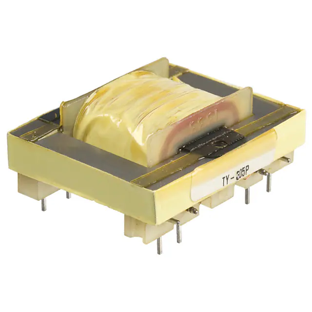

TY-305P-B 数据手册
A u d i o Tr a n s f o r m e r D a t a / Vo i c e C o u p l i n g T Y- 3 0 5 P Description: The TY series transformers are used for a variety of applications including impedance matching, isolation, repeat coil, line balancing, bridging and hybrid circuits. Max. DC Typ. Typ. Typ. Freq. DCR (Ohms) Current Insertion Return Response (Ohms) Pri Sec (mA) Loss (dB) Loss (dB) (dB) Pri Sec 600 600 100 1.5 10 ±.5 108 61 .680 TYP Impedance .150 MIN Electrical Specifications at 25º C: Designed to meet FCC Part 68 Longitudinal Balance: (FCC 68.310) – 60 dB min. 200 – 1000 Hz 45 dB min. 1000 – 4000 Hz 8 Dielectric Strength: (FCC 68.304) – 1500VAC 1 Power Level: -45 dBm to +7 dBm 1.65 TYP Frequency Range: Data/Voice = 300 to 3500 Hz Data = 800 to 3500 Hz 4 5 Operating Temperature: -20°C ~ 85°C 1.375 TYP Schematic: 3 6 PRIMARY 600 600 OHM OHM 7 .250 (3 PLCS) .200 .750 .062 DIA (8 PLCS) 2 RoHS Compliance: As of manufacturing date February 2016, all standard products meet the requirements of 2015/863/EU, known as the RoHS 3 initiative. 4 460 Harley Knox Blvd. Perris, California 92571 5 1.00 *Upon printing, this document is considered “uncontrolled”. Please contact Triad Magnetics website for the most current version. For soldering and washing information please see http://www.triadmagnetics.com/faq.html web:www.TriadMagnetics.com Phone 951-277-0757 Fax 951-277-2757 8 1 SECONDARY U N IT MOU N T IN G P A T T E R N Publish Date: May 31, 2019
