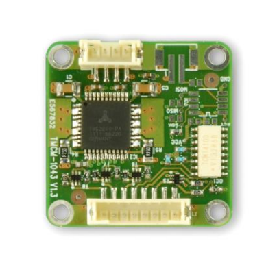

TMCM-1043-KIT 数据手册
MODULE FOR STEPPER MOTORS MODULE TMCM-1043 STEP/DIR DRIVER BOARD Cost-effective 1-axis Step/Dir stepper motor driver board for 2-phase bipolar stepper motors DESCRIPTION MAIN CHARACTERISTICS 2-phase stepper motor driver board Step/Dir Interface The TMCM-1043 is a simple and compact 1-axis driver board. It allows motor control via step and direction signals and can be directly controlled via a PLC or by an external Step/Dir controller board. Handling is quite easy and no further configuration is required. Nominal supply voltages are 12V DC and 24V DC. The drive capability is fixed at 1.1A RMS. The module provides a very high microstep resolution and TRINMICs spreadCycle chopper for smooth motor movement. The TMCM-1043 is equipped with an error output and an additional output. The board fits directly on the back of a NEMA17 stepper motor. Using the TMCM-1043 USB serial programmer kit, the TMCM-1043 can be configured for up to 1.4A RMS current resp. 2A peak. Further, standby current can be used. On-board Processor for initialization and diagnostic Fixed Drive Capability 1.1A RMS (1.6A peak current) or Program. Drive Capability up to 1.4A RMS (2A peak) Voltage Range 12… 24V DC nominal (9… 28V max.) µC Power Driver SPI Microstep Resolution 16 microsteps per full step input Step Multiplier 256 microsteps per full step output with *16 step multiplier TMC2660 Initialization Diagnostic MOSFET Driver Stage MOTOR TMCM-1043 9… 28V DC Error Output overtemperature Out1=ERROR Step/Dir OUT2 spreadCycle™ high-precision chopper Compact Size 37 x 37 x 8.2mm 3 37 Temperature Range -30… 50˚C 34 Mounting 4 holes for M3 screws for NEMA 17 motors 3 INTERFACE AND POWER CONNECTOR Pin 1 2 3 4 5 6 7 8 Label GND +24V OUT_2 OUT_1 COM ENABLE DIR STEP Label A1 A2 A3 A4 37 Interface / Power 1 X1 3 34 Motor Connector Description Motor coil A Motor coil A Motor coil B Motor coil B ORDER CODE TMCM-1043 4xM3 Motor Description System and module ground Power supply +24V DC nominal Output 2 Error output (overtemperature) Supply for optocoupler inputs Enable signal input Direction signal Step signal input MOTOR CONNECTOR Pin 1 2 3 4 X2 1 S/D stepper driver board TRINAMIC Motion Control GmbH & Co. KG Hamburg, Germany 1234 A1 A2 B1 Plug type: JST B4B-PH-SM4-TB Mating plug: JST PHR-4 B2 Interface and Power Connector 87654321 GND Power STEP/DIR OUT1/2 Plug type: JST B8B-PH-SM4-TB Mating plug: JST PHR-8 TMCM-1043 V1.3 Manual (Rev. 1.01 / 2013-NOV-30) Examples: Step/Dir Circuits Example 1: COM = +24V Example 1: COM = +5V +3.3V +24V +3.3V +5V TMCM-1043 TMCM-1043 8mA ENABLE 8mA 74HCT08 TMC2660 GND 8mA STEP TMC2660 8mA 74HCT08 GND 8mA DIR 8mA 74HCT08 GND GND GND Note: TRINAMIC offers the TMCM-1043 USB serial programmer kit which can be used to configure the TMCM-1043 for up to 1.4A RMS. One kit includes a power supply unit, the programmer, cables, and three TMCM-1043 modules. Caution! ! Add external power supply capacitors! It is recommended to connect an electrolytic capacitor of significant size to the power supply lines next to the TMCM-1043. Rule of thumb for size of electrolytic capacitor: ! Do not connect or disconnect motor during operation! Motor cable and motor inductivity might lead to voltage spikes when the motor is disconnected / connected while energized. These voltage spikes might exceed voltage limits of the driver MOSFETs and might permanently damage them. Therefore, always disconnect power supply before connecting / disconnecting the motor. ! Keep the power supply voltage below the upper limit of 28V! Otherwise the driver electronics will seriously be damaged! Especially, when the selected operating voltage is near the upper limit a regulated power supply is highly recommended. ! There is no reverse polarity protection! The module will short any reversed supply voltage due to internal diodes of the driver transistors. Disclaimer TRINAMIC Motion Control GmbH & Co. KG does not authorize or warrant any of its products for use in life support systems, without the specific written consent of TRINAMIC Motion Control GmbH & Co. KG. Life support systems are equipment intended to support or sustain life, and whose failure to perform, when properly used in accordance with instructions provided, can be reasonably expected to result in personal injury or death. Information given in this data sheet is believed to be accurate and reliable. However no responsibility is assumed for the consequences of its use nor for any infringement of patents or other rights of third parties which may result from its use. Specifications are subject to change without notice. All trademarks used are property of their respective owners. Revision History Version Date Author Description SD – Sonja Dwersteg 1.00 1.01 2013-DEC-03 2014-MAR-24 www.trinamic.com SD SD Initial version Current range programmable with TMCM-1043 USB serial programmer.
