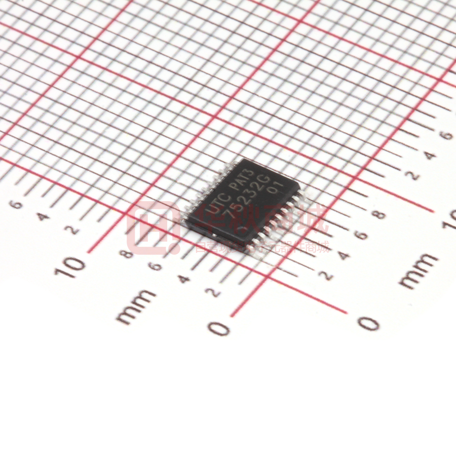

UNISONIC TECHNOLOGIES CO., LTD 75232 MULTIPLE RS-232 DRIVERS AND RECEIVERS DESCRIPTION The UTC 75232 is a monolithic IC containing three independent drivers and five receivers which comply with the requirements of the TIA/EIA232-F standards. LINEAR INTEGRATED CIRCUIT FEATURES * Single chip with easy interconnection of the UART and serial-port connector of personal computer. * Meets standard TIA/EIA-232-F and ITU V.28 * Up to 120 kbps data rate * 20-pin SOP/ DIP/SSOP/TSSOP packages Lead-free: 75232L Halogen-free: 75232G ORDERING INFORMATION Normal 75232-D20-T 75232-P20-R 75232-P20-T 75232-R20-R 75232-R20-T 75232-S20-R 75232-S20-T Ordering Number Lead Free 75232L-D20-T 75232L-P20-R 75232L-P20-T 75232L-R20-R 75232L-R20-T 75232L-S20-R 75232L-S20-T Halogen Free 75232G-D20-T 75232G-P20-R 75232G-P20-T 75232G-R20-R 75232G-R20-T 75232G-S20-R 75232G-S20-T Package DIP-20 TSSOP-20 TSSOP-20 SSOP-20 SSOP-20 SOP-20 SOP-20 Packing Tube Tape Reel Tube Tape Reel Tube Tape Reel Tube www.unisonic.com.tw Copyright © 2008 Unisonic Technologies Co., Ltd 1 of 10 QW-R113-005,E 75232 PIN CONFIGURATION VDD RA1 RA2 RA3 DY1 DY2 RA4 DY3 RA5 VSS 1 2 3 4 5 6 7 8 9 10 LINEAR INTEGRATED CIRCUIT 20 19 18 17 16 15 14 13 12 11 VCC RY1 RY2 RY3 DA1 DA2 RY4 DA3 RY5 GND PIN DESCRIPTION PIN NO. 1 2 3 4 5 6 7 8 9 10 11 12 13 14 15 16 17 18 19 20 PIN NAME VDD RA1 RA2 RA3 DY1 DY2 RA4 DY3 RA5 VSS GND RY5 DA3 RY4 DA2 DA1 RY3 RY2 RY1 VCC FUNCTION Supply voltage First receiver input Second receiver input Third receiver input First driver output Second driver output Fourth receiver input Third driver output Fifth receiver input Supply voltage Ground Fifth receiver output Third driver input Fourth receiver output Second driver input First driver input Third receiver output Second receiver output First receiver output Supply voltage UNISONIC TECHNOLOGIES CO., LTD www.unisonic.com.tw 2 of 10 QW-R113-005,E 75232 ABSOLUTE MAXIMUM RATINGS PARAMETER SYMBOL VDD VSS VCC LINEAR INTEGRATED CIRCUIT RATINGS UNIT 15 V Supply Voltage (Note 2) -15 V 10 V Driver -15 ~ 7 V Input Voltage Range VIN Receiver -30 ~ 30 V Driver Output Voltage Range VOUT -15 ~ 15 V Receiver Low Level Output Current IOUT 20 mA Operation Temperature TOPR 0 ~ +70 °C Storage Temperature TSTG -40 ~ +150 °C Note: 1. Absolute maximum ratings are those values beyond which the device could be permanently damaged. Note: 1. Absolute maximum ratings are stress ratings only and functional device operation is not implied. Note: 2. All voltages are with respect to the network ground terminal. THERMAL DATA PARAMETER DIP-20 Junction-to-Ambient SOP-20 SSOP-20 TSSOP-20 θJA SYMBOL RATINGS 70 100 115 115 UNIT °C/W RECOMMENDED OPERATING RATINGS PARAMETER Supply Voltage Level Input Voltage (driver only) High Level Output Current Low Level Output Current High Low Driver Receiver Driver Receiver SYMBOL VDD VSS VCC VIH VIL IOH IOL MIN 7.5 -7.5 4.5 1.9 TYP 9 -9 5 MAX 15 -15 5.5 0.8 -6.0 -0.5 6 16 UNIT V V V V V mA mA E LECTRICAL CHARACTERISTICS (Over recommended supply voltage and operating temperature ranges, unless otherwise specified) PARAMETER SUPPLY CURRENTS SYMBOL TEST CONDITIONS VDD =9V, VSS =-9V No load. VDD =12, VSS =-12V All inputs at 1.9V VDD =15, VSS =-15V VDD =9V, VSS =-9V No load. VDD =12, VSS =-12V All inputs at 0.8V VDD =15, VSS =-15V VDD =9V, VSS =-9V No load. VDD =12, VSS =-12V All inputs at 1.9V VDD =15, VSS =-15V VDD =9V, VSS =-9V No load. VDD =12, VSS =-12V All inputs at 0.8V VDD =15, VSS =-15V No load. All inputs at 5V, VCC=5V MIN TYP MAX UNIT 15 19 25 4.5 5.5 9 -15 -19 -25 -3.2 -3.2 -3.2 30 mA Supply Current from VDD IDD mA mA Supply Current from VSS ISS mA mA Supply Current from VCC ICC UNISONIC TECHNOLOGIES CO., LTD www.unisonic.com.tw 3 of 10 QW-R113-005,E 75232 ELECTRICAL CHARACTERISTICS(Cont.) LINEAR INTEGRATED CIRCUIT PARAMETER SYMBOL TEST CONDITIONS MIN TYP MAX UNIT DRIVER SECTION (VDD=9V, VSS=-9V, VCC=5V) Output Voltage Level High VOH VIL=0.8V, RL=3 kΩ 6 7.5 V (Figure. 1) Low VOL VIH=1.9V, RL=3 kΩ (Note 1) -7.5 -6 V Input Current Level High IIH VIN=5V 10 μA (Figure. 2) Low IIL VIN=0V -1.6 mA Short Circuit Output High IOH(SC) VIL=0.8V, VOUT=0V (Note 2) -8.5 -12 -19.5 mA Current (Figure. 1) Low IOL(SC) VIH=2.0V, VOUT=0V 8.5 12 19.5 mA Output Resistance (Note 3) ROUT VDD=VSS=VCC=0V, VOUT=-2V~2V 300 Ω RECEIVER SECTION (VDD=9V, VSS=-9V, VCC=5V) Ta=25°C (Figure. 5) 1.75 1.9 2.3 Positive VT+ V Going Threshold Voltage Ta=0°C ~ 70°C (Figure. 5) 1.55 2.3 Negative VT0.75 0.97 1.25 V Input Hysteresis(VT+ - VT-) VHYS 0.5 V VIH=0.75V 2.6 4 5 High VOH IOH=-0.5mA V Output Voltage Level Inputs Open 2.6 Low VOL VIN=3V, IOL=10mA 0.2 0.45 V VIN=25V 3.6 8.3 mA High IIH Input Current Level 0.43 VIN=3V (Figure. 5) VIN=-25V -3.6 -8.3 Low IIL mA -0.43 VIN=-3V Short-Circuit Output Current IO(SC) (Fig. 4) -3.4 -12 mA Note. 1. For voltage logic levels, the more positive (less negative) limit is designated as maximum, (e.g. if -10V is a maximum, the typical value is a more negative voltage). 2: Output short circuit conditions must maintain the total power dissipation below absolute maximum ratings and the sign is used to indicate direction. 3: Test conditions are those specified by TIA/EIA232-F and as listed above. SWITCHING CHARACTERISTICS (Ta=25°C) PARAMETER SYMBOL TEST CONDITIONS DRIVER SECTION (VDD=12V, VSS=-12V, VCC=5V) tPLH RL=3 ~ 7 kΩ, CL=15pF Propagation Delay Time (Figure. 3) tPHL MIN TYP 315 75 60 40 1.7 1.5 MAX UNIT 500 175 100 75 2.5 2.5 ns ns ns ns μs μs tTLH RL=3 ~ 7 kΩ, CL=15pF tTHL Transition Time RL=3 ~ 7 kΩ, CL=2500pF tTLH (Figure. 3, Note) tTHL RECEIVER SECTION (VDD=12V, VSS=-12V, VCC=5V) tPLH 107 250 ns RL=5 kΩ, CL=50pF tPHL 42 150 ns Propagation Delay Time (Figure. 6) tPLH 100 160 ns RL=1.5 kΩ, CL=15pF 60 100 ns tPHL tTLH 175 350 ns RL=5 kΩ, CL=50pF 16 60 ns tTHL Transition Time (Figure. 6) tTLH 90 175 ns RL=1.5 kΩ, CL=15pF tTHL 15 50 ns Note: Measured points of the output waveform (TIA/EIA-232-F conditions) as below, all unused inputs are tied. - Low to High level: between -3V and 3V. - High to Low level: between 3V and -3V. UNISONIC TECHNOLOGIES CO., LTD www.unisonic.com.tw 4 of 10 QW-R113-005,E 75232 PARAMETER MEASUREMENT INFORMATION DRIVER TEST CIRCUITS: LINEAR INTEGRATED CIRCUIT IIH VIN -IIL VIN VDD VCC Figure. 1 For VOH, VOL, IOH(SC), IOL(SC) VSS Figure. 2 For IIH, IIL DRIVER VOLTAGE WAVEFORMS: Figure. 3 Note: 1. The pulse generator characteristics: tW=25μs, PRR=20kHz, ZO=50Ω, tR=tF

1. 物料型号: - 型号为75232,有不同版本:标准版、无铅版(75232L)、无卤版(75232G)。
2. 器件简介: - UTC 75232是一款单片集成电路,包含三个独立的驱动器和五个接收器,符合TIA/EIA232-F标准。
3. 引脚分配: - VDD(1, 20):供电电压; - RA1-RA5(2-6, 7-9):接收器输入; - DY1-DY3(5, 6, 8):驱动器输出; - Vss(10):供电电压; - GND(11):地; - RY1-RY5(12-16):接收器输出; - DA1-DA3(13-15):驱动器输入。
4. 参数特性: - 驱动器部分:高电平输出电压(VOH)6V至7.5V,低电平输出电压(VOL)-7.5V至-6V; - 接收器部分:正向门槛电压(VT+)1.75V至2.3V,负向门槛电压(VT-)0.75V至1.25V。
5. 功能详解: - 75232提供三个驱动器和五个接收器,支持RS-232标准,数据传输速率可达120kbps。
6. 应用信息: - 用于保护电源供应,满足TIA/EIA-232-F的断电故障条件; - 需要选择合适的负载电容(C1, C2, C3)以满足RS-232最大斜率要求。
7. 封装信息: - 提供DIP-20、SOP-20、SSOP-20、TSSOP-20等多种封装方式。
