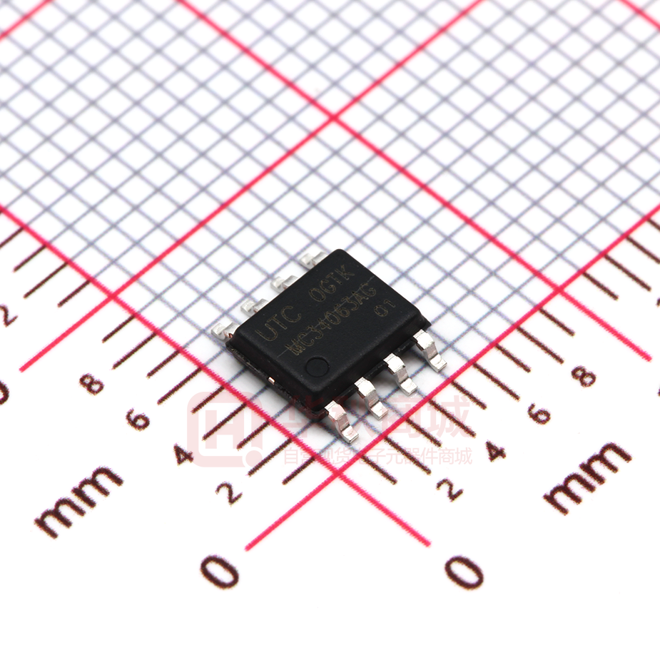

UNISONIC TECHNOLOGIES CO., LTD MC34063A DC TO DC CONVERTER CONTROLLER DESCRIPTION The UTC MC34063A is a monolithic regulator subsystem, intended for use as DC to DC converter. This device contains a temperature compensated band gap reference, a duty-cycle control oscillator, driver and high current output switch. It can be used for step down, step-up or inverting switching regulators as well as for series pass regulators. LINEAR INTEGRATED CIRCUIT FEATURES * Operation from 3.0V to 40V. * Short circuit current limiting. * Low standby current. * Output switch current of 1.5A without external transistors. * Frequency of operation from 100Hz to 100kHz. * Step-up, step-down or inverting switch regulators. Lead-free: MC34063AL Halogen-free: MC34063AG ORDERING INFORMATION Normal MC34063A-D08-T MC34063A-S08-R Ordering Number Lead Free MC34063AL-D08-T MC34063AL-S08-R Halogen Free MC34063AG-D08-T MC34063AG-S08-R Package DIP-8 SOP-8 Packing Tube Tape Reel www.unisonic.com.tw Copyright © 2008 Unisonic Technologies Co., Ltd 1 of 10 QW-R103-008,H MC34063A PIN CONFIGURATION LINEAR INTEGRATED CIRCUIT PIN DESCRIPTION PIN NO 1 2 3 4 5 6 7 8 PIN NAME Switch Collector Switch Emitter Timing Capacitor GND Comparator Inverting Input VCC IPEAK Sense Driver Collector I/O I O DESCRIPTION Internal Darlington pairs TI collector Internal Darlington pairs TI emitter The value of selected capacitor controls the internal oscillator run rate Inverting input of comparator which can set & initiate the Darlington pairs output switch Current sense input to monitor the voltage drop across an external resistor placed in series with VCC Internal Darlington pairs TI collector I I I UNISONIC TECHNOLOGIES CO., LTD www.unisonic.com.tw 2 of 10 QW-R103-008,H MC34063A BLOCK DIAGRAM LINEAR INTEGRATED CIRCUIT E Switch Collector 1 T1 Switch Emitter 2 A Timing Capacitor 3 COMP. T2 Q S R D C Is 8 Drive Collector 7 IPEAK Sense CT OSCILLATOR 6 Vcc GND 4 1.25VREF B 5 Comparator Inverting Input UNISONIC TECHNOLOGIES CO., LTD www.unisonic.com.tw 3 of 10 QW-R103-008,H MC34063A ABSOLUTE MAXIMUM RATINGS (Ta=25°C ) PARAMETER Supply Voltage Comparator Input Voltage Range Switch Collector Voltage Switch Emitter Voltage Switch Collector to Emitter Voltage Driver Collector Voltage Switch Current LINEAR INTEGRATED CIRCUIT RATINGS UNIT 40 V -0.3 ~ +40 V 40 V 40 V 40 V 40 V 1.5 A DIP-8 1250 Power Dissipation (Ta=25°C) PD mW SOP-8 625 Junction Temperature TJ +150 °C Operating Temperature TOPR 0 ~ +70 °C Storage Temperature TSTG -65 ~ +150 °C Note: Absolute maximum ratings are those values beyond which the device which the device could be permanently damaged. Absolute maximum ratings are stress ratings only and functional device operation is not implied. SYMBOL VCC VIN(COMP) VC(SW) VE(SW) VCE(SW) VC(DR) ISW THERMAL DATA PARAMETER Junction-to-Ambient DIP-8 SOP-8 SYMBOL θJA RATINGS 100 160 UNIT ℃/W ELECTRICAL CHARACTERISTICS (VCC=5.0V, Ta=0~+70°C, unless otherwise specified.) PARAMETER Oscillator Charging Current Discharging Current Oscillator Amplitude Discharge to Charge Current Ratio Current limit Sense Voltage Output Switch Saturation Voltage 1(Note) Saturation Voltage 2(Note) DC Current Gain(Note) Collector Off State Current(Note) Comparator Threshold Voltage Threshold Voltage Line Regulation Input Bias Current Total Device Supply Current SYMBOL ICHG IDISCHG VOSC K VSENSE VCE(SAT)1 VCE(SAT)2 GI (DC) IC(OFF) VTHD VTHD II(BIAS) ICC TEST CONDITIONS VCC=5 to 40V, Ta=25°C VCC=5 to 40V, Ta=25°C Ta=25°C V7=VCC, Ta=25°C ICHG=IDISCHG, Ta=25°C ISW=1.0A, VC(DRIVER)=VC(SW) ISW=1.0A, VC(DRIVER)=50mA ISW=1.0A, VCE=5.0V, Ta=25°C VCE=40.0V, Ta=25°C MIN 22 140 5.2 250 TYP MAX UNIT 31 190 0.5 6.1 300 0.95 0.45 180 0.01 42 260 7.5 350 1.3 0.7 100 μA μA V mV V V μA V mV nA mA 50 VCC=3 ~ 40V VIN=0V 1.21 1.24 1.29 2.0 5.0 50 400 2.7 4.0 VCC=5~40V, CT=0.001 V7=VCC, VC>VTHD, Pin2=GND Note: Output switch tests are performed under pulsed conditions to minimize power dissipation. UNISONIC TECHNOLOGIES CO., LTD www.unisonic.com.tw 4 of 10 QW-R103-008,H MC34063A STEP-UP CONVERTER 170μH L 8 180 SQ R 7 IPK RSC 0.22 VIN12V 6 + 100 VCC + - Comp. 5 R2 R1 2.2k 47k 330 1.25V REF REG OSC CT 3 CT 1500pF 4 Q2 Q1 2 1 LINEAR INTEGRATED CIRCUIT 1N5819 1.0μH + CO VOUT 28V/175mA VOUT + 100 Optional Filter Test Line Regulation Load Regulation Output Ripple Efficiency Output Ripple With Optional Filter Conditions VIN = 8.0V ~ 16V, IOUT = 175mA VIN = 12V, IOUT = 75mA ~ 175mA VIN = 12V, IOUT = 175mA VIN = 12V, IOUT = 175mA VIN = 12V, IOUT = 175mA Results 30mV = ±0.05% 10mV = ±0.017% 400mVp-p 87.7% 40mVp-p UNISONIC TECHNOLOGIES CO., LTD www.unisonic.com.tw 5 of 10 QW-R103-008,H MC34063A STEP-DOWN CONVERTER(Cont.) LINEAR INTEGRATED CIRCUIT Test Line Regulation Load Regulation Output Ripple Short Circuit Current Efficiency Output Ripple With Optional Filter Conditions VIN = 15V ~ 25V, IOUT = 500mA VIN = 25V, IOUT = 50mA ~ 500mA VIN = 25V, IOUT = 500mA VIN = 25V, RL = 0.1Ω VIN = 25V, IOUT = 500mA VIN = 25V, IOUT = 500mA Results 12mV = ±0.12% 3.0mV = ±0.03% 120mVp-p 1.1A 83.7% 40mVp-p UNISONIC TECHNOLOGIES CO., LTD www.unisonic.com.tw 6 of 10 QW-R103-008,H MC34063A VOLTAGE INVERTING CONVERTER LINEAR INTEGRATED CIRCUIT Test Line Regulation Load Regulation Output Ripple Short Circuit Current Efficiency Output Ripple With Optional Filter Conditions VIN = 4.5V ~ 6.0V, IOUT = 100mA VIN = 5.0V, IOUT = 10mA ~ 100mA VIN = 5.0V, IOUT = 100mA VIN = 5.0V, RL = 0.1Ω VIN = 5.0V, IOUT = 100mA VIN = 5.0V, IOUT = 100mA Results 3.0mV = ±0.012% 0.022V = ±0.09% 500mVp-p 910mA 62.2% 70mVp-p UNISONIC TECHNOLOGIES CO., LTD www.unisonic.com.tw 7 of 10 QW-R103-008,H MC34063A LINEAR INTEGRATED CIRCUIT EXTERNAL CURRENT BOOST CONNECTIONS FOR IC PEAK GREATER THAN 1.5A UNISONIC TECHNOLOGIES CO., LTD www.unisonic.com.tw 8 of 10 QW-R103-008,H MC34063A TYPICAL CHARACTERISTICS LINEAR INTEGRATED CIRCUIT UNISONIC TECHNOLOGIES CO., LTD www.unisonic.com.tw 9 of 10 QW-R103-008,H MC34063A DESIGN FORMULA TABLE CALCULATION tON tOFF (tON+tOFF)MAX CT 4x10-5 tON 2IOUT(MAX) 0.3/ISW STEP-DOWN LINEAR INTEGRATED CIRCUIT STEP-UP VOLTAGE-INVERTING VOUT + VF VIN - VCE(SAT) 4x10-5 tON 4x10-5 tON ISW RS L(MIN) CO 0.3/ISW 0.3/ISW IOUT tON VRIPPLE(P-P) VCE(SAT) - Saturation voltage of the output switch. VF - Forward voltage drop of the ringback rectifier. The following power supply characteristics must be chosen: - Nominal input voltage. VIN VOUT - Desired output voltage, VOUT =1.25(1+R2/R1) - Desired output current. IOUT FMIN - Minimum desired output switching frequency at the selected values for VIN and IOUT. VRIPPLE(P-P) - Desired peak-to-peak output ripple voltage. In practice, the calculated value will need to be increased due to the capacitor equivalent series resistance and board layout. The ripple voltage should be kept to a low value since it will directly effect the line and load regulation. U TC assumes no responsibility for equipment failures that result from using products at values that exceed, even momentarily, rated values (such as maximum ratings, operating condition ranges, or other parameters) listed in products specifications of any and all UTC products described or contained herein. UTC products are not designed for use in life support appliances, devices or systems where malfunction of these products can be reasonably expected to result in personal injury. Reproduction in whole or in part is prohibited without the prior written consent of the copyright owner. The information presented in this document does not form part of any quotation or contract, is believed to be accurate and reliable and may be changed without notice. UNISONIC TECHNOLOGIES CO., LTD www.unisonic.com.tw 10 of 10 QW-R103-008,H
MC34063AG-S08-R
物料型号: - 标准型号:MC34063A-D08-T(DIP-8封装,管装) - 无铅型号:MC34063AL-D08-T(DIP-8封装,管装) - 无卤型号:MC34063AG-D08-T(DIP-8封装,管装) - SOP-8封装,胶带卷装:MC34063A-S08-R(标准),MC34063AL-S08-R(无铅),MC34063AG-S08-R(无卤)
器件简介: MC34063A是一款单体集成电路调节器子系统,用于DC到DC转换器。该设备包含一个温度补偿的带隙参考源、一个占空比控制振荡器、驱动器和高电流输出开关。它可以用于降压、升压或反相开关稳压器,以及串联通道稳压器。
引脚分配: 1. 开关集电极(I):内部达林顿对的TI集电极 2. 开关发射极(O):内部达林顿对的TI发射极 3. 定时电容器:选定的电容器值控制内部振荡器的运行速率 4. GND:地 5. 比较器反相输入(I):比较器的反相输入,可以设置和启动达林顿对的输出开关 6. Vcc:电源 7. IPEAK Sense:电流感应输入,用于监测外部电阻上的电压降
参数特性: - 操作电压范围:3.0V至40V - 短路电流限制 - 低待机电流 - 输出开关电流:1.5A(无需外部晶体管) - 操作频率:100Hz至100kHz - 支持升压、降压或反相开关稳压器
功能详解: MC34063A包含一个温度补偿的带隙参考源、占空比控制振荡器、驱动器和高电流输出开关,使其能够实现降压、升压或反相开关稳压器的功能。此外,它还具有短路保护和低待机电流的特点。
应用信息: MC34063A适用于需要DC到DC转换的各种应用,包括但不限于电源适配器、电池充电器、开关电源等。
封装信息: - DIP-8封装:MC34063A-D08-T(管装),MC34063A-D08-R(胶带卷装) - SOP-8封装:MC34063A-S08-R(胶带卷装)
