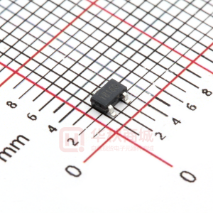

UNISONIC TECHNOLOGIES CO., LTD SK1816 BIPOLAR LATCH TYPE HALL EFFECT FOR HIGH-TEMPERATURE OPERATION DESCRIPTION The UTC SK1816 is a semiconductor integrated circuit utilizing the Hall effect. It designed to operate in the alternating magnetic field especially at low supply voltage and operation over extended temperature ranges to +125℃. This Hall IC is suitable for application to various kinds of sensors, contact-less switches, such as Speed sensor, Position sensor, Rotation sensor, Contact-less sensor, and Motor control. LINEAR INTEGRATED CIRCUIT 1 SIP-3 3 2 1 SOT-23 FEATURES * Wide supply voltage range of 2.5V to 20V * Wide temperature operation range of -20℃~+125℃ * Alternating magnetic field operation * Built-in protection diode * TTL and MOS IC are directly drivable by the output * The life is semipermanent because it employs contact-less parts * SIP-3 and SOT-23 package are available. *Pb-free plating product number: SK1816L ORDERING INFORMATION Order Number Normal Lead Free Plating SK1816-AE3-4-R SK1816L-AE3-4-R SK1816-G03-D-K SK1816L-G03-D-K Package SOT-23 SIP-3 Pin Assignment 1 2 3 O I G I G O Packing Tape Reel Bulk Note: Pin Assignment: I:VSS O:VOUT SK1816L-AE3-4-R G:GND (1) K: Bulk, R: Tape Reel (2) refer to Pin Assignment (3) AE3: SOT-23, G03: SIP-3 (4) L: Lead Free Plating, Blank: Pb/Sn (1)Packing Type (2)Pin Assignment (3)Package Type (4)Lead Plating www.unisonic.com.tw Copyright © 2005 Unisonic Technologies Co., Ltd 1 of 7 QW-R118-004,A SK1816 MARKING INFORMATION LINEAR INTEGRATED CIRCUIT SIP-3 1816 L: Lead Free Plating Blank: Pb/Sn , Date Code SOT-23 1816 L: Lead Free Plating, Blank: Pb/Sn BLOCK DIAGRAM REGULATOR Vcc Output GND Hall element Amplifier Schmidt trigger Output stage UNISONIC TECHNOLOGIES CO., LTD www.unisonic.com.tw 2 of 7 QW-R118-004,A SK1816 ABSOLUTE MAXIMUM RATINGS (Ta = 25℃) PARAMETER LINEAR INTEGRATED CIRCUIT SYMBOL VCC ICC IO RATINGS UNIT Supply Voltage 2.5~20 V Supply Current 10 mA Circuit Current 20 mA SIP-3 400 Power Dissipation PD mW SOT-23 200 Operating Temperature TOPR -20 ~ +125 ℃ Storage Temperature TSTG -40 ~ +150 ℃ Note 1. Absolute maximum ratings are those values beyond which the device could be permanently damaged. Absolute maximum ratings are stress ratings only and functional device operation is not implied. 2. The device is guaranteed to meet performance specification within 0℃~+70℃ operating temperature range and assured by design from -20℃~+125℃. ELECTRICAL CHARACTERISTICS (Ta=25℃, unless otherwise specified.) PARAMETER Low-Level Output Voltage Output Leakage Current Output Short Circuit Current Supply Current Output Switching Time SYMBOL VOL ILEAK -Ios ICC TR TF TEST CONDITIONS VCC =16V,IOUT=12mA,B=30 mT VCC =3.6V,IOUT=12mA,B=30 mT VCC =16V,B=-30 mT VCC =16V,VOUT=0V,B=-30 mT VCC =16V VCC =3.6V VCC =16V,RL=10KΩ,CL=10PF VCC =16V,RL=10KΩ,CL=10PF MIN TYP MAX UNIT 0.7 V 0.7 V 1 10 µA 0.8 mA 6 mA 5.5 mA μS 5 μS 1 MAGNETIC CHARACTERISTICS Operate Point BOP At Ta = +25℃ 5 mT Release Point BRP At Ta = +25℃ -5 mT Hysteresis BHYS At Ta = +25℃ 5.5 mT NOTE: 1. BOP =operate point (output turns ON); BRP =release point (output turns OFF); BHYS =hysteresis(BOP – BRP). As used here, negative flux densities are defined as less than zero (algebraic convention). Typical values are at Ta = +25℃ and VCC = 12V. 2. 1mT=10 gauss UNISONIC TECHNOLOGIES CO., LTD www.unisonic.com.tw 3 of 7 QW-R118-004,A SK1816 PACKAGE INFORMATION LINEAR INTEGRATED CIRCUIT SIP-3 4.1 mm 0.95 mm SOT-23 0.385 mm 2.01 mm 3.0 mm 1.00 mm Fig. 1 SENSOR LOCATIONS S 1 2 3 Marked face 1. Vcc 2. GND 3. Output N Marked face 1. Vcc 2. Output 3. GND 1 3 2 N SIP-3 Vout H Bh L Brp Bop 0 Magnetic flux density S SOT-23 Fig.2 APPLYING DIRECTION OF MAGNETIC FLUX UNISONIC TECHNOLOGIES CO., LTD www.unisonic.com.tw 4 of 7 QW-R118-004,A SK1816 TYPICAL APPLICATION CIRCUIT LINEAR INTEGRATED CIRCUIT VIN Coil 1 Coil 2 Vcc SK1816 SIP-3 GND Output FOR DC FAN 1 Vin 3.5K 100 3K 8V Vcc Coil 1 1.5K Coil 2 SK1816 SIP-3 1.5K Output GND FOR DC FAN 2 TEST CIRCUIT VIN 1816 10KΩ DO 10P UNISONIC TECHNOLOGIES CO., LTD www.unisonic.com.tw 5 of 7 QW-R118-004,A SK1816 TYPICAL CHARACTERISTICS Temperature vs. Magnetic field 60 Magnetic field ( G ) 40 30 20 10 -6 -6 -6 -6 -6 -5 -5 -5 -5 -10 -20 0 10 25 55 75 95 115 125 Temperature ( C ) 0 42 36 43 37 44 39 46 41 Magnetic field ( G ) 50 35 29 37 31 38 32 47 42 49 44 Bop Brp BW LINEAR INTEGRATED CIRCUIT Voltage vs. Magnetic field 60 50 40 35 34 30 20 10 0 -1 -10 3 -20 37 34 43 37 45 37 48 38 53 40 Bop Brp BW 5 -3 -6 12 15-7 20-9 27-13 Voltage ( V ) Temperature vs. Icc 6.00 5.00 Current ( mA ) 4.00 3.00 2.00 1.00 0.00 -20 0 10 25 55 75 95 115 125 Temperature ( C ) Current ( mA ) 5.11 4.91 4.78 4.55 4.36 4.20 4.03 3.95 3.87 Icc 4.60 4.55 4.50 4.45 4.40 4.35 3 5 4.45 4.50 Voltage vs. Icc 4.55 4.56 4.56 4.57 Icc 12 15 20 27 Voltage ( V ) Temperature vs. Sink 31 30 30 29 29 28 28 27 27 29 29 29 28 28 28 28 28 27 3 Voltage vs. Sink 30 30 30 30 29 28 28 28 Sink Sink (mA) 29 Sink (mA) 29 28 29 29 29 Sink 28 -20 0 10 25 55 75 95 115 125 5 13 15 20 27 Temperature ( C ) Voltage ( V ) UNISONIC TECHNOLOGIES CO., LTD www.unisonic.com.tw 6 of 7 QW-R118-004,A SK1816 TYPICAL CHARACTERISTICS(Cont.) Switch Points 50 Hysteresis IN Gauss Switch Point IN Gauss 40 30 20 10 0 -10 -20 0 10 25 55 75 95 115 125 60 50 40 30 20 10 0 -20 LINEAR INTEGRATED CIRCUIT Hysteresis 0 10 25 55 75 95 115 125 Ambient Temperature IN oC Ambient Temperature IN oC Output Sink Current 31 30 30 29 29 28 28 27 27 -20 0 10 25 55 75 95 115 125 Ambient Temperature IN oC 6.00 Supply Current IN mA 5.00 4.00 3.00 2.00 1.00 0.00 -20 0 Supply Current Sink Current IN mA 10 25 55 75 95 115 125 Ambient Temperature IN oC Output Sink Current 29 29 29 28 28 28 28 28 27 3 5 13 15 20 27 Voltage ( V ) 4.60 Input Current ( mA ) 4.55 4.50 4.45 4.40 4.35 3 5 Vin - Icc Current ( mA ) 12 15 20 27 Voltage ( V ) UTC assumes no responsibility for equipment failures that result from using products at values that exceed, even momentarily, rated values (such as maximum ratings, operating condition ranges, or other parameters) listed in products specifications of any and all UTC products described or contained herein. UTC products are not designed for use in life support appliances, devices or systems where malfunction of these products can be reasonably expected to result in personal injury. Reproduction in whole or in part is prohibited without the prior written consent of the copyright owner. The information presented in this document does not form part of any quotation or contract, is believed to be accurate and reliable and may be changed without notice. UNISONIC TECHNOLOGIES CO., LTD www.unisonic.com.tw 7 of 7 QW-R118-004,A
