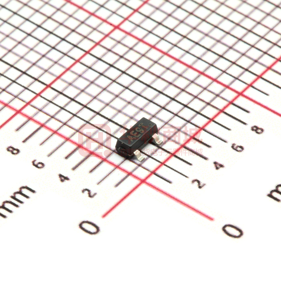

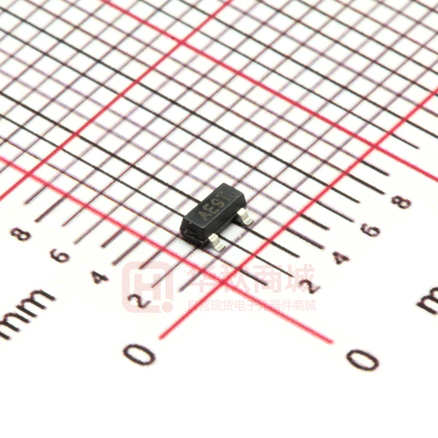

    MOS管 P-Channel VDS=-20V VGS=±12V ID=-4.2A Pd=830mW SOT23
UT2305G-AE3-R 数据手册
UNISONIC TECHNOLOGIES CO., LTD UT2305 Power MOSFET 4.2A, 20V P-CHANNEL POWER MOSFET  DESCRIPTION The UTC UT2305 is P-channel enhancement mode power MOSFET, designed in serried ranks. With fast switching speed, low on-resistance, favorable stabilization. Used in commercial and industrial surface mount applications and suited for low voltage applications such as DC/DC converters. SYMBOL   ORDERING INFORMATION Ordering Number Note:  UT2305G-AE2-R UT2305G-AE3-R UT2305G-AG3-R Pin Assignment: G: Gate D: Drain Package SOT-23-3 SOT-23 SOT-26 1 S S D Pin Assignment 4 5 2 3 G D G D D G S D 6 D Packing Tape Reel Tape Reel Tape Reel S: Source MARKING SOT-23 / SOT-23-3 www.unisonic.com.tw Copyright © 2015 Unisonic Technologies Co., Ltd SOT-26 1 of 4 QW-R502-133.H UT2305  Power MOSFET ABSOLUTE MAXIMUM RATINGS PARAMETER SYMBOL RATING UNITS Drain-Source Voltage VDS - 20 V Gate-Source Voltage VGS ± 12 V Continuous Drain Current (Note 3) (TA=25°C) ID -4.2 A Pulsed Drain Current (Note 1, 2) IDM -10 A SOT-23-3 0.83 W Power Dissipation (TA=25°C) SOT-23 PD 1.38 W SOT-26 1.1 W Junction Temperature TJ +150 °C Storage Temperature TSTG -55 ~ +150 °C Note: Absolute maximum ratings are those values beyond which the device could be permanently damaged. Absolute maximum ratings are stress ratings only and functional device operation is not implied.  THERMAL DATA PARAMETER Junction to Ambient (Note 3)  SYMBOL SOT-23-3 SOT-23 SOT-26 θJA RATING 150 90 110 UNIT °C/W °C/W °C/W ELECTRICAL CHARACTERISTICS (TJ =25°C, unless otherwise specified) PARAMETER SYMBOL OFF CHARACTERISTICS Drain-Source Breakdown Voltage BVDSS Drain-Source Leakage Current IDSS Gate-Source Leakage Current IGSS Breakdown Voltage Temperature Coefficient ∆BVDSS/∆TJ ON CHARACTERISTICS Gate Threshold Voltage VGS(TH) Drain-Source On-State Resistance (Note 2) RDS(ON) TEST CONDITIONS MIN VGS=0V, ID=-250μA VDS=-20V, VGS=0V VGS=±12V, VDS=0V Reference to 25°C, ID=-1mA -20 VDS=VGS, ID=-250uA VGS=-10V, ID=-4.5A VGS=-4.5V, ID=-4.2A VGS=-2.5V, ID=-2.0A VGS=-1.8V, ID=-1.0A -0.5 DYNAMIC CHARACTERISTICS Input Capacitance CISS VGS=0V, VDS=-15V, f=1MHz Output Capacitance COSS Reverse Transfer Capacitance CRSS SWITCHING CHARACTERISTICS Turn-ON Delay Time (Note 2) tD(ON) Turn-ON Rise Time tR VDS=-15V, VGS=-10V, ID=-1A, RG=6Ω, RD=15Ω Turn-OFF Delay Time tD(OFF) Turn-OFF Fall Time tF Total Gate Charge (Note 2) QG VDS=-16V, VGS=-4.5V, Gate-Source Charge QGS ID=-4.2A Gate-Drain Charge QGD SOURCE- DRAIN DIODE RATINGS AND CHARACTERISTICS Drain-Source Diode Forward Voltage(Note2) VSD VGS=0V, IS=-1.2A Reverse Recovery Time trr VGS=0V, IS=-4.2A, dI/dt=100A/μs Reverse Recovery Charge QRR Notes: 1. Pulse width limited by TJ(MAX) 2. Pulse width ≤300μs, duty cycle≤2%. 3. Surface mounted on 1 in2 copper pad of FR4 board; 270°C/W when mounted on min. UNISONIC TECHNOLOGIES CO., LTD www.unisonic.com.tw TYP MAX UNIT -0.1 V -1 μA ±100 nA V/°C -1.2 53 65 100 250 V mΩ mΩ mΩ mΩ 900 116 120 pF pF pF 12 36 326 200 30 5 2.5 ns ns ns ns nC nC nC -1.2 27.7 22 V ns nC 2 of 4 QW-R502-133.H UT2305 Power MOSFET TYPICAL CHARACTERISTICS Drain Current,-ID (A) Drain Current,-ID (A)  Typical Capacitance Characteristics Gate Charge Characteristics 10000 f=1.0MHZ ID=-4.2A VDS=-16V 10 CISS 1000 8 C (pF) Gate to Source Voltage,-VGS (V) 12 6 COSS 100 4 CRSS 2 10 0 0 5 10 15 20 25 Total Gate Charge,QG (nC) UNISONIC TECHNOLOGIES CO., LTD www.unisonic.com.tw 1 5 9 13 17 21 25 29 Drain-to-Source Voltage,-VDS (V) 3 of 4 QW-R502-133.H UT2305  Power MOSFET TYPICAL CHARACTERISTICS(Cont.) UTC assumes no responsibility for equipment failures that result from using products at values that exceed, even momentarily, rated values (such as maximum ratings, operating condition ranges, or other parameters) listed in products specifications of any and all UTC products described or contained herein. UTC products are not designed for use in life support appliances, devices or systems where malfunction of these products can be reasonably expected to result in personal injury. Reproduction in whole or in part is prohibited without the prior written consent of the copyright owner. The information presented in this document does not form part of any quotation or contract, is believed to be accurate and reliable and may be changed without notice. UNISONIC TECHNOLOGIES CO., LTD www.unisonic.com.tw 4 of 4 QW-R502-133.H
