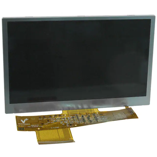

    LCD TFT 480X272 4.3"
COG-T430T6566-04 数据手册
VL-FS-COG-VLGT6566-04 REV.B (COG-VLGT6566-04) OCT/2010 PAGE 2 OF 18 DOCUMENT REVISION HISTORY DOCUMENT DATE REVISION FROM TO DESCRIPTION CHANGED BY CHECKED BY A 2010.06.28 First Release. ZENG LI HUANG YUAN LIANG B 2010.10.28 Items 1 was updated: 1.) (Page 1) Customer name was updated. ZENG LI HUANG YUAN LIANG VL-FS-COG-VLGT6566-04 REV.B (COG-VLGT6566-04) OCT/2010 PAGE 3 OF 18 CONTENTS Page No. 1. GENERAL DESCRIPTION 4 2. MECHANICAL SPECIFICATIONS 4 3. INTERFACE SIGNALS 8 4. 4.1 4.2 ABSOLUTE MAXIMUM RATINGS ELECTRICAL MAXIMUM RATINGS - FOR IC ONLY ENVIRONMENTAL CONDITION 9 9 9 5. 5.1 5.2 5.3 ELECTRICAL SPECIFICATIONS TYPICAL ELECTRICAL CHARACTERISTICS TIMING SPECIFICATION POWER ON/OFF SEQUENCE 10 10 11 13 6. OPTICAL CHARACTERISTICS (FOR TFT PANEL ONLY) 14 7. TFT PANEL INSPECTION SPECIFICATIONS 16 8. REMARK 18 VL-FS-COG-VLGT6566-04 REV.B (COG-VLGT6566-04) OCT/2010 PAGE 4 OF 18 VARITRONIX LIMITED Specification of LCD Module Type Model No.: COG-VLGT6566-04 1. General Description • • • • 4.3” TFT, 480 x RGB x 272 dots, 16M Colors, positive, transmissive dot matrix LCD module. Viewing angle: 6 o’clock. Driving IC: ‘HIMAX’ HX8257-A (COG) TFT LCD controller & driver or equivalent. Data interface: parallel RGB interface. • • • Logic voltage: 3.0V. White LED backlight. FPC connection. • “RoHS” compliance. 2. Mechanical Specifications The mechanical detail is shown in Fig. 1 and summarized in Table 1 below. Table 1 Parameter Outline dimensions Active area Display format Color TFT 480xRGBx272 Color configuration Dot pitch Weight Specifications 105.5(W) x 109.8(H) x 3.05(D) 95.04(W) x 53.86(H) 480 x RGB x 272 RGB stripe 0.198(RGB)(W) x 0.198(H) (0.066(W) x 0.198(H)) Approx: 45 Unit mm mm dots mm gram VL-FS-COG-VLGT6566-04 REV.B (COG-VLGT6566-04) OCT/2010 PAGE 5 OF 18 Figure 1: Module Specification VL-FS-COG-VLGT6566-04 REV.B (COG-VLGT6566-04) OCT/2010 PAGE 6 OF 18 4.3" TFT LCD DISPLAY 480 x RGB x 272 DOTS 480 x RGB 272 VSS VDD PCLK DISP HSYNC VSYNC 'HIMAX' HX8257-A (COG) TFT CONTROLLER & DRIVER DE R0~R7, G0~G7, B0~B7 24 VLED1VLED1+ WHITE LED BACKLIGHT Figure 2: Block diagram VL-FS-COG-VLGT6566-04 REV.B (COG-VLGT6566-04) OCT/2010 PAGE 7 OF 18 Figure 3: Reference circuit diagram VL-FS-COG-VLGT6566-04 REV.B (COG-VLGT6566-04) OCT/2010 PAGE 8 OF 18 3. Interface signals Pin No. 1~2 3~4 5 6 7 8 9 10 11 12 13 14 15 16 17 18 19 20 21 22 23 24 25 26 27 28 29 30 31 32 33 34 35 Symbol VSS VDD (VDDIO,VCI) R0 R1 R2 R3 R4 R5 R6 R7 G0 G1 G2 G3 G4 G5 G6 G7 B0 B1 B2 B3 B4 B5 B6 B7 VSS PCLK (CLK/DOTCLK) PON (DISP) HSYNC (HS) VSYNC (VS) DE NC Table 2(a): Pin assignment Description Ground. Power supply. Digital data input. R7~R0/G7~G0/B7~B0 are used. Ground. Clock signal for data latching in RGB interface. Display on/off mode control. Internally pulled high. (a) DISP=L, standby mode. (b) DISP=H, normal display mode. Horizontal sync input in RGB interface. Vertical sync input in RGB interface. Input data enable control in RGB interface. No connection. VL-FS-COG-VLGT6566-04 REV.B (COG-VLGT6566-04) OCT/2010 PAGE 9 OF 18 Pin No. 36 37 38 39 40 41 42 43 44~45 4. 4.1 4.2 Symbol VSS NC NC NC NC VSS VLED1VLED1+ NC Table 2(b): Pin assignment Description Ground. No connection. Ground. Cathode of LED backlight. Anode of LED backlight. No connection. Absolute Maximum Ratings Electrical Maximum Ratings – for IC Only Table 3 Parameter Symbol Min. Max. Unit Logic Power Supply VDD - VSS -0.3 +4.0 V Note: The modules may be destroyed if they are used beyond the absolute maximum ratings. All voltage values are referenced to VSS = 0V. Environmental Condition Table 4 Item Ambient temperature (Ta) Operating temperature (Topr) Min. -20°C Max. +70°C Storage temperature (Tstg) (Note 1) Min. Max. -30°C +80°C Remark Dry Humidity (note 1) 90% max. RH for Ta ≤ 40°C No < 50% RH for 40°C < Ta ≤ Maximum operating temperature condensation Vibration (IEC 68-2-6) cells must be mounted on a suitable connector Frequency: 10 ∼ 55 Hz Amplitude: 0.75 mm Duration: 20 cycles in each direction. Shock (IEC 68-2-27) Half-sine pulse shape Pulse duration: 11 ms 3 directions Peak acceleration: 981 m/s2 = 100g Number of shocks: 3 shocks in 3 mutually perpendicular axes. Note 1: Product cannot sustain at extreme storage conditions for long time. 3 directions VL-FS-COG-VLGT6566-04 REV.B (COG-VLGT6566-04) OCT/2010 PAGE 10 OF 18 5. 5.1 Electrical Specifications Typical Electrical Characteristics At Ta = 25 °C, VDD=3.0±0.1V, VSS=0V. Parameter Power supply voltage (Logic) Input signal voltage Supply current (Logic) Supply voltage of white LED backlight Symbol Table 5 Conditions VDD VIH VIL IDD VLED Luminance (on the backlight surface) “H” level “ L” level VDD=3.0V Forward current =20 mA @25°C No. of LED dies = 7 x 1 = 7 dies Min. Typ. Max. Unit V 2.9 3.0 3.1 0.8VDD 0 VDD 0.2VDD - - 30 V V mA - 23.1 - V 2800 - - cd/m2 Note: Do not display the fixed pattern for a long time because it may develop image sticking due to the LCD structure. It should change pattern frequently. If the screen is displayed with fixed pattern, use a screen saver. VL-FS-COG-VLGT6566-04 REV.B (COG-VLGT6566-04) OCT/2010 PAGE 11 OF 18 5.2 Timing Specification 5.2.1 parallel RGB Interface Timing Characteristics At Ta = 25 °C, VDD=3.0±0.1V, VSS=0V. Table 6 R0~R7, G0~G7, B0~B7 R0~R7, G0~G7, B0~B7 Figure 5: parallel RGB Interface Timing VL-FS-COG-VLGT6566-04 REV.B (COG-VLGT6566-04) OCT/2010 PAGE 12 OF 18 5.2.3 Input Setup Timing Requirement Characteristics At Ta = 25 °C, VDD=3.0±0.1V, VSS=0V. Table 8 R0~R7, G0~G7, B0~B7 Figure 6: Input Setup Timing Requirement VL-FS-COG-VLGT6566-04 REV.B (COG-VLGT6566-04) OCT/2010 PAGE 13 OF 18 5.3 Power On/Off Sequence The HX8257-A has a power ON/OFF sequence control function. When DISP pin is pulled “H”, blank data is outputted for 10-frames first, from the falling edge of the following VSYNC signal. Similarly, when DISP is pulled “L”, 10-frames of blank data will be outputted from the falling edge of the following VSYNC, too. The blank data would be gray level 0 for normally black LC (NBW= “H”), and be gray level 255 for normally white LC (NBW= “L”). Figure 7: Power On Sequence Figure 8: Power Off Sequence VL-FS-COG-VLGT6566-04 REV.B (COG-VLGT6566-04) OCT/2010 PAGE 14 OF 18 6. Optical Characteristics (for TFT panel only) Table 9: Optical specifications (light source: C light) Specifications Items Symbol Condition Unit Note Min. Typ. Max. Transmittance T% 6.1 % Contrast Ratio CR 250 TR 5 ms Response Time TF 15 ms All left side data are based on XR 0.590 0.620 0.650 Red following 0.314 0.344 0.374 YR condition -XG 0.276 0.306 0.336 Green Viewing 6 o’clock YG 0.533 0.563 0.593 normal angle Chromaticity NTSC: 50% XB 0.103 0.133 0.163 LC: TN Blue θX = θY = 0° YB 0.119 0.149 0.179 Light: C light XW 0.281 0.311 0.341 (Machine:BM5A) White YW 0.319 0.349 0.379 Normal Polarizer φ1(3 o’clock) 45 Reference Only Hor. φ2(9 o’clock) Center 45 Viewing angle deg. CR≥10 θ2(12 o’clock) 15 Ver. θ1(6 o’clock) 35 Note 1: Definition of Contrast Ratio (CR): The contrast ratio can be calculated by the following expression. Contrast Ratio (CR) = L63 / L0 L63: Luminance of gray level 63 L0: Luminance of gray level 0 CR = CR (5) CR (X) is corresponding to the Contrast Ratio of the point X at Figure in Note 5. Note 2: Definition of Response Time (TR, TF): Figure 9 VL-FS-COG-VLGT6566-04 REV.B (COG-VLGT6566-04) OCT/2010 PAGE 15 OF 18 Note 3: Definition of view angle (θ , φ ): Figure 10 Note 4: The above “Viewing Angle” is the measuring position with Largest Contrast Ratio; not for good image quality. View Direction for good image quality is 6 O’clock. Measurement Set-Up: The LCD module should be stabilized at a given temperature for 20 minutes to avoid abrupt temperature change during measuring. In order to stabilize the luminance, the measurement should be executed after lighting Backlight for 20 minutes in a windless and dark room. Photometer (BM-7A) Figure 11 Note 5: Figure 12 VL-FS-COG-VLGT6566-04 REV.B (COG-VLGT6566-04) OCT/2010 PAGE 16 OF 18 7. TFT Panel Inspection Specifications VL-FS-COG-VLGT6566-04 REV.B (COG-VLGT6566-04) OCT/2010 PAGE 17 OF 18 VL-FS-COG-VLGT6566-04 REV.B (COG-VLGT6566-04) OCT/2010 PAGE 18 OF 18 8. Remark “ Varitronix Limited reserves the right to change this specification.” Tel:(852) 2197-6000 Fax:(852) 2343-9555. - END - URL:http://www.varitronix.com
