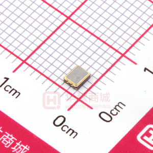

    OX-200 - Oven Controlled Crystal Oscillator - Vectron International, Inc
OX-200 数据手册
OX-200 Oven Controlled Crystal Oscillator OX-200 Features • Reflow Process Compatible • AT-CUT and SC_CUT Crystal Options • Low Profile Compact Package • • • • • Applications Base stations Test equipment Synthesizers Military communication equipment Digital Switching Performance Specifications Frequency Stabilities1 (AT-Cut Crystal-Standard - ) Parameter vs. operating temperature range (referenced to +25°C) Min -50 -100 -150 -200 -0.3 -10 -10 -2 -500 -250 Typical Max +50 +100 +150 +200 +0.3 +10 +10 +2 +500 +250 5 Units ppb ppb ppb ppb ppm ppb ppb ppb ppb ppb minutes Condition 0 to +70°C -20 to +70°C -20 to +70°C -40 to +85°C at time of shipment, nominal EFC VS ±5% static Load ±5% static after 30 days of operation after 30 days of operation after 30 days of operation to ±100ppb of final frequency (1 hour reading) @ +25°C 0 to +70°C -20 to +70°C -20 to +70°C -40 to +85°C at time of shipment, nominal EFC VS ±5% static Load ±5% static after 30 days of operation after 30 days of operation after 30 days of operation to ±100ppb of final frequency (1 hour reading) @ +25°C Options5 Initial tolerance vs. supply voltage change vs. load change vs. aging / day vs. aging / year vs. aging / year (followig year) Warm-up time Frequency Stabilities1 (SC-Cut Crystal-Option - 10 to 160 MHz) vs. operating temperature range (referenced to +25°C) -10 -20 -25 -30 -0.2 -5 -5 -1 -100 -50 +10 +20 +25 +30 +0.2 +5 +5 +1 +100 +50 5 ppb ppb ppb ppb ppm ppb ppb ppb ppb minutes Initial tolerance vs. supply voltage change vs. load change vs. aging / day vs. aging / year vs. aging / year (following year) Warm-up time Page 1 of 5 Vectron International • 267 Lowell Road, Hudson, NH 03051 • Tel: 1-88-VECTRON-1 • http://www.vectron.com Performance Specifications Supply Voltage (Vs) Parameter Supply voltage (standard) Min 3.135 4.75 11.4 Typical 3.3 5.0 12.0 Max 3.465 5.25 12.6 3.0 1.0 Units VDC VDC VDC Watts Watts Condition Power consumption during warm-up steady state @ +25°C RF Output Signal [standard] Load Signal Level (Vol) Signal Level (Vol) Signal Level (Voh) Signal Level (Voh) Duty Cycle Signal Load Output Power @3,3V Putput Power @ 5.0V Harmonics Tuning Range Tuning Range Linearity Tuning Slope Control Voltage Range 0.0 0.0 0.0 Reference Voltage 2.75 3.92 4.9 1.4 2.0 2.0 2.8 4.0 5.0 ±3.0 ±0.75 10% Positive 2.8 4.0 4.0 2.85 4.08 5.1 -90 -120 -140 -145 -150 -75 -100 -130 -140 -150 14 Handling & Processing Note VDC VDC VDC VDC dBc/Hz dBc/Hz dBc/Hz dBc/Hz dBc/Hz dBc/Hz dBc/Hz dBc/Hz dBc/Hz dBc/Hz g VDC with Vs=3.3V with Vs=5.0V with Vs=12.0V with Vs = 3.3 VDC with Vs = 5.0 VDC with Vs =12 VDC 1 Hz 10 Hz 100 Hz 1 kHz 10 kHz 1 Hz 10 Hz 100 Hz 1 kHz 10 kHz 2 5 50 5 8 8 11 -30 Fixed OCXO; No adjust ±8 ±2.0 ppm ppm with AT cut crystal with SC cut crystal 2.4 3.5 45 55 Sine Wave Ω dBm dBm dBm 50 Ω load 50 Ω load 50 Ω load % 15 0.4 0.5 VDC HCMOS pF VDC with Vs=3.3V and 15pF Load with Vs=5.0V & 12V and 15pF Load with Vs=3.3V and 15pF Load with Vs=5.0V & 12V and 15pF Load @ (Voh-Vol)/2 Frequency Tuning (EFC) Option5 @ 10MHz with SC Cut @ 10MHz with AT Cut Reference Voltage Output (Vref ) Additional Parameters Phase Noise3 Phase Noise3 Weight Processing & Packing Page 2 of 5 Vectron International • 267 Lowell Road, Hudson, NH 03051 • Tel: 1-88-VECTRON-1 • http://www.vectron.com Absolute Maximum Ratings supply voltage (Vs) Output Load Operable Temperature Range Storage Temperature Range -55 -55 6.5 15.0 50 +85 +125 V V pF °C °C with Vs=3.3 & 5.0 VDC with Vs= 12 VDC Outline Drawing / Enclosure OX-200 Height “H” 10.4 12.7 13,4 Pin Length “L” 6.2 min. 6.2 min 6.2 min Pin Connections 1 2 3 4 5 RF Output Ground (Case) Electronic Frequency Control Input (EFC) Reference Voltage Option Supply Voltage Input (VS) Dimensions in mm Page 3 of 5 Vectron International • 267 Lowell Road, Hudson, NH 03051 • Tel: 1-88-VECTRON-1 • http://www.vectron.com Standard Shipping Method (OX-301) A X B K P Enclosure Type Typ OX-401 *bei W ≤ 24 mm nur untere Lochreihe ∗by W ≤ 24 mm only lower hole line Lage im Gurt Position in tape Pin 1 Abwickelrichtung Unwinding direction Gurtunterseite Tape buttom side Gurtoberseite Tape upper side Tape Width W (mm) 44 Quantity per meter 37.5 Quantity per reel 280 Dimension P 32 Recommended Reflow Profile Profile Feature Average ramp-up rate (TL to TP) Preheat -Temperature Min TSmin -Temperature Min TSmax -Time (min to max) tS Pb-Free Assembly/ Sn-Pb Assembly 3°C/second max. 150°C 200°C 60-180 seconds 3°C/second max 217°C 60-150 seconds max 260°C Profile Feature Time 25°C to Peak Temperature Time maintained above -Temperature (TL) -Time (tL) Pb-Free Assembly/ Sn-Pb Assembly 8 minutes max. 217°C 60-150 seconds TSmax to TL -Ramp-up Rate Time maintained above -Temperature (TL) -Time (tL) Peak Temperature (TP) Time within 5°C of actual Peak Temperature (tP) Ramp-down Rate 20-40 seconds 6°C/ second max Note: All temperatures refer to topside of the package, measured on the package body surface. Page 4 of 5 Vectron International • 267 Lowell Road, Hudson, NH 03051 • Tel: 1-88-VECTRON-1 • http://www.vectron.com Ordering Information OX - 200 0 - D A E - 258 0 - 10M0000000 Product Family OX: OCXO Frequency Package THT version: 200 Height 0: 10.4 mm 1: 12.7 mm 2: 13.4 mm Supply Voltage B: 12V D: 5V E: 3.3V RF Output Code A: HCMOS E: Sinewave Frequency Control 0: No Tuning 1: ±1.0 to ±2.5ppm 2: ±3.0 to ±8.0ppm Stability Code 108: ±10ppb 208: ±20ppb 258: ±25ppb 508: ±50ppb 107: ±100ppb Temperature Range E: -40°C to +85°C J: -20°C to +70°C Notes: 1. Contact factory for improved stabilities or additional product options. Not all options and codes are available at all frequencies. 2. Unless other stated all values are valid after warm-up time and refer to typical conditions for supply voltage, frequency control voltage, load, temperature (25°C). 3. Phase noise degrades with increasing output frequency. 4. Subject to technical modification. 5. Contact factory for availability. For Additional Information, Please Contact USA: Vectron International 267 Lowell Road Hudson, NH 03051 Tel: 1.888.328.7661 Fax: 1.888.329.8328 Europe: Vectron International Landstrasse, D-74924 Neckarbischofsheim, Germany Tel: +49 (0) 7268.801.100 Fax: +49 (0) 7268.801.282 Asia: Vectron International 1F-2F, No 8 Workshop, No 308 Fenju Road WaiGaoQiao Free Trade Zone Pudong, Shanghai, China 200131 Tel: 86.21.5048.0777 Fax: 86.21.5048.1881 Disclaimer Vectron International reserves the right to make changes to the product(s) and or information contained herein without notice. No liability is assumed as a result of their use or application. No rights under any patent accompany the sale of any such product(s) or information. Rev:30.Mar 2010 Page 5 of 5 Vectron International • 267 Lowell Road, Hudson, NH 03051 • Tel: 1-88-VECTRON-1 • http://www.vectron.com
