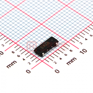

PS-702 SAW Based Clock Oscillator Former Part Number SO-720 PS-702 Description The PS-702 is a SAW Based Clock Oscillator that achieves low phase noise and very low jitter performance. The PS-702 is housed in an industry standard 6-Pad leadless ceramic package that is hermetically sealed. Packaging options include bulk or tape and reel. Features • • Industry Standard Package, 5.0 x 7.5 x 2.0 mm ASIC Technology For Ultra Low Jitter 0.100 ps-rms typical across 12 kHz to 20 MHz BW 0.120 ps-rms typical across 50 kHz to 80 MHz BW • • • • • • • Output Frequencies from 150 MHz to 1 GHz 3.3 V Operation LV-PECL or LVDS Configuration with Fast Transition Times Complementary Outputs Output Disable Feature Improved Temperature Stability over Standard SAW XO Product is free of lead and compliant to EC RoHS Directive • • • • • Applications Reference Clock for Wired and Wireless Products Description Standard 1-2-4 Gigabit Fibre Channel 10 Gigabit Fibre Channel 10GbE LAN / WAN OC-192 SONET / SDH INCITS 352-2002 INCITS 364-2003 IEEE 802.3ae ITU-T G.709 GR-253-CORE Issue4 Block Diagram Vcc COutput Output BAW SAW Vc OD Gnd Page1 of 7 Vectron International • 267 Lowell Road, Hudson, NH 03051 • Tel: 1-88-VECTRON-1 • http://www.vectron.com Rev: 08May2009 Performance Specifications Table 1: Electrical Performance Parameter Voltage 2, 3 Current (No Load) 3 Symbol VCC ICC Min Supply 2.97 Frequency Typical 3.3 55 Maximum 3.63 70 1000 Units V mA MHz ppm Nominal Frequency 1, 2 fN fSTAB 150 ±50, ±100 Frequency Stability 1, 2 (Ordering Option) Aging 6, 8 10 Outputs VCC-1.4 450 250 IOUT 5, 6 ppm V mV-pp V mV-pp Mid Level - LVPECL 2, 3 Swing - LVPECL Swing - LVDS 2, 3 Current 6 Rise Time Fall Time 5, 6 Symmetry 6, 7 2, 3 2, 3 2, 3 VCC-1.25 600 VCC-1.2 450 VCC-1.0 750 Mid Level - LVDS 20 500 500 45 50 0.100 0.120 2.5 16 0/70, -20/70 or -40/85 5.0 x 7.5 x 2.0 55 0.250 0.300 3.0 24 mA ps ps % ps-rms ps-rms ps-rms ps pk-pk °C mm tR tF SYM фJ фJ фJ фJ TOP Jitter (12 kHz - 20 MHz BW) 622.08 MHz Jitter 6, 7 (50 kHz - 80 MHz BW) 622.08 MHz Period Jitter 9, RMS (622.08 MHz) Period Jitter , Peak - Peak (622.08 MHz) Operating Temperature Package Size 1] 2] 3] 4] 5] 6] 7] 8] 9] 1 9 See Standard Frequencies and Ordering Information tables (Pg 7) for more specific information Parameters are tested with production test circuit below (Fig 1). Parameters are tested at ambient temperature with test limits guard-banded for specified operating temperature. Measured as the maximum deviation from the best straight-line fit, per MIL-0-55310. Measured from 20% to 80% of a full output swing (Fig 2). Not tested in production, guaranteed by design, verified at qualification. Integrated across stated bandwidth per GR-253-CORE Issue4. Tested with Vc = 0.3V to 3.0V unless otherwise stated in part description Broadband Period Jitter measured using Lecroy Wavemaster 8600A 6 GHz Oscilloscope, 250K samples taken Enable, Disable (-1.3V, +2.0V) 1 6 (+2.0V) tR COutput tF No connect 2 5 VOH 50% VOL (-1.3V) 3 4 50Ω Output 50Ω On Time Test Circuit Notes: 1) To Permit 50Ω Measurement of Outputs, all DC Inputs are Biased Down 1.3V. 2) All Voltage Sources Contain Bypass Capacitors to Minimize Supply Noise. 3) 50Ω Terminations are Within Test Equipment. Period Fig 1: Test Circuit Fig 2: LV-PECL Waveform Page2 of 7 Vectron International • 267 Lowell Road, Hudson, NH 03051 • Tel: 1-88-VECTRON-1 • http://www.vectron.com Rev: 08May2009 Absolute Maximum Ratings Parameter Power Supply Output Current Storage Temperature Soldering Temp/Time Symbol VCC IOUT TS TLS Ratings 0 to 4 25 -55 to 125 260 / 40 Unit V mA °C °C / sec Stresses in excess of the absolute maximum ratings can permanently damage the device. Functional operation is not implied at these or any other conditions in excess of conditions represented in the operational sections of this datasheet. Exposure to absolute maximum ratings for extended periods may adversely affect device reliability. Permanent damage is also possible if OD or Vc is applied before Vcc. Suggested Output Load Configurations +3.3V 0.10 μF 0.01 μF 0.10 μF 0.01 μF +3.3V +3.3V 150Ω 150Ω OD N/C Gnd 1 2 3 6 5 4 Vcc COutput Output Z = 50Ω Z = 50Ω 100Ω OD N/C Gnd 1 2 3 6 5 4 Vcc COutput Output Z = 50Ω Z = 50Ω 40Ω 40Ω 49Ω 49Ω 240Ω 240Ω LV-PECL to LV-PECL: For short transmission lengths, the power consumption could be reduced by removing the 100Ω resistor and doubling the value of the pull down resistors. LV-PECL to LVDS: Restricted for short transmission lengths. Configuration may require modification depending on LVDS receiver. +3.3V 0.10 μF 0.01 μF 0.10 μF 0.01 μF +2.0V OD N/C Gnd 1 2 3 6 5 4 Vcc COutput Output 0.01 μF 0.01 μF OD N/C -1.3V 1 2 3 6 5 4 Vcc COutput Output 240Ω 240Ω Functional Test: Allows standard power supply configuration. Since AC coupled, the LV-PECL levels cannot be measured. Production Test: Allows direct DC coupling into 50Ω measurement equipment. Must bias the power supplys as shown. Similar to Figure 1. Page3 of 7 Vectron International • 267 Lowell Road, Hudson, NH 03051 • Tel: 1-88-VECTRON-1 • http://www.vectron.com Rev: 08May2009 Typical Characteristics - Phase Noise PS-702-ECE-GAAN-622M080000 Page4 of 7 Vectron International • 267 Lowell Road, Hudson, NH 03051 • Tel: 1-88-VECTRON-1 • http://www.vectron.com Rev: 08May2009 Reliability VI qualification includes aging at various extreme temperatures, shock and vibration, temperature cycling, and IR reflow simulation. The PS-702 family is capable of meeting the following qualification tests: Environmental Compliance Parameter Mechanical Shock Mechanical Vibration Solderability Gross and Fine Leak Resistance to Solvents Conditions MIL-STD-883, Method 2002 MIL-STD-883, Method 2007 MIL-STD-883, Method 2003 MIL-STD-883, Method 1014 MIL-STD-883, Method 2016 Handling Precautions Although ESD protection circuitry has been designed into the PS-702 proper precautions should be taken when handling and mounting. VI employs a human body model (HBM) and a charged device model (CDM) for ESD susceptibility testing and design protection evaluation. ESD Ratings Model Human Body Model Man Man Model Minimum 1500V 200V Conditions MIL-STD-883, Method 3015 V/JESD22-A115-A Reflow Profile (IPC/JEDEC J-STD-020C) Parameter PreHeat Time Ramp Up Time Above 217 °C Time To Peak Temperature Time at 260 °C Ramp Down Symbol tS RUP tL TAMB-P tP RDN Value 60 sec Min, 180 sec Max 3 °C/sec Max 60 sec Min, 150 sec Max 480 sec Max 20 sec Min, 40 sec Max 6 °C/sec Max The device is qualified to meet the JEDEC standard for Pb-Free assembly. The temperatures and time intervals listed are based on the Pb-Free small body requirements. The PS-702 device is hermetically sealed so an aqueous wash is not an issue. Termination Plating: Electroless Gold Plate over Nickel Plate Page5 of 7 Vectron International • 267 Lowell Road, Hudson, NH 03051 • Tel: 1-88-VECTRON-1 • http://www.vectron.com Rev: 08May2009 Outline Drawing & Pad Layout Pin Out Pin 1 Symbol NC or OE 1 Function NC or Enable = LV-CMOS logic 0 or Ground Disable = LV-CMOS logic 1 **see Note 1 below** NC or Enable = LV-CMOS logic 0 or Ground Disable = LV-CMOS logic 1 **see Note 1 below** Case and Electrical Ground Output Complementary Output Power Supply Voltage (3.3V ±10%) 2 NC or OE1 3 4 5 6 GND Output COutput VCC Note 1: For proper operation disable pin can not be left floating and a pin1 or pin 2 enable option must be ordered. See page 7 for alternative input logic operation Tape & Reel (EIA-481-2-A) Tape Dimensions (mm) Dimension Tolerance PS-702 Reel Dimensions (mm) Po Typ 4 W Typ 16 F Typ 7.5 Do Typ 1.5 P1 Typ 8 A Typ 178 B Min 1.5 C Typ 13 D Min 20.2 N Min 50 W1 Typ 16.4 W2 Max 22.4 # Per Reel 200 Page6 of 7 Vectron International • 267 Lowell Road, Hudson, NH 03051 • Tel: 1-88-VECTRON-1 • http://www.vectron.com Rev: 08May2009 Standard Output Frequencies (MHz) 155M520000 240M000000 320M000000 491M520000 635M040000 690M569200 800M000000 156M250000 245M760000 324M000000 500M000000 637M500000 693M483000 901M120000 160M000000 250M000000 350M000000 531M250000 640M000000 704M380600 1000M00000 162M000000 260M000000 375M000000 532M000000 644M531300 707M352700 175M000000 268M800000 384M000000 533M000000 657M421900 720M000000 187M500000 300M000000 389M600000 537M600000 666M514300 742M434700 200M000000 311M040000 400M000000 622M080000 669M326600 768M000000 212M500000 312M500000 480M000000 625M000000 672M162700 796M875000 Frequencies not shown are available upon request. Ordering Information PS - 702 - E C E - K A A N - xxxMxxxxxx Product Family PS: SO - SAW Oscillator Package 702: 5 x 7.5 x 2.0 mm 6 Pad Ceramic SMD Input E: 3.3 Vdc ±10% Output C: LV-PECL (45/55% Symmetry) D: LVDS (45/55% Symmetry) Operating Temperature T: 0°C to 70°C J: -20°C to 70°C E: -40 to 85 °C Frequency (See Above) 150 - 1000 MHz Future Use Enable/Disbale Pin A: Pin 1 B: Pin 2 Enable/Disable A: Enable High, Tristate B: Enable High, Fixed Logic Level C: Enable Low, Tristate D: Enable Low, Fixed Logic Level Stability K: ± 50 ppm maximum S: ± 100 ppm maximum *Not all combinations are possible For Additional Information, Please Contact USA: Vectron International 267 Lowell Road Hudson, NH 03051 Tel: 1.888.328.7661 Fax: 1.888.329.8328 Europe: Vectron International Landstrasse, D-74924 Neckarbischofsheim, Germany Tel: +49 (0) 3328.4784.17 Fax: +49 (0) 3328.4784.30 Asia: Vectron International 1F-2F, No 8 Workshop, No 308 Fenju Road WaiGaoQiao Free Trade Zone Pudong, Shanghai, China 200131 Tel: 86.21.5048.0777 Fax: 86.21.5048.1881 Disclaimer Vectron International reserves the right to make changes to the product(s) and or information contained herein without notice. No liability is assumed as a result of their use or application. No rights under any patent accompany the sale of any such product(s) or information. Page7 of 7 Vectron International • 267 Lowell Road, Hudson, NH 03051 • Tel: 1-88-VECTRON-1 • http://www.vectron.com Rev: 08May2009
PS-702-ECT-KDA
1. 物料型号: - 型号为PS-702,是一款基于SAW(声表面波)的时钟振荡器。
2. 器件简介: - PS-702是一款实现低相位噪声和超低抖动性能的SAW时钟振荡器。它采用行业标准的6-pad无引脚陶瓷封装,并且是密封的。封装选项包括散装或卷带。
3. 引脚分配: - 1号引脚:NC或OE'(根据注释1,NC或使能=LV-CMOS逻辑0或接地禁用=LV-CMOS逻辑1) - 2号引脚:NC或OE'(同1号引脚) - 3号引脚:GND(机箱和电气地) - 4号引脚:输出 - 5号引脚:C输出(互补输出) - 6号引脚:V(电源电压,3.3V±10%)
4. 参数特性: - 工作频率范围从150MHz到1GHz。 - 12kHz至20MHz带宽下典型0.100ps-rms抖动,50kHz至80MHz带宽下典型0.120ps-rms抖动。 - 3.3V操作,支持LV-PECL或LVDS配置,具有快速转换时间。 - 提供互补输出和输出禁用功能。 - 提升了温度稳定性,符合EC RoHS指令。
5. 功能详解: - 应用于有线和无线产品的参考时钟,包括1-2-4吉比特光纤通道、10吉比特光纤通道、10GbE局域网/广域网、OC-192 SONET/SDH等。
6. 应用信息: - 用于参考时钟,适用于多种通信标准,如INCITS 352-2002、INCITS 364-2003、IEEE 802.3ae、ITU-T G.709等。
7. 封装信息: - 封装尺寸为5.0x7.5x2.0mm的6-pad表面贴装陶瓷封装。
