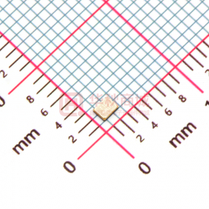

Temperature Compensated Crystal Oscillator TX-600 / TX-601 TX-600 Description The TX-600 Series TCXO is designed utilizing full analog technology. Extremely low phase noise and smooth frequency vs temperature are achieved. Innovative packaging design allows for high volume manufacturing as well as low profile. Features • • • • • • • • • High Shock Survival > 20,000 G (TX-600) Commercial application (TX-601) Low Phase Noise, Low G-Sensitivity Stratum 3 Compliant Fully RoHS Compliant Surface Mount, Low Profile Rugged Construction Frequency Range: 5 MHZ to 100 MHZ Previous Model: C2280 • • • • • • Applications Military Portable Radios GPS Telemetry Test and Measurement Equipment Wi-Max Basestations Wireless Communications Wireline Switches Performance Specifications Parameter vs. operating temperature range (referenced to +25°C) Min -2.0 -1.0 -0.5 -0.28 -4.6 -1.0 -0.1 -0.2 Typ Max +2.0 +1.0 +0.5 +0.28 +4.6 +1.0 +0.1 +0.2 4.0 5.25 3.465 2.9 Units ppm ppm ppm ppm ppm ppm ppm ppm ppm ppm VDC VDC VDC Condition -40… +85°C -40… +85°C -20… +70°C 0… +70°C Stratum 3, GR-1244-CORE, for all causes and 15 yrs aging at time of shipment, nominal EFC Vs ± 5% Load ± 10% @ +40°C for 15 years Frequency Stabilities1 Total stability Initial Tolerance vs. supply voltage change vs. load change vs. aging / 1 year vs. aging Supply voltage Supply voltage Supply voltage ±1 Supply Voltage (Vs) 4.75 3.135 2.7 5.0 3.3 2.8 Vectron International • 267 Lowell Road, Hudson, NH 03051 • Tel: 1-88-VECTRON-1 • http://www.vectron.com Performance Specifications Parameter Current consumption Min Typ Max 35 Units mA Condition Depends on frequency RF Output Signal Load Signal Level (Vol) Signal Level (Voh) Rise/Fall Time Duty cycle Tri-State (>12.8 MHz) Signal Level Load R Load C Tuning Range Tuning Range Tuning Slope Control Voltage Range Freq. control input impedance Reference Voltage (Vref ) (1 mA source) Phase Noise3 (@ 20 MHz tested under nominal operating conditions) 0.0 10 ±5.0 Positive Vs VDC kohm 40 50 0.9*Vs 5 60 15 0.1*Vs HCMOS pF V V ns % @ nominal Load and 10% to 90% of waveform @ nominal Load and @ 50% level Tristate Output standard Vpp kohm pF with Nominal Load Active High Clipped Sinewave 1 10 10 Frequency Tuning (EFC) Fixed; No adjust ppm Additional Parameters1 +3.8 +2.3 +4.0 +2.4 +4.1 +2.5 -90 -120 -140 -145 -150 1 6.0 0 -45 -55 Vs +90 +105 VDC VDC dBc/Hz dBc/Hz dBc/Hz dBc/Hz dBc/Hz ps RMS V V °C °C Damage will occur beyond this level Vs=>+4.5 VDC Vs=>+2.7 VDC 10 Hz 100 Hz 1 kHz 10 kHz 100 kHz Jitter Supply voltage (Vs) Control Voltage Operable temperature range Storage temperature range Absolute Maximum Ratings Vectron International • 267 Lowell Road, Hudson, NH 03051 • Tel: 1-88-VECTRON-1 • http://www.vectron.com Outline Drawing / Enclosure A X B P *bei W ≤ 24 mm nur untere Lochreihe ∗by W ≤ 24 mm only lower hole line Lage im Gurt Position in tape Pin 1 Abwickelrichtung Unwinding direction K Gurtunterseite Tape buttom side Gurtoberseite Tape upper side Production tolerance complying DIN IEC 286-3 Enclosure Type Type C Tape width W [mm] 44 Quantity per meter 50 Quantity per reel 300 Dimension P 20 Recommended Reflow Profile Vectron International • 267 Lowell Road, Hudson, NH 03051 • Tel: 1-88-VECTRON-1 • http://www.vectron.com Outline Drawing / Enclosure Dimensions in [mm] inches Pin Connections 1 Voltage Control (Vc) Reference Voltage (Vref ) Ground (Case) Output Enable Supply Voltage (Vs) 2 3 4 5 6 Type C Code 0 Height “H” 3.81 mm Pin Length “L” NA Vectron International • 267 Lowell Road, Hudson, NH 03051 • Tel: 1-88-VECTRON-1 • http://www.vectron.com Ordering Information TX - 600 0 - D A T - 106 Product Family TX: TCXO Package 600: High shock 601: Commercial Height 0: 3.81 mm Supply Voltage D: 5 Vdc E: 3.3 Vdc G: 2.8Vdc RF Output Code A: HCMOS F: Sinewave, clipped A - 10M0000000 Frequency Tuning Option A: No Tuning B: Electrical Tuning Stability Code 206: ±2.0ppm 106: ±1.0ppm 507: ±0.5ppm 287: ±0.28ppm 466: ±4.6ppm (Stratum3) Temperature Range E: -40°C to +85°C J: -20°C to +70°C T: 0°C to +70°C Notes: 1. Contact factory for improved stabilities or additional product options. Not all options and codes are available at all frequencies. 2. Unless other stated all values are valid after warm-up time and refer to typical conditions for supply voltage, frequency control voltage, load, temperature (25°C). 3. Phase noise degrades with increasing output frequency. 4. Subject to technical modification. 5. Contact factory for availability. For Additional Information, Please Contact Vectron International 267 Lowell Road Hudson, NH 03051 Tel: 1.888.328.7661 Fax: 1.888.329.8328 USA: Vectron International Landstrasse, D-74924 Neckarbischofsheim, Germany Tel: +49 (0) 3328.4784.17 Fax: +49 (0) 3328.4784.30 Europe: Vectron International 1F-2F, No 8 Workshop, No 308 Fenju Road WaiGaoQiao Free Trade Zone Pudong, Shanghai, China 200131 Tel: 86.21.5048.0777 Fax: 86.21.5048.1881 Asia: Disclaimer Vectron International reserves the right to make changes to the product(s) and or information contained herein without notice. No liability is assumed as a result of their use or application. No rights under any patent accompany the sale of any such product(s) or information. Rev: 6/2/2009 daf Vectron International • 267 Lowell Road, Hudson, NH 03051 • Tel: 1-88-VECTRON-1 • http://www.vectron.com

### 物料型号 - 型号:TX-600 / TX-601
### 器件简介 - 描述:TX-600系列TCXO(温度补偿晶体振荡器)采用全模拟技术设计,实现了极低的相位噪声和平滑的频率与温度关系。创新的封装设计允许高产量制造以及低轮廓。
### 引脚分配 - Type C封装引脚: - 0:未定义 - 1:电压控制(Vc) - 2:参考电压(Vref) - 3:地(Case) - 4:输出 - 5:使能 - 6:供电电压(Vs)
### 参数特性 - 频率稳定性: - 工作温度范围:-40...+85°C,稳定性为-2.0到+2.0ppm(参考+25°C) - -40...+85°C:-1.0到+1.0ppm - -20...+70°C:-0.5到+0.5ppm - 0...+70°C:-0.28到+0.28ppm - 总稳定性:Stratum 3, GR-1244-CORE, 所有原因和15年老化,-4.6到+4.6ppm - 初始容差:-1.0到+1.0ppm,发货时,名义EFC - 供电电压变化、负载变化、老化/1年、老化:-0.1到+0.1ppm,-0.2到+0.2ppm,4.0ppm,15年老化
### 功能详解 - 高冲击生存:> 20,000 G(TX-600) - 低相位噪声、低G-灵敏度 - Stratum 3合规 - 完全符合RoHS - 表面贴装、低轮廓 - 坚固结构 - 频率范围:5 MHz到100 MHz
### 应用信息 - 军事便携式无线电 - GPS遥测 - 测试和测量设备 - Wi-Max基站 - 无线通信 - 有线交换机
### 封装信息 - 封装类型:Type C - 胶带宽度:44mm - 每米数量:50 - 每卷数量:300 - 尺寸P:20mm
