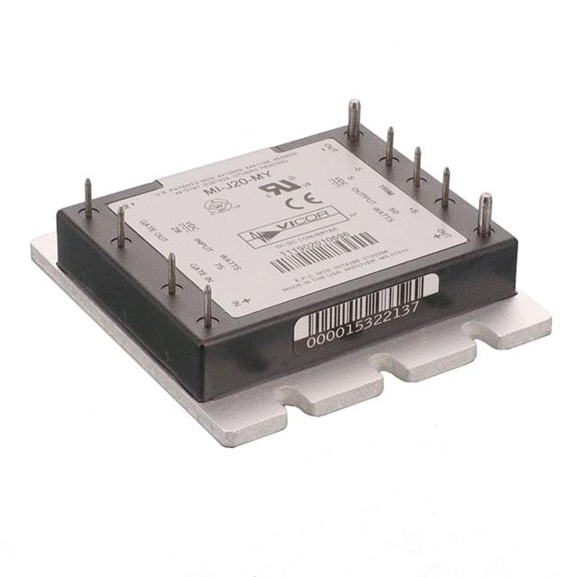

DC-DC Converters MI-J00 10 to 50 Watts Features & Benefits Packaging Options • Inputs: 28VDC per MIL-STD-704D/E/F 155VDC per MIL-STD-1399A 270VDC per MIL-STD-704D/E/F Standard: Slotted baseplate SlimMod: Flangeless baseplate, option suffix: - S Example: MI - JXX - XX - S • Single output: 2 – 48VDC FinMod: Finned heat sink, option suffix: - F1, -F2, -F3 and - F4 • Up to 23W/in3 • MIL-STD-810 environments Examples: MI - JXX - XX -F1, 0.25” fins, longitudinal MI - JXX - XX -F2, 0.50” fins, longitudinal MI - JXX - XX -F3, 0.25” fins, transverse MI - JXX - XX -F4, 0.50” fins, transverse • Up to 90% efficiency • Remote sense • Current limit • ZCS power architecture • Low noise FM control Converter Selection Chart • Size: 2.28” x 2.4” x 0.5” (57,9 x 61,0 x 12,7mm) MI-J Semi-custom modules available, consult factory. Product Highlights The MI-J00 family of DC-DC converters is designed for applications utilizing distributed power architectures. Based on Vicor’s VI‑200 / VI-J00 family of zero-current switching, component-level DC-DC converters, the MI-J00 family offers exceptional performance in terms of power density, efficiency, noise, ease of use, and reliability. The MI-J00 family meets the steady-state input voltage requirements of MIL-STD-704D/E/F for the 28VDC (MI-J2X) and 270VDC input (MI-J6X). The 155VDC input (MI-J5X) meets MIL-STD-1399A. When used with the MI-IAM input attenuator module, the 28V or 270V input MI-J00 converter meets the transient and spike requirements of MIL-STD-704, MIL STD-1275, and DO-160. Please refer to the MI-IAM data sheet for details. The output voltage can be externally trimmed or programmed from 50% to 110% of nominal output. Current limiting, remote sense, and an inhibit pin all combine to offer a high degree of protection, versatility, and reliability for power systems. Fully encapsulated in Vicor’s industry standard package, the MI-J00 family meets MIL-STD-810 environmental testing requirements for humidity, fungus, salt-fog, explosive atmosphere, acceleration, vibration, and shock. MI-J00 DC-DC Converters Page 1 of 7 Input Voltage Nominal Range Transient [a] Notes 2 = 28V 18 – 50V [b] 60V 28VDC input per MIL-STD 704D/E/F 5 = 155V 100 – 210V 6 = 270V 125 – 400V 7 = 165V 100 – 310V 230V 155VDC input per MIL-STD-1399A [c] 475V 270V DC input per MIL-STD-704D/E/F n/a [a] Transient voltage for 1 second. 16V operation at 75% load. [c] These units rated at 75% load from 125 – 150V : MI-J6Z-xY, MI-J6Y-xY, MI-J60-xY IN [b] Output Voltage ­­ Z = 2.0V 1 = 12V Y = 3.3V P = 13.8V 0 = 5.0V 2 = 15V X = 5.2V N = 18.5V W = 5.5V 3 = 24V V = 5.8V L = 28V T = 6.5V J = 36V R = 7.5V K = 40V M = 10V 4 = 48V Rev 1.4 06/2017 vicorpower.com 800 927.9474 Product Grade Temperatures (°C) Operating Storage I = –40 to +100 I = –55 to +125 M = –55 to +100 M = –65 to +125 Output Power/Current VOUT ≥5V 50 to 100 Enviornmental Qualifications Parameter Qualification Altitude MIL-STD-810D, Method 500.2, Procedure III, explosive decompression (40K ft.). Explosive Atmosphere MIL-STD-810C, Method 511.1, Procedure I MIL-STD-810D, Method 500.2, Procedure II, 40,000ft., 1000 – 1500ft./ min. to 70,000ft., unit functioning MIL-STD-810D, Method 514.3, Procedure I, category 6, helicopter, 20g Vibration MIL-STD-810D, Method 514.3 random: 10 – 300Hz @ 0.02g 2 /Hz, 2000Hz @ 0.002g 2 / Hz, 3.9 total Grms 3 h­rs/axis. Sine: 30Hz @ 20g, 60Hz @ 10g, 90Hz @ 6.6g, 120Hz @ 5.0g, 16.0 total Grms, 3 axes MIL-STD-810E, Method 514.4, Table 514.4-VII, ±6db/octave, 7.7Grms, 1hr/axis MIL-STD-810D, Method 516.3, Procedure I, functional shock, 40g Shock MIL-STD-202F, Method 213B, 18 pulses, 60g, 9ms MIL-STD-202F, Method 207A, 3 impacts / axis, 1, 3, 5 feet Acceleration MIL-STD-810D, Method 513.3, Procedure II Operational test, 9g for 1 minute along 3 mutually perpendicular axes Humidity MIL-STD-810D, Method 507.2, Procedure I, cycle I, 240hrs, 88% relative humidity Solder Test MIL-STD-202, Method 208, 8hr. aging Fungus MIL-STD-810C, Method 508.1 Salt-Fog MIL-STD-810C, Method 509.1 MI-J00 DC-DC Converters Page 4 of 7 MIL-STD-202F, Method 213B, 75g, 11ms saw tooth shock Rev 1.4 06/2017 vicorpower.com 800 927.9474 MI-J00 Basic Module Operation F1 +IN C3 C3 (µF) = C2a C1a –IN Zero Current Switching Converter +OUT –OUT C1b 400 VIN Minimum C2b Figure 1 — Basic module operation requires fusing, grounding, bypassing capacitors.* See Design Guide & Applications Manual. Storage Output Connections and Considerations The permissible load current [e] must never be exceeded during normal, abnormal or test conditions. Converters subject to dynamic loading exceeding 25% of rated current must be reviewed by Vicor Applications Engineering to ensure that the converter will operate properly. Under dynamic load, light load, or no load conditions, the converter may emit audible noise. Converters that utilize remote sense may require compensation circuitry to offset the phase lag caused by the external output leads and load impedance. Remote Sense leads must be protected for conditions such as lead reversal, noise pickup, open circuit, or excessive output lead resistance between the sense point and the converters output terminals. For applications that may draw more than the rated current, a fast acting electronic circuit breaker must be utilized to protect the converter. Under no circumstance should the rated current be exceeded. Utilizing or testing of current limit or short circuit current will damage the converter. Ensure that the total output capacitance connected to the converter does not exceed the limits on Page 4. [e] Permissible load current: Vicor products, when not installed in customer units, should be stored in ESD safe packaging in accordance with ANSI/ESD S20.20, “Protection of Electrical and Electronic Parts, Assemblies and Equipment” and should be maintained in a temperature controlled factory/warehouse environment not exposed to outside elements controlled between the temperature ranges of 15ºC and 38ºC. Humidity shall not be condensing, no minimum humidity when stored in an ESD compliant package. Nominal Power Rating MI-J00 DC-DC Converters Page 5 of 7 Nominal VOUT Rev 1.4 06/2017 vicorpower.com 800 927.9474 MI-J00 Mechanical Drawing VI-J00 Mechanical Diagram .49 (12,4) .30±.015 (7,6)±(0,38) 2.28 (57,9) 1.30 (33,0) Standard RoHS 0.080 Dia (2) places Solder plate over copper alloy .65 (16,5) 0.080 Dia (2) places Matte tin over copper alloy Pin # 2.10 (53,4) 4 9 3 8 2 VI-J00 MI-J00 7 1 .15 (3,8) .70 .40 (17,8) (10,2) 6 5 .15 (3,8) .35± .015 (8,9)±(0,38) Gate Out 4 -In 5 +Out +Sense Trim 8 –Sense 9 –Out RoHS 0.040 Dia (7) places Matte tin over copper alloy 2.40 (61,0) 1.75 (44,4) Max. .30 (7,6) Min. .22 (5,6) Min. .12 (3,0) Gate In 3 7 Product ID this surface .50 (12,7) +In 2 6 Standard 0.040 (1,0) Dia (7) places Solder plate over copper alloy FULL R 1.90 (48,3) 1.40 1.00 (35,6) (25,4) +.030 (0,76) -.000 (0) .01 Aluminum Base Note: For alternate package options refer to the mechanical drawing page of vicorpower.com MI-J00 DC-DC Converters Page 6 of 7 Function 1 Rev 1.4 06/2017 vicorpower.com 800 927.9474 MI-J00 Vicor’s comprehensive line of power solutions includes high density AC-DC and DC-DC modules and accessory components, fully configurable AC-DC and DC-DC power supplies, and complete custom power systems. Information furnished by Vicor is believed to be accurate and reliable. However, no responsibility is assumed by Vicor for its use. Vicor makes no representations or warranties with respect to the accuracy or completeness of the contents of this publication. Vicor reserves the right to make changes to any products, specifications, and product descriptions at any time without notice. Information published by Vicor has been checked and is believed to be accurate at the time it was printed; however, Vicor assumes no responsibility for inaccuracies. Testing and other quality controls are used to the extent Vicor deems necessary to support Vicor’s product warranty. Except where mandated by government requirements, testing of all parameters of each product is not necessarily performed. Specifications are subject to change without notice. Visit http://www.vicorpower.com/vi-200_vi-j00 for the latest product information. Vicor’s Standard Terms and Conditions and Product Warranty All sales are subject to Vicor’s Standard Terms and Conditions of Sale, and Product Warranty which are available on Vicor’s webpage (http://www.vicorpower.com/termsconditionswarranty) or upon request. Life Support Policy VICOR’S PRODUCTS ARE NOT AUTHORIZED FOR USE AS CRITICAL COMPONENTS IN LIFE SUPPORT DEVICES OR SYSTEMS WITHOUT THE EXPRESS PRIOR WRITTEN APPROVAL OF THE CHIEF EXECUTIVE OFFICER AND GENERAL COUNSEL OF VICOR CORPORATION. As used herein, life support devices or systems are devices which (a) are intended for surgical implant into the body, or (b) support or sustain life and whose failure to perform when properly used in accordance with instructions for use provided in the labeling can be reasonably expected to result in a significant injury to the user. A critical component is any component in a life support device or system whose failure to perform can be reasonably expected to cause the failure of the life support device or system or to affect its safety or effectiveness. Per Vicor Terms and Conditions of Sale, the user of Vicor products and components in life support applications assumes all risks of such use and indemnifies Vicor against all liability and damages. Intellectual Property Notice Vicor and its subsidiaries own Intellectual Property (including issued U.S. and Foreign Patents and pending patent applications) relating to the products described in this data sheet. No license, whether express, implied, or arising by estoppel or otherwise, to any intellectual property rights is granted by this document. Interested parties should contact Vicor’s Intellectual Property Department. Vicor Corporation 25 Frontage Road Andover, MA, USA 01810 Tel: 800-735-6200 Fax: 978-475-6715 email Customer Service: custserv@vicorpower.com Technical Support: apps@vicorpower.com MI-J00 DC-DC Converters Page 7 of 7 Rev 1.4 06/2017 vicorpower.com 800 927.9474
MI-J20-MY
物料型号:VICOR MI-J00系列
器件简介: - 该系列DC-DC转换器适用于分布式电源架构,基于Vicor的零电流开关、组件级DC-DC转换器。 - 提供卓越的功率密度、效率、噪声、易用性和可靠性。
引脚分配: - 输入电压引脚:+In - 输出电压引脚:+Out - 远程感应引脚:+Sense 和 –Sense - 调节引脚:Trim - 门控输入和输出:Gate In 和 Gate Out
参数特性: - 输入电压范围:28VDC、155VDC、270VDC,符合MIL-STD-704D/E/F和MIL-STD-1399A标准。 - 单一输出电压:2-48VDC。 - 功率密度高达23W/in³。 - 效率高达90%。 - 封装尺寸:2.28” x 2.4” x 0.5” (57.9 x 61.0 x 12.7mm)。
功能详解: - 支持外部调节或编程输出电压,从标称输出的50%至110%。 - 具备电流限制、远程感应和抑制引脚,提供高保护、多功能性和可靠性。 - 完全封装,满足MIL-STD-810环境测试要求。
应用信息: - 适用于需要高功率密度和高效率的军事和航空应用。 - 可与MI-IAM输入衰减模块一起使用,以满足MIL-STD-704、MIL-STD-1275和DO-160的瞬态和尖峰要求。
封装信息: - 标准封装:带槽底板。 - SlimMod封装:无凸缘底板,后缀-S。 - FinMod封装:带散热片,后缀-F1、-F2、-F3和-F4。
