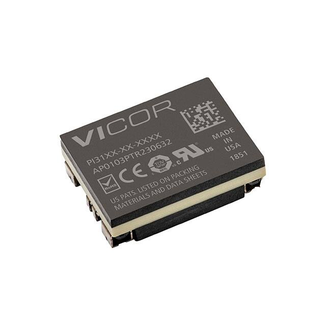

ZVS Regulators PI352x-00 30 – 60VIN ZVS Buck Regulator Product Description Features & Benefits The PI352x-00 is a family of high input voltage, wide‑input‑range DC-DC ZVS Buck regulators integrating controller, power switches and support components all within a high‑density System‑in‑Package (SiP). • High‑Efficiency HV ZVS Buck Topology The integration of a high-performance Zero-Voltage Switching (ZVS) topology, within the PI352x-00 series, increases point‑of‑load performance providing best‑in‑class power efficiency. The PI352x-00 requires only an external inductor, two voltage selection resistors and minimal capacitors to form a complete DC‑DC switch‑mode buck regulator. • Parallel‑capable with single‑wire current sharing • Wide input voltage range of 30 – 60V • Power-up into pre-biased load ≤ 6.0V • Input Over/Undervoltage Lockout (OVLO/UVLO) • Output Overvoltage Protection (OVP) • Overtemperature Protection (OTP) • Fast and slow current limits Device Output Voltage IOUT Max Set Range PI3523-00 3.3V 2.2 – 4V 22A PI3525-00 5.0V 4.0 – 6.5V 20A PI3526-00 12V 6.5 – 14V 18A • Differential amplifier for output remote sensing • User adjustable soft start & tracking • –40 to 120°C operating range (TINT) Applications • HV to PoL Buck Regulator Applications • Computing, Communications, Industrial, Automotive Equipment Package Information • 10 x 14 x 2.56mm LGA SiP ZVS Regulators Page 1 of 41 Rev 2.1 10/2021 PI352x-00 Contents Thermal, Storage and Handling Information 3 SiP Power Dissipation as Percentage of Total System Losses 33 Absolute Maximum Ratings 3 Application Description 34 Functional Block Diagram 4 Output Voltage Set Point 34 Pin Description 5 Soft Start Adjust and Tracking 34 Package Pinout 6 Inductor Pairing 35 PI352x-00 Common Electrical Characteristics 7 Parallel Operation 35 PI3523-00 (3.3VOUT ) Electrical Characteristics 8 Filter Considerations 35 PI3525-00 (5.0VOUT ) Electrical Characteristics 15 VDR Bias Regulator 36 PI3526-00 (12VOUT ) Electrical Characteristics 22 Layout Guidelines 37 Functional Description 29 LGA Recommended PCB Footprint and Stencil 38 ENABLE (EN) 29 LGA Package Drawings 39 Remote Sensing 29 Revision History 40 Soft Start 29 Warranty 41 Output Voltage Selection 29 Output Current Limit Protection 29 Input Undervoltage Lockout 29 Input Overvoltage Lockout 30 Output Overvoltage Protection 30 Overtemperature Protection 30 Pulse Skip Mode (PSM) 30 Variable Frequency Operation 30 Thermal Characteristics 30 ZVS Regulators Page 2 of 41 Rev 2.1 10/2021 PI352x-00 Order Information Product Nominal Output Rated IOUT Package PI3523-00-LGIZ 3.3V 22A 10 x 14mm LGA 5.0V 20A 12V 18A PI3525-00-LGIZ PI3525-00-LGIG PI3526-00-LGIZ 10 x 14mm LGA 10 x 14mm LGA halogen free Transport Media TRAY 10 x 14mm LGA Thermal, Storage and Handling Information Name Rating Storage Temperature –65 to 150°C Internal Operating Temperature –40 to 120°C Soldering Temperature for 20 seconds 245°C MSL Rating 3 ESD Rating, JESD22-A114F, JS-002-2014 2kV HBM; 1kV CDM, respectively Absolute Maximum Ratings Name Rating VIN –0.7 to 75V VS1 –0.7VDC to 75V VOUT –0.5 to 25V SGND ±100mA TRK –0.3 to 5.5V, ±30mA VDR, SYNCI, SYNCO, PWRGD, EN, COMP, EAO, EAIN, VDIFF, VSN, VSP, TESTx –0.3 to 5.5V, ±5mA Notes: Stresses beyond these limits may cause permanent damage to the device. Operation at these conditions or conditions beyond those listed in the Electrical Specifications table is not guaranteed. All voltages are referenced to PGND unless otherwise noted. ZVS Regulators Page 3 of 41 Rev 2.1 10/2021 PI352x-00 Functional Block Diagram VS1 VIN Q2 Q1 VDR Power Control SYNCO SYNCI PWRGD EN TESTx VOUT + – VSP VSN VDIFF VCC ZVS Control – + EAIN CEAIN-INT VREF EAO Digital Parametric Trim RZI CHF COMP TRK PGND 0Ω SGND Simplified block diagram ZVS Regulators Page 4 of 41 Rev 2.1 10/2021 PI352x-00 Pin Description Name Location I/O Description VS1 Block 1 Power Switching Node: and ZVS sense for power switches. VIN Block 3 Power Input Voltage: and sense for UVLO, OVLO and feed forward ramp. VDR 5K I/O Gate Driver VCC: Internally generated 5.1V. May be used as a bias supply for low power external loads. See Application Description for important considerations. SYNCI 4K I Synchronization Input: Synchronize to the falling edge of external clock frequency. SYNCI is a high impedance digital input node and should always be connected to SGND when not in use. The PI352x-00 family is not optimized for external synchronization functionality. Refer to Application Description of Parallel Operation for details. SYNCO 3K O Synchronization Output: Outputs a high signal at the start of each clock cycle for the longer of ½ of the minimum period or the on time of the high side power MOSFET. TEST1 2K I/O Test Connections: Use only with factory guidance. Connect to SGND for proper operation. TEST2 1K I/O Test Connections: Use only with factory guidance. Connect to SGND for proper operation. TEST3 1J I/O Test Connections: Use only with factory guidance. Connect to SGND for proper operation. TEST4 1H I/O Test Connections: Use only with factory guidance. Connect to SGND for proper operation. TEST5 1E I/O Test Connections: Use only with factory guidance. Connect to SGND for proper operation. PWRGD 1G O Power Good: High impedance when regulator is operating and VOUT is in regulation. Otherwise pulls to SGND. EN 1F I/O Enable Input: Regulator enable control. When asserted active or left floating: regulator is enabled. Otherwise regulator is disabled. SGND Block 5 TRK 1C I Soft-Start and Track Input: An external capacitor may be connected between TRK pin and SGND to increase the rise time of the internal reference during soft start. COMP 1B O Compensation Capacitor: Connect capacitor for control loop dominant pole. See Error Amplifier section for details. A default CCOMP of 4.7nF is used in the example. EAO 1A O Error amp output: External connection for additional compensation and current sharing. EAIN 2A I Error Amp Inverting Input: Connection for the main VOUT feedback divider tap. VDIFF 3A O Independent Amplifier Output: Active only when module is enabled. VSN 4A I Independent Amplifier Inverting Input: If unused connect in unity gain. VSP 5A I Independent Amplifier Non-Inverting Input: If unused connect to SGND. VOUT 6A,B Power Direct VOUT Connect: for per-cycle internal clamp node and feed-forward ramp. PGND Block2 Power Power Ground: VIN and VOUT power returns. ZVS Regulators Page 5 of 41 Signal Ground: Internal logic ground for EA, TRK, SYNCI, SYNCO communication returns. SGND and PGND are star connected within the regulator package. Rev 2.1 10/2021 PI352x-00 Package Pinout 1 EA0 COMP TRK SGND TEST5 EN PWRG0 TEST4 TEST3 TEST2 2 EAIN SGND SGND SGND SGND PGND PGND PGND PGND TEST1 3 VDIFF SGND SGND SGND SGND PGND PGND PGND PGND SYNC0 4 VSN SGND PGND PGND PGND PGND PGND PGND PGND SYNC1 5 VSP PGND PGND PGND PGND PGND PGND PGND PGND VDR 6 VOUT VOUT PGND PGND PGND PGND PGND PGND PGND PGND 8 VIN VIN VIN VIN VIN VIN VIN VIN VIN VIN 9 VIN VIN VIN VIN VIN VIN VIN VIN VIN VIN 10 VIN VIN VIN VIN VIN VIN VIN VIN VIN VIN PGND PGND PGND PGND PGND PGND PGND PGND PGND PGND VS1 VS1 VS1 VS1 VS1 VS1 VS1 VS1 VS1 VS1 7 11 12 13 14 Pin Block Name Group of pins VIN A8-10, B8-10, C8-10, D8-10, E8-10, F8-10, G8-10, H8-10, J8-10, K8-10 VS1 A14, B14, C14, D14, E14, F14, G14, H14, J14, K14 PGND A12, B12, C12, D12, E12, F12, G12, H12, J12, K12 PGND B5, C4-6, D4-6, E4-6, F2-6, G2-6, H2-6, J2-6, K6 VOUT A6, B6 SGND B2-4, C2-3, D1-3, E2-3 ZVS Regulators Page 6 of 41 Rev 2.1 10/2021 PI352x-00 PI352x-00 Common Electrical Characteristics Specifications apply for –40°C < TINT < 120°C, VIN = 48V, EN = High, unless otherwise noted. Parameter Symbol Conditions Min Typ Max Unit Open Loop Gain 96 120 140 dB Small Signal Gain-bandwidth 5 7 12 MHz 0.5 1 mV 2.5 V Differential Amp Input Offset Common Mode Input Range –0.1 Differential Mode Input Range 2 V Input Bias Current –1 1 µA Output Current –1 1 mA Maximum VOUT IVDIFF = –1mA Minimum VOUT IVDIFF = –1mA 4.85 Capacitive Load Range for Stability V 0 Slew Rate 20 mV 50 pF 11 V/µs PWRGD VOUT Rising Threshold VPG_HI% 78 84 90 % VOUT_DC VOUT Falling Threshold VPG_LO% 75 81 87 % VOUT_DC PWRGD Output Low VPG_SAT 0.4 V Sink = 4mA VDR Voltage Set Point VVDR VIN_DC > 10V External Loading IVDR See Application Description for details 4.9 5.05 0 5.2 V 2 mA Enable High Threshold VEN_HI 0.9 1.0 1.1 V Low Threshold VEN_LO 0.7 0.8 0.9 V Threshold Hysteresis VEN_HYS 100 200 300 mV Pull-Up Voltage Level for Source Current VEN_PU Pull-Up Current IEN_PU_POS 2 V 50 µA MIL-HDBK-217, 25°C, Ground Benign: GB 12.6 MHrs Telcordia SR-332, 25°C, Ground Benign: GB 96.9 MHrs VIN > 8V, excluding tFR_DLY Reliability MTBF [a] All parameters reflect regulator and inductor system performance. Measurements were made using a standard PI352x-00 evaluation board with 3 x 3" dimensions and 4 layer, 2oz copper. Refer to inductor pairing table within Application Description section for specific inductor manufacturer and value. [b] Regulator is assured to meet performance specifications by design, test correlation, characterization, and/or statistical process control. Output voltage is determined by an external feedback divider ratio. [c] Output current capability may be limited and other performance may vary from noted electrical characteristics when V OUT is not set to nominal. [d] Refer to Output Ripple plots. [e] Refer to Load Current vs. Ambient Temperature curves. [f] Refer to Switching Frequency vs. Load current curves. ZVS Regulators Page 7 of 41 Rev 2.1 10/2021 PI352x-00 PI3523-00 (3.3VOUT) Electrical Characteristics Specifications apply for –40°C < TINT < 120°C, VIN = 48V, EN = High, unless otherwise noted. Parameter Symbol Conditions Min Typ Max Unit 30 48 60 V Input Specifications Input Voltage VIN_DC Input Current IIN_DC Input Current At Output Short (fault condition duty cycle) IIN_Short VIN = 48V, TCASE = 25°C, IOUT = 22A 1.69 A Short at terminals 4.7 mA Input Quiescent Current IQ_VIN Disabled 0.75 Input Quiescent Current IQ_VIN Enabled, no load, TCASE = 25°C 1.8 Effective value VIN = 48V, 25°C 0.50 Input Voltage Slew Rate VIN_SR Input capacitance, Internal CIN_INT 1.2 mA mA 1 V/µs µF Output Specifications EAIN Voltage Total Regulation Output Voltage Trim Range VEAIN VOUT_DC [b] 0.975 [b] [c] 2.2 Line Regulation ΔVOUT / ΔVIN Load Regulation ΔVOUT / ΔIOUT At 25°C, 2A < IOUT < 22A Output Voltage Ripple At 25°C, 30V < VIN < 60V [d] VOUT_AC IOUT = 20A, COUT = 8 x 100µF, 20MHz BW Output Current IOUT_DC [e] Current Limit IOUT_CL Typical current limit based on nominal 230nH inductor. Maximum Array Size Output Current, array of 2 Output Current, array of 3 NPARALLEL 0.990 1.005 3.3 4.0 % 0.10 % 76 mVp-p 22 25.3 [b] IOUT_DC_ARRAY2 Total array capability, IOUT_DC_ARRAY3 Total array capability, [b] see applications section for details see applications section for details V 0.10 0 [b] V A A 3 Modules 0 [g] A 0 [g] A 27.0 29.1 V 2.08 2.50 V Protection Input UVLO Start Threshold VUVLO_START Input UVLO Stop Hysteresis VUVLO_HYS 1.66 1.25 µs Input OVLO Stop Threshold VOVLO 62 64.3 V Input OVLO Start Hysteresis VOVLO_HYS 0.90 1.17 Input OVLO Response Time tf Input UVLO Response Time Output Overvoltage Protection, Relative VOVP_REL Output Overvoltage Protection, Absolute VOVP_ABS Hysteresis active when OVLO present for at least tFR_DLY Above set VOUT 4.5 [a] 1.60 V 1.25 µs 20 % 5.2 V All parameters reflect regulator and inductor system performance. Measurements were made using a standard PI352x-00 evaluation board with 3 x 3" dimensions and 4 layer, 2oz copper. Refer to inductor pairing table within Application Description section for specific inductor manufacturer and value. [b] Regulator is assured to meet performance specifications by design, test correlation, characterization, and/or statistical process control. Output voltage is determined by an external feedback divider ratio. [c] Output current capability may be limited and other performance may vary from noted electrical characteristics when V OUT is not set to nominal. [d] Refer to Output Ripple plots. [e] Refer to Load Current vs. Ambient Temperature curves. [f] Refer to Switching Frequency vs. Load current curves. [g] Contact factory applications for array derating and layout best practices to minimize sharing errors. ZVS Regulators Page 8 of 41 Rev 2.1 10/2021 PI352x-00 PI3523-00 (3.3VOUT) Electrical Characteristics (Cont.) Specifications apply for –40°C < TINT < 120°C, VIN = 48V, EN = High, unless otherwise noted. Parameter Symbol Conditions Min Typ Max Unit 470 500 530 kHz Timing Switching Frequency Fault Restart Delay fs [f] While in Discontinuous Conduction Mode (DCM) only, SYNCI grounded tFR_DLY 30 ms Synchronization Input (SYNCI) Synchronization Frequency Range fSYNCI SYNCI Threshold VSYNCI –50% and +10% relative to set switching frequency (fS), while in DCM operating mode only. [c] [f] 250 550 2.5 kHz V Synchronization Output (SYNCO) SYNCO High VSYNCO_HI Source 1mA SYNCO Low VSYNCO_LO Sink 1mA 4.5 V SYNCO Rise Time tSYNCO_RT 20pF load 10 ns SYNCO Fall Time tSYNCO_FT 20pF load 10 ns 0.5 V Soft Start, Tracking and Error Amplifier TRK Active Range (Nominal) VTRK 0 1.4 V TRK Enable Threshold VTRK_OV 20 40 60 mV TRK to EAIN Offset VEAIN_OV 40 80 120 mV ITRK 30 50 70 µA Charge Current (Soft Start) Discharge Current (Fault) ITRK_DIS TRK Capacitance, Internal CTRK_INT Soft-Start Time tSS VTRK = 0.5V 8.7 mA 47 CTRK_EXT = 0µF 0.6 0.94 nF 1.6 ms Error Amplifier Trans-Conductance GMEAO [b] 5.1 mS PSM Skip Threshold PSMSKIP [b] 0.6 V EAIN Capacitance, Internal CEAIN_INT 56 pF Error Amplifier Output Impedance ROUT [b] Internal Compensation Capacitor CHF [b] 56 pf RZI [b] 6 kΩ Internal Compensation Resistor 1 [a] MΩ All parameters reflect regulator and inductor system performance. Measurements were made using a standard PI352x-00 evaluation board with 3 x 3" dimensions and 4 layer, 2oz copper. Refer to inductor pairing table within Application Description section for specific inductor manufacturer and value. [b] Regulator is assured to meet performance specifications by design, test correlation, characterization, and/or statistical process control. Output voltage is determined by an external feedback divider ratio. [c] Output current capability may be limited and other performance may vary from noted electrical characteristics when V OUT is not set to nominal. [d] Refer to Output Ripple plots. [e] Refer to Load Current vs. Ambient Temperature curves. [f] Refer to Switching Frequency vs. Load current curves. [g] Contact factory applications for array derating and layout best practices to minimize sharing errors. ZVS Regulators Page 9 of 41 Rev 2.1 10/2021 PI352x-00 94 93 92 91 90 89 88 87 86 85 84 83 82 9 8 Power Dissipation (W) Efficiency (%) PI3523-00 (3.3VOUT) Electrical Characteristics (Cont.) 2 4 6 8 10 12 14 16 18 20 7 6 5 4 3 2 1 0 22 2 4 6 8 Load Current (A) VIN: 48V 30V 60V VIN: 93 8 91 7 89 87 85 83 81 79 16 48V 30V 18 20 22 20 22 20 22 60V 6 5 4 3 2 1 4 6 8 10 12 14 16 18 20 2 22 4 6 8 48V 30V 10 12 14 16 18 Load Current (A) Load Current (A) VIN: 60V Figure 2 — System efficiency, low trim, board temperature = 25°C 48V 30V 60V Figure 5 — System power dissipation, low trim, board temperature = 25°C 10 94 Power Dissipation (W) 92 Efficiency (%) 14 0 2 VIN: 90 88 86 84 82 80 12 Figure 4 — System power dissipation, nominal trim, board temperature = 25°C Power Dissipation (W) Efficiency (%) Figure 1 — System efficiency, nominal trim, board temperature = 25°C 77 10 Load Current (A) 2 4 6 8 10 12 14 16 18 20 8 6 4 2 0 22 2 4 6 30V Figure 3 — System efficiency, high trim, board temperature = 25°C 48V 10 12 14 16 18 Load Current (A) Load Current (A) VIN: 8 VIN: 60V 30V 48V Figure 6 — System power dissipation, high trim, board temperature = 25°C ZVS Regulators Rev 2.1 Page 10 of 41 10/2021 60V PI352x-00 PI3523-00 (3.3VOUT) Electrical Characteristics (Cont.) 12 Power Dissipation (W) 92 Efficiency (%) 90 88 86 84 82 80 78 2 4 6 8 10 12 14 16 18 20 10 8 6 4 2 0 22 2 4 6 8 Load Current (A) VIN: 60V VIN: Figure 7 — System efficiency, nominal trim, board temperature = 100°C 16 18 20 22 48V 30V 20 22 20 22 60V 10 Power Dissipation (W) 89 Efficiency (%) 14 Figure 10 — System power dissipation, nominal trim, board temperature = 100°C 91 87 85 83 81 79 77 2 4 6 8 10 12 14 16 18 20 9 8 7 6 5 4 3 2 1 0 22 2 4 6 8 Load Current (A) VIN: 10 12 14 16 18 Load Current (A) 48V 30V 60V VIN: Figure 8 — System efficiency, low trim, board temperature = 100°C 48V 30V 60V Figure 11 — System power dissipation, low trim, board temperature = 100°C 12 94 Power Dissipation (W) 92 Efficiency (%) 12 Load Current (A) 48V 30V 10 90 88 86 84 82 80 10 8 6 4 2 0 78 2 4 6 8 10 12 14 16 18 20 22 2 4 6 Load Current (A) VIN: 30V Figure 9 — System efficiency, high trim, board temperature = 100°C 48V 8 10 12 14 16 18 Load Current (A) VIN: 60V 30V 48V Figure 12 — System power dissipation, high trim, board temperature = 100°C ZVS Regulators Rev 2.1 Page 11 of 41 10/2021 60V PI352x-00 94 8 92 7 Power Dissipation (W) Efficiency (%) PI3523-00 (3.3VOUT) Electrical Characteristics (Cont.) 90 88 86 84 82 6 5 4 3 2 1 0 80 2 4 6 8 10 12 14 16 18 20 2 22 4 6 8 Load Current (A) VIN: 48V 30V VIN: 60V Figure 13 — System efficiency, nominal trim, board temperature = –40°C 14 16 18 20 22 48V 30V 20 22 20 22 60V 6 Power Dissipation (W) Efficiency (%) 12 Figure 16 — System power dissipation, nominal trim, board temperature = –40°C 92 90 88 86 84 82 80 2 4 6 8 10 12 14 16 18 20 5 4 3 2 1 0 22 2 4 6 8 VIN: 48V 30V 10 12 14 16 18 Load Current (A) Load Current (A) VIN: 60V Figure 14 — System efficiency, low trim, board temperature = –40°C 48V 30V 60V Figure 17 — System power dissipation, low trim, board temperature = –40°C 8 Power Dissipation (W) 94 92 Efficiency (%) 10 Load Current (A) 90 88 86 84 82 80 2 4 6 8 10 12 14 16 18 20 7 6 5 4 3 2 1 0 22 2 4 6 Load Current (A) VIN: 30V 48V Figure 15 — System efficiency, high trim, board temperature = –40°C 8 10 12 14 16 18 Load Current (A) 60V VIN: 30V 48V Figure 18 — System power dissipation, high trim, board temperature = –40°C ZVS Regulators Rev 2.1 Page 12 of 41 10/2021 60V PI352x-00 PI3523-00 (3.3VOUT) Electrical Characteristics (Cont.) Figure 19 — Transient response: 50% to 100% load, at 1A/µs. Nominal line, nominal trim, COUT = 8 x 100µF ceramic Figure 22 — Output short circuit, nominal line Figure 20 — Output voltage ripple: nominal line, nominal trim, 100% load, COUT = 8 x 100µF ceramic Figure 23 — Output voltage ripple: nominal line, nominal trim, 50% load, COUT = 8 x 100µF ceramic Maximum Output Current (A) 600 Frequency (kHz) 500 400 300 200 100 0 1.1 3.3 5.5 7.7 9.9 12.1 14.3 16.5 18.7 20.9 Load Current (A) 30VIN 48VIN 20 15 Notes: 1. SiP is based on VS1 and VIN paths only. 2. Inductor is based on two leads and base with inclusion of GEL 30 interface resistance (0.15mm thick; 3.5W/m-K thermal conductivity). 10 5 0 0 20 40 60 80 100 120 140 Temperature of Isothermal PCB (ºC) 60VIN Figure 21 — Switching frequency vs. load, nominal trim 25 Figure 24 — System thermal specified operating area: Max IOUT at nominal trim vs. temperature at locations noted ZVS Regulators Rev 2.1 Page 13 of 41 10/2021 PI352x-00 PI3523-00 (3.3VOUT) Electrical Characteristics (Cont.) Output Current (A) 25 20 15 10 5 0 0.8 1 1.2 1.4 1.6 1.8 2 2.2 2.4 VEAO (V) 30VIN 48VIN 60VIN Figure 25 — Output current vs. VEAO, nominal trim Figure 28 — Start up from VIN applied, nominal line, nominal trim, typical timing, PI3523 18 16 GMOD (S) 14 12 10 8 6 4 2 0 0.6 0.9 1.2 1.5 1.8 2.1 2.4 VEAO (V) 30VIN 48VIN 60VIN rEQ_OUT (Ω) Figure 26 — Small signal modulator gain vs. VEAO, nominal trim 20 18 16 14 12 10 8 6 4 2 0 -2 0.6 0.9 1.2 1.5 1.8 2.1 Figure 29 — Start up from EN, VIN pre-applied, nominal line, nominal trim, typical timing, PI3523 2.4 VEAO (V) 30VIN 48VIN 60VIN Figure 27 — rEQ_OUT vs VEAO, nominal trim ZVS Regulators Rev 2.1 Page 14 of 41 10/2021 PI352x-00 PI3525-00 (5.0VOUT) Electrical Characteristics Specifications apply for –40°C < TINT < 120°C, VIN = 48V, EN = High, unless otherwise noted. Parameter Symbol Conditions Min Typ Max Unit 30 48 60 V Input Specifications Input Voltage VIN_DC Input Current IIN_DC Input Current At Output Short (fault condition duty cycle) IIN_Short VIN = 48V, TCASE = 25°C, IOUT = 20A 2.28 A Short at terminals 2.3 mA Input Quiescent Current IQ_VIN Disabled 0.75 Input Quiescent Current IQ_VIN Enabled, no load, TCASE = 25°C 2.5 Effective value VIN = 48V, 25°C 0.50 Input Voltage Slew Rate VIN_SR Input capacitance, Internal CIN_INT 1.2 mA mA 1 V/µs µF Output Specifications EAIN Voltage Total Regulation Output Voltage Trim Range VEAIN VOUT_DC [b] 0.975 [b] [c] 4.0 Line Regulation ΔVOUT / ΔVIN Load Regulation ΔVOUT / ΔIOUT At 25°C, 2A < IOUT < 20A Output Voltage Ripple At 25°C, 30V < VIN < 60V [d] VOUT_AC IOUT = 20A, COUT = 12 x 47µF, 20MHz BW Output Current IOUT_DC [e] Current Limit IOUT_CL Typical current limit based on nominal 230nH inductor. Maximum Array Size Output Current, array of 2 Output Current, array of 3 NPARALLEL 0.990 1.005 5.0 6.5 % 0.10 % 75 mVp-p 20 23 [b] IOUT_DC_ARRAY2 Total array capability, IOUT_DC_ARRAY3 Total array capability, [b] see applications section for details see applications section for details V 0.10 0 [b] V A A 3 Modules 0 [g] A 0 [g] A 27.0 29.1 V 2.08 2.50 V Protection Input UVLO Start Threshold VUVLO_START Input UVLO Stop Hysteresis VUVLO_HYS 1.66 1.25 µs Input OVLO Stop Threshold VOVLO 62 64.3 V Input OVLO Start Hysteresis VOVLO_HYS 0.90 1.17 Input OVLO Response Time tf Input UVLO Response Time Output Overvoltage Protection, Relative VOVP_REL Output Overvoltage Protection, Absolute VOVP_ABS Hysteresis active when OVLO present for at least tFR_DLY Above set VOUT [a] 6.7 1.60 V 1.25 µs 20 % 7.5 V All parameters reflect regulator and inductor system performance. Measurements were made using a standard PI352x-00 evaluation board with 3 x 3" dimensions and 4 layer, 2oz copper. Refer to inductor pairing table within Application Description section for specific inductor manufacturer and value. [b] Regulator is assured to meet performance specifications by design, test correlation, characterization, and/or statistical process control. Output voltage is determined by an external feedback divider ratio. [c] Output current capability may be limited and other performance may vary from noted electrical characteristics when V OUT is not set to nominal. [d] Refer to Output Ripple plots. [e] Refer to Load Current vs. Ambient Temperature curves. [f] Refer to Switching Frequency vs. Load current curves. [g] Contact factory applications for array derating and layout best practices to minimize sharing errors. ZVS Regulators Rev 2.1 Page 15 of 41 10/2021 PI352x-00 PI3525-00 (5.0VOUT) Electrical Characteristics (Cont.) Specifications apply for –40°C < TINT < 120°C, VIN = 48V, EN = High, unless otherwise noted. Parameter Symbol Conditions Min Typ Max Unit 564 600 636 kHz Timing Switching Frequency Fault Restart Delay fs [f] While in Discontinuous Conduction Mode (DCM) only, SYNCI grounded tFR_DLY 30 ms Synchronization Input (SYNCI) Synchronization Frequency Range fSYNCI SYNCI Threshold VSYNCI –50% and +10% relative to set switching frequency (fS), while in DCM operating mode only. [c] [f] 300 660 2.5 kHz V Synchronization Output (SYNCO) SYNCO High VSYNCO_HI Source 1mA 4.5 V SYNCO Low VSYNCO_LO Sink 1mA SYNCO Rise Time tSYNCO_RT 20pF load 10 ns SYNCO Fall Time tSYNCO_FT 20pF load 10 ns 0.5 V Soft Start, Tracking and Error Amplifier TRK Active Range (Nominal) VTRK 0 TRK Enable Threshold VTRK_OV 20 TRK to EAIN Offset VEAIN_OV ITRK Charge Current (Soft Start) Discharge Current (Fault) ITRK_DIS TRK Capacitance, Internal CTRK_INT Soft-Start Time tSS 1.4 V 40 60 mV 40 80 120 mV 30 50 70 µA VTRK = 0.5V CTRK_EXT = 0µF Error Amplifier Trans-Conductance GMEAO [b] PSM Skip Threshold PSMSKIP [b] EAIN Capacitance, Internal CEAIN_INT 0.6 8.7 mA 47 nF 0.94 1.6 ms 7.6 mS 0.8 V 56 pF Error Amplifier Output Impedance ROUT [b] Internal Compensation Capacitor CHF [b] 56 pf RZI [b] 5 kΩ Internal Compensation Resistor [a] 1 MΩ All parameters reflect regulator and inductor system performance. Measurements were made using a standard PI352x-00 evaluation board with 3 x 3" dimensions and 4 layer, 2oz copper. Refer to inductor pairing table within Application Description section for specific inductor manufacturer and value. [b] Regulator is assured to meet performance specifications by design, test correlation, characterization, and/or statistical process control. Output voltage is determined by an external feedback divider ratio. [c] Output current capability may be limited and other performance may vary from noted electrical characteristics when V OUT is not set to nominal. [d] Refer to Output Ripple plots. [e] Refer to Load Current vs. Ambient Temperature curves. [f] Refer to Switching Frequency vs. Load current curves. [g] Contact factory applications for array derating and layout best practices to minimize sharing errors. ZVS Regulators Rev 2.1 Page 16 of 41 10/2021 PI352x-00 96 95 94 93 92 91 90 89 88 87 86 85 Power Dissipation (W) Efficiency (%) PI3525-00 (5VOUT) Electrical Characteristics (Cont.) 2 4 6 8 10 12 14 16 18 12 11 10 9 8 7 6 5 4 3 2 1 2 20 4 6 VIN: 30V 48V VIN: 60V 2 4 6 8 10 12 14 30V 48V 16 18 2 20 4 4 6 8 10 12 6 30V 48V Efficiency (%) Figure 32 — System efficiency, high trim, board temperature = 25°C 16 18 20 48V 18 20 18 20 60V 8 10 12 14 16 48V 30V 60V Figure 34 — System power dissipation, low trim, board temperature = 25°C 14 16 18 20 12 11 10 9 8 7 6 5 4 3 2 1 2 4 6 8 10 12 14 16 Load Current (A) Load Current (A) VIN: 30V VIN: 60V Power Dissipation (W) 2 14 Load Current (A) Figure 31 — System efficiency, low trim, board temperature = 25°C 96 95 94 93 92 91 90 89 88 87 86 85 12 12 11 10 9 8 7 6 5 4 3 2 1 Load Current (A) VIN: 10 Figure 33 — System power dissipation, nominal trim, board temperature = 25°C Power Dissipation (W) Efficiency (%) Figure 30 — System efficiency, nominal trim, board temperature = 25°C 96 95 94 93 92 91 90 89 88 87 86 85 8 Load Current (A) Load Current (A) VIN: 60V 30V 48V Figure 35 — System power dissipation, high trim, board temperature = 25°C ZVS Regulators Rev 2.1 Page 17 of 41 10/2021 60V PI352x-00 96 95 94 93 92 91 90 89 88 87 86 85 Power Dissipation (W) Efficiency (%) PI3525-00 (5VOUT) Electrical Characteristics (Cont.) 2 4 6 8 10 12 14 16 18 12 11 10 9 8 7 6 5 4 3 2 1 20 2 4 6 Load Current (A) VIN: 48V 30V 4 6 8 10 12 14 48V 30V 16 18 20 2 4 4 6 8 10 12 6 30V 14 48V Efficiency (%) Efficiency (%) Figure 38 — System efficiency, high trim, board temperature = 90°C 20 18 20 18 20 60V 8 10 12 14 16 48V 30V 60V Figure 40 — System power dissipation, low trim, board temperature = 90°C 16 18 20 12 11 10 9 8 7 6 5 4 3 2 1 2 4 6 Load Current (A) VIN: 18 Load Current (A) Power Dissipation (W) 2 16 48V 30V VIN: 60V Figure 37 — System efficiency, low trim, board temperature = 90°C 96 95 94 93 92 91 90 89 88 87 86 85 14 12 11 10 9 8 7 6 5 4 3 2 1 Load Current (A) VIN: 12 Figure 39 — System power dissipation, nominal trim, board temperature = 90°C Power Dissipation (W) 2 10 Load Current (A) VIN: 60V Figure 36 — System efficiency, nominal trim, board temperature = 90°C 96 95 94 93 92 91 90 89 88 87 86 85 8 8 10 12 14 16 Load Current (A) VIN: 60V 30V 48V Figure 41 — System power dissipation, high trim, board temperature = 90°C ZVS Regulators Rev 2.1 Page 18 of 41 10/2021 60V PI352x-00 96 95 94 93 92 91 90 89 88 87 86 85 Power Dissipation (W) Efficiency (%) PI3525-00 (5VOUT) Electrical Characteristics (Cont.) 2 4 6 8 10 12 14 16 18 12 11 10 9 8 7 6 5 4 3 2 1 20 2 4 6 Load Current (A) VIN: 30V 48V VIN: 4 6 8 10 12 14 30V 48V 16 18 20 2 4 4 6 8 10 12 6 30V 48V Efficiency (%) Efficiency (%) Figure 44 — System efficiency, high trim, board temperature = –40°C 18 20 48V 18 20 18 20 60V 8 10 12 14 16 30V 48V 60V Figure 46 — System power dissipation, low trim, board temperature = –40°C 14 16 18 20 12 11 10 9 8 7 6 5 4 3 2 1 2 4 6 Load Current (A) VIN: 30V VIN: 60V Power Dissipation (W) 2 16 Load Current (A) Figure 43 — System efficiency, low trim, board temperature = –40°C 96 95 94 93 92 91 90 89 88 87 86 85 14 12 11 10 9 8 7 6 5 4 3 2 1 Load Current (A) VIN: 12 Figure 45 — System power dissipation, nominal trim, board temperature = –40°C Power Dissipation (W) 2 10 Load Current (A) 60V Figure 42 — System efficiency, nominal trim, board temperature = –40°C 96 95 94 93 92 91 90 89 88 87 86 85 8 8 10 12 14 16 Load Current (A) 60V VIN: 30V 48V Figure 47 — System power dissipation, high trim, board temperature = –40°C ZVS Regulators Rev 2.1 Page 19 of 41 10/2021 60V PI352x-00 PI3525-00 (5VOUT) Electrical Characteristics (Cont.) Figure 49 — Output voltage ripple: nominal line, nominal trim, 100% load, COUT = 12 x 47µF ceramic Figure 52 — Output voltage ripple: nominal line, nominal trim, 50% load, COUT = 12 x 47µF ceramic 625 600 575 550 525 500 475 450 425 400 375 350 325 300 0 2 4 6 8 10 12 14 16 18 Maximum Output Current (A) Figure 51 — Output short circuit, nominal line Frequency (kHz) Figure 48 — Transient response: 50% to 100% load, at 1A/µs. Nominal line, nominal trim, COUT = 12 x 47µF ceramic 20 Load Current (A) 30VIN 48VIN 18 16 14 12 10 8 6 4 2 0 Note: SiP is based on VIN and VS1 paths only. Inductor is based on base with inclusion of GEL 30 interface resistance (0.15mm thick; 3.5W/m-K thermal conductivity), and all leads. 25 50 75 100 125 Temperature of Isothermal SiP VIN and VS1 pins, and PCB at Inductor (ºC) 60VIN Figure 50 — Switching frequency vs. load, nominal trim 22 20 Figure 53 — System thermal specified operating area: Max IOUT at nominal trim vs. temperature at locations noted ZVS Regulators Rev 2.1 Page 20 of 41 10/2021 PI352x-00 PI3525-00 (5VOUT) Electrical Characteristics (Cont.) 20 Output Current (A) 18 16 14 12 10 8 6 4 2 0.8 1.3 1.8 2.3 2.8 VEAO (V) 30VIN 48VIN 60VIN Figure 54 — Output current vs. VEAO, nominal trim Figure 57 — Start up from VIN applied, nominal line, nominal trim, typical timing, PI3525 20 18 16 GMOD (S) 14 12 10 8 6 4 2 0 0.8 1 1.2 1.4 1.6 1.8 2.0 2.2 2.4 2.6 2.8 VEAO (V) 48VIN 30VIN 60VIN Figure 55 — Small signal modulator gain vs. VEAO, nominal trim Figure 58 — Start up from EN, VIN pre-applied, nominal line, nominal trim, typical timing, PI3525 25 rEQ_OUT (Ω) 20 15 10 5 0 0.8 1.2 1.6 2.0 2.4 2.8 VEAO (V) 30VIN 48VIN 60VIN Figure 56 — rEQ_OUT vs VEAO, nominal trim ZVS Regulators Rev 2.1 Page 21 of 41 10/2021 PI352x-00 PI3526-00 (12VOUT) Electrical Characteristics Specifications apply for –40°C < TINT < 120°C, VIN = 48V, EN = High, unless otherwise noted. Parameter Symbol Conditions Min Typ Max Unit 30 48 60 V Input Specifications Input Voltage VIN_DC Input Current IIN_DC Input Current At Output Short (fault condition duty cycle) IIN_Short VIN = 48V, TCASE = 25°C, IOUT = 18A 4.68 A Short at terminals 4.5 mA Input Quiescent Current IQ_VIN Disabled 0.75 Input Quiescent Current IQ_VIN Enabled, no load, TCASE = 25°C 3.2 Effective value VIN = 48V, 25°C 0.50 Input Voltage Slew Rate VIN_SR Input capacitance, Internal CIN_INT 1.2 mA mA 1 V/µs µF Output Specifications EAIN Voltage Total Regulation Output Voltage Trim Range VEAIN VOUT_DC [b] 0.975 [b] [c] 6.5 Line Regulation ΔVOUT / ΔVIN Load Regulation ΔVOUT / ΔIOUT At 25°C, 2A < IOUT < 20A Output Voltage Ripple At 25°C, 30V < VIN < 60V [d] VOUT_AC IOUT = 18A, COUT = 8 x 10µF, 20MHz BW Output Current IOUT_DC [e] Current Limit IOUT_CL Typical current limit based on nominal 480nH inductor. Maximum Array Size Output Current, array of 2 Output Current, array of 3 NPARALLEL 0.990 1.005 12 14 % 0.10 % 240 mVp-p 18 20.7 [b] IOUT_DC_ARRAY2 Total array capability, IOUT_DC_ARRAY3 Total array capability, [b] see applications section for details see applications section for details V 0.10 0 [b] V A A 3 Modules 0 [g] A 0 [g] A 27 29.1 V 2.08 2.50 V Protection Input UVLO Start Threshold VUVLO_START Input UVLO Stop Hysteresis VUVLO_HYS 1.66 1.25 µs Input OVLO Stop Threshold VOVLO 62 64.3 V Input OVLO Start Hysteresis VOVLO_HYS 0.90 1.17 Input OVLO Response Time tf Input UVLO Response Time Output Overvoltage Protection, Relative VOVP_REL Output Overvoltage Protection, Absolute VOVP_ABS Hysteresis active when OVLO present for at least tFR_DLY Above set VOUT [a] 14.6 1.60 V 1.25 µs 20 % 15.7 V All parameters reflect regulator and inductor system performance. Measurements were made using a standard PI352x-00 evaluation board with 3 x 3" dimensions and 4 layer, 2oz copper. Refer to inductor pairing table within Application Description section for specific inductor manufacturer and value. [b] Regulator is assured to meet performance specifications by design, test correlation, characterization, and/or statistical process control. Output voltage is determined by an external feedback divider ratio. [c] Output current capability may be limited and other performance may vary from noted electrical characteristics when V OUT is not set to nominal. [d] Refer to Output Ripple plots. [e] Refer to Load Current vs. Ambient Temperature curves. [f] Refer to Switching Frequency vs. Load current curves. [g] Contact factory applications for array derating and layout best practices to minimize sharing errors. ZVS Regulators Rev 2.1 Page 22 of 41 10/2021 PI352x-00 PI3526-00 (12VOUT) Electrical Characteristics (Cont.) Specifications apply for –40°C < TINT < 120°C, VIN = 48V, EN = High, unless otherwise noted. Parameter Symbol Conditions Min Typ Max Unit 658 700 742 kHz Timing Switching Frequency Fault Restart Delay fs [f] While in DCM operating mode only, SYNCI grounded tFR_DLY 30 ms Synchronization Input (SYNCI) Synchronization Frequency Range fSYNCI SYNCI Threshold VSYNCI –50% and +10% relative to set switching frequency (fS), while in DCM operating mode only. [c] [f] 350 770 2.5 kHz V Synchronization Output (SYNCO) SYNCO High VSYNCO_HI Source 1mA 4.5 V SYNCO Low VSYNCO_LO Sink 1mA SYNCO Rise Time tSYNCO_RT 20pF load 10 ns SYNCO Fall Time tSYNCO_FT 20pF load 10 ns 0.5 V Soft Start, Tracking and Error Amplifier TRK Active Range (Nominal) VTRK 0 TRK Enable Threshold VTRK_OV 20 TRK to EAIN Offset VEAIN_OV ITRK Charge Current (Soft Start) Discharge Current (Fault) ITRK_DIS TRK Capacitance, Internal CTRK_INT Soft-Start Time tSS 1.4 V 40 60 mV 40 80 120 mV 30 50 70 µA VTRK = 0.5V CTRK_EXT = 0µF Error Amplifier Trans-Conductance GMEAO [b] PSM Skip Threshold PSMSKIP [b] EAIN Capacitance, Internal CEAIN-INT 0.6 8.7 mA 47 nF 0.94 1.6 ms 7.6 mS 0.8 V 56 pF Error Amplifier Output Impedance ROUT [b] Internal Compensation Capacitor CHF [b] 56 pf RZI [b] 5 kΩ Internal Compensation Resistor [a] 1 MΩ All parameters reflect regulator and inductor system performance. Measurements were made using a standard PI352x-00 evaluation board with 3 x 3" dimensions and 4 layer, 2oz copper. Refer to inductor pairing table within Application Description section for specific inductor manufacturer and value. [b] Regulator is assured to meet performance specifications by design, test correlation, characterization, and/or statistical process control. Output voltage is determined by an external feedback divider ratio. [c] Output current capability may be limited and other performance may vary from noted electrical characteristics when V OUT is not set to nominal. [d] Refer to Output Ripple plots. [e] Refer to Load Current vs. Ambient Temperature curves. [f] Refer to Switching Frequency vs. Load current curves. [g] Contact factory applications for array derating and layout best practices to minimize sharing errors. ZVS Regulators Rev 2.1 Page 23 of 41 10/2021 PI352x-00 98 10 97 9 Power Dissipation (W) Efficiency (%) PI3526-00 (12VOUT) Electrical Characteristics (Cont.) 96 95 94 93 92 91 8 7 6 5 4 3 2 1 0 90 1.8 3.6 5.4 7.2 9 10.8 12.6 14.4 16.2 1.8 18 3.6 5.4 Load Current (A) VIN: 48V 30V VIN: 10.8 12.6 14.4 16.2 18 48V 30V 60V Figure 62 — System power dissipation, nominal trim, board temperature = 25°C 97 8 Power Dissipation (W) 96 Efficiency (%) 9 Load Current (A) 60V Figure 59 — System efficiency, nominal trim, board temperature = 25°C 95 94 93 92 91 90 89 7 6 5 4 3 2 1 0 88 1.8 3.6 5.4 7.2 9 10.8 12.6 14.4 16.2 1.8 18 3.6 5.4 48V 30V 7.2 9 10.8 12.6 14.4 16.2 18 Load Current (A) Load Current (A) VIN: VIN: 60V Figure 60 — System efficiency, low trim, board temperature = 25°C 48V 30V 60V Figure 63 — System power dissipation, low trim, board temperature = 25°C 98 12 Power Dissipation (W) 97 Efficiency (%) 7.2 96 95 94 93 92 91 10 8 6 4 2 0 90 1.8 3.6 5.4 7.2 9 10.8 12.6 14.4 16.2 1.8 18 3.6 5.4 30V 48V Figure 61 — System efficiency, high trim, board temperature = 25°C 9 10.8 12.6 14.4 Load Current (A) Load Current (A) VIN: 7.2 VIN: 60V 30V 48V Figure 64 — System power dissipation, high trim, board temperature = 25°C ZVS Regulators Rev 2.1 Page 24 of 41 10/2021 60V 16.2 18 PI352x-00 PI3526-00 (12VOUT) Electrical Characteristics (Cont.) 14 97 12 Power Dissipation (W) 98 Efficiency (%) 96 95 94 93 92 91 90 10 89 1.8 3.6 5.4 7.2 9 10.8 12.6 14.4 16.2 8 6 4 2 0 18 1.8 3.6 5.4 Load Current (A) VIN: 48V 30V 60V VIN: 10.8 12.6 14.4 16.2 18 48V 30V 60V Figure 68 — System power dissipation, nominal trim, board temperature = 100°C 96 10 Power Dissipation (W) 95 94 Efficiency (%) 9 Load Current (A) Figure 65 — System efficiency, nominal trim, board temperature = 100°C 93 92 91 90 89 88 87 9 8 7 6 5 4 3 2 1 0 86 1.8 3.6 5.4 7.2 9 10.8 12.6 14.4 16.2 1.8 18 3.6 5.4 48V 30V 7.2 9 10.8 12.6 14.4 16.2 18 Load Current (A) Load Current (A) VIN: VIN: 60V Figure 66 — System efficiency, low trim, board temperature = 100°C 48V 30V 60V Figure 69 — System power dissipation, low trim, board temperature = 100°C 98 14 Power Dissipation (W) 97 96 Efficiency (%) 7.2 95 94 93 92 91 90 12 10 8 6 4 2 0 89 1.8 3.6 5.4 7.2 9 10.8 12.6 14.4 16.2 1.8 18 3.6 5.4 30V 48V Figure 67 — System efficiency, high trim, board temperature = 100°C 9 10.8 12.6 14.4 Load Current (A) Load Current (A) VIN: 7.2 VIN: 60V 30V 48V 60V Figure 70 — System power dissipation, high trim, board temperature = 100°C ZVS Regulators Rev 2.1 Page 25 of 41 10/2021 16.2 18 PI352x-00 98 9 97 8 Power Dissipation (W) Efficiency (%) PI3526-00 (12VOUT) Electrical Characteristics (Cont.) 96 95 94 93 92 91 90 89 7 6 5 4 3 2 1 0 1.8 3.6 5.4 7.2 9 10.8 12.6 14.4 16.2 1.8 18 3.6 5.4 Load Current (A) VIN: 30V 48V 60V VIN: 10.8 12.6 14.4 16.2 18 48V 30V 60V Figure 74 — System power dissipation, nominal trim, board temperature = –40°C 98 97 96 95 94 93 92 91 90 89 88 87 86 85 84 7 Power Dissipation (W) Efficiency (%) 9 Load Current (A) Figure 71 — System efficiency, nominal trim, board temperature = –40°C 6 5 4 3 2 1 0 1.8 3.6 5.4 7.2 9 10.8 12.6 14.4 16.2 1.8 18 3.6 5.4 48V 30V 7.2 9 10.8 12.6 14.4 16.2 18 Load Current (A) Load Current (A) VIN: VIN: 60V Figure 72 — System efficiency, low trim, board temperature = –40°C 48V 30V 60V Figure 75 — System power dissipation, low trim, board temperature = –40°C 10 98 9 Power Dissipation (W) 99 97 Efficiency (%) 7.2 96 95 94 93 92 91 8 7 6 5 4 3 2 1 0 90 1.8 3.6 5.4 7.2 9 10.8 12.6 14.4 16.2 1.8 18 3.6 5.4 30V 48V Figure 73 — System efficiency, high trim, board temperature = –40°C 9 10.8 12.6 14.4 Load Current (A) Load Current (A) VIN: 7.2 VIN: 60V 30V 48V 60V Figure 76 — System power dissipation, high trim, board temperature = –40°C ZVS Regulators Rev 2.1 Page 26 of 41 10/2021 16.2 18 PI352x-00 PI3526-00 (12VOUT) Electrical Characteristics (Cont.) Figure 77 — Transient response: 50% to 100% load, at 1A/µs. nominal line, nominal trim, COUT = 8 x 10µF ceramic Figure 80 — Output short circuit, nominal line Figure 78 — Output voltage ripple: nominal line, nominal trim, 100% load, COUT = 8 x 10µF ceramic Figure 81 — Output voltage ripple: nominal line, nominal trim, 50% load, COUT = 8 x 10µF ceramic Maximum Output Current (A) Frequency (kHz) 725 650 575 500 425 350 1.8 3.6 5.4 7.2 9 10.8 12.6 14.4 16.2 18 Load Current (A) 30VIN 48VIN 18 16 14 12 Note: SiP is based on VIN and VS1 paths only. Inductor is based on base with inclusion of GEL 30 interface resistance (0.15mm thick; 3.5W/m-K thermal conductivity), and all leads. 10 8 6 4 2 0 25 50 75 100 125 Temperature of Isothermal SiP VIN and VS1 pins, and PCB at Inductor (ºC) 60VIN Figure 79 — Switching frequency vs. load, nominal trim 20 Figure 82 — System thermal specified operating area: max IOUT at nominal trim vs. temperature at locations noted ZVS Regulators Rev 2.1 Page 27 of 41 10/2021 PI352x-00 PI3526-00 (12VOUT) Electrical Characteristics (Cont.) Output Current (A) 25 20 15 10 5 0 0.8 1 1.2 1.4 1.6 1.8 2 2.2 2.4 2.6 2.8 VEAO (V) 48VIN 30VIN 60VIN Figure 83 — Output current vs. VEAO, nominal trim Figure 86 — Start up from VIN applied, nominal line, nominal trim, typical timing, PI3526 14 12 GMOD (S) 10 8 6 4 2 0 0.8 1 1.2 1.4 1.6 1.8 2.0 2.2 2.4 2.6 2.8 VEAO (V) 30VIN 48VIN 60VIN Figure 84 — Small signal modulator gain vs. VEAO, nominal trim Figure 87 — Start up from EN, VIN pre-applied, nominal line, nominal trim, typical timing, PI3526 35 30 rEQ_OUT (Ω) 25 20 15 10 5 0 0.8 1.3 1.8 2.3 2.8 VEAO (V) 30VIN 48VIN 60VIN Figure 85 — rEQ_OUT vs VEAO, nominal trim ZVS Regulators Rev 2.1 Page 28 of 41 10/2021 PI352x-00 Functional Description Soft Start The PI352x-00 is a family of highly integrated ZVS Buck regulators. The PI352x-00 has an output voltage that can be set within a prescribed range shown in Table 1. Performance and maximum output current are characterized with a specific external power inductor (see Table 3). The PI352x-00 includes an internal soft-start capacitor to control the rate of rise of the output voltage. See the Electrical Characteristics Section for the default value. Connecting an external capacitor from the TRK pin to SGND will increase the start-up ramp period. See, “Soft Start Adjustment and Track,” in the Applications Description section for more details. Output Voltage Selection L1 VIN VIN CIN PGND ZVS-Buck VOUT VDR SYNCO SYNCI PWRGD EN TESTx VOUT VS1 COUT VSP VSN VDIFF The PI352x-00 output voltage is set with REA1 and REA2 as shown in Figure 88. Table 1 defines the allowable operational voltage ranges for the PI352x-00 family. Refer to the Output Voltage Set Point Application Description for details. REA1 TRK Output Voltage EAIN EAO Device REA2 COMP Nominal Range PI3523-00 3.3V 2.2 – 4.0V PI3525-00 5.0V 4.0 – 6.5V PI3526-00 12V 6.5 – 14V SGND CCOMP Figure 88 — ZVS buck with required components For basic operation, Figure 88 shows the connections and components required. No additional design or settings are required. ENABLE (EN) EN is the enable pin of the converter. The EN Pin is referenced to SGND and permits the user to turn the regulator on or off. The EN default polarity is a positive logic assertion. If the EN pin is left floating or asserted high, the converter output is enabled. Pulling EN pin below VEN_LO with respect to SGND will disable the regulator output. Remote Sensing If remote sensing is required, the PI352x-00 product family is equipped with a general purpose op-amp. This amplifier can allow full differential remote sense by configuring it as a differential follower and connecting the VDIFF pin to the EAIN pin. Table 1 — PI352x-00 family output voltage ranges Output Current Limit Protection The PI352x-00 has a current limit protection, which prevents the output from sourcing current higher than the regulator’s maximum rated current. If the output current exceeds the Current Limit (IOUT_CL) for 1024μs, a slow current limit fault is initiated and the regulator is shutdown which eliminates output current flow. After Fault Restart Delay (tFR_DLY ), a soft-start cycle is initiated. This restart cycle will be repeated indefinitely until the excessive load is removed. The PI352x-00 also has short circuit protection which can immediately stop switching to protect against catastrophic failure of an external component such as a saturated inductor. If short circuit protection is triggered the PI352x-00 will complete the current cycle and stop switching. The module will attempt to soft start after Fault Restart Delay (tFR_DLY ). Input Undervoltage Lockout If VIN falls below the input Undervoltage Lockout (UVLO) threshold, but remains high enough to power the internal bias supply, the PI352x-00 will complete the current cycle and stop switching. The system will soft start once the input voltage is reestablished and after the Fault Restart Delay. ZVS Regulators Rev 2.1 Page 29 of 41 10/2021 PI352x-00 Input Overvoltage Lockout Pulse Skip Mode (PSM) If VIN exceeds the input Overvoltage Lockout (OVLO) threshold (VOVLO), while the controller is running, the PI352x-00 will complete the current cycle and stop switching. If VIN remains above OVLO for at least tFR_DLY, then the input voltage is considered reestablished once VIN goes below VOVLO – VOVLO_HYS. If VIN goes below OVLO before tFR_DLY elapses, then the input voltage is considered reestablished once VIN goes below VOVLO. The system will soft start once the input voltage is reestablished and after the Fault Restart Delay. PI352x-00 features a Pulse Skip Mode (PSM) to achieve high efficiency at light loads. The regulators are setup to skip pulses if EAO falls below a PSM threshold (PSMSKIP). Depending on conditions and component values, this may result in single pulses or several consecutive pulses followed by skipped pulses. Skipping cycles significantly reduces gate drive power and improves light load efficiency. The regulator will leave PSM once the EAO rises above the Pulse Skip Mode threshold. Output Overvoltage Protection The PI352x-00 family is equipped with output Overvoltage Protection (OVP) to prevent damage to input voltage sensitive devices. If the output voltage exceeds VOVP-REL or VOVP-ABS, the regulator will complete the current cycle and stop switching. The system will resume operation once the output voltage falls below the OVP threshold and after Fault Restart Delay. Overtemperature Protection The PI352x-00 features an over temperature protection (OTP), which will not engage until after the product is operated above the maximum rated temperature. The OTP circuit is only designed to protect against catastrophic failure due to excessive temperatures and should not be relied upon to ensure the device stays within the recommended operating temperature range. Thermal shutdown terminates switching and discharges the soft-start capacitor. The PI352x-00 will restart after the excessive temperature has decreased by 30°C Variable Frequency Operation Each PI352x-00 is preprogrammed to a base operating frequency, with respect to the power stage inductor (see Table 2), to operate at peak efficiency across line and load variations. At low line and high load applications, the base frequency will decrease to accommodate these extreme operating ranges. By stretching the frequency, the ZVS operation is preserved throughout the total input line voltage range therefore maintaining optimum efficiency. Thermal Characteristics Figure 89(a) and 89(c) thermal impedance models that can predict the maximum temperature of the hottest component for a given operating condition. This model assumes that all customer PCB connections are at one temperature, which is PCB equivalent Temperature TPCB °C. The SiP model can be simplified as shown in Figure 89(b). which assumes all PCB nodes are at the same temperature. ZVS Regulators Rev 2.1 Page 30 of 41 10/2021 PI352x-00 Maximum SiP Internal Temperature TINT ( oC ) SiP Power Dissipaon PDSiP (W) Thermal Resistance SiP Case Top θINT-TOP oC / W SiP Case Top Temperature TTOP oC Thermal Resistances θINT-VIN o SiP PCB Pads C/W SiP PCB Pad Temperatures TVIN o C θINT-VS1 o C/W θINT-PGND1 o C/W θINT-PGND2 o C/W θINT-SGND o C/W TVS1 o C TPGND1 o C TPGND2 o C TSGND o C (a) Maximum SiP Internal Temperature TINT ( oC ) SiP Power Dissipaon PDSIP (W) Thermal Resistance SiP Case Top θINT-TOP oC / W Thermal Resistance SiP PCB Equivalent θ INT-PCB oC / W Case Top Temperature TTOP oC SiP PCB Common Temperature TPCB oC (b) Maximum Inductor Internal Temperature TINT ( oC ) Inductor Power Dissipaon PDIND (W) Thermal Resistance Inductor Case Top θINT-TOP oC / W Thermal Resistance Inductor Case Boom θINT-BOTTOM oC / W Inductor Case Top Temperature TTOP oC Inductor Case Boom Temperature TBOTTOM oC Thermal Resistances θINT-LEAD1 o Inductor PCB Pads C/W Inductor PCB Pad Temperatures (c) Figure 89 — PI352x-00 thermal model (a), SiP simplified version (b) and inductor thermal model (c) ZVS Regulators Rev 2.1 Page 31 of 41 10/2021 TVS1 o C θINT-LEAD2 o C/W θINT-TAB o C/W TVOUT o C TTAB o C PI352x-00 Where the symbol in Figure 89(a) and (b) is defined as the following: θINT-TOP the thermal impedance from the hottest component inside the SiP to the top side θINT-PCB the thermal impedance from the hottest component inside the SiP to the customer PCB, assuming all pins are at one temperature. θINT-VIN the thermal impedance from the hottest component inside the SiP to the circuit board VIN pads. θINT-VS1 the thermal impedance from the hottest component inside the SiP to the circuit board VS1 pads. θINT-PGND1 the thermal impedance from the hottest component inside the SiP to the circuit board at the PGND1 pads. PGND1 is pins 12A-K. θINT-PGND2 the thermal impedance from the hottest component inside the SiP to the circuit board at the PGND2 pads . PGND2 is pins 2F-J, 3F-J, 4C-J, 5B-J and 6C-K. θINT-SGND the thermal impedance from the hottest component inside the SiP to the circuit board at the SGND pads. Where the symbol in Figure 89(c) is defined as the following: θINT-TOP the thermal impedance from the hot spot to the top surface of the core. θINT-BOT the thermal impedance from the hot spot to the bottom surface of the core. θINT-TAB the thermal impedance from the hot spot to the metal mounting tab on the core body, if applicable. θINT-LEAD1 the thermal impedance from the hot spot to one of the mounting leads. Since the leads are the same thermal impedance, there is no need to specify by explicit pin number. θINT-LEAD2 the thermal impedance from the hot spot to the other mounting lead. The following equation can predict the junction temperature based on the heat load applied to the SiP and the known ambient conditions with the simplified thermal circuit model: TINT = PD + TTOP θINT-TOP 1 + θINT-TOP Product System + TPCB θINT-PCB 1 (1) θINT-PCB Simplified SiP Thermal Impedances Detailed SiP Thermal Impedances θINT-TOP (°C / W) θINT-PCB (°C / W) θINT-TOP (°C / W) θINT-VIN (°C / W) θINT-VS1 (°C / W) θINT-PGND1 (°C / W) θINT-PGND2 (°C / W) θINT-SGND (°C / W) PI3523-00 70 0.98 70 3.4 1.7 9.8 27 87 PI3525-00 69 1.5 69 3.3 3.8 23 20 59 PI3526-00 110 1.8 110 3.4 5.8 24 27 86 Table 2 — PI352x-00 SiP Thermal Impedance Product System Inductor Part Number Effective Thermal Impedances θINT-TOP θINT-LEAD1, θINT-LEAD2 θINT-BOTTOM θINT-TAB (°C / W) (°C / W) (°C / W) (°C / W) PI3523-00 FP2207R1-R230-R 11 9.4 6.9 n/a PI3525-00 FP2207R1-R230-R 8.8 9.5 6.0 n/a PI3526-00 HCV1707R1-R48-R 65 18 20 700 Table 3 — Inductor effective thermal model parameters ZVS Regulators Rev 2.1 Page 32 of 41 10/2021 PI352x-00 SiP Dissipation (% Total Loss) SiP Power Dissipation as Percentage of Total System Losses 100 95 90 85 80 75 70 65 60 55 50 30 35 40 45 50 55 60 VIN (V) IOUT:
