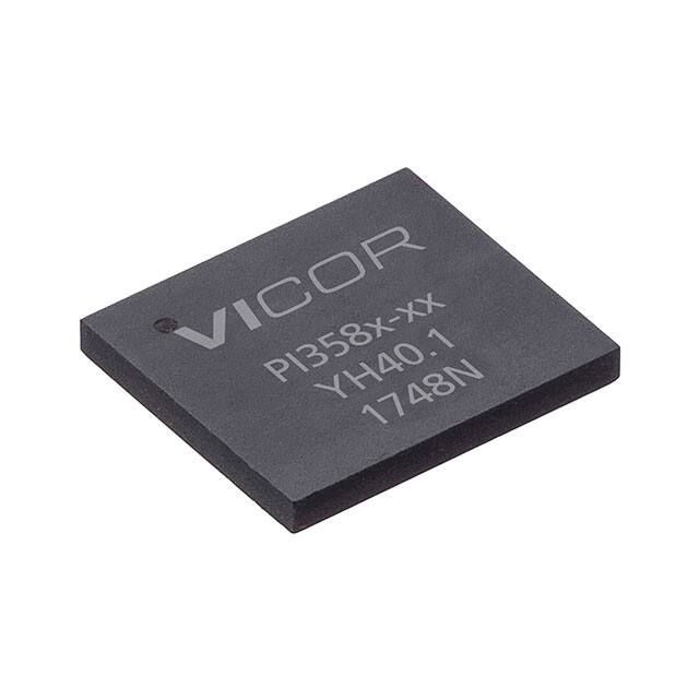

    PI3585-00-QFYZ 是一款高输入电压、宽输入范围的 ZVS Buck DC-DC 调节器,集成了控制器和功率开关,采用高密度 GQFN 封装。该系列采用高性能零电压开关 (ZVS) 拓扑,提...
PI3585-00-QFYZ 数据手册
Not Recommended for New Designs ZVS Regulators PI358x-00 30 – 60VIN ZVS Buck Regulator Product Description Features & Benefits The PI358x-00 is a family of high input voltage, wide‑input‑range DC-DC ZVS Buck regulators integrating controller and power switches within a high-density GQFN (UTAC's Grid‑array QFN) package. • High-Efficiency HV ZVS Buck Topology The integration of a high-performance Zero-Voltage Switching (ZVS) topology, within the PI358x-00 series, increases point‑of‑load performance providing best-in-class power efficiency. • Parallel capable with single-wire current sharing • Wide input voltage range of 30 – 60V • Power up into pre-biased load < 6V • Input Over/Undervoltage Lockout (OVLO/UVLO) • Output Overvoltage Protection (OVP) Device Output Voltage IOUT Max • Overtemperature Protection (OTP) Set Range PI3583-00-QFYZ 3.3V 2.2 – 4.0V 10A • Differential amplifier for output remote sensing PI3585-00-QFYZ 5.0V 3.8 – 6.5V 10A • User adjustable soft start & tracking PI3586-00-QFYZ 12.0V 6.5 – 14V 9A • –20 to 120°C operating range (TINT) • Fast and slow current limits Applications • HV to PoL Buck Regulator Applications • Computing, Communications, Industrial, Automotive Equipment Package Information • 37-Pin GQFN ZVS Regulators Page 1 of 45 Rev 1.2 08/2020 Not Recommended for New Designs PI358x-00 Contents Order Information 3 Thermal, Storage and Handling Information 3 Output Voltage Set Point 37 Absolute Maximum Ratings 3 Soft Start Adjust and Tracking 37 Functional Block Diagram 4 Inductor Pairing 37 Pin Description 5 Parallel Operation 38 Package Pinout 6 Filter Considerations 38 PI358x-00 Common Electrical Characteristics 7 VDR Bias Regulator 39 PI3583-00 (3.3VOUT ) Electrical Characteristics 9 Additional System Design Considerations 39 PI3585-00 (5.0VOUT ) Electrical Characteristics 16 Layout Guidelines 40 PI3586-00 (12.0VOUT ) Electrical Characteristics 23 Recommended PCB Footprint 42 Functional Description 30 Package Drawings 43 Remote Sensing 30 Revision History 44 Soft Start 32 Warranty 45 Output Voltage Selection 32 Output Current Limit Protection 32 Input Undervoltage Lockout 32 Input Overvoltage Lockout 32 Output Overvoltage Protection 32 Overtemperature Protection 32 Pulse Skip Mode (PSM) 32 Variable Frequency Operation 32 Thermal Characteristics 32 SiP Power Dissipation as Percentage of Total System Losses ZVS Regulators Page 2 of 45 Application Description 36 Rev 1.2 08/2020 37 Not Recommended for New Designs PI358x-00 Order Information Product Nominal Output Rated IOUT Package Transport Media PI3583-00-QFYZ 3.3V 10A 7 x 8mm GQFN TRAY PI3585-00-QFYZ 5.0V 10A 7 x 8mm GQFN TRAY PI3586-00-QFYZ 12.0V 9A 7 x 8mm GQFN TRAY Thermal, Storage and Handling Information Name Rating Storage Temperature –65 to 150°C Internal Operating Temperature –20 to 120°C Soldering Temperature for 30 seconds 260°C MSL Rating MSL3 ESD Rating, JESD22-A114F, JS-002-2014 500V HBM; 200V CDM, respectively Absolute Maximum Ratings [a] Name Rating VIN –0.7 to 75V VS1 –6 [b] to 75V VOUT –0.5 to 25V CR –0.7 to 25V CB –0.3 to 5.5V with respect to CR Q1B –0.3 to 5.5V with respect to VS1 VBS –0.7 to 75V Q2G –0.5 to 5.5V SGND ±100mA TRK –0.3 to 5.5V, ±30mA VDR, VCC, SYNCI, SYNCO, PWRGD, EN, CC, CSL, COMP, EAO, EAIN, VDIFF, VSN, VSP, TESTx –0.3 to 5.5V, ±5mA [a] Stresses beyond these limits may cause permanent damage to the device. Operation at these conditions or conditions beyond those listed in the Electrical Specifications table is not guaranteed. All voltages are referenced to PGND unless otherwise noted. [b] Peak during switching transient. ZVS Regulators Page 3 of 45 Rev 1.2 08/2020 PI358x-00 Not Recommended for New Designs Functional Block Diagram Q1B VS1 Q2G CSL CR CB VIN VS1 Q1 VBS Q2 VOUT ZVS Control Power Control VDR VDR VCC ZVS Buck Control SYNCO and SYNCI PWRGD EN + - Digital Parametric Trim + VREF VSN VSP VDIFF EAIN EAO RZI COMP TRK PGND ZVS Regulators Page 4 of 45 Rev 1.2 08/2020 LGH SGND TEST3 TEST2 TEST1 Simplified block diagram Not Recommended for New Designs PI358x-00 Pin Description Name Location I/O Description PGND 1, 15, 37 Power Power Ground: VIN and VOUT power returns VS1 2 Power Switching Node: and ZVS sense for power switches. Requires a schottky diode clamp with a low inductance connection in parallel with an RC snubber for 1nF and 0.3Ω. Refer to Table 1 for the recommended components. 3 Power Input Voltage: for the power stage. 14 Power Input Voltage: and sense for UVLO, OVLO and feed forward ramp. CR 4 Power ZVS control function node. Requires a 40V schottky diode clamp to PGND. Refer to Table 1 for the recommended component. CB 5 Power ZVS control function node. Decouple with a 0.047µF capacitor between CB and CR. Refer to Table 1 for the recommended component. Q1B 6 Power Q1 driver boost pin. Decouple with a 0.22µF capacitor in series with a 1.3Ω resistor between Q1B and VS1. Refer to Table 1 for the recommended components. CSL 7 Power ZVS control function node. Connect to PGND. Q2G 8 Power Q2 gate drive. Leave open. VDR 9 I/O Gate Driver VCC: 5.1V gate driver bias supply. May be used as a bias supply for low power external loads. See Application Description for important considerations. N/C 10-12 I/O No Internal connection. VBS 13 Power Switching node for gate driver bias supply. VOUT 16-19 Power Output Voltage: Internal Clamp connection and sense for power switches and feed-forward ramp. SYNCI 20 I Synchronization Input: Synchronize to the falling edge of external clock frequency. SYNCI is a high impedance digital input node and should always be connected to SGND when not in use. The PI358x-00 family is not optimized for external synchronization functionality. SYNCO 21 O Synchronization Output: Outputs a high signal at the start of each clock cycle for the longer of ½ of the minimum period or the on time of the high-side power MOSFET. TEST1 22 I/O Factory Test: Use only with factory guidance. Connect to SGND for proper operation. TEST2 23 I/O Factory Test: Use only with factory guidance. Connect to SGND for proper operation. TEST3 24 I/O Factory Test: Use only with factory guidance. Leave open. VIN SGND 25 I/O Signal Ground: Internal logic ground for EAO, EAIN, TRK, SYNCI, SYNCO communication returns. SGND and PGND are not connected inside the package. SGND should be connected to the large PGND island (controller paddle, pin 37) directly under the PI358x package. Sensitive analog nodes should be connected to the SGND side of the connection. VCC 26 I/O Control Circuitry VCC: Analog & digital bias. Decouple with 2.2µF to SGND. EN 27 I/O Enable Input: Regulator enable control. Asserted high or left floating – regulator enabled; Asserted low – regulator output disabled. TRK 28 I LGH 29 I/O For factory use only. Connect to SGND in application. COMP 30 O Compensation Capacitor: Connect capacitor for control loop dominant pole. See Error Amplifier section for details. A default CCOMP of 4.7nF is used in the example. EAO 31 O Error Amplifier Output: External connection for additional compensation and current sharing. EAIN 32 I Error Amplifier Inverting Input: Connection for the feedback divider tap. VSN 33 I Independent Amplifier Inverting Input: If unused connect in unity gain. VSP 34 I Independent Amplifier Non-Inverting Input: If unused connect to SGND. VDIFF 35 O Independent Amplifier Output: Active only when module is enabled. PWRGD 36 O Power Good: High impedance when regulator is operating and VOUT is in regulation. Otherwise pulls to SGND. ZVS Regulators Page 5 of 45 Soft Start and Track Input: An external capacitor with minimum capacitance of 47nF is required to be connected between TRK pin and SGND to control the rate of rise during soft start. Rev 1.2 08/2020 PI358x-00 Not Recommended for New Designs Package Pinout PGD VDIFF 36 1 VSP VSN EAIN 34 33 32 35 EAO COMP LGH 31 30 29 TRK EN VCC 28 27 26 PGND 2 VS1 PGND 25 SGND 24 TEST3 23 TEST2 22 TEST1 21 SYNCO 20 SYNCI 19 VOUT 18 VOUT 17 VOUT 16 VOUT 15 PGND 14 VIN 13 VBS 37 3 VIN 4 5 6 7 8 9 10 11 12 CR CB QIB CSL Q2G VDR N/C N/C N/C PI358x TOP THROUGH VIEW OF PRODUCT GQFN PACKAGE ZVS Regulators Page 6 of 45 Rev 1.2 08/2020 PI358x-00 Not Recommended for New Designs PI358x-00 Common Electrical Characteristics Specifications apply for –20°C < TINT < 120°C, VIN = 48V, EN = High, unless otherwise noted. [c] Parameter Symbol Conditions Min Typ Max Unit Open Loop Gain [d] 96 120 140 dB Small Signal Gain-Bandwidth [d] 5 7 12 MHz 0.5 1 mV 2.5 V Differential Amp Input Offset Error Common-Mode Input Range –0.1 Differential-Mode Input Range 2 V Input Bias Current –1 1 µA Sink/Source Current –1 1 mA Maximum VOUT IVDIFF = –1mA Minimum VOUT IVDIFF = –1mA Capacitive Load Range for Stability [j] 4.85 V 20 0 Slew Rate 50 11 mV pF V/µs PWRGD VOUT Rising Threshold VPG_HI% 78 84 90 % VOUT_DC VOUT Falling Threshold VPG_LO% 75 81 87 % VOUT_DC PWRGD Output Low VPG_SAT 0.4 V Sink = 4mA [c] All parameters reflect regulator and inductor system performance. Measurements were made using a standard PI358x evaluation board with 3 x 3in dimensions and 4 layer, 2oz copper. Refer to inductor pairing table within Application Description section for specific inductor manufacturer and value. [d] Regulator is assured to meet performance specifications by design, test correlation, characterization, and/or statistical process control. Output voltage is determined by an external feedback divider ratio. [e] Output current capability may be limited and other performance may vary from noted electrical characteristics when V OUT is not set to nominal. [f] Refer to Output Ripple plots. [g] Refer to Load Current vs. Ambient Temperature curves. [h] Refer to Switching Frequency vs. Load current curves. [i] Contact factory applications for array derating and layout best practices to minimize sharing errors. [j] Informational only. ZVS Regulators Page 7 of 45 Rev 1.2 08/2020 PI358x-00 Not Recommended for New Designs PI358x-00 Common Electrical Characteristics (Cont.) Specifications apply for –20°C < TINT < 120°C, VIN = 48V, EN = High, unless otherwise noted. [c] Parameter Symbol Conditions Min Typ Max Unit 4.9 5.05 5.2 V 2 mA VDR Voltage Set Point VVDR VIN_DC > 10V External Loading IVDR See Application Description for details External Inductor Between VDR and VBS LVBS External Capacitor Between VDR and PGND CVDR 0 External required components for VDR, recommended to be an Inductor. Refer to Table 1 for the recommended component. External required components for VDR, recommended to be a capacitor. Refer to Table 1 for the recommended component. 10 µH 2.2 µF Enable High Threshold 0.9 VEN_HI 1.0 1.1 V Low Threshold VEN_LO 0.7 0.8 0.9 V Threshold Hysteresis VEN_HYS 100 200 300 mV Pull-Up Voltage Level for Source Current VEN_PU 2 V IEN_PU_POS 50 µA MIL-HDBK-217, 25ºC, Ground Benign: GB 22.7 MHrs Telcordia SR-332, 25ºC, Ground Benign: GB 191 MHrs Pull-Up Current Reliability MTBF [c] All parameters reflect regulator and inductor system performance. Measurements were made using a standard PI358x evaluation board with 3 x 3in dimensions and 4 layer, 2oz copper. Refer to inductor pairing table within Application Description section for specific inductor manufacturer and value. [d] Regulator is assured to meet performance specifications by design, test correlation, characterization, and/or statistical process control. Output voltage is determined by an external feedback divider ratio. [e] Output current capability may be limited and other performance may vary from noted electrical characteristics when V OUT is not set to nominal. [f] Refer to Output Ripple plots. [g] Refer to Load Current vs. Ambient Temperature curves. [h] Refer to Switching Frequency vs. Load current curves. [i] Contact factory applications for array derating and layout best practices to minimize sharing errors. [j] Informational only. ZVS Regulators Page 8 of 45 Rev 1.2 08/2020 PI358x-00 Not Recommended for New Designs PI3583-00 (3.3VOUT) Electrical Characteristics Specifications apply for –20°C < TINT < 120°C, VIN = 48V, EN = High, unless otherwise noted. [c] Parameter Symbol Conditions Min Typ Max Unit 30 48 60 V Input Specifications Input Voltage VIN_DC Input Current IIN_DC Input Current at Output Short (Fault Condition Duty Cycle) IIN_Short VIN = 48V, TCASE = 25°C, full load Short at terminals 0.77 A 3 mA Input Quiescent Current IQ_VIN Disabled 0.65 mA Input Quiescent Current IQ_VIN Enabled, no load, TCASE = 25°C 1.8 mA VIN_SR [j] VEAIN [d] Input Voltage Slew Rate 1 V/µs Output Specifications EAIN Voltage Total Regulation Output Voltage Trim Range VOUT_DC [d] [e] 0.975 0.990 1.005 V 2.2 3.3 4.0 V Line Regulation ΔVOUT / ΔVIN @ 25°C, 30V < VIN < 60V 0.10 Load Regulation ΔVOUT / ΔIOUT @ 25°C, 10% to 100% load 0.10 % 53 mVP-P Output Voltage Ripple VOUT_AC Full load, COUT = 6 x 100µF, 20MHz BW [f] Output Current IOUT_DC [g] Current Limit IOUT_CL Typical current limit based on nominal 420nH inductor. Maximum Array Size NPARALLEL 0 % 10 11.5 [d] A A 3 Modules Output Current, Array of 2 IOUT_DC_ARRAY2 Total array capability, [d] see applications section for details 0 [i] A Output Current, Array of 3 IOUT_DC_ARRAY3 Total array capability, [d] see applications section for details 0 [i] A 27.0 29.1 V 2.08 2.50 V Protection Input UVLO Start Threshold VUVLO_START Input UVLO Stop Hysteresis VUVLO_HYS 1.66 Input UVLO Response Time Input OVLO Stop Threshold Input OVLO Start Hysteresis VOVLO_STOP VOVLO_HYS Input OVLO Start Threshold VOVLO_START Input OVLO Response Time tf Output Overvoltage Protection, Relative VOVP_REL Output Overvoltage Protection, Absolute VOVP_ABS [d] Hysteresis active when OVLO present for at least tFR_DLY [d] [d] 1.25 µs 64.3 V 1.17 V 60.5 Above set VOUT 4.8 [c] V 1.25 µs 20 % 5.3 V All parameters reflect regulator and inductor system performance. Measurements were made using a standard PI358x evaluation board with 3 x 3in dimensions and 4 layer, 2oz copper. Refer to inductor pairing table within Application Description section for specific inductor manufacturer and value. [d] Regulator is assured to meet performance specifications by design, test correlation, characterization, and/or statistical process control. Output voltage is determined by an external feedback divider ratio. [e] Output current capability may be limited and other performance may vary from noted electrical characteristics when V OUT is not set to nominal. [f] Refer to Output Ripple plots. [g] Refer to Load Current vs. Ambient Temperature curves. [h] Refer to Switching Frequency vs. Load current curves. [i] Contact factory applications for array derating and layout best practices to minimize sharing errors. [j] Informational only. ZVS Regulators Page 9 of 45 Rev 1.2 08/2020 PI358x-00 Not Recommended for New Designs PI3583-00 (3.3VOUT) Electrical Characteristics (Cont.) Specifications apply for –20°C < TINT < 120°C, VIN = 48V, EN = High, unless otherwise noted. [c] Parameter Symbol Conditions Min Typ Max Unit 470 500 530 kHz Timing Switching Frequency Fault Restart Delay fs [h] While in DCM operating mode only, SYNCI grounded tFR_DLY 30 ms Synchronization Input (SYNCI) Synchronization Frequency Range fSYNCI SYNCI Threshold VSYNCI –50% and +10% relative to set switching frequency (fS), while in DCM operating mode only. [e] and [h] 250 550 2.5 kHz V Synchronization Output (SYNCO) SYNCO High VSYNCO_HI Source 1mA 4.5 V SYNCO Low VSYNCO_LO Sink 1mA SYNCO Rise Time tSYNCO_RT 20pF load 10 ns SYNCO Fall Time tSYNCO_FT 20pF load 10 ns 0.5 V Soft Start, Tracking and Error Amplifier TRK Active Range (Nominal) VTRK 0 1.4 V TRK Enable Threshold VTRK_OV TRK to EAIN Offset VEAIN_OV 40 80 120 mV ITRK 30 50 70 µA Charge Current (Soft Start) Discharge Current (Fault) ITRK_DIS TRK Capacitance, External CTRK_EXT Soft Start Time tSS 40 VTRK = 0.5V CTRK = 47nF Error Amplifier Transconductance GMEAO [d] PSM Skip Threshold PSMSKIP [d] ROUT [d] RZI [d] Error Amplifier Output Impedance Internal Compensation Resistor 8.7 47 [c] mV mA nF 0.94 ms 7.6 mS 0.8 V 1 MΩ 6 kΩ All parameters reflect regulator and inductor system performance. Measurements were made using a standard PI358x evaluation board with 3 x 3in dimensions and 4 layer, 2oz copper. Refer to inductor pairing table within Application Description section for specific inductor manufacturer and value. [d] Regulator is assured to meet performance specifications by design, test correlation, characterization, and/or statistical process control. Output voltage is determined by an external feedback divider ratio. [e] Output current capability may be limited and other performance may vary from noted electrical characteristics when V OUT is not set to nominal. [f] Refer to Output Ripple plots. [g] Refer to Load Current vs. Ambient Temperature curves. [h] Refer to Switching Frequency vs. Load current curves. [i] Contact factory applications for array derating and layout best practices to minimize sharing errors. [j] Informational only. ZVS Regulators Rev 1.2 Page 10 of 45 08/2020 PI358x-00 Not Recommended for New Designs PI3583-00 (3.3VOUT) Electrical Characteristics (Cont.) 4 94 Power Dissipation (W) Efficiency (%) 92 90 88 86 84 82 80 78 2 3 4 5 7 6 8 9 3 2 1 0 10 2 Load Current (A) VIN: 30V 48V 4 60V VIN: 7 6 8 9 10 30V 48V 9 10 9 10 60V Figure 4 — System power dissipation, nominal trim, board temperature = 25ºC 92 91 90 89 88 87 Power Dissipation (W) 4 86 85 84 83 82 3 2 1 0 81 2 3 4 5 7 6 8 9 2 10 3 4 VIN: 30V 48V 5 7 6 8 Load Current (A) Load Current (A) VIN: 60V Figure 2 — System efficiency, low trim, board temperature = 25ºC 30V 48V 60V Figure 5 — System power dissipation, low trim, board temperature = 25ºC 5 Power Dissipation (W) 94 92 Efficiency (%) 5 Load Current (A) Figure 1 — System efficiency, nominal trim, board temperature = 25ºC Efficiency (%) 3 90 88 86 84 82 80 2 3 4 5 7 6 8 9 30V 48V Figure 3 — System efficiency, high trim, board temperature = 25ºC 3 2 1 10 2 Load Current (A) VIN: 4 3 4 5 7 6 8 Load Current (A) 60V VIN: 30V 48V Figure 6 — System power dissipation, high trim, board temperature = 25ºC ZVS Regulators Rev 1.2 Page 11 of 45 08/2020 60V PI358x-00 Not Recommended for New Designs PI3583-00 (3.3VOUT) Electrical Characteristics (Cont.) 5 94 Power Dissipation (W) Efficiency (%) 92 90 88 86 84 82 80 78 2 3 4 5 7 6 8 9 4 3 2 1 0 10 2 Load Current (A) VIN: 30V 48V 60V VIN: 5 7 6 8 9 10 30V 48V 9 10 9 10 60V Figure 10 — System power dissipation, nominal trim, board temperature = 90ºC 5 94 Power Dissipation (W) 92 Efficiency (%) 4 Load Current (A) Figure 7 — System efficiency, nominal trim, board temperature = 90ºC 90 88 86 84 82 80 78 2 3 4 5 7 6 8 9 4 3 2 1 0 10 2 Load Current (A) VIN: 30V 48V 3 4 5 7 6 8 Load Current (A) 60V VIN: Figure 8 — System efficiency, low trim, board temperature = 90ºC 30V 48V 60V Figure 11 — System power dissipation, low trim, board temperature = 90ºC 6 94 Power Dissipation (W) 92 Efficiency (%) 3 90 88 86 84 82 80 78 2 3 4 5 7 6 8 9 30V 48V Figure 9 — System efficiency, high trim, board temperature = 90ºC 4 3 2 1 0 10 2 Load Current (A) VIN: 5 3 4 5 7 6 8 Load Current (A) 60V VIN: 30V 48V 60V Figure 12 — System power dissipation, high trim, board temperature = 90ºC ZVS Regulators Rev 1.2 Page 12 of 45 08/2020 PI358x-00 Not Recommended for New Designs PI3583-00 (3.3VOUT) Electrical Characteristics (Cont.) 4 94 Power Dissipation (W) Efficiency (%) 92 90 88 86 84 82 80 78 2 3 4 5 7 6 8 9 3 2 1 0 10 2 Load Current (A) VIN: 30V 48V 4 60V VIN: 7 6 8 9 10 30V 48V 9 10 9 10 60V Figure 16 — System power dissipation, nominal trim, board temperature = –20ºC 92 Power Dissipation (W) 3 90 88 86 84 82 2 1 0 80 2 3 4 5 7 6 8 9 2 10 3 4 VIN: 30V 48V 5 7 6 8 Load Current (A) Load Current (A) VIN: 60V Figure 14 — System efficiency, low trim, board temperature = –20ºC 30V 48V 60V Figure 17 — System power dissipation, low trim, board temperature = –20ºC 4 Power Dissipation (W) 94 92 Efficiency (%) 5 Load Current (A) Figure 13 — System efficiency, nominal trim, board temperature = –20ºC Efficiency (%) 3 90 88 86 84 82 80 2 3 4 5 7 6 8 9 30V 48V Figure 15 — System efficiency, high trim, board temperature = –20ºC 2 1 0 10 2 Load Current (A) VIN: 3 3 4 5 7 6 8 Load Current (A) 60V VIN: 30V 48V 60V Figure 18 — System power dissipation, high trim, board temperature = –20ºC ZVS Regulators Rev 1.2 Page 13 of 45 08/2020 PI358x-00 Not Recommended for New Designs PI3583-00 (3.3VOUT) Electrical Characteristics (Cont.) Figure 22 — Output short circuit, nominal line Figure 20 — Output voltage ripple: nominal line, nominal trim, 100% load, COUT = 6 x 100µF ceramic, 20MHz BW Figure 23 — Output voltage ripple: nominal line, nominal trim, 50% load, COUT = 6 x 100µF ceramic, 20MHz BW 500 Maximum Output Current (A) Switching Frequency (kHz) Figure 19 — Transient response: 50% to 100% load, at 1A/µs; nominal line, nominal trim, COUT = 6 x 100µF ceramic 480 460 440 420 400 380 360 340 320 300 0 1 2 3 4 5 6 7 8 9 10 Load Current (A) VIN: 30V 48V 10 8 Note: SiP is based on VIN and VS1 paths only. Inductor is based on base with inclusion of GEL 30 interface resistance (0.15mm thick; 3.5W/m-K thermal conductivity), and all leads. 6 4 2 0 0 20 40 60 80 100 120 140 Temperature of Isothermal SiP VIN and VS1 pins, and PCB at Inductor (ºC) 60V Figure 21 — Switching frequency vs. load, nominal trim 12 Figure 24 — System thermal specified operating area: max IOUT at nominal trim vs. temperature at locations noted ZVS Regulators Rev 1.2 Page 14 of 45 08/2020 Not Recommended for New Designs PI3583-00 (3.3VOUT) Electrical Characteristics (Cont.) 10 Output Current (A) 9 8 7 6 5 4 3 2 1 0.8 1.3 2.3 1.8 2.8 EAO Voltage (V) VIN: 30V 48V 60V Figure 25 — Output current vs. VEAO, nominal trim 8 7 GMOD (S) 6 5 4 3 2 1 0 0.8 1.3 2.3 1.8 2.8 EAO Voltage (V) VIN: 30V 48V 60V Figure 26 — Small-signal modulator gain vs. VEAO, nominal trim 45 40 rEQ_OUT (Ω) 35 30 25 20 15 10 5 0 0.8 1.3 1.8 2.3 2.8 EAO Voltage (V) VIN: 30V 48V 60V Figure 27 — rEQ_OUT vs VEAO, nominal trim ZVS Regulators Rev 1.2 Page 15 of 45 08/2020 PI358x-00 PI358x-00 Not Recommended for New Designs PI3585-00 (5.0VOUT) Electrical Characteristics Specifications apply for –20°C < TINT < 120°C, VIN = 48V, EN = High, unless otherwise noted. [c] Parameter Symbol Conditions Min Typ Max Unit 30 48 60 V Input Specifications Input Voltage VIN_DC Input Current IIN_DC Input Current at Output Short (Fault Condition Duty Cycle) IIN_Short VIN = 48V, TCASE = 25°C, full load 1.12 A Short at terminals 1.8 mA 0.65 mA 2 mA Input Quiescent Current IQ_VIN Disabled Input Quiescent Current IQ_VIN Enabled, no load, TCASE = 25°C VIN_SR [j] VEAIN [d] Input Voltage Slew Rate 1 V/µs Output Specifications EAIN Voltage Total Regulation Output Voltage Trim Range VOUT_DC [d] [e] 0.975 0.990 1.005 V 3.8 5.0 6.5 V Line Regulation ΔVOUT / ΔVIN @ 25°C, 30V < VIN < 60V 0.10 Load Regulation ΔVOUT / ΔIOUT @ 25°C, 10% to 100% load 0.10 % 60 mVP-P Output Voltage Ripple VOUT_AC Full load, COUT = 6 x 47µF, 20MHz BW [f] Output Current IOUT_DC [g] Current Limit IOUT_CL Typical current limit based on nominal 420nH inductor. Maximum Array Size NPARALLEL 0 % 10 11.5 [d] A A 3 Modules Output Current, Array of 2 IOUT_DC_ARRAY2 Total array capability, [d] see applications section for details 0 [i] A Output Current, Array of 3 IOUT_DC_ARRAY3 Total array capability, [d] see applications section for details 0 [i] A 27.0 29.1 V 2.08 2.50 V Protection Input UVLO Start Threshold VUVLO_START Input UVLO Stop Hysteresis VUVLO_HYS 1.66 Input UVLO Response Time Input OVLO Stop Threshold Input OVLO Start Hysteresis VOVLO_STOP VOVLO_HYS Input OVLO Start Threshold VOVLO_START Input OVLO Response Time tf Output Overvoltage Protection, Relative VOVP_REL Output Overvoltage Protection, Absolute VOVP_ABS [d] Hysteresis active when OVLO present for at least tFR_DLY [d] [d] µs 64.3 V 1.17 V 60.5 Above set VOUT [c] 1.25 6.7 V 1.25 µs 20 % 7.5 V All parameters reflect regulator and inductor system performance. Measurements were made using a standard PI358x evaluation board with 3 x 3in dimensions and 4 layer, 2oz copper. Refer to inductor pairing table within Application Description section for specific inductor manufacturer and value. [d] Regulator is assured to meet performance specifications by design, test correlation, characterization, and/or statistical process control. Output voltage is determined by an external feedback divider ratio. [e] Output current capability may be limited and other performance may vary from noted electrical characteristics when V OUT is not set to nominal. [f] Refer to Output Ripple plots. [g] Refer to Load Current vs. Ambient Temperature curves. [h] Refer to Switching Frequency vs. Load current curves. [i] Contact factory applications for array derating and layout best practices to minimize sharing errors. [j] Informational only. ZVS Regulators Rev 1.2 Page 16 of 45 08/2020 PI358x-00 Not Recommended for New Designs PI3585-00 (5.0VOUT) Electrical Characteristics (Cont.) Specifications apply for –20°C < TINT < 120°C, VIN = 48V, EN = High, unless otherwise noted. [c] Parameter Symbol Conditions Min Typ Max Unit 564 600 636 kHz Timing Switching Frequency Fault Restart Delay fs [h] While in DCM operating mode only, SYNCI grounded tFR_DLY 30 ms Synchronization Input (SYNCI) Synchronization Frequency Range fSYNCI SYNCI Threshold VSYNCI –50% and +10% relative to set switching frequency (fS), while in DCM operating mode only. [e] and [h] 300 660 2.5 kHz V Synchronization Output (SYNCO) SYNCO High VSYNCO_HI Source 1mA 4.5 V SYNCO Low VSYNCO_LO Sink 1mA SYNCO Rise Time tSYNCO_RT 20pF load 10 ns SYNCO Fall Time tSYNCO_FT 20pF load 10 ns 0.5 V Soft Start, Tracking and Error Amplifier TRK Active Range (Nominal) VTRK 0 1.4 V TRK Enable Threshold VTRK_OV TRK to EAIN Offset VEAIN_OV 40 80 120 mV ITRK 30 50 70 µA Charge Current (Soft Start) Discharge Current (Fault) ITRK_DIS TRK Capacitance, External CTRK_EXT Soft Start Time tSS 40 VTRK = 0.5V CTRK = 47nF Error Amplifier Transconductance GMEAO [d] PSM Skip Threshold PSMSKIP [d] ROUT [d] RZI [d] Error Amplifier Output Impedance Internal Compensation Resistor 8.7 47 [c] mV mA nF 0.94 ms 7.6 mS 0.8 V 1 MΩ 6 kΩ All parameters reflect regulator and inductor system performance. Measurements were made using a standard PI358x evaluation board with 3 x 3in dimensions and 4 layer, 2oz copper. Refer to inductor pairing table within Application Description section for specific inductor manufacturer and value. [d] Regulator is assured to meet performance specifications by design, test correlation, characterization, and/or statistical process control. Output voltage is determined by an external feedback divider ratio. [e] Output current capability may be limited and other performance may vary from noted electrical characteristics when V OUT is not set to nominal. [f] Refer to Output Ripple plots. [g] Refer to Load Current vs. Ambient Temperature curves. [h] Refer to Switching Frequency vs. Load current curves. [i] Contact factory applications for array derating and layout best practices to minimize sharing errors. [j] Informational only. ZVS Regulators Rev 1.2 Page 17 of 45 08/2020 PI358x-00 Not Recommended for New Designs 95 94 93 92 91 90 89 88 87 86 85 84 83 5 Power Dissipation (W) Efficiency (%) PI3585-00 (5.0VOUT) Electrical Characteristics (Cont.) 4 3 2 1 2 3 4 5 6 7 8 9 10 2 3 4 Load Current (A) VIN: 48V 30V VIN: 60V 94 93 92 91 90 89 88 87 86 85 84 83 82 81 7 8 9 10 48V 30V 9 10 9 10 60V 4 2 3 4 5 6 7 8 9 3 2 1 0 10 2 3 4 VIN: 48V 30V 5 6 7 8 Load Current (A) Load Current (A) VIN: 60V Figure 29 — System efficiency, low trim, board temperature = 25ºC 48V 30V 60V Figure 32 — System power dissipation, low trim, board temperature = 25ºC 5 96 95 94 93 92 91 90 89 88 87 Power Dissipation (W) Efficiency (%) 6 Figure 31 — System power dissipation, nominal trim, board temperature = 25ºC Power Dissipation (W) Efficiency (%) Figure 28 — System efficiency, nominal trim, board temperature = 25ºC 86 85 5 Load Current (A) 2 3 4 5 6 7 8 9 4 3 2 1 10 2 3 4 Load Current (A) VIN: 30V 48V Figure 30 — System efficiency, high trim, board temperature = 25ºC 5 6 7 8 Load Current (A) VIN: 60V 30V 48V Figure 33 — System power dissipation, high trim, board temperature = 25ºC ZVS Regulators Rev 1.2 Page 18 of 45 08/2020 60V PI358x-00 Not Recommended for New Designs 94 93 92 91 90 89 88 87 86 85 84 83 82 81 6 Power Dissipation (W) Efficiency (%) PI3585-00 (5.0VOUT) Electrical Characteristics (Cont.) 5 4 3 2 1 2 3 4 5 6 7 8 9 10 2 3 4 Load Current (A) VIN: 48V 30V VIN: 60V 6 7 8 9 10 48V 30V 9 10 9 10 60V Figure 37 — System power dissipation, nominal trim, board temperature = 90ºC 6 93 92 91 90 89 88 87 86 85 84 83 82 81 80 79 78 Power Dissipation (W) Efficiency (%) Figure 34 — System efficiency, nominal trim, board temperature = 90ºC 5 4 3 2 1 2 3 4 5 6 7 8 9 10 2 3 4 Load Current (A) VIN: 48V 30V 5 6 7 8 Load Current (A) VIN: 60V Figure 35 — System efficiency, low Trim, board temperature = 90ºC 48V 30V 60V Figure 38 — System power dissipation, low trim, board temperature = 90ºC 7 94 Power Dissipation (W) 93 92 Efficiency (%) 5 Load Current (A) 91 90 89 88 87 86 85 84 2 3 4 5 6 7 8 9 30V 48V Figure 36 — System efficiency, high trim, board temperature = 90ºC 5 4 3 2 1 10 2 Load Current (A) VIN: 6 3 4 5 6 7 8 Load Current (A) 60V VIN: 30V 48V Figure 39 — System power dissipation, high trim, board temperature = 90ºC ZVS Regulators Rev 1.2 Page 19 of 45 08/2020 60V PI358x-00 Not Recommended for New Designs PI3585-00 (5.0VOUT) Electrical Characteristics (Cont.) 96 4.5 Power Dissipation (W) Efficiency (%) 94 92 90 88 86 84 82 80 4 3.5 3 2.5 2 1.5 1 0.5 0 2 3 4 5 7 6 8 9 10 2 3 4 Load Current (A) VIN: 30V 48V 60V VIN: 7 6 8 9 10 30V 48V 9 10 60V Figure 43 — System power dissipation, nominal trim, board temperature = –20ºC 96 4 94 3.5 Power Dissipation (W) Efficiency (%) Figure 40 — System efficiency, nominal trim, board temperature = –20ºC 92 90 88 86 84 82 80 3 2.5 2 1.5 1 0.5 0 2 3 4 5 7 6 8 9 10 2 3 4 Load Current (A) VIN: 30V 48V 5 7 6 8 Load Current (A) 60V VIN: Figure 41 — System efficiency, low trim, board temperature = –20ºC 30V 48V 60V Figure 44 — System power dissipation, low trim, board temperature = –20ºC 96 6 Power Dissipation (W) 94 Efficiency (%) 5 Load Current (A) 92 90 88 86 84 82 80 5 4 3 2 1 0 2 3 4 5 7 6 8 9 10 2 3 Load Current (A) VIN: 30V 48V Figure 42 — System efficiency, high trim, board temperature = –20ºC 4 5 7 6 8 Load Current (A) 60V VIN: 30V 48V 60V Figure 45 — System power dissipation, high trim, board temperature = –20ºC ZVS Regulators Rev 1.2 Page 20 of 45 08/2020 9 10 PI358x-00 Not Recommended for New Designs PI3585-00 (5.0VOUT) Electrical Characteristics (Cont.) Figure 46 — Transient response: 50% to 100% load, at 1A/µs; nominal line, nominal trim, COUT = 6 x 47µF ceramic Figure 49 — Output short circuit, nominal line Figure 47 — Output voltage ripple: nominal line, nominal trim, 100% load, COUT = 6 x 47µF ceramic, 20MHz BW Figure 50 — Output voltage ripple: nominal line, nominal trim, 50% load, COUT = 6 x 47µF ceramic, 20MHz BW Maximum Output Current (A) 600 Frequency (kHz) 575 550 525 500 475 450 425 400 0 1 2 3 4 5 6 7 8 9 10 Load Current (A) VIN: 30V 48V 10 8 Note: SiP is based on VIN and VS1 paths only. Inductor is based on base with inclusion of GEL 30 interface resistance (0.15mm thick; 3.5W/m-K thermal conductivity), and all leads. 6 4 2 0 0 20 40 60 80 100 120 140 Temperature of Isothermal SiP VIN and VS1 pins, and PCB at Inductor (ºC) 60V Figure 48 — Switching frequency vs. load, nominal trim 12 Figure 51 — System thermal specified operating area: max IOUT at nominal trim vs. temperature at locations noted ZVS Regulators Rev 1.2 Page 21 of 45 08/2020 Not Recommended for New Designs PI3585-00 (5.0VOUT) Electrical Characteristics (Cont.) 10 Output Current (A) 9 8 7 6 5 4 3 2 1 0.8 1.3 1.8 2.3 2.8 EAO Voltage (V) VIN: 30V 48V 60V Figure 52 — Output current vs. VEAO, nominal trim 10 GMOD (S) 8 6 4 2 1 0.8 1.3 1.8 2.8 2.3 EAO Voltage (V) VIN: 48V 30V 60V Figure 53 — Small-signal modulator gain vs. VEAO, nominal trim 35 30 rEQ_OUT (Ω) 25 20 15 10 5 0 0.8 1 1.2 1.4 1.6 1.8 2 2.2 2.4 2.6 2.8 EAO Voltage (V) VIN: 30V 48V 60V Figure 54 — rEQ_OUT vs VEAO, nominal trim ZVS Regulators Rev 1.2 Page 22 of 45 08/2020 PI358x-00 PI358x-00 Not Recommended for New Designs PI3586-00 (12.0VOUT) Electrical Characteristics Specifications apply for –20°C < TINT < 120°C, VIN = 48V, EN = High, unless otherwise noted. [c] Parameter Symbol Conditions Min Typ Max Unit 30 48 60 V Input Specifications Input Voltage VIN_DC Input Current IIN_DC Input Current at Output Short (Fault Condition Duty Cycle) IIN_Short VIN = 48V, TCASE = 25°C, full load 2.35 A Short at terminals 3.5 mA 0.65 mA 3 mA Input Quiescent Current IQ_VIN Disabled Input Quiescent Current IQ_VIN Enabled, no load, TCASE = 25°C VIN_SR [j] VEAIN [d] Input Voltage Slew Rate 1 V/µs Output Specifications EAIN Voltage Total Regulation Output Voltage Trim Range VOUT_DC [d] [e] Line Regulation ΔVOUT / ΔVIN @ 25°C, 30V < VIN < 60V Load Regulation ΔVOUT / ΔIOUT 0.975 0.990 1.005 V 6.5 12.0 14.0 V 0.1 % @ 25°C, 10% to 100% load 0.1 % Output Voltage Ripple VOUT_AC Full load, COUT = 6 x 10µF, 20MHz BW [f] 115 mVP-P Output Current IOUT_DC [g] Current Limit IOUT_CL Typical current limit based on nominal 900nH inductor Maximum Array Size NPARALLEL 0 9 10.5 [d] A A 3 Modules Output Current, Array of 2 IOUT_DC_ARRAY2 Total array capability, [d] see applications section for details 0 [i] A Output Current, Array of 3 IOUT_DC_ARRAY3 Total array capability, [d] see applications section for details 0 [i] A 27.0 29.1 V 2.08 2.50 V Protection Input UVLO Start Threshold VUVLO_START Input UVLO Stop Hysteresis VUVLO_HYS 1.66 Input UVLO Response Time Input OVLO Stop Threshold Input OVLO Start Hysteresis VOVLO_STOP VOVLO_HYS Input OVLO Start Threshold VOVLO_START Input OVLO Response Time tf Output Overvoltage Protection, Relative VOVP_REL Output Overvoltage Protection, Absolute VOVP_ABS [d] Hysteresis active when OVLO present for at least tFR_DLY [d] [d] µs 64.3 V 1.17 V 60.5 Above set VOUT [c] 1.25 14.7 V 1.25 µs 20 % 15.8 V All parameters reflect regulator and inductor system performance. Measurements were made using a standard PI358x evaluation board with 3 x 3in dimensions and 4 layer, 2oz copper. Refer to inductor pairing table within Application Description section for specific inductor manufacturer and value. [d] Regulator is assured to meet performance specifications by design, test correlation, characterization, and/or statistical process control. Output voltage is determined by an external feedback divider ratio. [e] Output current capability may be limited and other performance may vary from noted electrical characteristics when V OUT is not set to nominal. [f] Refer to Output Ripple plots. [g] Refer to Load Current vs. Ambient Temperature curves. [h] Refer to Switching Frequency vs. Load current curves. [i] Contact factory applications for array derating and layout best practices to minimize sharing errors. [j] Informational only. ZVS Regulators Rev 1.2 Page 23 of 45 08/2020 PI358x-00 Not Recommended for New Designs PI3586-00 (12.0VOUT) Electrical Characteristics (Cont.) Specifications apply for –20°C < TINT < 120°C, VIN = 48V, EN = High, unless otherwise noted. [c] Parameter Symbol Conditions Min Typ Max Unit 658 700 742 kHz Timing Switching Frequency Fault Restart Delay fs [h] While in DCM operating mode only, SYNCI grounded tFR_DLY 30 ms Synchronization Input (SYNCI) Synchronization Frequency Range fSYNCI SYNCI Threshold VSYNCI –50% and +10% relative to set switching frequency (fS), while in DCM operating mode only. [e] and [h] 350 770 2.5 kHz V Synchronization Output (SYNCO) SYNCO High VSYNCO_HI Source 1mA 4.5 V SYNCO Low VSYNCO_LO Sink 1mA SYNCO Rise Time tSYNCO_RT 20pF load 10 ns SYNCO Fall Time tSYNCO_FT 20pF load 10 ns 0.5 V Soft Start, Tracking and Error Amplifier TRK Active Range (Nominal) VTRK 0 1.4 V TRK Enable Threshold VTRK_OV TRK to EAIN Offset VEAIN_OV 40 80 120 mV ITRK 30 50 70 µA Charge Current (Soft Start) Discharge Current (Fault) ITRK_DIS TRK Capacitance, External CTRK_EXT Soft Start Time tSS 40 VTRK = 0.5V CTRK = 47nF Error Amplifier Transconductance GMEAO [d] PSM Skip Threshold PSMSKIP [d] ROUT [d] RZI [d] Error Amplifier Output Impedance Internal Compensation Resistor 8.7 47 [c] mV mA nF 0.94 ms 7.6 mS 0.8 V 1 MΩ 6 kΩ All parameters reflect regulator and inductor system performance. Measurements were made using a standard PI358x evaluation board with 3 x 3in dimensions and 4 layer, 2oz copper. Refer to inductor pairing table within Application Description section for specific inductor manufacturer and value. [d] Regulator is assured to meet performance specifications by design, test correlation, characterization, and/or statistical process control. Output voltage is determined by an external feedback divider ratio. [e] Output current capability may be limited and other performance may vary from noted electrical characteristics when V OUT is not set to nominal. [f] Refer to Output Ripple plots. [g] Refer to Load Current vs. Ambient Temperature curves. [h] Refer to Switching Frequency vs. Load current curves. [i] Contact factory applications for array derating and layout best practices to minimize sharing errors. [j] Informational only. ZVS Regulators Rev 1.2 Page 24 of 45 08/2020 PI358x-00 Not Recommended for New Designs PI3586-00 (12.0VOUT) Electrical Characteristics (Cont.) 4.5 Power Dissipation (W) 5 98 Efficiency (%) 100 96 94 92 90 88 86 4 3.5 3 2.5 2 1.5 1 0.5 0 84 2 3 4 5 6 7 8 2 9 3 4 VIN: 30V 48V VIN: 60V Figure 55 — System efficiency, nominal trim, board temperature = 25ºC 7 8 9 30V 48V 8 9 60V Power Dissipation (W) 4 95 Efficiency (%) 6 Figure 58 — System power dissipation, nominal trim, board temperature = 25ºC 100 90 85 80 3.5 3 2.5 2 1.5 1 0.5 0 75 2 3 4 5 6 7 8 2 9 3 4 VIN: 30V 5 6 7 Load Current (A) Load Current (A) 48V VIN: 60V Figure 56 — System efficiency, low trim, board temperature = 25ºC 30V 48V 60V Figure 59 — System power dissipation, low trim, board temperature = 25ºC 100 Power Dissipation (W) 6 95 Efficiency (%) 5 Load Current (A) Load Current (A) 90 85 80 5 4 3 2 1 0 75 2 3 4 5 6 7 8 2 9 3 VIN: 30V 48V Figure 57 — System efficiency, high trim, board temperature = 25ºC 4 5 6 7 8 Load Current (A) Load Current (A) VIN: 60V 30V 48V 60V Figure 60 — System power dissipation, high trim, board temperature = 25ºC ZVS Regulators Rev 1.2 Page 25 of 45 08/2020 9 PI358x-00 Not Recommended for New Designs PI3586-00 (12.0VOUT) Electrical Characteristics (Cont.) 98 6 Power Dissipation (W) Efficiency (%) 97 96 95 94 93 92 91 5 4 3 2 1 0 90 2 3 4 5 6 7 8 2 9 3 4 VIN: 30V 48V VIN: 60V 6 7 8 9 30V 48V 8 9 8 9 60V Figure 64 — System power dissipation, nominal trim, board temperature = 90ºC 96 5 95 4.5 Power Dissipation (W) Efficiency (%) Figure 61 — System efficiency, nominal trim, board temperature = 90ºC 94 93 92 91 90 89 4 3.5 3 2.5 2 1.5 1 0.5 0 88 2 3 4 5 6 7 8 2 9 3 4 VIN: 30V 5 6 7 Load Current (A) Load Current (A) 48V VIN: 60V Figure 62 — System efficiency, low Trim, board temperature = 90ºC 30V 48V 60V Figure 65 — System power dissipation, low trim, board temperature = 90ºC 6 Power Dissipation (W) 98 97 Efficiency (%) 5 Load Current (A) Load Current (A) 96 95 94 93 92 5 4 3 2 1 0 2 3 4 5 6 7 8 9 2 3 Load Current (A) VIN: 30V 48V Figure 63 — System efficiency, high trim, board temperature = 90ºC 4 5 6 7 Load Current (A) 60V VIN: 30V 48V 60V Figure 66 — System power dissipation, high trim, board temperature = 90ºC ZVS Regulators Rev 1.2 Page 26 of 45 08/2020 PI358x-00 Not Recommended for New Designs PI3586-00 (12.0VOUT) Electrical Characteristics (Cont.) 98 Power Dissipation (W) 5 Efficiency (%) 97 96 95 94 93 92 4 3 2 1 0 2 3 4 5 6 7 8 0 9 1 2 VIN: 30V 48V VIN: 60V Figure 67 — System efficiency, nominal trim, board temperature = –20ºC 5 7 6 8 9 30V 48V 8 9 8 9 60V 4 Power Dissipation (W) 97 Efficiency (%) 4 Figure 70 — System power dissipation, nominal trim, board temperature = –20ºC 98 96 95 94 93 92 91 90 3 2 1 0 2 3 4 5 6 7 8 0 9 1 2 VIN: 30V 3 4 5 7 6 Load Current (A) Load Current (A) 48V VIN: 60V Figure 68 — System efficiency, low trim, board temperature = –20ºC 30V 48V 60V Figure 71 — System power dissipation, low trim, board temperature = –20ºC 98 6 Power Dissipation (W) 97.5 97 Efficiency (%) 3 Load Current (A) Load Current (A) 96.5 96 95.5 95 94.5 94 93.5 93 5 4 3 2 1 0 2 3 4 5 6 7 8 0 9 1 VIN: 30V 48V Figure 69 — System efficiency, high trim, board temperature = –20ºC 2 3 4 5 7 6 Load Current (A) Load Current (A) VIN: 60V 30V 48V 60V Figure 72 — System power dissipation, high trim, board temperature = –20ºC ZVS Regulators Rev 1.2 Page 27 of 45 08/2020 PI358x-00 Not Recommended for New Designs PI3586-00 (12.0VOUT) Electrical Characteristics (Cont.) Figure 73 — Transient response: 50% to 100% load, at 1A/µs; nominal line, nominal trim, COUT = 6 x 47µF ceramic Figure 76 — Output short circuit, nominal line Figure 74 — Output voltage ripple: nominal line, nominal trim, 100% load, COUT = 6 x 47µF ceramic, 20MHz BW Figure 77 — Output voltage ripple: nominal line, nominal trim, 50% load, COUT = 6 x 47µF ceramic, 20MHz BW Maximum Output Current (A) Switching Frequency (kHz) 750 700 650 600 550 500 450 400 350 0 1 2 3 4 5 6 7 8 9 Load Current (A) VIN: 30V 48V 9 8 7 6 Notes: 1. SiP is based on VIN and VS1 paths only. 2. Inductor is based on two leads and base with inclusion of GEL 30 interface resistance (0.15mm thick; 3.5W/m-K thermal conductivity). 5 4 3 2 1 0 0 20 40 60 80 100 120 140 Temperature of Isothermal SiP VIN and VS1 pins, and PCB at Inductor (ºC) 60V Figure 75 — Switching frequency vs. load, nominal trim 10 Figure 78 — System thermal specified operating area: max IOUT at nominal trim vs. temperature at locations noted ZVS Regulators Rev 1.2 Page 28 of 45 08/2020 Not Recommended for New Designs PI3586-00 (12.0VOUT) Electrical Characteristics (Cont.) 10 Output Current (A) 9 8 7 6 5 4 3 2 1 0.8 1 1.2 1.4 1.6 1.8 2 2.2 2.4 2.6 2.8 2.6 2.8 EAO Voltage (V) VIN: 30V 48V 60V Figure 79 — Output current vs. VEAO, nominal trim 8 7 GMOD (S) 6 5 4 3 2 1 0 0.8 1 1.2 1.4 1.6 1.8 2 2.2 2.4 EAO Voltage (V) VIN: 30V 48V 60V Figure 80 — Small-signal modulator gain vs. VEAO, nominal trim 60 rEQ_OUT (Ω) 50 40 30 20 10 0 0.8 1 1.2 1.4 1.6 1.8 2 2.2 2.4 2.6 2.8 EAO Voltage (V) VIN: 30V 48V 60V Figure 81 — rEQ_OUT vs VEAO, nominal trim ZVS Regulators Rev 1.2 Page 29 of 45 08/2020 PI358x-00 Not Recommended for New Designs PI358x-00 Functional Description ENABLE (EN) The PI358x-00 is a family of highly integrated ZVS Buck regulators. The PI358x-00 has an output voltage that can be set within a prescribed range. Performance and maximum output current are characterized with a specific external power inductor (see Table 4). EN is the enable pin of the converter. The EN pin is referenced to SGND and permits the user to turn the regulator on or off. The EN default polarity is a positive logic assertion. If the EN pin is left floating or asserted high, the converter output is enabled. Pulling EN pin below VEN_LO with respect to SGND will disable the regulator output. For basic operation, Figure 82 shows the connections and components required. No additional design or settings are required. If the exact recommended part cannot be used, the description column of Table 1 serves as a guidance for an alternate part. Any substitute parts should be equal to or better than the original for all parameters. Reasonable engineering judgment in making the choices for alternative components and a detailed verification of the performance would be highly recommended. Remote Sensing If remote sensing is required, the PI358x-00 product family is equipped with a general purpose op-amp. This amplifier can allow full differential remote sense by configuring it as a differential follower and connecting the VDIFF pin to the EAIN pin. ZVS Regulators Rev 1.2 Page 30 of 45 08/2020 PI358x-00 Not Recommended for New Designs DCR CSL CCR CR CB CQ1B RQ1B Q2G Q1B VIN VIN CIN CIN_HF PGND RVS1 CVS1 DVS1 VBS VOUT LVBS VDR CVDR L1 VS1 COUT COUT_HF VSP VSN VDIFF ZVS Buck VCC VOUT CVCC REA1 EAIN SYNCO SYNCI PWRGD EN EAO COMP LGH SGND TEST3 TEST2 TEST1 TRK CEAIN CHF REA2 CCOMP CTRK Figure 82 — ZVS Buck with required components Reference Designation COUT CIN Manufacturer Part Number Value Description Refer to Table 6 – Recommended input and output capacitor components COUT_HF Murata GRM21BR72A474KA73K 0.47µF Capacitor, X7R Ceramic, 0.47uF, 100V, 10%, 0805 CIN_HF Murata GRM21BR72A474KA73K 0.47µF Capacitor, X7R Ceramic, 0.47µF, 100V, 10%, 0805 CQ1B TDK C1608X7R1C224K080AC 0.22µF Capacitor, X7R, 0.22µF, 16V, 10%, 0603 RQ1B Rohm ESR03EZPJ1R3 1.3Ω RES SMD 1.3Ω 5% 1/4W 0603 DCR Nexperia PMEG4002EL CCR Murata GCM188R71H473KA55D DVS1 Nexperia PMEG10010ELR CVS1 TDK C1608C0G2A102J080AA 1nF Capacitor, C0G, 100V, 1nF, 5%, 0603 RVS1 Samsung RUT1608FR300CS 0.3Ω RES SMD 300mΩ 1%1/8W 0603 LVBS TDK MLZ2012M100HT 10µH Inductor, 10µH ±20%, 300mA, 2Mhz, 0805 CVDR, CVCC Murata GRM188R71A225KE15D 2.2µF Capacitor, X7R Ceramic, 2.2µF, 10V, 0603 CEAIN 56pF CCOMP 4.7nF CHF 56pF CTRK 47nF L1 REA1 REA2 Refer to Inductor Pairing Refer to Application Description for Output Voltage Set Point Table 1 — List of recommended components ZVS Regulators Rev 1.2 Page 31 of 45 08/2020 Diode, Schottky, PMEG4002EL Philips, 40V, 200mA, SOD882 47nF Capacitor, Ceramic, 47nF, 50V, 0603 Diode, Schottky, 100V, 1A, low VF, low leakage current, SOD123W Not Recommended for New Designs PI358x-00 Soft Start Output Overvoltage Protection The PI358x-00 requires an external soft-start capacitor from the TRK pin to SGND to control the rate of rise of the output voltage. Increasing the capacitance of this soft-start capacitor will increase the start-up ramp period. See, “Soft Start Adjustment and Track,” in the Applications Description section for more details. The PI358x-00 family is equipped with output Overvoltage Protection (OVP) to prevent damage to input voltage sensitive devices. If the output voltage exceeds VOVP-REL or VOVP-ABS, the regulator will complete the current cycle and stop switching. The system will resume operation once the output voltage falls below the OVP threshold and after Fault Restart Delay. Output Voltage Selection The PI358x-00 output voltage can be set with REA1 and REA2 as shown in Figure 82. Table 2 defines the allowable operational voltage ranges for the PI358x-00 family. Refer to the Output Voltage Set Point Application Description for details. Overtemperature Protection Nominal Range PI3583-00-QFYZ 3.3V 2.2 – 4.0V The PI358x features an over temperature protection (OTP), which will not engage until after the product is operated above the maximum rated temperature. The OTP circuit is only designed to protect against catastrophic failure due to excessive temperatures and should not be relied upon to ensure the device stays within the recommended operating temperature range. Thermal shutdown terminates switching and discharges the soft-start capacitor. The PI358x will restart after the excessive temperature decreases by 30ºC. PI3585-00-QFYZ 5.0V 3.8 – 6.5V Pulse Skip Mode (PSM) PI3586-00-QFYZ 12.0V 6.5 – 14V PI358x-00 features a Pulse Skip Mode (PSM) to achieve high efficiency at light loads. The regulators are setup to skip pulses if EAO falls below a PSM threshold (PSMSKIP). Depending on conditions and component values, this may result in single pulses or several consecutive pulses followed by skipped pulses. Skipping cycles significantly reduces gate drive power and improves light load efficiency. The regulator will leave PSM once the EAO rises above the Pulse Skip Mode threshold. Device Output Voltage Table 2 — PI358x-00 family output voltage ranges Output Current Limit Protection The PI358x-00 has a current limit protection, which prevents the output from sourcing current higher than the regulator’s maximum rated current. If the output current exceeds the Current Limit (IOUT_CL) for 1024μs, a slow current limit fault is initiated and the regulator is shutdown which eliminates output current flow. After Fault Restart Delay (tFR_DLY ), a soft-start cycle is initiated. This restart cycle will be repeated indefinitely until the excessive load is removed. Variable Frequency Operation The PI358x-00 also has short circuit protection which can rapidly stop switching to protect against catastrophic failure of an external component such as a saturated inductor. If short circuit protection is triggered the PI358x-00 will complete the current cycle and stop switching. The module will attempt to soft start after Fault Restart Delay (tFR_DLY ). Each PI358x-00 is preprogrammed to a base operating frequency, with respect to the power stage inductor (see Table 3), to operate at peak efficiency across line and load variations. At higher loads, the base operating frequency will decrease to accommodate storage of more energy in the main inductor. By increasing the switching period, ZVS operation is preserved throughout the total input line and output trim voltage ranges, maintaining optimum efficiency. The ZVS operation is preserved throughout the total input line voltage range therefore maintaining optimum efficiency. Input Undervoltage Lockout Thermal Characteristics If VIN falls below the input Undervoltage Lockout (UVLO) threshold, but remains high enough to power the bias supply, the PI358x-00 will complete the current cycle and stop switching. The system will soft start once the input voltage is reestablished and after the Fault Restart Delay. Figure 83(a) and 83(c) thermal impedance models that can predict the maximum temperature of the hottest component for a given operating condition. This model assumes that all customer PCB connections are at one temperature, which is PCB equivalent Temperature TPCB °C. Input Overvoltage Lockout The SiP model can be simplified as shown in Figure 83(b). which assumes all PCB nodes are at the same temperature. If VIN exceeds the input Overvoltage Lockout (OVLO) threshold (VOVLO), while the controller is running, the PI358x-00 will complete the current cycle and stop switching. If VIN remains above OVLO for at least tFR_DLY, then the input voltage is considered reestablished once VIN goes below VOVLO -VOVLO_HYS. If VIN goes below OVLO before tFR_DLY elapses, then the input voltage is considered reestablished once VIN goes below VOVLO. The system will soft start once the input voltage is reestablished and after the Fault Restart Delay. ZVS Regulators Rev 1.2 Page 32 of 45 08/2020 PI358x-00 Not Recommended for New Designs Maximum SiP Internal Temperature TINT ( oC ) Thermal Resistance SiP Case Top θINT-TOP oC / W SiP Power Dissipation PDSiP (W) Thermal Resistances θINT-VIN o SiP PCB Pads C/W SiP Case Top Temperature TTOP oC SiP PCB Pad Temperatures TVIN o C θINT-VS1 o C/W θINT-PGND o C/W TVS1 o C TPGND o C (a) Maximum SiP Internal Temperature TINT ( oC ) SiP Power Dissipation PDSiP (W) Thermal Resistance SiP PCB Equivalent θINT-PCB oC / W Thermal Resistance SiP Case Top θINT-TOP oC / W SiP PCB Common Temperature TPCB oC Case Top Temperature TTOP oC (b) Maximum Inductor Internal Temperature TINT ( oC ) Inductor Power Dissipation PDIND (W) Thermal Resistance Inductor Case Top θINT-TOP oC / W Thermal Resistance Inductor Case Bottom θINT-BOTTOM oC / W Inductor Case Top Temperature TTOP oC Inductor Case Bottom Temperature TBOTTOM oC Thermal Resistances θINT-LEAD1 o Inductor PCB Pads C/W Inductor PCB Pad Temperatures TVS1 o C (c) Figure 83 — PI358x-00 thermal model (a), SiP simplified version (b) and inductor thermal model (c) ZVS Regulators Rev 1.2 Page 33 of 45 08/2020 θINT-LEAD2 o C/W θINT-TAB o C/W TVOUT o C TTAB o C Not Recommended for New Designs PI358x-00 Where the symbol in Figure 83(a) and (b) is defined as the following: θINT-TOP the thermal impedance from the hottest component inside the SiP to the top side θINT-PCB the thermal impedance from the hottest component inside the SiP to the customer PCB, assuming all pins are at one temperature. θINT-VIN the thermal impedance from the hottest component inside the SiP to the circuit board VIN pads. θINT-VS1 the thermal impedance from the hottest component inside the SiP to the circuit board VS1 pads. the thermal impedance from the hottest component inside the SiP to the circuit board for PGND pin 1 and pin 37 combined. θINT-PGND Where the symbol in Figure 83(c) is defined as the following: θINT-TOP the thermal impedance from the hot spot to the top surface of the core. θINT-BOT the thermal impedance from the hot spot to the bottom surface of the core. θINT-TAB the thermal impedance from the hot spot to the metal mounting tab on the core body. θINT-LEAD1 the thermal impedance from the hot spot to one of the mounting leads. Since the leads are the same thermal impedance, there is no need to specify by explicit pin number. θINT-LEAD2 the thermal impedance from the hot spot to the other mounting lead. The following equation can predict the junction temperature based on the heat load applied to the SiP and the known ambient conditions with the simplified thermal circuit model: TINT = PD + TTOP θINT-TOP 1 θINT-TOP + + TPCB θINT-PCB 1 (1) θINT-PCB ZVS Regulators Rev 1.2 Page 34 of 45 08/2020 PI358x-00 Not Recommended for New Designs Thermal Characteristics (Cont.) Product System Simplified SiP Thermal Impedances θINT-TOP Detailed SiP Thermal Impedances (°C / W) (°C / W) θINT-PCB (°C / W) θINT-TOP (°C / W) θINT-VIN (°C / W) θINT-VS1 θINT-PGND PI3583-00 44 0.53 44 1.4 0.95 7.7 PI3585-00 54 0.64 54 2.6 0.92 9.6 PI3586-00 29 0.42 29 0.88 1.2 2.2 (°C / W) Table 3 — PI358x-00 SiP thermal impedance Product System Inductor Part Number Thermal Impedances θINT-TOP (°C / W) θINT-LEAD1, θINT-LEAD2 (°C / W) θINT-BOTTOM (°C / W) (°C / W) θINT-TAB PI3583-00 HCV1206-R42-R 68 58 16 180 PI3585-00 HCV1206-R42-R 110 58 21 140 PI3586-00 HCV1206-R90-R 13 40 20 190 Table 4 — Inductor thermal model parameters ZVS Regulators Rev 1.2 Page 35 of 45 08/2020 Not Recommended for New Designs SiP Power Dissipation as Percentage of Total System Losses 100 SiP Dissipation (% Total Loss) 95 90 85 80 75 70 65 60 55 50 30 35 40 45 50 55 60 VIN (V) IOUT % Rated Load: 10% 30% 100% Figure 84 — PI3583-00-QFYZ 100 SiP Dissipation (% Total Loss) 95 90 85 80 75 70 65 60 55 50 30 35 40 45 50 55 60 VIN (V) IOUT % Rated Load: 10% 30% 100% Figure 85 — PI3585-00-QFYZ 100 SiP Dissipation (% Total Loss) 90 80 70 60 50 40 30 30 35 40 45 50 55 60 VIN (V) IOUT % Rated Load: 10% 30% 100% Figure 86 — PI3586-00-QFYZ ZVS Regulators Rev 1.2 Page 36 of 45 08/2020 PI358x-00 PI358x-00 Not Recommended for New Designs Application Description VOUT 1 Output Voltage Set Point VOUT 2 The PI358x-00 family of Buck Regulators utilizes VREF, an internal reference for regulating the output voltage. The output voltage setting is accomplished using external resistors as shown in Figure 87. Select R2 to be at or around 1kΩ for best noise immunity. Use Equations 2 and 3 to determine the proper value based on the desired output voltage. (a) Parent VOUT VOUT 2 (b) t VOUT Figure 88 — PI358x-00 tracking responses R1 + For Direct Tracking, choose the PI358x-00 with the highest output voltage as the parent and connect the parent to the TRK pin of the other PI358x-00 regulators through a divider (Figure 88) with the same ratio as the child’s feedback divider. EAIN VREF EAO R2 RZI COMP Parent VOUT Figure 87 — External resistor divider network R1 + R2 VOUT = VREF • R2 R1 = R2 • VOUT – VREF VREF R1 PI358x TRK (2) Child R2 SGND (3) Figure 89 — Voltage divider connections for direct tracking Where: VREF = VEAIN Soft Start Adjust and Tracking The TRK pin offers a means to adjust the regulator’s soft-start time or to track with additional regulators. The soft-start slope is controlled by an external capacitor and a fixed charge current to provide a Soft-Start Time tSS for all PI358x-00 regulators. The following equation can be used to calculate the proper capacitor for a desired soft-start times: CTRK = ( tTRK • ITRK ) All connected PI358x-00 regulator soft-start slopes will track with this method. Direct tracking timing is demonstrated in Figure 88(b). All tracking regulators should have their Enable (EN) pins connected together to work properly. Inductor Pairing The PI358x-00 utilizes an external inductor. This inductor has been optimized for maximum efficiency performance. Table 5 details the specific inductor value and part number utilized for each PI358x-00. (4) Product System where tTRK is the soft-start time and ITRK is a 50µA internal charge current (see Electrical Characteristics for limits). There is typically either proportional or direct tracking implemented within a design. For proportional tracking between several regulators at start up, simply connect all PI358x-00 device TRK pins together. This type of tracking will force all connected regulators to start up and reach regulation at the same time (see Figure 88(a)). Value (nH) Mfr. Part Number Max Operating Temperature TINT-IND (°C) PI3583-00-QFYZ 420 Eaton HCV1206-R42-R PI3585-00-QFYZ 420 Eaton HCV1206-R42-R 125 PI3586-00-QFYZ 900 Eaton HCV1206-R90-R 125 Table 5 — PI358x-00 inductor pairing ZVS Regulators Rev 1.2 Page 37 of 45 08/2020 125 Not Recommended for New Designs Parallel Operation Multiple PI358x-00 can be connected in parallel to increase the output capability of a single output rail. When connecting modules in parallel, each EAO, TRK and EN pin should be connected together. EAIN pins should remain separated, each with a REA1 and REA2, to reject noise differences between different modules' SGND pins. Current sharing will occur automatically in this manner so long as each inductor is the same value. Refer to the Electrical Characteristics table for maximum array size and array rated output current. Current sharing may be considered independent of synchronization and/or interleaving. Modules do not have to be interleaved or synchronized to share current. DCR_1 CCR_1 CSL CB Q2G Q1B VIN VIN CIN_1 CR CQ1B_1 RQ1B_1 CIN_HF_1 DVS1_1 VBS VOUT VDR ZVS Buck VCC CB LGH SGND CR Q2G CTRK_1 RVS1_2 DVS1_2 VOUT ZVS Buck VDR VCC TRK L1_2 C _2 OUT VS1 PGND LVBS_2 VOUT | COUT_HF_2 REA1_2 EAIN SYNCO SYNCI PWRGD EN EAO COMP LGH SGND TEST3 TEST2 TEST1 TRK EAO CHF_2 | | (5) (6) Where rEQ_IN can be calculated by dividing the lowest line voltage by the full load input current. It is critical that the line source impedance be at least an octave lower than the converter’s dynamic input resistance, Equation 6. However, RLINE cannot be made arbitrarily low otherwise Equation 5 is violated and the system will show instability, due to an under-damped RLC input network. Input Filter case 2 — Inductive source and local, external input decoupling capacitance with significant RCIN ESR (i.e., electrolytic type): In order to simplify the analysis in this case, the voltage source impedance can be modeled as a simple inductor LLINE. CVS1_2 VSP VSN VDIFF CVCC_2 EN CCOMP_1 TRK Q1B VBS CVDR_2 REA2_1 CQ1B_2 RQ1B_2 VIN CIN_HF_2 EAO CHF_1 | CIN • rEQ_IN RLINE VOUT COUT_HF_1 COMP DCR_2 CCR_2 CIN_2 The voltage source impedance can be modeled as a series RLINE LLINE circuit. The high performance ceramic decoupling capacitors will not significantly damp the network because of their low ESR; therefore in order to guarantee stability the following conditions must be verified: EAIN SYNCO SYNCI PWRGD EN VIN Input Filter Case 1 — Inductive source and local, external, input decoupling capacitance with negligible ESR (i.e.: ceramic type): CVS1_1 VSP VSN VDIFF CVCC_1 EN Table 7 shows the recommended input and output capacitors to be used for the PI358x-00 as well as per capacitor RMS ripple current and the input and output ripple voltages. Table 6 lists the recommended input and output ceramic capacitors manufacturer and part numbers. It is very important to verify that the voltage supply source as well as the interconnecting lines are stable and do not oscillate. RVS1_1 PGND LVBS_1 CVDR_1 L1_1 C _1 OUT VS1 PI358x-00 Notice that the high performance ceramic capacitors CIN_INT within the PI358x-00 should be included in the external electrolytic capacitance value for this purpose. The stability criteria will be: |r | > R REA2_2 CCOMP_2 EQ_IN TRK CTRK_2 LLINE CIN • RC Figure 90 — PI358x-00 parallel operation Due to the high output current capability of a single module and CrCM occurring at approximately 50% rated load, interleaving is not supported. Use of the PI358x-00 SYNCI pin is practical only under a limited set of conditions. Synchronizing to another converter or to a fixed external clock source can result in a significant reduction in output power capability or higher than expected ripple. (7) CIN IN | < rEQ_IN | (8) Equation 8 shows that if the aggregate ESR is too small – for example by using very high quality input capacitors (CIN) – the system will be under-damped and may even become destabilized. As noted, an octave of design margin in satisfying Equation 7 should be considered the minimum. When applying an electrolytic capacitor for input filter damping the ESR value must be chosen to avoid loss of converter efficiency and excessive power dissipation in the electrolytic capacitor. Filter Considerations The PI358x-00 requires low impedance ceramic input capacitors (X7R/X5R or equivalent) to ensure proper start up and high frequency decoupling for the power stage. The PI358x-00 will draw nearly all of the high frequency current from the low impedance ceramic capacitors when the main high side MOSFET(s) are conducting. During the time the MOSFET(s) are off, the input capacitors are replenished from the source. ZVS Regulators Rev 1.2 Page 38 of 45 08/2020 PI358x-00 Not Recommended for New Designs VDR Bias Regulator Additional System Design Considerations The VDR bias regulator is a ZVS switching regulator that is intended primarily to power the internal controller and driver circuitry. The power capability of this regulator is sized for the PI358x-00, with adequate reserve for the application it was intended for. 1. Inductive loads: As with all power electronic applications, consideration must be given to driving inductive loads that may be exposed to a fault in the system which could result in consequences beyond the scope of the power supply primary protection mechanisms. An inductive load could be a filter, fan motor or even excessively long cables. Consider an instantaneous short circuit through an un-damped inductance that occurs when the output capacitors are already at an initial condition of fully charged. The only thing that limits the current is the inductance of the short circuit and any series resistance. Even if the power supply is off at the time of the short circuit, the current could ramp up in the external inductor and store considerable energy. The release of this energy will result in considerable ringing, with the possibility of ringing nodes connected to the output voltage below ground. The system designer should plan for this by considering the use of other external circuit protection such as load switches, fuses, and transient voltage protectors. The inductive filters should be critically damped to avoid excessive ringing or damaging voltages. Adding a high current Schottky diode from the output voltage to PGND close to the PI358x-00 is recommended for these applications. It may be used for as a pullup source for open collector applications and for other very low power uses with the following restrictions: 1. The total external loading on VDR must be less than IVDR. 2. No direct connection is allowed. Any noise source that can disturb the VDR voltage can also affect the internal controller operation. A series impedance is required between the VDR pin and any external circuitry. 3. All loads must be locally decoupled using a 0.1μF ceramic capacitor. This capacitor must be connected to the VDR output through a series resistor no smaller than 1kΩ, which forms a low-pass filter. 2. Low voltage operation: There is no isolation from an SELV (Safety-Extra-Low-Voltage) power system. Powering low voltage loads from input voltages as high as 60V may require additional consideration to protect low voltage circuits from excessive voltage in the event of a short circuit from input to output. A fast TVS (transient voltage suppressor) gating an external load switch is an example of such protection. Input / Output Output Input Manufacturer Part Number Value Description Murata GRM32EC70J107ME15 100µF 100µF 6.3V 1210 X7S Murata GRM32ER71A476KE15 47µF 47μF 10V 1210 X7R Murata GRM32DR71E106KA12 10µF 10μF 25V 1210 X7R Murata GRM32ER72A225KA35 2.2µF 2.2μF 100V 1210 X7R or Murata GRM32ER71K475KE14L 4.7µF 4.7μF 80V 1210 X7R Table 6 — Recommended input and output capacitor components COUT CIN Ripple Current (ARMS) COUT Ripple Current (ARMS) VIN Ripple (mVP-P) VOUT Ripple (mVP-P) Load Step (A) (1A/µs) VOUT Droop and Kick (mVPP) VOUT Recovery Time (µs) 6x 2.2µF 6 x 100µF 3.3 7.0 430 40 5 160 80 10 6x 2.2µF 6 x 47µF 4.3 8.3 380 60 5 130 80 10 6x 2.2µF 6 x 10µF 5 6.0 600 140 4.5 330 80 Product Load Current (A) CIN PI3583 10 PI3585 PI3586 Table 7 — Recommended input and output capacitor quantity and performance ZVS Regulators Rev 1.2 Page 39 of 45 08/2020 PI358x-00 Not Recommended for New Designs Layout Guidelines To optimize maximum efficiency and low noise performance from a PI358x-00 design, layout considerations are necessary. Reducing trace resistance and minimizing high current loop returns along with proper component placement will contribute to optimized performance. VIN CIN A typical buck converter circuit is shown in Figure 91. The potential areas of high parasitic inductance and resistance are the circuit return paths, shown as LR below. COUT Figure 93 — Current flow: Q2 closed VIN COUT CIN Figure 91 — Typical buck regulator Figure 94 illustrates the tight path between CIN and COUT (and VIN and VOUT ) for the high AC return current. The external CIN capacitor needs to be connected to the input of the SiP through a low inductance connection, which is especially important due to the lack of internal input capacitance. The PI358x-00 evaluation board uses a layout optimized for performance in this way. The path between the COUT and CIN capacitors is of particular importance since the AC currents are flowing through both of them when Q1 is turned on. Figure 92, schematically, shows the reduced trace length between input and output capacitors. The shorter path lessens the effects that copper trace parasitics can have on the PI358x-00 performance. PGND Inductor VOUT VIN VS1 PGND VIN ZVS Buck SiP CIN External Components COUT Figure 94 — Recommended layout for optimized AC current within the SiP, inductor, and ceramic input and output capacitors Figure 92 — Current flow: Q1 closed When Q1 is on and Q2 is off, the majority of CIN’s current is used to satisfy the output load and to recharge the COUT capacitors. When Q1 is off and Q2 is on, the load current is supplied by the inductor and the COUT capacitor as shown in Figure 93. During this period CIN is also being recharged by the VIN. Minimizing CIN loop inductance is important to reduce peak voltage excursions when Q1 turns off. Also, the difference in area between the CIN loop and COUT loop is vital to minimize switching and GND noise. ZVS Regulators Rev 1.2 Page 40 of 45 08/2020 Not Recommended for New Designs Besides the critical power path involving the input/output of the converter, the input/output capacitors and the inductor, the routing of some powertrain supporting components are also sensitive to routing parasitics. For example, LVBS and CVDR are passive components for internal bias supply switcher; DVS1, CVS1 and RVS1 are clamped to protect VS1, the main switching node. In either condition, a path with low inductance is required. CVS1 RVS1 DVS1 ZVS Buck SiP DCR CCR CQ1B RQ1B CVDR CVCC COUT _HF CIN_HF LVBS Figure 95 — Example layout of external components on a PI358x evaluation board Here is a list of external components to the SiP which needs to have low inductance routes: COUT_HF, CIN_HF, CQ1B, RQ1B, DCR, CCR, DVS1, CVS1, RVS1, LVBS, CVDR, CVCC. An example layout from the evaluation board is shown in Figure 95. These external components are placed locally to the SiP and connect to the relevant pin with wide traces. Some of them have the other end connecting through vias to the ground plane in the underneath layer. A similar practice is expected in customer applications. In many cases the powertrain or its related layout is critical and sensitive to routing parasitics. A direct copy of the Vicor reference PCB layout is recommended. ZVS Regulators Rev 1.2 Page 41 of 45 08/2020 PI358x-00 Not Recommended for New Designs PI358x-00 Recommended PCB Footprint PI358x GQFN PACKAGE (Reference DWG #45687 Rev #8) E1 c1 c D1 L PCB LAND PATTERN L1 REF. C C1 D1 E1 L L1 DIMENSIONAL REFERENCES NOM. MIN. .15 .20 .25 .30 6.80 7.80 .50 .15 .20 Recommended receiving footprint for PI358x‑00 7 x 8mm package. ZVS Regulators Rev 1.2 Page 42 of 45 08/2020 MAX. .25 .35 .25 PI358x-00 Not Recommended for New Designs Package Drawings PI358x GQFN PACKAGE (Reference DWG #45687 Rev #8) PIN 1 INDEX B D A E TOP VIEW DETAIL A REF. A A1 b b1 b2 b3 b4 b5 b6 b7 b8 b9 c c1 c2 D E f f1 f2 f3 f4 f5 f7 f8 f9 PI358X GQFN DIMENSIONAL REFERENCES MIN. NOM. .80 .85 .00 .10 REF .30 REF .50 REF .50 REF .95 REF .65 REF .75 REF .20 REF .60 REF .55 REF .15 .20 .25 .30 .40 BSC 7.00 BSC 8.00 BSC 2.15 2.20 .85 .90 .35 .40 2.30 2.35 2.85 2.90 2.50 2.55 2.80 2.85 4.85 4.90 3.15 3.20 MAX. .90 .05 .25 .35 2.25 .95 .45 2.40 2.95 2.60 2.90 4.95 3.25 SIDE VIEW NOTES: 1. 'c2' REPRESENTS THE BASIC TERMINAL PITCH. SPECIFIES THE GEOMETRIC POSITION OF THE TERMINAL AXIS. 2. COPLANARITY APPLIES TO THE EXPOSED PAD AS WELL AS THE TERMINALS. 3. COPLANARITY SHALL NOT EXCEED 0.08 MM. 4. WARPAGE SHALL NOT EXCEED 0.10 MM. 5. PACKAGE LENGTH / PACKAGE WIDTH ARE CONSIDERD AS SPECIAL CHARACTERISTIC(S). 6. EXPOSED METALLIZED PADS ARE CU PADS WITH SURFACE FINISH PROTECTION. 7. ALL DIMENSIONS ARE IN MM UNLESS OTHERWISE SPECIFIED. 8. RoHS COMPLIANT PER CST-0001LATEST REVISION. 0.10 C A 36X 0.08 C C DETAIL DETAIL A A1 b8 f b b f2 b8 26 27 28 29 30 31 32 33 34 35 36 b8 f1 25 c2 24 f2 1 b2 b9 23 22 f4 b8 21 20 2 18 b8 17 b3 c f3 b8 19 f8 16 f9 b2 b8 15 b4 f4 14 b8 3 f5 b8 f7 b5 13 12 11 10 c1 9 8 7 6 5 4 b6 36X b7 b 0.10 M C A B b1 BOTTOM VIEW ZVS Regulators Rev 1.2 Page 43 of 45 08/2020 b Not Recommended for New Designs PI358x-00 Revision History Revision Date Description 1.0 02/25/19 Initial release n/a 1.1 06/23/20 Updated outline drawing 43 1.2 08/11/20 Updated terminology 37 ZVS Regulators Rev 1.2 Page 44 of 45 08/2020 Page Number(s) Not Recommended for New Designs PI358x-00 Vicor’s comprehensive line of power solutions includes high density AC-DC and DC-DC modules and accessory components, fully configurable AC-DC and DC-DC power supplies, and complete custom power systems. Information furnished by Vicor is believed to be accurate and reliable. However, no responsibility is assumed by Vicor for its use. Vicor makes no representations or warranties with respect to the accuracy or completeness of the contents of this publication. Vicor reserves the right to make changes to any products, specifications, and product descriptions at any time without notice. Information published by Vicor has been checked and is believed to be accurate at the time it was printed; however, Vicor assumes no responsibility for inaccuracies. Testing and other quality controls are used to the extent Vicor deems necessary to support Vicor’s product warranty. Except where mandated by government requirements, testing of all parameters of each product is not necessarily performed. Specifications are subject to change without notice. Visit http://www.vicorpower.com/dc-dc-converters-board-mount/cool-power-pi33xx-and-pi34xx for the latest product information. Vicor’s Standard Terms and Conditions and Product Warranty All sales are subject to Vicor’s Standard Terms and Conditions of Sale, and Product Warranty which are available on Vicor’s webpage (http://www.vicorpower.com/termsconditionswarranty) or upon request. Life Support Policy VICOR’S PRODUCTS ARE NOT AUTHORIZED FOR USE AS CRITICAL COMPONENTS IN LIFE SUPPORT DEVICES OR SYSTEMS WITHOUT THE EXPRESS PRIOR WRITTEN APPROVAL OF THE CHIEF EXECUTIVE OFFICER AND GENERAL COUNSEL OF VICOR CORPORATION. As used herein, life support devices or systems are devices which (a) are intended for surgical implant into the body, or (b) support or sustain life and whose failure to perform when properly used in accordance with instructions for use provided in the labeling can be reasonably expected to result in a significant injury to the user. A critical component is any component in a life support device or system whose failure to perform can be reasonably expected to cause the failure of the life support device or system or to affect its safety or effectiveness. Per Vicor Terms and Conditions of Sale, the user of Vicor products and components in life support applications assumes all risks of such use and indemnifies Vicor against all liability and damages. Intellectual Property Notice Vicor and its subsidiaries own Intellectual Property (including issued U.S. and Foreign Patents and pending patent applications) relating to the products described in this data sheet. No license, whether express, implied, or arising by estoppel or otherwise, to any intellectual property rights is granted by this document. Interested parties should contact Vicor’s Intellectual Property Department. The products described on this data sheet are protected by U.S. Patents. Please see www.vicorpower.com/patents for the latest patent information. Contact Us: http://www.vicorpower.com/contact-us Vicor Corporation 25 Frontage Road Andover, MA, USA 01810 Tel: 800-735-6200 Fax: 978-475-6715 www.vicorpower.com email Customer Service: custserv@vicorpower.com Technical Support: apps@vicorpower.com ©2019 – 2020 Vicor Corporation. All rights reserved. The Vicor name is a registered trademark of Vicor Corporation. All other trademarks, product names, logos and brands are property of their respective owners. ZVS Regulators Rev 1.2 Page 45 of 45 08/2020
