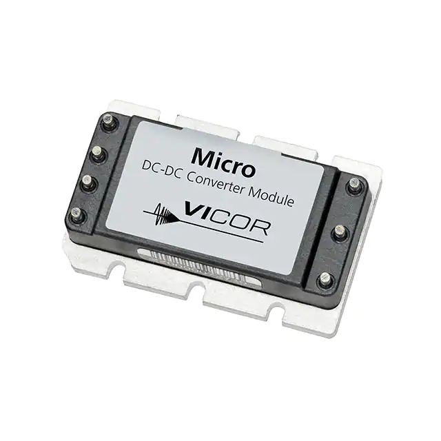

Micro Family 24V Input Actual size: 2.28 x 1.45 x 0.5in [57,9 x 36,8 x 12,7mm] ® C S US C NRTL US DC-DC Converter Module Features & Benefits Applications • DC input range: 18 – 36V • Isolated output Industrial and process control, distributed power, medical, ATE, communications, defense and aerospace. • Operation to 16V at 75% power after start up For details on proper operation please refer to the: Design Guide & Applications Manual for Maxi, Mini, Micro Family. • Input surge withstand: 50V for 100ms • DC output: 3.3 – 48V • Programmable output: 10 – 110% • Regulation: ±0.4% no load to full load • Efficiency: Up to 89% • Maximum operating temp: 100°C, full load • Power density: up to 91W per cubic inch • Height above board: 0.43in [10,9mm] • Parallelable, with N+M fault tolerance • Low-noise ZCS/ZVS architecture • RoHS Compliant (with F or G pin option) Product Overview Absolute Maximum Ratings Parameter Rating Unit +IN to –IN voltage –0.5 to +53 VDC PC to –IN voltage –0.5 to +7.0 VDC PR to –IN voltage –0.5 to +7.0 VDC SC to –OUT voltage –0.5 to +1.5 VDC Isolation voltage IN to OUT IN to base 3000 VRMS Test voltage 1500 VRMS Test voltage Test voltage 500 VRMS Operating Temperature OUT to base –55 to +100 °C Storage Temperature –65 to +125 °C 500 [260] °F [°C] 750 [390] °F [°C] in.lbs [N.m] Pin soldering temperature These DC-DC converter modules use advanced power processing, control and packaging technologies to provide the performance, flexibility, reliability and cost effectiveness of a mature power component. Mounting torque Notes 5 [0.57] M-Grade M-Grade 100ms off) No load No load to full load; nominal input Output voltage 95% of nominal Output voltage 100ms off) Dissipation, standby 1.6 3 Watts No load Load regulation ±0.02 ±0.2 % No load to full load; nominal input Load current 0 15.15 Amps Current limit 15.5 17.5 20.6 Amps Output voltage 95% of nominal Short circuit current 10.6 17.5 20.6 Amps Output voltage 100ms off) No load No load to full load nominal input Output voltage 95% of nominal Output voltage 100ms off) Dissipation, standby 3.2 4.8 Watts No load Load regulation ±0.02 ±0.2 % No load to full load; nominal input Load current 0 20 Amps Current limit 20.4 23 27 Amps Output voltage 95% of nominal Short circuit current 2 23 27 Amps Output voltage 100ms off) Dissipation, standby 1.3 2.1 Watts No load Load regulation ±0.02 ±0.2 % No load to full load; nominal input Load current 0 10 Amps Current limit 10.2 11.5 13.5 Amps Output voltage 95% of nominal Short circuit current 2 11.5 13.5 Amps Output voltage 100ms off) Dissipation, standby 3 3.4 Watts No load Load regulation ±0.02 ±0.2 % No load to full load; nominal input Load current 0 12.5 Amps Current limit 12.7 14.4 16.9 Amps Output voltage 95% of nominal Short circuit current 8.75 14.4 16.9 Amps Output voltage 100ms off) No load No load to full load nominal input Output voltage 95% of nominal Output voltage 100ms off) Dissipation, standby 4.4 6.1 Watts No load Load regulation ±0.02 ±0.2 % No load to full load; nominal input Load current 0 8.33 Amps Current limit 8.5 9.59 10.9 Amps Output voltage 95% of nominal Short circuit current 1.09 9.59 10.9 Amps Output voltage 100ms off) Dissipation, standby 1.8 2.6 Watts No load Load regulation ±0.02 ±0.2 % No load to full load; nominal input Load current 0 4.17 Amps Current limit 4.25 4.8 5.63 Amps Output voltage 95% of nominal Short circuit current 2.91 4.8 5.63 Amps Output voltage 100ms off) No load No load to full load nominal input Output voltage 95% of nominal Output voltage 100ms off) Dissipation, standby 4.6 7 Watts No load Load regulation ±0.02 ±0.2 % No load to full load; nominal input Load current 0 6.67 Amps Current limit 6.8 7.67 8.67 Amps Output voltage 95% of nominal Short circuit current 4.66 7.67 8.67 Amps Output voltage 100ms off) Dissipation, standby 1.8 2.6 Watts No load Load regulation ±0.02 ±0.2 % No load to full load; nominal input Load current 0 3.33 Amps Current limit 3.39 3.83 4.5 Amps Output voltage 95% of nominal Short circuit current 2.33 3.83 4.5 Amps Output voltage 100ms off) Dissipation, standby 4.0 5.0 Watts No load Load regulation ±0.02 ±0.2 % No load to full load; nominal input Load current 0.0 6.3 Amps Current limit 6.4 7.2 8.4 Amps Output voltage 95% of nominal Short circuit current 4.4 7.2 8.4 Amps Output voltage 100ms off) Dissipation, standby 3.6 5.4 Watts No load Load regulation ±0.02 ±0.2 % No load to full load; nominal input Load current 0 4.17 Amps Current limit 4.25 4.8 5.67 Amps Output voltage 95% of nominal Short circuit current 2.91 4.8 5.42 Amps Output voltage 100ms off) Dissipation, standby 2 3 Watts No load Load regulation ±0.02 ±0.2 % No load to full load; nominal input Load current 0 2.08 Amps Current limit 2.12 2.39 2.81 Amps Output voltage 95% of nominal Short circuit current 1.45 2.39 2.81 Amps Output voltage 100ms off) Dissipation, standby 4.2 6.2 Watts No load Load regulation ±0.02 ±0.2 % No load to full load; nominal input Load current 0 5.4 Amps Current limit 5.5 6.2 7.2 Amps Output voltage 95% of nominal Short circuit current 3.8 6.2 7.2 Amps Output voltage 100ms off) Dissipation, standby 3.3 5 Watts No load Load regulation ±0.02 ±0.2 % No load to full load; nominal input Load current 0 3.57 Amps Current limit 3.64 4.12 5 Amps Output voltage 95% of nominal Short circuit current 0.5 4.12 5 Amps Output voltage 100ms off) Dissipation, standby 1.8 2.7 Watts No load Load regulation ±0.02 ±0.2 % No load to full load; nominal input Load current 0 1.78 Amps Current limit 1.82 2.06 2.42 Amps Output voltage 95% of nominal Short circuit current 1.25 2.06 2.42 Amps Output voltage 100ms off) Dissipation, standby 3.7 4.3 Watts No load Load regulation ±0.02 ±0.2 % No load to full load; nominal input Load current 0 2.78 Amps Current limit 2.83 3.2 3.76 Amps Output voltage 95% of nominal Short circuit current 1.94 3.2 3.76 Amps Output voltage 100ms off) Dissipation, standby 1.8 2.3 Watts No load Load regulation ±0.02 ±0.2 % No load to full load; nominal input Load current 0 1.39 Amps Current limit 1.41 1.6 1.88 Amps Output voltage 95% of nominal Short circuit current 0.97 1.6 1.88 Amps Output voltage 100ms off) No load No load to full load nominal input Output voltage 95% of nominal Output voltage 100ms off) Dissipation, standby 3 5 Watts No load Load regulation ±0.02 ±0.2 % No load to full load; nominal input Load current 0 2.08 Amps Current limit 2.12 2.4 2.81 Amps Output voltage 95% of nominal Short circuit current 1.46 2.4 2.81 Amps Output voltage 100ms off) Dissipation, standby 2.1 3 Watts No load Load regulation ±0.02 ±0.2 % No load to full load; nominal input Load current 0 1.04 Amps Current limit 1.06 1.2 1.41 Amps Output voltage 95% of nominal Short circuit current 0.72 1.2 1.66 Amps Output voltage

物料型号: - 型号示例:V24C12T100BL2
器件简介: - VICOR Micro Family 24V输入的DC-DC转换模块,具有多种特性和优势,适用于工业和过程控制、分布式电源、医疗、自动化测试设备、通信、国防和航空等领域。
引脚分配: - +IN: 输入正极 - -IN: 输入负极 - +OUT: 输出正极 - -OUT: 输出负极 - PC: 主控制引脚,用于模块使能/禁用 - PR: 并行引脚,用于并行操作 - SC: 次级控制引脚,用于输出电压编程
参数特性: - 输入电压范围:18V至36V - 隔离输出:3.3V至48V,可编程输出10%至110% - 调节:±0.4%(从无负载到满载) - 效率:高达89% - 最大工作温度:100°C(满载) - 功率密度:每立方英寸高达91W - 符合RoHS标准
功能详解: - 高频ZCS/ZVS开关提供高功率密度、低噪声和高效率。 - 模块具有过压保护、欠压保护、过温保护等特性。 - 支持并行操作,具有N+1(N+M)冗余。
应用信息: - 适用于多种应用场景,包括但不限于工业控制、医疗设备、通信设备等。
封装信息: - 封装类型包括短引线、长引线、通孔和表面贴装等。 - 提供不同长度和表面处理选项,以适应不同的安装需求。
