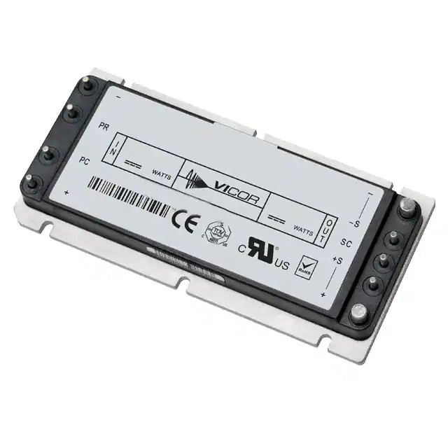

Maxi Family 28V Wide Input Actual size: 4.6 x 2.2 x 0.5in [117 x 56 x 12,7mm] ® C S US C NRTL US DC-DC Converter Module Features & Benefits Applications • DC input range: 9 – 36V [a] Industrial and process control, distributed power, medical, ATE, communications, defense, aerospace. • Isolated output • Input surge withstand: 50V for 100ms • DC output: 3.3 – 48V For details on proper operation please refer to the: Design Guide & Applications Manual for Maxi, Mini, Micro Family. • Programmable output: 10 – 110% • Regulation: ±0.2% no load to full load Absolute Maximum Ratings • Efficiency: Up to 85% • Maximum operating temp: 100°C Parameter • Power density: up to 40W per cubic inch +IN to –IN voltage –0.5 to +53 VDC • Height above board: 0.43in (10,9mm) PC to –IN voltage –0.5 to +7.0 VDC • Parallelable, with N+M fault tolerance PR to –IN voltage –0.5 to +7.0 VDC • Low-noise ZCS/ZVS architecture SC to –OUT voltage –0.5 to +1.5 VDC • RoHS Compliant (with F or G pin option) –Sense to –OUT voltage 1.0 VDC Product Overview These DC-DC converter modules use advanced power processing, control and packaging technologies to provide the performance, flexibility, reliability and cost effectiveness of a mature power component. High-frequency ZCS/ZVS switching provides high power density with low noise and high efficiency. Rating Unit Notes +OUT to –OUT, +Sense to –OUT See Module Output Specifications Isolation voltage IN to OUT 3000 VRMS Test voltage IN to base 1500 VRMS Test voltage OUT to base 500 VRMS Test voltage Operating Temperature –55 to +100 °C M-Grade Storage Temperature –65 to +125 °C M-Grade 500 [260] °F [°C] 100ms off) Dissipation, stand-by 12.7 13.7 Watts No load Load regulation ±0.02 ±0.2 % No load to full load; nominal input Load Current 0 13.33 Amps Current limit 13.5 15.3 20.6 Amps Output voltage 95% of nominal Short circuit current 9.31 15.3 20.6 Amps Output voltage 100ms off) Dissipation, stand-by 12.3 13.5 Watts No load Load regulation ±0.02 ±0.2 % No load to full load; nominal input Load Current 0 8.33 Amps Current limit 8.49 9.6 11.3 Amps Output voltage 95% of nominal Short circuit current 5.83 9.6 11.3 Amps Output voltage 100ms off) Dissipation, stand-by 15.5 18.0 Watts No load Load regulation ±0.02 ±0.2 % No load to full load; nominal input Load Current 0 7.14 Amps Current limit 7.28 8.2 10.0 Amps Output voltage 95% of nominal Short circuit current 4.99 8.2 10.0 Amps Output voltage 100ms off) Dissipation, stand-by 14.4 16.8 Watts No load Load regulation ±0.02 ±0.2 % No load to full load; nominal input Load Current 0 5.56 Amps Current limit 5.67 7.7 8.06 Amps Output voltage 95% of nominal Short circuit current 3.89 6.9 7.5 Amps Output voltage 100ms off) Dissipation, stand-by 15.6 18.3 Watts No load Load regulation ±0.02 ±0.2 % No load to full load; nominal input Load Current 0 4.17 Amps Current limit 4.25 4.4 5.84 Amps Output voltage 95% of nominal Short circuit current 2.92 4.8 5.43 Amps Output voltage

物料型号:VICOR品牌的DC-DC转换模块,例如V28A12T200BL2,输出电压3.3V至48V不等,具有不同的功率等级和封装类型。
器件简介:这些DC-DC转换模块利用先进的电源处理、控制和封装技术,提供高性能、灵活性、可靠性和成本效益的成熟电源组件。
引脚分配:模块具有多个引脚,包括+IN(输入正极)、-IN(输入负极)、+OUT(输出正极)、-OUT(输出负极)、PC(主控)、PR(并行)、SC(次控)等。
参数特性:包括输入电压范围9-36V,输出电压可编程调节,最高效率可达85%,最大操作温度100°C,功率密度高达每立方英寸40W。
功能详解:模块采用高频ZCS/ZVS开关技术,提供高功率密度、低噪声和高效率。模块还具有远程感测功能、过压保护、故障监控等。
应用信息:适用于工业和过程控制、分布式电源、医疗、自动化测试设备、通信、国防、航空等领域。
封装信息:模块具有多种封装类型,包括短引线、长引线、ModuMate和RoHS兼容封装等。
