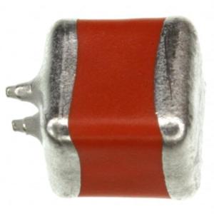

597D Vishay Sprague Solid Tantalum Chip Capacitors TANTAMOUNT®, Ultra-Low ESR, Conformal Coated, Maximum CV FEATURES • New case size offerings • Case profiles: E case (4 mm) and R case (3.6 mm) • Low profile case: V case (2 mm) • Terminations: Tin (2) standard • Extremely low ESR • Ripple current up to 4.1 A Pb-free Available RoHS* COMPLIANT PERFORMANCE CHARACTERISTICS Operating Temperature: - 55 °C to + 85 °C (To + 125 °C with voltage derating) Note: Refer to doc. 40088 Capacitance Range: 15 µF to 1500 µF Capacitance Tolerance: ± 10 %, ± 20 % standard Voltage Rating: 4 WVDC to 63 WVDC ORDERING INFORMATION 597D TYPE 687 CAPACITANCE This is expressed in picofarads. The first two digits are the significant figures. The third is the number of zeros to follow. X0 CAPACITANCE TOLERANCE X0 = ± 20 % X9 = ± 10 % 6R3 DC VOLTAGE RATING AT + 85 °C This is expressed in volts. To complete the three-digit block, zeros precede the voltage rating. A decimal point is indicated by an “R” (6R3 = 6.3 V). E CASE CODE See Ratings and Case Codes Table 2 TERMINATION 2 = 100 % Tin 8 = Solder Plated (60/40) Special Order T REEL SIZE AND PACKAGING T =Tape and Reel 7" [500] Reel W = 13" [N/A] Reel Note: Preferred Tolerance and reel sizes are in bold. We reserve the right to supply higher voltage ratings and tighter capacitance tolerance capacitors in the same case size Voltage substitutions will be marked with the higher voltage rating DIMENSIONS in inches [millimeters] Tantalum wire Nib identifies Anode (+) Terminal L W J D B A H CASE CODE E F R V Z L (MAX.) 0.287 ± 0.012 [7.3 ± 0.3] 0.287 ± 0.012 [7.3 ± 0.3] 0.287 ± 0.012 [7.3 ± 0.3] 0.287 ± 0.012 [7.3 ± 0.3] 0.287 ± 0.012 [7.3 ± 0.3] W 0.173 ± 0.016 [4.4 ± 0.4] 0.238 ± 0.016 [6.0 ± 0.4] 0.238 + 0.016/- 0.024 [6.0 + 0.4/- 0.6] 0.173 ± 0.016 [4.4 ± 0.4] 0.238 ± 0.016 [6.0 ± 0.4] H 0.157 ± 0.016 [4.0 ± 0.4] 0.187 ± 0.016 [4.7 ± 0.4] 0.142 ± 0.016 [3.6 ± 0.4] 0.079 [2.0] Max. 0.238 ± 0.016 [6.0 ± 0.4] A 0.051 ± 0.012 [1.3 ± 0.3] 0.051 ± 0.012 [1.3 ± 0.3] 0.051 ± 0.012 [1.3 ± 0.3] 0.051 ± 0.012 [1.3 ± 0.3] 0.051 ± 0.012 [1.3 ± 0.3] B 0.180 ± 0.025 [4.6 ± 0.6] 0.180 ± 0.025 [4.6 ± 0.6] 0.180 ± 0.025 [4.6 ± 0.6] 0.180 ± 0.025 [4.6 ± 0.6] 0.180 ± 0.025 [4.6 ± 0.6] D (REF.) 0.253 [6.4] 0.243 [6.2] 0.243 [6.2] 0.253 [6.4] 0.243 [6.2] J (MAX.) 0.004 [0.1] 0.004 [0.1] 0.004 [0.1] 0.004 [0.1] 0.004 [0.1] Note: The anode termination (D less B) will be a minimum of 0.012" [0.3 mm] * Pb containing terminations are not RoHS compliant, exemptions may apply Document Number: 40047 Revision: 01-Aug-08 For technical questions, contact: tantalum@vishay.com www.vishay.com 107 597D Vishay Sprague Solid Tantalum Chip Capacitors TANTAMOUNT®, Ultra-Low ESR, Conformal Coated, Maximum CV 6.3 V 10 V 16 V 20 V 25 V 35 V 50 V E/R R F Z* 63 V 75 V RATINGS AND CASE CODE µF 10 15 22 33 47 68 100 150 220 330 470 680 1000 1500 2200 4V F* R R F E V E E/R R V E E R E E R F* R F* STANDARD RATINGS CAPACITANCE (µF) 470 680 1000 1000 1500 330 470 680 1000 330 470 680 220 470 220 330 68 150 47 15 15 22 33 47 CASE CODE MAX. DCL MAX. DF MAX. ESR AT + 25 °C AT + 25 °C AT + 25 °C (µA) 120 Hz (%) 100 kHz (mΩ) 4 WVDC AT + 85 °C, SURGE = 5.2 V . . . 2.7 WVDC AT + 125 °C, SURGE = 3.4 V V 597D477X_004V__ 19 8 30 E 597D687X_004E__ 27 6 25 E 597D108X_004E__ 40 8 20 R 597D108X_004R__ 40 8 18 R 597D158X_004R__ 60 8 15 6.3 WVDC AT + 85 °C, SURGE = 8 V . . . 4 WVDC AT + 125 °C, SURGE = 5 V V 597D337X_6R3V__ 21 8 35 E 597D477X_6R3E__ 30 6 30 E 597D687X_6R3E__ 43 6 25 R 597D108X_6R3R__ 63 8 20 10 WVDC AT + 85 °C, SURGE = 13 V . . . 7 WVDC AT + 125 °C, SURGE = 8 V E 597D337X_010E__ 33 6 35 E 597D477X_010E__ 47 6 28 R 597D687X_010R__ 68 6 28 16 WVDC AT + 85 °C, SURGE = 20 V . . . 10 WVDC AT + 125 °C, SURGE = 12 V E 597D227X_016E__ 35 8 40 F 597D477X_016F__ * 75 14 100 20 WVDC AT + 85 °C, SURGE = 26 V . . . 13 WVDC AT + 125 °C, SURGE = 16 V R 597D227X_020R__ 44 8 80 F 597D337X_020F__* 66 10 100 25 WVDC AT + 85 °C, SURGE = 32 V . . . 17 WVDC AT + 125 °C, SURGE = 20 V 17 6 100 R 597D686X_025R__ 38 8 80 F 597D157X_025F__ 35 WVDC AT + 85 °C, SURGE = 46 V . . . 23 WVDC AT + 125 °C, SURGE = 28 V R 597D476X_035R__ 17 6 80 50 WVDC AT + 85 °C, SURGE = 65 V . . . 33 WVDC AT + 125 °C, SURGE = 38 V E 597D156X_050E__ 8 6 300 R 597D156X_050R__ 8 6 250 R 597D226X_050R__ 11 6 170 F 597D336X_050F__ 17 6 150 Z 597D476X_050Z__* 24 6 145 63 WVDC AT + 85 °C, SURGE = 81 V . . . 42 WVDC AT + 125 °C, SURGE = 54 V F 597D226X_063F__* 14 6 200 PART NUMBER MAX. RIPPLE 100 kHz IRMS (A) 2.2 2.9 3.3 3.7 4.1 2.0 2.7 2.9 3.5 2.5 2.8 2.9 2.3 1.4 1.8 1.4 1.6 1.8 1.8 0.8 1.0 0.8 0.8 1.1 0.9 22 Note: * Contact factory for availability www.vishay.com 108 For technical questions, contact: tantalum@vishay.com Document Number: 40047 Revision: 01-Aug-08 597D Solid Tantalum Chip Capacitors TANTAMOUNT®, Ultra-Low ESR, Conformal Coated, Maximum CV TYPICAL CURVES T97 1500 µF - 4 V 'R' CASE SIZE ESR and Z vs. FREQUENCY 1 ESR ESR and Z (Ω) ESR and Z (Ω) Vishay Sprague T97 330 µF - 10 V 'E' CASE SIZE ESR and Z vs. FREQUENCY 1 ESR Z Z 0.1 0.1 0.01 100 Hz 1 kHz 10 kHz FREQUENCY 100 kHz 1 MHz 0.01 100 Hz 1 kHz 10 kHz FREQUENCY (Hz ) 100 kHz 1 MHz T97 1000 µF - 4 V 'E' CASE SIZE ESR and Z vs. FREQUENCY 1 ESR T97 1000 µF - 6.3 V 'R' CASE SIZE ESR and Z vs. FREQUENCY 1 ESR ESR and Z (Ω) Z ESR and Z (Ω) Z 0.1 0.1 0.01 100 Hz 1 kHz 10 kHz FREQUENCY 100 kHz 1 MHz 0.01 100 Hz 1 kHz 10 kHz FREQUENCY 100 kHz 1 MHz T97 330 µF - 6.3 V 'V' CASE SIZE ESR and Z vs. FREQUENCY 10 ESR T97 470 µF - 4 V 'V' CASE SIZE ESR and Z vs. FREQUENCY 10 ESR ESR and Z (Ω) ESR and Z (Ω) 1 Z 1 Z 0.1 0.1 0.01 100 Hz 1 kHz 10 kHz FREQUENCY 100 kHz 1 MHz 0.01 100 Hz 1 kHz 10 kHz FREQUENCY 100 kHz 1 MHz Document Number: 40047 Revision: 01-Aug-08 For technical questions, contact: tantalum@vishay.com www.vishay.com 109 Legal Disclaimer Notice Vishay Disclaimer All product specifications and data are subject to change without notice. Vishay Intertechnology, Inc., its affiliates, agents, and employees, and all persons acting on its or their behalf (collectively, “Vishay”), disclaim any and all liability for any errors, inaccuracies or incompleteness contained herein or in any other disclosure relating to any product. Vishay disclaims any and all liability arising out of the use or application of any product described herein or of any information provided herein to the maximum extent permitted by law. The product specifications do not expand or otherwise modify Vishay’s terms and conditions of purchase, including but not limited to the warranty expressed therein, which apply to these products. No license, express or implied, by estoppel or otherwise, to any intellectual property rights is granted by this document or by any conduct of Vishay. The products shown herein are not designed for use in medical, life-saving, or life-sustaining applications unless otherwise expressly indicated. Customers using or selling Vishay products not expressly indicated for use in such applications do so entirely at their own risk and agree to fully indemnify Vishay for any damages arising or resulting from such use or sale. Please contact authorized Vishay personnel to obtain written terms and conditions regarding products designed for such applications. Product names and markings noted herein may be trademarks of their respective owners. Document Number: 91000 Revision: 18-Jul-08 www.vishay.com 1

1. 物料型号: - 型号为Vishay Sprague的Solid Tantalum Chip Capacitors,TANTAMOUNT®系列。
2. 器件简介: - 该器件为超低ESR(等效串联电阻)、共形涂层、最大电容电压(CV)的固体钽电容芯片。
3. 引脚分配: - 钽线突出部分标识阳极(+)端子。
4. 参数特性: - 工作温度范围:-55°C至+85°C(电压降额可至+125°C)。 - 电容范围:15µF至1500µF。 - 电容公差:±10%,±20%为标准。 - 电压额定值:4VDC至63VDC。
5. 功能详解: - 新的封装尺寸提供。 - 极低的ESR值。 - 纹波电流可达到4.1A。
6. 应用信息: - 该系列电容适用于需要高可靠性和稳定性的应用场合。
7. 封装信息: - 提供E封装(4mm)、R封装(3.6mm)、V封装(2mm)等不同尺寸。 - 封装尺寸详细数据以表格形式给出,包括长度、宽度、高度等参数。
