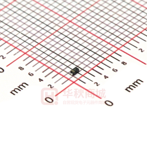

BAS70-02V-V-G Vishay Semiconductors Small Signal Schottky Diode Features • This diode features very low turn-on voltage and fast switching • This device is protected by a PN junction guard ring against excessive voltage, such as electrostatic discharges • Space saving SOD-523 package • Compliant to RoHS Directive 2002/95/EC and in accordance to WEEE 2002/96/EC 1 19344 2 22321 Mechanical Data Case: SOD-523 Weight: approx. 1.4 mg Molding compound flammability rating: UL 94 V-0 Terminals: high temperature soldering guaranteed: 260 °C/10 s at terminals Packaging codes/options: 08/3K per 7" reel (8 mm tape), 15K/box Parts Table Part BAS70-02V-V-G Ordering code BAS70-02V-V-G-08 Type marking Remarks Tape and reel .X Absolute Maximum Ratings Tamb = 25 °C, unless otherwise specified Parameter Repetitive peak reverse voltage Forward continuous current Surge forward current Power dissipation Test condition Symbol VRRM IF IFSM Ptot Value 70 100 600 150 Unit V mA mA mW Thermal Characteristics Tamb = 25 °C, unless otherwise specified Parameter Thermal resistance junction to ambient air Junction temperature Storage temperature range Test condition Symbol RthJA Tj Tstg Value 680 125 - 55 to +150 Unit K/W °C °C ** Please see document “Vishay Material Category Policy”: www.vishay.com/doc?99902 Document Number 82393 Rev. 1.0, 14-Oct-10 For technical questions within your region, please contact one of the following: DiodesAmericas@vishay.com, DiodesAsia@vishay.com, DiodesEurope@vishay.com www.vishay.com 1 BAS70-02V-V-G Vishay Semiconductors Electrical Characteristics Tamb = 25 °C, unless otherwise specified Parameter Reverse breakdown voltage Leakage current Forward voltage Diode capacitance Reverse recovery time Test condition IR = 10 µA (pulsed) VR = 50 V, tp < 300 µs tp < 300 µs, IF = 1.0 mA tp < 300 µs, IF = 15 mA VR = 0 V, f = 1 MHz IF = 10 mA, IR = 10 mA, Irr = 1 mA, RL = 100 Ω Symbol V(BR) IR VF VF CD trr 1.5 Min. 70 20 100 410 1000 2 5 Typ. Max. Unit V nA mV mV pF ns Package Dimensions in millimeters (inches): SOD-523 0.7 (0.028) 0.9 (0.035) 0.7 (0.028) 0.4 (0.016) 0.5 (0.020) 1.45 (0.057) 0.35 (0.014) 1.7 (0.067) 1.5 (0.059) 0.1 (0.004) max. 0.20 (0.008) 0.08 (0.003) foot print recommendation: 0.35 (0.014) 0.18 (0.007) 1.3 (0.051) 1.1 (0.043) Document no.: S8-V-3880.02-001 (4) Rev. h - Date: 13. Oct. 2010 16864 www.vishay.com 2 For technical questions within your region, please contact one of the following: Document Number 82393 DiodesAmericas@vishay.com, DiodesAsia@vishay.com, DiodesEurope@vishay.com Rev. 1.0, 14-Oct-10 Legal Disclaimer Notice Vishay Disclaimer ALL PRODUCT, PRODUCT SPECIFICATIONS AND DATA ARE SUBJECT TO CHANGE WITHOUT NOTICE TO IMPROVE RELIABILITY, FUNCTION OR DESIGN OR OTHERWISE. Vishay Intertechnology, Inc., its affiliates, agents, and employees, and all persons acting on its or their behalf (collectively, “Vishay”), disclaim any and all liability for any errors, inaccuracies or incompleteness contained in any datasheet or in any other disclosure relating to any product. Vishay makes no warranty, representation or guarantee regarding the suitability of the products for any particular purpose or the continuing production of any product. To the maximum extent permitted by applicable law, Vishay disclaims (i) any and all liability arising out of the application or use of any product, (ii) any and all liability, including without limitation special, consequential or incidental damages, and (iii) any and all implied warranties, including warranties of fitness for particular purpose, non-infringement and merchantability. Statements regarding the suitability of products for certain types of applications are based on Vishay’s knowledge of typical requirements that are often placed on Vishay products in generic applications. Such statements are not binding statements about the suitability of products for a particular application. It is the customer’s responsibility to validate that a particular product with the properties described in the product specification is suitable for use in a particular application. Parameters provided in datasheets and/or specifications may vary in different applications and performance may vary over time. All operating parameters, including typical parameters, must be validated for each customer application by the customer’s technical experts. Product specifications do not expand or otherwise modify Vishay’s terms and conditions of purchase, including but not limited to the warranty expressed therein. Except as expressly indicated in writing, Vishay products are not designed for use in medical, life-saving, or life-sustaining applications or for any other application in which the failure of the Vishay product could result in personal injury or death. Customers using or selling Vishay products not expressly indicated for use in such applications do so at their own risk and agree to fully indemnify and hold Vishay and its distributors harmless from and against any and all claims, liabilities, expenses and damages arising or resulting in connection with such use or sale, including attorneys fees, even if such claim alleges that Vishay or its distributor was negligent regarding the design or manufacture of the part. Please contact authorized Vishay personnel to obtain written terms and conditions regarding products designed for such applications. No license, express or implied, by estoppel or otherwise, to any intellectual property rights is granted by this document or by any conduct of Vishay. Product names and markings noted herein may be trademarks of their respective owners. Document Number: 91000 Revision: 11-Mar-11 www.vishay.com 1
