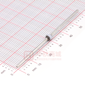

BY228-13 , BY228-15 Vishay Semiconductors Standard Avalanche Sinterglass Diode FEATURES • Glass passivated junction • Hermetically sealed package • Compliant to RoHS directive 2002/95/EC and in accordance to WEEE 2002/96/EC • Halogen-free according to IEC 61249-2-21 definition 949588 APPLICATIONS • High voltage rectification • Effficiency diode in horizontal deflection circuits MECHANICAL DATA Case: SOD-64 Terminals: plated axial leads, solderable per MIL-STD-750, method 2026 Polarity: color band denotes cathode end Mounting position: any Weight: approx. 858 mg PARTS TABLE PART BY228-13 BY228-15 TYPE DIFFERENTIATION VR = 1000 V; IFAV = 3 A VR = 1200 V; IFAV = 3 A PACKAGE SOD-64 SOD-64 ABSOLUTE MAXIMUM RATINGS (Tamb = 25 °C, unless otherwise specified) PARAMETER Peak reverse voltage, non repetitive Reverse voltage Peak forward surge current Average forward current Junction temperature Storage temperature range Non repetitive reverse avalanche energy l (BR)R = 0.4 A TEST CONDITION lR = 100 μA See electrical characteristics tp = 10 ms, half sine wave PART BY228-13 BY228-15 BY228-13 BY228-15 SYMBOL VRSM VRSM VR VR IFSM IFAV Tj Tstg ER VALUE 1300 1500 1000 1200 50 3 140 - 55 to + 175 10 UNIT V V V V A A °C °C mJ MAXIMUM THERMAL RESISTANCE (Tamb = 25 °C, unless otherwise specified) PARAMETER Junction ambient TEST CONDITION On PC board with spacing 25 mm SYMBOL RthJA VALUE 70 UNIT K/W www.vishay.com 144 For technical questions within your region, please contact one of the following: DiodesAmericas@vishay.com, DiodesAsia@vishay.com, DiodesEurope@vishay.com Document Number: 86004 Rev. 1.7, 09-Aug-10 BY228-13 , BY228-15 Standard Avalanche Sinterglass Diode Vishay Semiconductors ELECTRICAL CHARACTERISTICS (Tamb = 25 °C, unless otherwise specified) PARAMETER Forward voltage TEST CONDITION IF = 5 A VR = 1000 V Reverse current VR = 1200 V VR = 1000 V, Tj = 140 °C VR = 1200 V, Tj = 140 °C Total reverse recovery time Reverse recovery time lF = 1 A, - dIF/dt = 0.05 A/μs IF = 0.5 A, IR = 1 A, iR = 0.25 A BY228-13 BY228-15 BY228-13 BY228-15 PART SYMBOL VF IR IR IR IR trr trr MIN. TYP. 2 2 MAX 1.5 5 5 140 140 20 2 UNIT V μA μA μA μA μs μs TYPICAL CHARACTERISTICS (Tamb = 25 °C, unless otherwise specified) RthJA - Ther. Resist. Junction/Ambient (K/W) 40 3.5 IFAV - Average Forward Current (A) VR = VRRM 3.0 2.5 2.0 1.5 1.0 0.5 0 RthJA = 70 K/W PCB: d = 25 mm 0 25 50 75 100 125 150 half sine wave RthJA = 25 K/W l = 10 mm 30 20 l l 10 TL = constant 0 0 94 9081 5 10 15 20 25 30 16403 l - Lead Length (mm) Tamb - Ambient Temperature (°C) Fig. 1 - Typ. Thermal Resistance vs. Lead Length Fig. 3 - Max. Average Forward Current vs. Ambient Temperature 100 1000 VR = VRRM 100 IF - Forward Current (A) 10 Tj = 150 °C 1 Tj = 25 °C 0.1 IR - Reverse Current (μA) 2.0 2.5 3.0 10 0.01 0.001 0.0 16402 1 0.5 1.0 1.5 25 16404 50 75 100 125 150 VF - Forward Voltage (V) Tj - Junction Temperature (°C) Fig. 2 - Forward Current vs. Forward Voltage Fig. 4 - Reverse Current vs. Junction Temperature Document Number: 86004 Rev. 1.7, 09-Aug-10 For technical questions within your region, please contact one of the following: DiodesAmericas@vishay.com, DiodesAsia@vishay.com, DiodesEurope@vishay.com www.vishay.com 145 BY228-13 , BY228-15 Vishay Semiconductors Standard Avalanche Sinterglass Diode PR - Reverse Power Dissipation (mW) 350 VR = VRRM 300 250 PR - Limit at 100 % VR 200 150 PR - Limit at 80 % VR 100 50 0 25 50 75 100 125 150 70 f = 1 MHz CD - Diode Capacitance (pF) 60 50 40 30 20 10 0 0.1 1 10 100 16405 Tj - Junction Temperature (°C) 16406 VR - Reverse Voltage (V) Fig. 5 - Diode Capacitance vs. Reverse Voltage Fig. 6 - Diode Capacitance vs. Reverse Voltage PACKAGE DIMENSIONS in millimeters (inches): SOD-64 Sintered Glass Case SOD-64 4.3 (0.168) max. Cathode Identification 1.35 (0.053) max. 26(1.014) min. 4 (0.156) max. 26 (1.014) min. Document-No.: 6.563-5006.4-4 Rev. 3 - Date: 09.February.2005 94 9587 www.vishay.com 146 For technical questions within your region, please contact one of the following: DiodesAmericas@vishay.com, DiodesAsia@vishay.com, DiodesEurope@vishay.com Document Number: 86004 Rev. 1.7, 09-Aug-10 Legal Disclaimer Notice Vishay Disclaimer ALL PRODUCT, PRODUCT SPECIFICATIONS AND DATA ARE SUBJECT TO CHANGE WITHOUT NOTICE TO IMPROVE RELIABILITY, FUNCTION OR DESIGN OR OTHERWISE. Vishay Intertechnology, Inc., its affiliates, agents, and employees, and all persons acting on its or their behalf (collectively, “Vishay”), disclaim any and all liability for any errors, inaccuracies or incompleteness contained in any datasheet or in any other disclosure relating to any product. Vishay makes no warranty, representation or guarantee regarding the suitability of the products for any particular purpose or the continuing production of any product. To the maximum extent permitted by applicable law, Vishay disclaims (i) any and all liability arising out of the application or use of any product, (ii) any and all liability, including without limitation special, consequential or incidental damages, and (iii) any and all implied warranties, including warranties of fitness for particular purpose, non-infringement and merchantability. Statements regarding the suitability of products for certain types of applications are based on Vishay’s knowledge of typical requirements that are often placed on Vishay products in generic applications. Such statements are not binding statements about the suitability of products for a particular application. It is the customer’s responsibility to validate that a particular product with the properties described in the product specification is suitable for use in a particular application. Parameters provided in datasheets and/or specifications may vary in different applications and performance may vary over time. All operating parameters, including typical parameters, must be validated for each customer application by the customer’s technical experts. Product specifications do not expand or otherwise modify Vishay’s terms and conditions of purchase, including but not limited to the warranty expressed therein. Except as expressly indicated in writing, Vishay products are not designed for use in medical, life-saving, or life-sustaining applications or for any other application in which the failure of the Vishay product could result in personal injury or death. Customers using or selling Vishay products not expressly indicated for use in such applications do so at their own risk and agree to fully indemnify and hold Vishay and its distributors harmless from and against any and all claims, liabilities, expenses and damages arising or resulting in connection with such use or sale, including attorneys fees, even if such claim alleges that Vishay or its distributor was negligent regarding the design or manufacture of the part. Please contact authorized Vishay personnel to obtain written terms and conditions regarding products designed for such applications. No license, express or implied, by estoppel or otherwise, to any intellectual property rights is granted by this document or by any conduct of Vishay. Product names and markings noted herein may be trademarks of their respective owners. Document Number: 91000 Revision: 11-Mar-11 www.vishay.com 1
