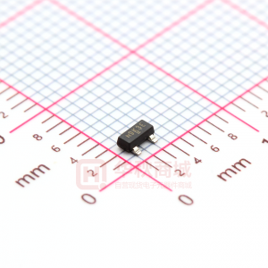

    SI2309CDS - P-Channel 60-V (D-S) MOSFET - Vishay Siliconix
SI2309CDS 数据手册
New Product Si2309CDS Vishay Siliconix P-Channel 60-V (D-S) MOSFET PRODUCT SUMMARY VDS (V) - 60 RDS(on) (Ω) 0.345 at VGS = - 10 V 0.450 at VGS = - 4.5 V ID (A)d - 1.6 - 1.4 Qg (Typ.) 2.7 nC FEATURES • Halogen-free Option Available • TrenchFET® Power MOSFET APPLICATIONS • Load Switch TO-236 (SOT-23) G 1 3 D S S 2 G Top View Si2309CDS (N9)* * Marking Code Ordering Information: Si2309CDS-T1-E3 (Lead (Pb)-free) Si2309CDS-T1-GE3 (Lead (Pb)-free and Halogen-free) D P-Channel MOSFET ABSOLUTE MAXIMUM RATINGS TA = 25 °C, unless otherwise noted Parameter Drain-Source Voltage Gate-Source Voltage TC = 25 °C Continuous Drain Current (TJ = 150 °C)a, b TC = 70 °C TA = 25 °C TA = 70 °C Pulsed Drain Current (10 µs Pulse Width) Single Pulse Avalanche Current Continuous Source-Drain Diode Current L = 0.1 mH TC = 25 °C TA = 25 °C TC = 25 °C TC = 70 °C Maximum Power Dissipation TA = 25 °C TA = 70 °C Operating Junction and Storage Temperature Range Soldering Recommendations (Peak Temperature)c TJ, Tstg PD IDM IAS IS ID Symbol VDS VGS Limit - 60 ± 20 - 1.6 - 1.3 - 1.2a, b - 1.0a, b -8 -5 - 1.4 - 0.9a, b 1.7 1.1 1.0a, b 0.67a, b - 55 to 150 260 °C W A Unit V THERMAL RESISTANCE RATINGS Parameter Maximum Junction-to-Ambienta, c t≤5s Steady State Maximum Junction-to-Foot (Drain) Notes: a. Surface Mounted on 1" x 1" FR4 board. b. t = 5 s. c. Maximum under Steady State conditions is 166 °C/W. d. When TC = 25 °C. Document Number: 68980 S-82584-Rev. A, 27-Oct-08 www.vishay.com 1 Symbol RthJA RthJF Typical 92 58 Maximum 120 73 Unit °C/W New Product Si2309CDS Vishay Siliconix SPECIFICATIONS TJ = 25 °C, unless otherwise noted Parameter Static Drain-Source Breakdown Voltage VDS Temperature Coefficient VGS(th) Temperature Coefficient Gate-Source Threshold Voltage Gate-Source Leakage Zero Gate Voltage Drain Current On-State Drain Currenta Drain-Source On-State Resistancea Forward Transconductancea Dynamic b Symbol VDS ΔVDS/TJ ΔVGS(th)/TJ VGS(th) IGSS IDSS ID(on) RDS(on) gfs Ciss Coss Crss Qg Qgs Qgd Rg td(on) tr td(off) tf td(on) tr td(off) tf IS ISM VSD trr Qrr ta tb Test Conditions VGS = 0 V, ID = - 250 µA ID = - 250 µA VDS = VGS, ID = - 250 µA VDS = 0 V, VGS = ± 20 V VDS = - 60 V, VGS = 0 V VDS = - 60 V, VGS = 0 V, TJ = 55 °C VDS ≤ 5 V, VGS = - 10 V VGS = - 10 V, ID = - 1.25 A VGS = - 4.5 V, ID = - 1.0 A VDS = - 10 V, ID = - 1.0 A Min. - 60 Typ. Max. Unit V - 65 4.5 -1 -3 - 100 -1 - 10 -6 0.285 0.360 2.8 0.345 0.450 mV/°C V nA µA A Ω S Input Capacitance Output Capacitance Reverse Transfer Capacitance Total Gate Charge Gate-Source Charge Gate-Drain Charge Gate Resistance Turn-On Delay Time Rise Time Turn-Off Delay Time Fall Time Turn-On Delay Time Rise Time Turn-Off Delay Time Fall Time Drain-Source Body Diode Characteristics Continuous Source-Drain Diode Current Pulse Diode Forward Current Body Diode Voltage Body Diode Reverse Recovery Time Body Diode Reverse Recovery Charge Reverse Recovery Fall Time Reverse Recovery Rise Time 210 VDS = - 30 V, VGS = 0 V, f = 1 MHz 28 20 2.7 VDS = - 30 V, VGS = - 4.5 V, ID = - 1.25 A f = 1 MHz VDD = - 30 V, RL = 30 Ω ID ≅ - 1 A, VGEN = - 4.5 V, Rg = 1 Ω 0.8 1.2 7 40 35 15 10 5 VDD = - 30 V, RL = 30 Ω ID ≅ - 1 A, VGEN = - 10 V, Rg = 1 Ω 10 15 10 TC = 25 °C IS = - 0.75 A, VGS = 0 V - 0.8 30 IF = - 1.25 A, dI/dt = 100 A/µs, TJ = 25 °C 33 18 12 60 55 25 20 10 20 25 20 - 1.4 -8 - 1.2 60 60 ns Ω 4.1 nC pF A V ns nC ns Notes: a. Pulse test; pulse width ≤ 300 µs, duty cycle ≤ 2 %. b. Guaranteed by design, not subject to production testing. Stresses beyond those listed under “Absolute Maximum Ratings” may cause permanent damage to the device. These are stress ratings only, and functional operation of the device at these or any other conditions beyond those indicated in the operational sections of the specifications is not implied. Exposure to absolute maximum rating conditions for extended periods may affect device reliability. www.vishay.com 2 Document Number: 68980 S-82584-Rev. A, 27-Oct-08 New Product Si2309CDS Vishay Siliconix TYPICAL CHARACTERISTICS 25 °C, unless otherwise noted 8 VGS = 10 thru 5 V 2.0 I D - Drain Current (A) VGS = 4 V 4 I D - Drain Current (A) 6 1.5 1.0 2 VGS = 3 V 0 0 1 2 3 4 5 0.5 TC = 25 °C TC = 125 °C 0.0 0 1 2 3 TC = - 55 °C 4 5 VDS - Drain-to-Source Voltage (V) VGS - Gate-to-Source Voltage (V) Output Characteristics 0.8 350 Transfer Characteristics R DS(on) - On-Resistance (Ω) 280 0.6 VGS = 4.5 V 0.4 VGS = 10 V C - Capacitance (pF) 210 Ciss 140 0.2 70 Crss 0.0 0 2 4 ID - Drain Current (A) 6 8 0 0 15 30 45 60 Coss VDS - Drain-to-Source Voltage (V) On-Resistance vs. Drain Current and Gate Voltage 10 ID = 1.25 A VGS - Gate-to-Source Voltage (V) 8 VDS = 15 V 6 VDS = 30 V R DS(on) - On-Resistance 1.7 2.0 ID = 1.25 A Capacitance VGS = 10 V (Normalized) 1.4 VGS = 4.5 V 1.1 4 VDS = 45 V 2 0.8 0 0 1 2 3 4 5 0.5 - 50 - 25 0 25 50 75 100 125 150 Qg - Total Gate Charge (nC) TJ - Junction Temperature (°C) Gate Charge Document Number: 68980 S-82584-Rev. A, 27-Oct-08 On-Resistance vs. Junction Temperature www.vishay.com 3 New Product Si2309CDS Vishay Siliconix TYPICAL CHARACTERISTICS 25 °C, unless otherwise noted 100 2.0 ID = 1.25 A R DS(on) - On-Resistance (Ω) 10 I S - Source Current (A) TJ = 150 °C 1 TJ = 25 °C 1.6 1.2 0.1 TJ = - 50 °C 0.01 0.8 TJ = 125 °C 0.4 TJ = 25 °C 0.001 0.0 0.0 0.3 0.6 0.9 1.2 1.5 0 2 4 6 8 10 VGS - Gate-to-Source Voltage (V) VSD - Source-to-Drain Voltage (V) Source-Drain Diode Forward Voltage 0.6 ID = 250 µA 0.4 6 VGS(th) Variance (V) 0.2 Power (W) ID = 1 mA 8 On-Resistance vs. Gate-to-Source Voltage TA = 25 °C 4 0.0 2 - 0.2 - 0.4 - 50 - 25 0 25 50 75 100 125 150 0 0.01 0.1 1 Time (s) 10 100 1000 TJ - Temperature (°C) Threshold Voltage 10 Limited by RDS(on)* Single Pulse Power, Junction-to-Ambient 10 µs I D - Drain Current (A) 1 100 µs 1 ms 10 ms 0.1 100 ms TA = 25 °C Single Pulse 0.01 0.1 1 10 1 s, 10 s 100 s, DC 100 VDS - Drain-to-Source Voltage (V) * VGS > minimum VGS at which RDS(on) is specified Safe Operating Area, Junction-to-Ambient www.vishay.com 4 Document Number: 68980 S-82584-Rev. A, 27-Oct-08 New Product Si2309CDS Vishay Siliconix TYPICAL CHARACTERISTICS 25 °C, unless otherwise noted 1 Duty Cycle = 0.5 Normalized Effective Transient Thermal Impedance 0.2 0.1 0.1 0.05 0.02 Notes: PDM t1 t2 1. Duty Cycle, D = t1 t2 2. Per Unit Base = RthJA = 166 °C/W Single Pulse 0.01 10 -4 10 -3 10 -2 10 -1 1 Square Wave Pulse Duration (s) 10 3. TJM - TA = PDMZthJA(t) 4. Surface Mounted 100 1000 Normalized Thermal Transient Impedance, Junction-to-Ambient 1 Duty Cycle = 0.5 Normalized Effective Transient Thermal Impedance 0.2 0.1 0.1 0.05 0.02 Notes: PDM t1 t2 1. Duty Cycle, D = t1 t2 2. Per Unit Base = RthJA = 73 °C/W 3. TJM - TA = PDMZthJA(t) Single Pulse 0.01 10 -4 10 -3 10 -2 10 -1 4. Surface Mounted 1 10 Square Wave Pulse Duration (s) Normalized Thermal Transient Impedance, Junction-to-Foot Vishay Siliconix maintains worldwide manufacturing capability. Products may be manufactured at one of several qualified locations. Reliability data for Silicon Technology and Package Reliability represent a composite of all qualified locations. For related documents such as package/tape drawings, part marking, and reliability data, see http://www.vishay.com/ppg?68980. Document Number: 68980 S-82584-Rev. A, 27-Oct-08 www.vishay.com 5 Legal Disclaimer Notice Vishay Disclaimer All product specifications and data are subject to change without notice. Vishay Intertechnology, Inc., its affiliates, agents, and employees, and all persons acting on its or their behalf (collectively, “Vishay”), disclaim any and all liability for any errors, inaccuracies or incompleteness contained herein or in any other disclosure relating to any product. Vishay disclaims any and all liability arising out of the use or application of any product described herein or of any information provided herein to the maximum extent permitted by law. The product specifications do not expand or otherwise modify Vishay’s terms and conditions of purchase, including but not limited to the warranty expressed therein, which apply to these products. No license, express or implied, by estoppel or otherwise, to any intellectual property rights is granted by this document or by any conduct of Vishay. The products shown herein are not designed for use in medical, life-saving, or life-sustaining applications unless otherwise expressly indicated. Customers using or selling Vishay products not expressly indicated for use in such applications do so entirely at their own risk and agree to fully indemnify Vishay for any damages arising or resulting from such use or sale. Please contact authorized Vishay personnel to obtain written terms and conditions regarding products designed for such applications. Product names and markings noted herein may be trademarks of their respective owners. Document Number: 91000 Revision: 18-Jul-08 www.vishay.com 1
