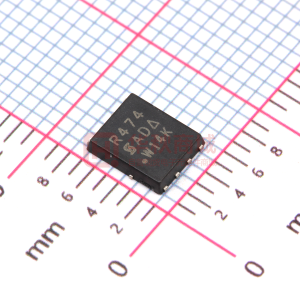

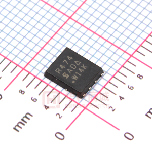

SiR474DP Vishay Siliconix N-Channel 30-V (D-S) MOSFET PRODUCT SUMMARY VDS (V) 30 RDS(on) (Ω) 0.0095 at VGS = 10 V 0.012 at VGS = 4.5 V ID (A)a, g 20 20 Qg (Typ.) 8 nC FEATURES • Halogen-free • TrenchFET® Power MOSFET • Low Thermal Resistance PowerPAK® Package with Low 1.07 mm Profile • Optimized for High-Side Synchronous Operation • 100 % Rg Tested • 100 % UIS Tested D PowerPAK SO-8 Rectifier 6.15 mm S 1 2 3 S S 5.15 mm APPLICATIONS G 4 D 8 7 6 5 D D D • Notebook CPU Core - High-Side Switch G Bottom View Ordering Information: SiR474DP-T1-GE3 (Lead (Pb)-free and Halogen-free) S N-Channel MOSFET ABSOLUTE MAXIMUM RATINGS TA = 25 °C, unless otherwise noted Parameter Drain-Source Voltage Gate-Source Voltage Continuous Drain Current (TJ = 150 °C) TC = 25 °C TC = 70 °C TA = 25 °C TA = 70 °C TC = 25 °C TA = 25 °C L = 0.1 mH TC = 25 °C TC = 70 °C TA = 25 °C TA = 70 °C Symbol VDS VGS ID IDM IS IAS EAS PD TJ, Tstg Limit 30 ± 20 20g 20g 15b, c 12b, c 50 20g 3.2b, c 20 20 29.8 19.0 3.9b, c 2.5b, c - 55 to 150 260 Unit V Pulsed Drain Current Continuous Source-Drain Diode Current Single Pulse Avalanche Current Avalanche Energy A mJ Maximum Power Dissipation W Operating Junction and Storage Temperature Range Soldering Recommendations (Peak Temperature)d, e °C THERMAL RESISTANCE RATINGS Parameter Maximum Junction-to-Ambientb, f Maximum Junction-to-Case (Drain) t ≤ 10 s Steady State Symbol RthJA RthJC Typical 27 3.5 Maximum 32 4.2 Unit °C/W Notes: a. Base on TC = 25 °C. b. Surface Mounted on 1" x 1" FR4 board. c. t = 10 s. d. See Solder Profile (http://www.vishay.com/ppg?73257). The PowerPAK SO-8 is a leadless package. The end of the lead terminal is exposed copper (not plated) as a result of the singulation process in manufacturing. A solder fillet at the exposed copper tip cannot be guaranteed and is not required to ensure adequate bottom side solder interconnection. e. Rework Conditions: manual soldering with a soldering iron is not recommended for leadless components. f. Maximum under Steady State conditions is 70 °C/W. g. Packaged Limited. Document Number: 68996 S-82749-Rev. A, 10-Nov-08 www.vishay.com 1 SiR474DP Vishay Siliconix SPECIFICATIONS TJ = 25 °C, unless otherwise noted Parameter Static Drain-Source Breakdown Voltage VDS Temperature Coefficient VGS(th) Temperature Coefficient Gate-Source Threshold Voltage Gate-Source Leakage Zero Gate Voltage Drain Current On-State Drain Currenta Drain-Source On-State Resistancea Forward Transconductancea Dynamic b Symbol VDS ΔVDS/TJ ΔVGS(th)/TJ VGS(th) IGSS IDSS ID(on) RDS(on) gfs Ciss Coss Crss Qg Qgs Qgd Rg td(on) tr td(off) tf td(on) tr td(off) tf IS ISM VSD trr Qrr ta tb Test Conditions VGS = 0 V, ID = 250 µA ID = 250 µA VDS = VGS, ID = 250 µA VDS = 0 V, VGS = ± 20 V VDS = 30 V, VGS = 0 V VDS = 30 V, VGS = 0 V, TJ = 55 °C VDS ≥ 5 V, VGS = 10 V VGS = 10 V, ID = 10 A VGS = 4.5 V, ID = 7 A VDS = 15 V, ID = 10 A Min. 30 Typ. Max. Unit V 34 - 4.7 1.0 2.2 ± 100 1 10 30 0.0075 0.010 30 0.0095 0.012 mV/°C V nA µA A Ω S Input Capacitance Output Capacitance Reverse Transfer Capacitance Total Gate Charge Gate-Source Charge Gate-Drain Charge Gate Resistance Turn-On Delay Time Rise Time Turn-Off Delay Time Fall Time Turn-On Delay Time Rise Time Turn-Off Delay Time Fall Time Drain-Source Body Diode Characteristics Continuous Source-Drain Diode Current Pulse Diode Forward Body Diode Voltage Body Diode Reverse Recovery Time Body Diode Reverse Recovery Charge Reverse Recovery Fall Time Reverse Recovery Rise Time Currenta 985 VDS = 15 V, VGS = 0 V, f = 1 MHz VDS = 15 V, VGS = 10 V, ID = 10 A VDS = 15 V, VGS = 4.5 V, ID = 10 A f = 1 MHz VDD = 15 V, RL = 1.5 Ω ID ≅ 10 A, VGEN = 4.5 V, Rg = 1 Ω 0.3 205 76 18 8 2.4 2.3 1.3 14 12 19 9 8 VDD = 15 V, RL = 1.5 Ω ID ≅ 10 A, VGEN = 10 V, Rg = 1 Ω 10 16 9 TC = 25 °C IS = 3 A 0.76 14 IF = 10 A, dI/dt = 100 A/µs, TJ = 25 °C 5 8 6 2.6 25 24 35 18 16 20 30 18 20 50 1.1 28 10 ns Ω 27 12 nC pF A V ns nC ns Notes: a. Pulse test; pulse width ≤ 300 µs, duty cycle ≤ 2 %. b. Guaranteed by design, not subject to production testing. Stresses beyond those listed under “Absolute Maximum Ratings” may cause permanent damage to the device. These are stress ratings only, and functional operation of the device at these or any other conditions beyond those indicated in the operational sections of the specifications is not implied. Exposure to absolute maximum rating conditions for extended periods may affect device reliability. www.vishay.com 2 Document Number: 68996 S-82749-Rev. A, 10-Nov-08 SiR474DP Vishay Siliconix TYPICAL CHARACTERISTICS 25 °C, unless otherwise noted 50 VGS = 10 thru 4 V 40 I D - Drain Current (A) I D - Drain Current (A) 6.4 8.0 30 VGS = 3 V 20 4.8 3.2 TC = 25 °C TC = 125 °C 10 1.6 TC = - 55 °C 0.0 0.5 1.0 1.5 2.0 2.5 0 1 2 3 4 5 0 0.0 VDS - Drain-to-Source Voltage (V) VGS - Gate-to-Source Voltage (V) Output Characteristics 0.015 1300 Transfer Characteristics Ciss R DS(on) - On-Resistance (Ω) 0.013 C - Capacitance (pF) 1040 0.011 VGS = 4.5 V 780 0.009 VGS = 10 V 0.007 520 Coss 260 Crss 0.005 0 10 20 30 40 50 0 0.0 2.4 4.8 7.2 9.6 12.0 ID - Drain Current (A) VDS - Drain-to-Source Voltage (V) On-Resistance vs. Drain Current and Gate Voltage 10 ID = 10 A VGS - Gate-to-Source Voltage (V) 8 R DS(on) - On-Resistance VDS = 20 V VDS = 10 V 4 VDS = 15 V 1.6 1.8 ID = 10 A Capacitance VGS = 10 V 1.4 (Normalized) 6 1.2 VGS = 4.5 V 1.0 2 0.8 0 0.0 3.7 7.4 11.1 14.8 18.5 0.6 - 50 - 25 0 25 50 75 100 125 150 Qg - Total Gate Charge (nC) TJ - Junction Temperature (°C) Gate Charge Document Number: 68996 S-82749-Rev. A, 10-Nov-08 On-Resistance vs. Junction Temperature www.vishay.com 3 SiR474DP Vishay Siliconix TYPICAL CHARACTERISTICS 25 °C, unless otherwise noted 100 0.05 1 TJ = 25 °C R DS(on) - On-Resistance (Ω) 10 I S - Source Current (A) TJ = 150 °C 0.04 0.03 0.1 0.02 TJ = 125 °C 0.01 TJ = 25 °C 0.01 0.001 0.0 0.00 0.2 0.4 0.6 0.8 1.0 1.2 0 1 2 3 4 5 6 7 8 9 10 VSD - Source-to-Drain Voltage (V) VGS - Gate-to-Source Voltage (V) Source-Drain Diode Forward Voltage 0.4 80 On-Resistance vs. Gate-to-Source Voltage 0.2 VGS(th) Variance (V) 64 0.0 Power (W) 48 - 0.2 ID = 5 mA 32 - 0.4 ID = 250 µA - 0.6 16 - 0.8 - 50 - 25 0 25 50 75 100 125 150 0 0.001 0.01 0.1 Time (s) 1 10 TJ - Temperature (°C) Threshold Voltage 100 Limited by RDS(on)* Single Pulse Power, Junction-to-Ambient 10 I D - Drain Current (A) 1 ms 1 10 ms 100 ms 1s 10 s TA = 25 °C Single Pulse BVDSS Limited 0.01 0.1 1 10 100 DC 0.1 VDS - Drain-to-Source Voltage (V) * VGS > minimum VGS at which RDS(on) is specified Safe Operating Area, Junction-to-Ambient www.vishay.com 4 Document Number: 68996 S-82749-Rev. A, 10-Nov-08 SiR474DP Vishay Siliconix TYPICAL CHARACTERISTICS 25 °C, unless otherwise noted 46.0 36.8 I D - Drain Current (A) 27.6 Package Limited 18.4 9.2 0.0 0 25 50 75 100 125 150 TC - Case Temperature (°C) Current Derating* 36.0 2.20 28.8 1.76 Power (W) 14.4 Power (W) 0 25 50 75 100 125 150 21.6 1.32 0.88 7.2 0.44 0.0 0.00 0 25 50 75 100 125 150 TC - Case Temperature (°C) TA - Ambient Temperature (°C) Power Derating, Junction-to-Case Power Derating, Junction-to-Ambient * The power dissipation PD is based on TJ(max) = 150 °C, using junction-to-case thermal resistance, and is more useful in settling the upper dissipation limit for cases where additional heatsinking is used. It is used to determine the current rating, when this rating falls below the package limit. Document Number: 68996 S-82749-Rev. A, 10-Nov-08 www.vishay.com 5 SiR474DP Vishay Siliconix TYPICAL CHARACTERISTICS 25 °C, unless otherwise noted 1 Duty Cycle = 0.5 Normalized Effective Transient Thermal Impedance 0.2 0.1 0.1 0.05 0.02 PDM t1 t2 1. Duty Cycle, D = Notes: 2. Per Unit Base = RthJA = 70 °C/W t1 t2 Single Pulse 0.01 10 -4 10 -3 10 -2 10 -1 1 Square Wave Pulse Duration (s) 10 3. TJM -- TA = PDMZthJA(t) 4. Surface Mounted 100 1000 Normalized Thermal Transient Impedance, Junction-to-Ambient 1 Duty Cycle = 0.5 Normalized Effective Transient Thermal Impedance 0.2 0.1 0.05 0.02 Single Pulse 0.1 0.01 10 -4 10 -3 10 -2 10 -1 Square Wave Pulse Duration (s) 1 10 Normalized Thermal Transient Impedance, Junction-to-Case Vishay Siliconix maintains worldwide manufacturing capability. Products may be manufactured at one of several qualified locations. Reliability data for Silicon Technology and Package Reliability represent a composite of all qualified locations. For related documents such as package/tape drawings, part marking, and reliability data, see http://www.vishay.com/ppg?68996. www.vishay.com 6 Document Number: 68996 S-82749-Rev. A, 10-Nov-08 Legal Disclaimer Notice Vishay Disclaimer All product specifications and data are subject to change without notice. Vishay Intertechnology, Inc., its affiliates, agents, and employees, and all persons acting on its or their behalf (collectively, “Vishay”), disclaim any and all liability for any errors, inaccuracies or incompleteness contained herein or in any other disclosure relating to any product. Vishay disclaims any and all liability arising out of the use or application of any product described herein or of any information provided herein to the maximum extent permitted by law. The product specifications do not expand or otherwise modify Vishay’s terms and conditions of purchase, including but not limited to the warranty expressed therein, which apply to these products. No license, express or implied, by estoppel or otherwise, to any intellectual property rights is granted by this document or by any conduct of Vishay. The products shown herein are not designed for use in medical, life-saving, or life-sustaining applications unless otherwise expressly indicated. Customers using or selling Vishay products not expressly indicated for use in such applications do so entirely at their own risk and agree to fully indemnify Vishay for any damages arising or resulting from such use or sale. Please contact authorized Vishay personnel to obtain written terms and conditions regarding products designed for such applications. Product names and markings noted herein may be trademarks of their respective owners. Document Number: 91000 Revision: 18-Jul-08 www.vishay.com 1
