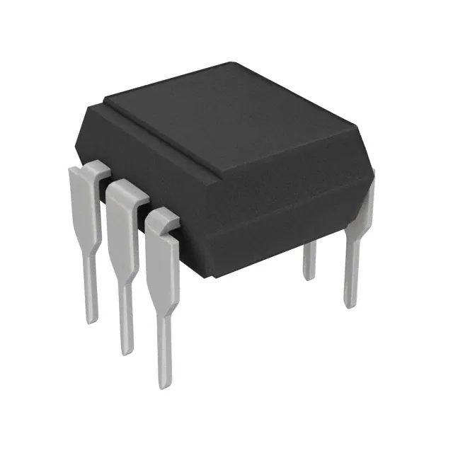

VO3052/VO3053 Vishay Semiconductors Optocoupler, Non Zero Crossing Phototriac, 1.5 kV/µs dV/dt, 600 V Features • 1500 V/µs dV/dT minimum, 2000 V/µs typical • 600 V Blocking Voltage • Low Input Trigger Current • 6 pin DIP package • Lead (Pb)-free component • Component in accordance to RoHS 2002/95/EC and WEEE 2002/96/EC i179041 thdip67 A1 C2 NC 3 6 MT2 5 NC 4 MT1 Agency Approvals • UL - File E52744 H/J System Code • CUL - File No. E52744, equivalent to CSA bulletin 5A • DIN EN 60747-5-2 (VDE0884) DIN EN 60747-5-5 pending Available with Option 1 Description The VO3052/VO3053 triac driver family consists of a GaAs infrared LED optically coupled to a monolithic photosensitive non zero crossing triac detector chip. The 600 V blocking voltage permits control of off-line voltages up to 240 VAC, with a safety factor or more than two, and is sufficient for as much as 380 V. Applications • • • • • • Household Appliances Triac Drive/AC Motor Drives Solenoid/Valve Controls Office Automation Equipment / Machine Temperature (HVAC)/Lighting Controls Switching Power Supply Order Information Part VO3053 VO3052 VO3053-X006 VO3052-X006 Remarks DIP-6, NZC, 600 V, Ift = 5 mA DIP-6, NZC, 600 V, Ift = 10 mA DIP-6 400 mil (option 6), NZC, 600 V, Ift = 5 mA DIP-6 400 mil (option 6), NZC, 600 V, Ift = 10 mA VO3053-X007T SMD-6 (option 7), NZC, 600 V, Ift = 5 mA VO3052-X007T SMD-6 (option 7), NZC, 600 V, Ift = 10 mA Absolute Maximum Ratings Tamb = 25 °C, unless otherwise specified Stresses in excess of the absolute Maximum Ratings can cause permanent damage to the device. Functional operation of the device is not implied at these or any other conditions in excess of those given in the operational sections of this document. Exposure to absolute Maximum Rating for extended periods of the time can adversely affect reliability. Input Parameter Reverse voltage Forward current - continuous Power dissipation Test condition Symbol VR IF Pdiss Value 6.0 60 100 Unit V mA mW Document Number 83749 Rev. 1.5, 07-Nov-06 www.vishay.com 1 VO3052/VO3053 Vishay Semiconductors Output Parameter Off state output terminal voltage Peak repetitive surge current Power dissipation PW = 100 ms, 120 pps Test condition Part VO3052/3053 Symbol VDRM ITSM Pdiss Value 600 1.0 150 Unit V A mW Coupler Parameter Isolation test voltage Total power dissipation Operating temperature Storage temperature Soldering temperature 10 sec 1.0 sec Test condition Symbol VISO Ptot Tamb Tstg Tsld Value 5300 250 - 40 to + 100 - 55 to + 150 260 Unit VRMS mW °C °C °C 110 IF = 5 mA 100 Load Current (mA) 90 IF = 20 mA 80 IF = 10 mA 70 60 50 - 40 - 20 0 20 40 60 80 100 20334 Temperature (°C) Figure 1. On State Current vs. Temperature www.vishay.com 2 Document Number 83749 Rev. 1.5, 07-Nov-06 VO3052/VO3053 Vishay Semiconductors Thermal Characteristics The thermal model is represented in the thermal network below. Each resistance value given in this model can be used to calculate the temperatures at each node for a given operating condition. The thermal resistance from board to ambient will be dependent on the type of PCB, layout and thickness of copper traces. For a detailed explanation of the thermal model, please reference Vishay's Thermal Characteristics of Optocouplers Application note. Parameter LED Power dissipation Output Power dissipation Total Power dissipation Maximum LED junction temperature Maximum output die junction temperature Thermal resistance, Junction Emitter to Board Thermal resistance, Junction Emitter to Case Thermal resistance, Junction Detector to Board Thermal resistance, Junction Detector to Case Thermal resistance, Junction Emitter to Junction Detector Thermal resistance, Case to Ambient TA Test condition at 25 °C at 25 °C at 25 °C Symbol Pdiss Pdiss Ptot Tjmax Tjmax Value 100 500 600 125 125 150 139 78 109 496 9563 Unit mW mW mW °C °C °C/W °C/W °C/W °C/W °C/W °C/W θJEB θJEC θJDB θJDC θJED θCA θCA TC Package θDC TJD θEC θDE TJE θDB TB θEB θBA 19996 TA Electrical Characteristics Tamb = 25 °C, unless otherwise specified Minimum and maximum values are testing requirements. Typical values are characteristics of the device and are the result of engineering evaluation. Typical values are for information only and are not part of the testing requirements. Input Parameter Reverse current Forward voltage VR = 6 V IF = 30 mA Test condition Symbol IR VF 1.2 Min Typ. Max 10 1.5 Unit µA V Document Number 83749 Rev. 1.5, 07-Nov-06 www.vishay.com 3 VO3052/VO3053 Vishay Semiconductors Output Parameter Leakage with LED off, either direction Critical rate of rise of off-state voltage Test condition VDRM = 600 V VD = 400 V Symbol IDRM dV/dt 1500 Min Typ. 10 2000 Max 500 Unit nA V/µs Coupler Parameter LED trigger current, current required to latch output Peak on-state voltage, either direction Holding current, either direction ITM = 100 mA Peak, IF = Rated IFT Test condition Part VO3053 VO3052 Symbol IFT IFT VTM IH 1.7 200 Min Typ. Max 5 10 3 Unit mA mA V µA Saftey and Insulation Ratings As per IEC60747-5-2, §7.4.3.8.1, this optocoupler is suitable for “safe electrical insulation” only within the safety ratings. Compliance with safety ratings shall be ensured by means of protective circuits. Parameter Climatic classification Pollution degree Tracking resistance (Comparative tracking index) Highest allowable overvoltage Maximum working insulation voltage Insulation resistance at 25 °C Insulation resistance at TS Insulation resistance at 100 °C Partial discharge test voltage Safety limiting values Maximum values allowed in the event of a failure: Case temperature Input current Output power Minimum external air gap (Clearance) Minimum external tracking (Creepage) Minimum external air gap (Clearance) Minimum external tracking (Creepage) Measured from input terminals to output terminals, shortest distance through air Measured from input terminals to output terminals, shortest distance path along body Measured from input terminals to output terminals, shortest distance through air Measured from input terminals to output terminals, shortest distance path along body Test condition IEC 68 part 1 DIN VDE 0109 Insulation group Illa Transient overvoltage Recurring peak voltage VIO = 500 V VIO = 500 V VIO = 500 V Method a, Vpd = VIORM x 1.875 CTI VIOTM VIORM RIS RIS RIS Vpd 175 8000 890 ≥ 1012 ≥ 10 12 Symbol Min Typ 40/100/21 2 Max Unit Vpeak Vpeak Ω Ω Ω Vpeak ≥ 1012 1669 TSI ISI PSO ≥7 175 250 500 °C mA mW mm ≥7 mm ≥8 mm ≥8 mm www.vishay.com 4 Document Number 83749 Rev. 1.5, 07-Nov-06 VISHAY VO3052/VO3053 Vishay Semiconductors 1.5 - 40 °C 1.3 Forward LED Voltage (V) 1.4 1.2 1.1 Normalized IFT 1.0 0.8 0.6 0.4 0.2 0.9 25 °C 0.7 85 °C 0.5 1 20335 0.0 10 Forward LED Current (mA) 100 20340 - 40 10 60 100 Temperature (°C) Figure 2. Forward Voltage vs. Forward Current Figure 5. Normalized Trigger Current vs. Temperature 1000 100 100 Turn-on Time (µs) IIkg (nA) 10 10 1 - 40 - 20 20337 1 0 20 40 60 80 100 20341 5 7 9 11 13 15 Temperature (°C) LED Current (mA) Figure 3. Off-State Leakage Current vs. Temperature Figure 6. Turn-On Time vs. LED Current 100 2.0 1.8 1.6 On State Current ITM (mA) 80 60 Normalized Ih 40 20 0 - 20 - 40 - 60 - 80 - 100 - 2 - 1.5 - 1 - 0.5 0 0.5 1 1.5 2 1.4 1.2 1.0 0.8 0.6 0.4 - 40 - 20 0 20 40 60 80 100 20338 On State Voltage_VTM (V) Figure 4. On State Current vs. VTM 20342 Temperature (°C) Figure 7. Normalized Holding Current vs. Temperature Document Number 83749 Rev. 1.5, 07-Nov-06 www.vishay.com 5 VO3052/VO3053 Vishay Semiconductors VISHAY 25 5.0 20 4.8 Turn-On Time (µs) 10 IFT (mA) 0 20 40 60 80 100 15 4.6 4.4 5 4.2 0 - 40 - 20 20339 4.0 30 20343 45 60 75 90 100 Temperature (°C) Pulse Width (µs) Figure 8. Turn-On Time vs. Temperature Figure 9. Trigger Current vs. Pulse Width Package Dimensions in Inches (mm) Option 6 0.407 (10.36) 0.391 (9.96) 0.307 (7.8) 0.291 (7.4) pin one ID 3 2 1 0.248 (6.30) 0.256 (6.50) ISO Method A 4 5 6 20° 0.300 (7.62) typ . 0.014 (0.35) 0.010 (0.25) 0.400 (10.16) 0.430 (10.92) 0.335 (8.50) 0.343 (8.70) 0.039 (1.00 ) Min . 0.048 (1.22) 0.052 (1.32) 0.130 (3.30) 0.150 (3.81) 18° 0.033 (0.84) typ. 0.018 (0.46) 0.020 (0.51) i178014_1 0.033 (0.84) typ. 0.100 (2.54) typ. 3° - 9° 0.008 (0.20) 0.012 (0.30) 0.300 - 0.347 (7.62–8.81) 0.130 (3.30) 0.150 (3.81) 0.028 (0.7) MIN. Option 7 0.300 (7.62) TYP . 4° typ . 0.180 (4.6) 0.160 (4.1) 0.315 (8.0) MIN . 0.331 (8.4) MIN. 0.406 (10.3) MAX. www.vishay.com 6 Document Number 83749 Rev. 1.5, 07-Nov-06 VISHAY Ozone Depleting Substances Policy Statement It is the policy of Vishay Semiconductor GmbH to VO3052/VO3053 Vishay Semiconductors 1. Meet all present and future national and international statutory requirements. 2. Regularly and continuously improve the performance of our products, processes, distribution and operating systems with respect to their impact on the health and safety of our employees and the public, as well as their impact on the environment. It is particular concern to control or eliminate releases of those substances into the atmosphere which are known as ozone depleting substances (ODSs). The Montreal Protocol (1987) and its London Amendments (1990) intend to severely restrict the use of ODSs and forbid their use within the next ten years. Various national and international initiatives are pressing for an earlier ban on these substances. Vishay Semiconductor GmbH has been able to use its policy of continuous improvements to eliminate the use of ODSs listed in the following documents. 1. Annex A, B and list of transitional substances of the Montreal Protocol and the London Amendments respectively 2. Class I and II ozone depleting substances in the Clean Air Act Amendments of 1990 by the Environmental Protection Agency (EPA) in the USA 3. Council Decision 88/540/EEC and 91/690/EEC Annex A, B and C (transitional substances) respectively. Vishay Semiconductor GmbH can certify that our semiconductors are not manufactured with ozone depleting substances and do not contain such substances. We reserve the right to make changes to improve technical design and may do so without further notice. Parameters can vary in different applications. All operating parameters must be validated for each customer application by the customer. Should the buyer use Vishay Semiconductors products for any unintended or unauthorized application, the buyer shall indemnify Vishay Semiconductors against all claims, costs, damages, and expenses, arising out of, directly or indirectly, any claim of personal damage, injury or death associated with such unintended or unauthorized use. Vishay Semiconductor GmbH, P.O.B. 3535, D-74025 Heilbronn, Germany Document Number 83749 Rev. 1.5, 07-Nov-06 www.vishay.com 7 Legal Disclaimer Notice Vishay Notice Specifications of the products displayed herein are subject to change without notice. Vishay Intertechnology, Inc., or anyone on its behalf, assumes no responsibility or liability for any errors or inaccuracies. Information contained herein is intended to provide a product description only. No license, express or implied, by estoppel or otherwise, to any intellectual property rights is granted by this document. Except as provided in Vishay's terms and conditions of sale for such products, Vishay assumes no liability whatsoever, and disclaims any express or implied warranty, relating to sale and/or use of Vishay products including liability or warranties relating to fitness for a particular purpose, merchantability, or infringement of any patent, copyright, or other intellectual property right. The products shown herein are not designed for use in medical, life-saving, or life-sustaining applications. Customers using or selling these products for use in such applications do so at their own risk and agree to fully indemnify Vishay for any damages resulting from such improper use or sale. Document Number: 91000 Revision: 08-Apr-05 www.vishay.com 1
