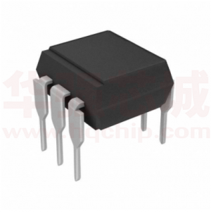

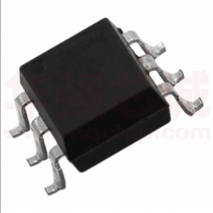

VO4254/VO4256 Vishay Semiconductors Optocoupler, Phototriac Output, High dV/dt, Low Input Current FEATURES • High static dV/dt 5 kV/µs A1 C2 NC 3 6 MT2 5 NC 4 MT1 • High input sensitivity IFT = 1.6, 2, and 3 mA • 400 and 600 V blocking voltage • 300 mA on-state current • Isolation test voltage 5300 VRMS APPLICATIONS i179035 • Solid-state relays • Industrial controls • Office equipment • Consumer appliances DESCRIPTION The VO4254/VO4256 phototriac consists of a GaAs IRLED optically coupled to a photosensitive non-zero crossing TRIAC packaged in a DIP-6 package. High input sensitivity is achieved by using an emitter follower phototransistor and a cascaded SCR predriver resulting in an LED trigger current of 1.6 mA for bin D, 2 mA for bin H, and 3 mA for bin M. The new non zero phototriac family use a proprietary dV/dt clamp resulting in a static dV/dt of greater than 5 kV/µs. The VO4254/VO4256 phototriac isolates low-voltage logic from 120, 240, and 380 VAC lines to control resistive, inductive, or capacitive loads including motors, solenoids, high current thyristors or TRIAC and relays. AGENCY APPROVALS • UL1577, file no. E52744 system code H or J, double protection • CUL - file no. E52744, equivalent to CSA bulletin 5A • DIN EN 60747-5-2 (VDE 0884) available with option 1 ORDER INFORMATION PART VO4254D VO4254D-X006 VO4254D-X007 VO4254H VO4254H-X006 VO4254H-X007 VO4254M VO4254M-X006 VO4254M-X007 VO4256D VO4256D-X006 VO4256D-X007 VO4256H VO4256H-X006 VO4256H-X007 VO4256M VO4256M-X006 VO4256M-X007 Note For additional information on the available options refer to option information. REMARKS 400 V VDRM, lft = 1.6 mA, DIP-6 400 V VDRM, Ift = 1.6 mA, DIP-6 400 mil 400 V VDRM, Ift = 1.6 mA, SMD-6 400 V VDRM, Ift = 2 mA, DIP-6 400 V VDRM, Ift = 2 mA, DIP-6 400 mil 400 V VDRM, Ift = 2 mA, SMD-6 400 V VDRM, Ift = 3 mA, DIP-6 400 V VDRM, Ift = 3 mA, DIP-6 400 mil 400 V VDRM, Ift = 3 mA, SMD-6 600 V VDRM, Ift = 1.6 mA, DIP-6 600 V VDRM, Ift = 1.6 mA, DIP-6 400 mil 600 V VDRM, Ift = 1.6 mA, SMD-6 600 V VDRM, Ift = 2 mA, DIP-6 600 V VDRM, Ift = 2 mA, DIP-6 400 mil 600 V VDRM, Ift = 2 mA, SMD-6 600 V VDRM, Ift = 3 mA, DIP-6 600 V VDRM, Ift = 3 mA, DIP-6 400 mil 600 V VDRM, Ift = 3 mA, SMD-6 Document Number: 84798 Rev. 1.4, 30-Aug-06 For technical questions, contact: optocouplers.answers@vishay.com www.vishay.com 1 VO4254/VO4256 Vishay Semiconductors Optocoupler, Phototriac Output, High dV/dt, Low Input Current ABSOLUTE MAXIMUM RATINGS PARAMETER INPUT Reverse voltage Forward current Power dissipation Derate from 25 °C OUTPUT Peak off-state voltage RMS on-state current Power dissipation Derate from 25 °C COUPLER Isolation test voltage (between emitter and detector, climate per DIN 500414, part 2, Nov. 74) Storage temperature range Ambient temperature range Soldering temperature max. ≤ 10 s dip soldering ≥ 0.5 mm from case bottom t=1s VISO Tstg Tamb Tsld 5300 - 55 to + 150 - 55 to + 100 260 VRMS °C °C °C VO4254D/H/M VO4256D/H/M VDRM VDRM ITM Pdiss 400 600 300 500 6.6 V V mA mW mW/°C VR IF Pdiss 6 60 100 1.33 V mA mW mW/°C TEST CONDITION PART SYMBOL VALUE UNIT Note Tamb = 25 °C, unless otherwise specified. Stresses in excess of the absolute Maximum Ratings can cause permanent damage to the device. Functional operation of the device is not implied at these or any other conditions in excess of those given in the operational sections of this document. Exposure to absolute Maximum Rating for extended periods of the time can adversely affect reliability. 350 300 Load Current (mA) 250 IF = 3 mA to 10 mA 200 150 100 50 0 - 40 - 20 19623 0 20 40 60 80 100 Temperature (°C) Fig. 1 - Recommended Operating Condition www.vishay.com 2 For technical questions, contact: optocouplers.answers@vishay.com Document Number: 84798 Rev. 1.4, 30-Aug-06 VO4254/VO4256 Optocoupler, Phototriac Output, High dV/dt, Low Input Current Vishay Semiconductors THERMAL CHARACTERISTICS PARAMETER LED power dissipation Output power dissipation Maximum LED junction temperature Maximum output die junction temperature Thermal resistance, junction emitter to board Thermal resistance, junction emitter to case Thermal resistance, junction detector to board Thermal resistance, junction detector to case Thermal resistance, junction emitter to junction detector Thermal resistance, case to ambient TEST CONDITION at 25 °C at 25 °C SYMBOL Pdiss Pdiss Tjmax Tjmax θEB θEC θDB θDC θED θCA VALUE 100 500 125 125 150 139 78 103 496 3563 UNIT mW mW °C °C °C/W °C/W °C/W °C/W °C/W °C/W Note The thermal model is represented in the thermal network below. Each resistance value given in this model can be used to calculate the temperatures at each node for a given operating condition. The thermal resistance from board to ambient will be dependent on the type of PCB, layout and thickness of copper traces. For a detailed explanation of the thermal model, please reference Vishay's Thermal Characteristics of Optocouplers Application note. TA θCA TC Package θDC TJD θEC θDE TJE θDB TB θEB θBA 19996 TA Document Number: 84798 Rev. 1.4, 30-Aug-06 For technical questions, contact: optocouplers.answers@vishay.com www.vishay.com 3 VO4254/VO4256 Vishay Semiconductors Optocoupler, Phototriac Output, High dV/dt, Low Input Current ELECTRICAL CHARACTERISTCS PARAMETER INPUT Forward voltage Reverse current Input capacitance OUTPUT Repetitive peak off-state voltage Off-state current On-state voltage On-current Critical rate of rise of off-state voltage COUPLER VO4254D VO4254H LED trigger current, current required to latch output VD = 3 V VO4254M VO4256D VO4256H VO4256M Capacitance (input-output) f = 1 MHz, VIO = 0 V IFT IFT IFT IFT IFT IFT CIO 0.8 1.6 2 3 1.6 2 3 mA mA mA mA mA mA pF IDRM = 100 µA VD = VDRM IT = 300 mA PF = 1, VT(RMS) = 1.7 V VD = 0.67 VDRM, TJ = 25 °C VO4254D/H/M VO4256D/H/M VDRM VDRM IDRM VTM ITM dV/dtcr 5000 400 600 100 3 300 V V µA V mA V/µs IF = 10 mA VR = 6 V VF = 0 V, f = 1 MHz VF IR CI 1.2 0.1 40 1.4 10 V µA pF TEST CONDITION PART SYMBOL MIN. TYP. MAX. UNIT Note Tamb = 25 °C, unless otherwise specified. Minimum and maximum values were tested requierements. Typical values are characteristics of the device and are the result of engineering evaluation. Typical values are for information only and are not part of the testing requirements. SAFETY AND INSULATION RATINGS PARAMETER Climatic classification (according to IEC 68 part 1) Pollution degree (DIN VDE 0109) Comparative tracking index per DIN IEC 112/VDE 0303 part 1, group IIIa per DIN VDE 6110 175 399 VIOTM VIORM PSO ISI TSI Creepage Clearance VIOTM VIORM PSO ISI TSI 7 7 175 8000 890 500 250 175 TEST CONDITION SYMBOL MIN. TYP. 55/100/21 2 399 V V mW mA °C mm mm MAX. UNIT www.vishay.com 4 For technical questions, contact: optocouplers.answers@vishay.com Document Number: 84798 Rev. 1.4, 30-Aug-06 VO4254/VO4256 Optocoupler, Phototriac Output, High dV/dt, Low Input Current TYPICAL CHARACTERISTICS Tamb = 25 °C, unless otherwise specified Vishay Semiconductors 1.5 1000 1.3 ITM, On-State Current (mA) 100 0 °C VF (V) 1.1 0 °C 0.9 25 °C 50 °C 0.7 0.1 19660 10 25 °C 85 °C IF = 2 mA 2 3 1 1.0 10.0 100.0 0 19683 1 IF (mA) VTM, On-State Voltage (V) Fig. 2 - Diode Forward Voltage vs. Forward Current Fig. 5 - On-State Current vs. On-State Voltage 42 80 Output Leakage current (pA) 70 60 50 40 30 20 10 0 °C 0 - 10 0 19684 40 85 °C VR (V) 38 36 25 °C 34 IR = 10 µA 32 - 60 - 40 - 20 19662 0 20 40 60 80 100 200 400 600 800 Temperature (ºC) Voltage (V) Fig. 3 - Diode Reverse Voltage vs. Temperature Fig. 6 - Output Off Current (Leakage) vs. Voltage 1000 1.8 1.6 1.4 IDRM, Leakage Current (nA) Normalized IFT 100 1.2 1.0 0.8 0.6 0.4 Normalized IFT at 25 ºC 0 20 40 60 80 100 10 IDRM at 630 V 1 - 60 - 40 - 20 19682 0.2 0.0 - 60 - 40 - 20 19666 0 20 40 60 80 100 TA, Ambient Temperature (°C) Temperature (ºC) Fig. 4 - Leakage Current vs. Ambient Temperature Fig. 7 - Normalized Trigger Input Current vs. Temperature Document Number: 84798 Rev. 1.4, 30-Aug-06 For technical questions, contact: optocouplers.answers@vishay.com www.vishay.com 5 VO4254/VO4256 Vishay Semiconductors Optocoupler, Phototriac Output, High dV/dt, Low Input Current 3.5 3.0 2.5 IFT (mA) 2.0 1.5 1.0 0.5 0.0 10 20013 100 1000 Turn-On Time (µs) Fig. 8 - IFT vs. Turn-On Time (µs) 1.4 1.2 1.0 Normalized IH at 25 °C Normalized IH 0.8 0.6 0.4 0.2 0.0 - 60 - 40 - 20 20014 0 20 40 60 80 100 Temperature (ºC) Fig. 9 - Normalized IH vs. Temperature 10 IFT, Trigger Current (mA) 8 6 85 ºC 100 ºC 4 2 - 40 ºC 25 ºC 10 20 30 40 50 60 70 0 20015 Trigger Pulse Width (µs) Fig. 10 - IFT vs. LED Pulse Width www.vishay.com 6 For technical questions, contact: optocouplers.answers@vishay.com Document Number: 84798 Rev. 1.4, 30-Aug-06 VO4254/VO4256 Optocoupler, Phototriac Output, High dV/dt, Low Input Current PACKAGE DIMENSIONS in inches (millimeters) Pin one ID Vishay Semiconductors 3 0.248 (6.30) 0.256 (6.50) 2 1 ISO Method A 4 5 6 0.335 (8.50) 0.343 (8.70) 0.039 (1.00) Min. 0.048 (1.22) 0.052 (1.32) 0.130 (3.30) 0.150 (3.81) 18° 0.033 (0.84) Typ. 3° - 9° 0.033 (0.84) Typ. 0.100 (2.54) Typ. 0.008 (0.20) 0.012 (0.30) 0.300 - 0.347 (7.62 - 8.81) 0.130 (3.30) 0.150 (3.81) 0.300 (7.62) typ. 4° Typ. 0.018 (0.46) 0.020 (0.51) i178014 Option 6 0.407 (10.36) 0.391 (9.96) 0.307 (7.8) 0.291 (7.4) 0.028 (0.7) MIN. Option 7 0.300 (7.62) TYP . 0.180 (4.6) 0.160 (4.1) 0.315 (8.0) MIN. 0.014 (0.35) 0.010 (0.25) 0.400 (10.16) 0.430 (10.92) 0.331 (8.4) MIN. 0.406 (10.3) MAX. 18450-1 Document Number: 84798 Rev. 1.4, 30-Aug-06 For technical questions, contact: optocouplers.answers@vishay.com www.vishay.com 7 VO4254/VO4256 Vishay Semiconductors Optocoupler, Phototriac Output, High dV/dt, Low Input Current OZONE DEPLETING SUBSTANCES POLICY STATEMENT It is the policy of Vishay Semiconductor GmbH to 1. Meet all present and future national and international statutory requirements. 2. Regularly and continuously improve the performance of our products, processes, distribution and operating systems with respect to their impact on the health and safety of our employees and the public, as well as their impact on the environment. It is particular concern to control or eliminate releases of those substances into the atmosphere which are known as ozone depleting substances (ODSs). The Montreal Protocol (1987) and its London Amendments (1990) intend to severely restrict the use of ODSs and forbid their use within the next ten years. Various national and international initiatives are pressing for an earlier ban on these substances. Vishay Semiconductor GmbH has been able to use its policy of continuous improvements to eliminate the use of ODSs listed in the following documents. 1. Annex A, B and list of transitional substances of the Montreal Protocol and the London Amendments respectively. 2. Class I and II ozone depleting substances in the Clean Air Act Amendments of 1990 by the Environmental Protection Agency (EPA) in the USA 3. Council Decision 88/540/EEC and 91/690/EEC Annex A, B and C (transitional substances) respectively. Vishay Semiconductor GmbH can certify that our semiconductors are not manufactured with ozone depleting substances and do not contain such substances. We reserve the right to make changes to improve technical design and may do so without further notice. Parameters can vary in different applications. All operating parameters must be validated for each customer application by the customer. Should the buyer use Vishay Semiconductors products for any unintended or unauthorized application, the buyer shall indemnify Vishay Semiconductors against all claims, costs, damages, and expenses, arising out of, directly or indirectly, any claim of personal damage, injury or death associated with such unintended or unauthorized use. Vishay Semiconductor GmbH, P.O.B. 3535, D-74025 Heilbronn, Germany www.vishay.com 8 For technical questions, contact: optocouplers.answers@vishay.com Document Number: 84798 Rev. 1.4, 30-Aug-06 Legal Disclaimer Notice Vishay Disclaimer All product specifications and data are subject to change without notice. Vishay Intertechnology, Inc., its affiliates, agents, and employees, and all persons acting on its or their behalf (collectively, “Vishay”), disclaim any and all liability for any errors, inaccuracies or incompleteness contained herein or in any other disclosure relating to any product. Vishay disclaims any and all liability arising out of the use or application of any product described herein or of any information provided herein to the maximum extent permitted by law. The product specifications do not expand or otherwise modify Vishay’s terms and conditions of purchase, including but not limited to the warranty expressed therein, which apply to these products. No license, express or implied, by estoppel or otherwise, to any intellectual property rights is granted by this document or by any conduct of Vishay. The products shown herein are not designed for use in medical, life-saving, or life-sustaining applications unless otherwise expressly indicated. Customers using or selling Vishay products not expressly indicated for use in such applications do so entirely at their own risk and agree to fully indemnify Vishay for any damages arising or resulting from such use or sale. Please contact authorized Vishay personnel to obtain written terms and conditions regarding products designed for such applications. Product names and markings noted herein may be trademarks of their respective owners. Document Number: 91000 Revision: 18-Jul-08 www.vishay.com 1
