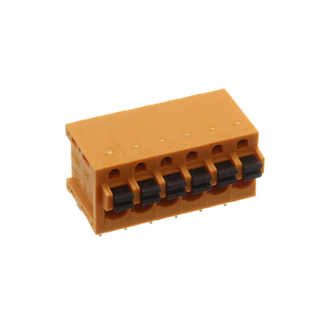

    Data sheet OMNIMATE Signal - series LMF LMF 5.08/06/90 3.5SN OR BX Weidmüller Interface GmbH & Co. KG Klingenbergstraße 16 D-32758 Detmold Germany Fon: +49 5231 14-0 Fax: +49 5231 14-292083 www.weidmueller.com     Product image Similar to illustration The new LMF allows us to meet the current market requirements for a PCB terminal with PUSH IN connection system for wire cross-sections up to 2.5 mm2 • PUSH IN connection system • LMF with pusher for opening the terminal point • LMFS without pusher, the terminal point is opened with a screwdriver • Integrated test point • 90° and 180° wire outlet direction General ordering data   Type Order No. Version GTIN (EAN) Qty. Product data Packaging   LMF 5.08/06/90 3.5SN OR BX 1330750000 PCB terminal, 5.08 mm, No. of poles: 6, 90°, Solder pin length (l): 3.5 mm, tinned, Orange, PUSH IN, Clamping range, max. : 2.5 mm², Box 4050118136005 45 pc(s). IEC: 400 V / 24 A / 0.2 - 2.5 mm² UL: 300 V / 20 A / AWG 24 - AWG 12 Box Creation date December 11, 2018 9:27:57 PM CET   Catalogue status 07.12.2018 / We reserve the right to make technical changes. 1     Data sheet OMNIMATE Signal - series LMF LMF 5.08/06/90 3.5SN OR BX   Weidmüller Interface GmbH & Co. KG Klingenbergstraße 16 D-32758 Detmold Germany Fon: +49 5231 14-0 Fax: +49 5231 14-292083 www.weidmueller.com Technical data Dimensions and weights   Width Height Height of lowest version Depth (inches)   33.1 mm 18.3 mm 14.8 mm 0.756 inch         Width (inches) Height (inches) Depth Net weight   Wire connection method                     Conductor outlet direction Pitch in inches (P) Fitted by customer Solder pin length (l) Solder eyelet hole diameter (D) Number of solder pins per pole Screwdriver blade standard L1 in mm Touch-safe protection acc. to DIN VDE 0470         Colour CTI UL 94 flammability rating 1.303 inch 0.72 inch 19.2 mm 11.36 g System parameters   Product family OMNIMATE Signal - series LMF Mounting onto the PCB THT solder connection Pitch in mm (P) 5.08 mm No. of poles 6 Max. adjacent poles per row 24 Solder pin dimensions d = 0.8 mm Solder eyelet hole diameter tolerance (D)+ 0,1 mm Screwdriver blade 0.6 x 3.5 Stripping length 10 mm L1 in inches 1 inch Touch-safe protection acc. to DIN VDE 57 106 Safe from finger touch PUSH IN 90° 0.2 inch No 3.5 mm 1.1 mm 2 DIN 5264 25.4 mm IP 20   Material data   Insulating material Colour chart (similar) Insulation resistance Contact material Coating Layer structure of solder connection Storage temperature, max. Operating temperature, min. Temperature range, installation, min.   Wemid (PA) RAL 2000 ≥ 108 Ω CuSn 4-6 μm SN 4-6 µm Sn matt 55 °C -50 °C -25 °C             Contact surface Tinning type Storage temperature, min. Max. relative humidity during storage Operating temperature, max. Temperature range, installation, max. Orange ≥ 600 V-0 tinned matt -25 °C 80 % 120 °C 120 °C Conductors suitable for connection   Clamping range, min. 0.12 mm² Wire connection cross section AWG, min. AWG 24 Solid, min. H05(07) V-U 0.2 mm² Flexible, min. H05(07) V-K 0.2 mm² w. plastic collar ferrule, DIN 46228 pt 4, min. 0.25 mm² w. wire end ferrule, DIN 46228 pt 1, min 0.25 mm² Plug gauge in accordance with EN 60999 a x b; ø 2.4 mm x 1.5 mm               Clamping range, max. 2.5 mm² Wire connection cross section AWG, max. AWG 12 Solid, max. H05(07) V-U 2.5 mm² Flexible, max. H05(07) V-K 2.5 mm² w. plastic collar ferrule, DIN 46228 pt 4, max. 2.5 mm² w. wire end ferrule, DIN 46228 pt 1, max. 2.5 mm²     Creation date December 11, 2018 9:27:57 PM CET   Catalogue status 07.12.2018 / We reserve the right to make technical changes. 2     Data sheet OMNIMATE Signal - series LMF LMF 5.08/06/90 3.5SN OR BX   Weidmüller Interface GmbH & Co. KG Klingenbergstraße 16 D-32758 Detmold Germany Fon: +49 5231 14-0 Fax: +49 5231 14-292083 www.weidmueller.com Technical data Rated data acc. to IEC   tested acc. to standard Rated current, max. no. of poles (Tu=20°C) Rated current, max. no. of poles (Tu=40°C) Rated voltage for surge voltage class / pollution degree III/2 Rated impulse voltage for surge voltage class/ pollution degree II/2 Rated impulse voltage for surge voltage class/ contamination degree III/3       Rated current, min. no. of poles (Tu=20°C) Rated current, min. no. of poles (Tu=40°C) Rated voltage for surge voltage class / pollution degree II/2 Rated voltage for surge voltage class / pollution degree III/3 Rated impulse voltage for surge voltage class/ pollution degree III/2 Short-time withstand current resistance   Certificate No. (CSA)         Rated voltage (use group D) Rated current (use group D) Wire cross-section, AWG, max.     Certificate No. (cURus) 300 V 20 A AWG 24 Specifications are maximum values, details see approval certificate.         Rated voltage (use group D) Rated current (use group D) Wire cross-section, AWG, max.   Box 135 mm     VPE length VPE height 30 mm 350 mm EC001284 EC002643 27-26-11-01 27-44-04-01 27-44-04-01           ETIM 4.0 ETIM 6.0 eClass 7.1 eClass 9.0   EC002643 EC002643 27-44-04-01 27-44-04-01 IEC 60664-1, IEC 61984 24 A 24 A 320 V 4 kV 4 kV         24 A 24 A 400 V 250 V 4 kV 3 x 1s with 120 A Rated data acc. to CSA   Institute (CSA) Rated voltage (Use group B) Rated current (use group B) Wire cross-section, AWG, min. Reference to approval values   300 V 20 A AWG 24 Specifications are maximum values, details see approval certificate. 20039-1815154 300 V 10 A AWG 12 Rated data acc. to UL 1059   Institute (cURus) Rated voltage (use group B) Rated current (use group B) Wire cross-section, AWG, min. Reference to approval values   E60693 300 V 10 A AWG 12 Packaging   Packaging VPE width   Classifications   ETIM 3.0 ETIM 5.0 eClass 6.2 eClass 8.1 eClass 9.1   Creation date December 11, 2018 9:27:57 PM CET   Catalogue status 07.12.2018 / We reserve the right to make technical changes. 3     Data sheet OMNIMATE Signal - series LMF LMF 5.08/06/90 3.5SN OR BX   Technical data Weidmüller Interface GmbH & Co. KG Klingenbergstraße 16 D-32758 Detmold Germany Fon: +49 5231 14-0 Fax: +49 5231 14-292083 www.weidmueller.com Notes   Notes • Additional colours on request • Rated current related to rated cross-section & min. No. of poles. • Wire end ferrule without plastic collar to DIN 46228/1 • Wire end ferrule with plastic collar to DIN 46228/4 • P on drawing = pitch • Rated data refer only to the component itself. Clearance and creepage distances to other components are to be designed in accordance with the relevant application standards. IPC conformity   • The test point can only be used as potential-pickup point. Conformity: The products are developed, manufactured and delivered according international recognized standards and norms and comply with the assured properties in the data sheet resp. fulfill decorative properties in accordance with IPC-A-610 "Class 2". Further claims on the products can be evaluated on request. Approvals   Approvals ROHS   Conform Downloads   Approval/Certificate/Document of Conformity Brochure/Catalogue Engineering Data   Declaration of the Manufacturer FL DRIVES EN FL ANALO.SIGN.CONV. EN MB DEVICE MANUF. EN FL DRIVES DE CAT 2 PORTFOLIOGUIDE EN FL BUILDING SAFETY EN FL APPL LED LIGHTING EN FL INDUSTR.CONTROLS EN FL MACHINE SAFETY EN FL HEATING ELECTR EN FL APPL_INVERTER EN FL_BASE_STATION_EN FL ELEVATOR EN FL POWER SUPPLY EN FL 72H SAMPLE SER EN PO OMNIMATE EN EPLAN, WSCAD Creation date December 11, 2018 9:27:57 PM CET   Catalogue status 07.12.2018 / We reserve the right to make technical changes. 4     Data sheet OMNIMATE Signal - series LMF LMF 5.08/06/90 3.5SN OR BX   Weidmüller Interface GmbH & Co. KG Klingenbergstraße 16 D-32758 Detmold Germany Fon: +49 5231 14-0 Fax: +49 5231 14-292083 www.weidmueller.com Drawings Dimensional drawing Graph Graph Creation date December 11, 2018 9:27:57 PM CET   Catalogue status 07.12.2018 / We reserve the right to make technical changes. 5 Wave Solder Profile   Recommended wave solderding profiles Weidmüller Interface GmbH & Co. KG Klingenbergstraße 16 D-32758 Detmold Germany Fon: +49 5231 14-0 Fax: +49 5231 14-292083 www.weidmueller.com   Single Wave:   260 Contact time appr. 3 sec. 260 °C 255 °C 250 °C 240 220 200 Temperature [°C] 180 160 140 appr. 150 °C Preheating 120 100 Cooling rate < 6 °K/s 80 60 Typical process Prozess limits Temperature on board 40 Heating rate < 3 °K/s 20 0 0 20 40 60 80 100 120 time [s] 140 160 180 200 220 240 Double Wave: 255 °C Total contact time max. 10 sec. 260 240 260 °C 250 °C 220 200 Temperature [°C] 180 160 140 appr. 150°C Preheating 120 100 Cooling rate < 6 °K/s 80 60 Typical process Process limits Temperature on board 40 Heating rate < 3 °K/s 20 0 0 20 40 60 Wave soldering profiles 80 100 120 time [s] 140 160 180 200 220 240 Wired connection elements should be processed in accordance with the DIN EN 61760-1 standard. We have included two recommendations for practical wave soldering profiles, with which Weidmüller PCB terminals and connectors are qualified. When choosing a suitable profile for your application, the following factors also need to be considered: - PCB thickness - Proportion of Cu in the layers - Single/double-sided assembly - Product range - Heating and cooling rates The single and double wave profiles each indicate the recommended operating range, including the maximum soldering temperature of 260°C. In practice, the maximum soldering temperature is quite often well below the above maximum profile.   We reserve the right to make technical changes.

物料型号:OMNIMATE Signal - series LMF LMF 5.08/06/90 3.5SN OR BX
器件简介: - 这是一种PCB端子,具有PUSH IN连接系统,适用于2.5mm²的电线横截面积。 - 提供了两种版本:带推杆的LMF和不带推杆的LMFS,后者需要用螺丝刀打开端子点。 - 集成了测试点,支持90°和180°的出线方向。
引脚分配: - 型号为LMF 5.08/06/90 3.5SN OR BX的端子具有6个引脚,引脚间距为5.08mm。
参数特性: - 额定电流:24A(在20°C时,最小和最大引脚数) - 额定电压:根据IEC标准,浪涌电压等级/污染等级II/2为400V,等级III/2为320V;根据UL标准,300V - 电线连接截面积:最小0.12mm²,最大2.5mm² - 电线连接AWG:最小AWG 24,最大AWG 12
功能详解: - 该端子设计用于通过PUSH IN方式连接电线,支持直插式连接。 - 端子可以进行波峰焊接,提供了推荐的波峰焊接温度曲线。
应用信息: - 适用于需要高电流承载能力和高可靠性的应用场合。
封装信息: - 产品以盒装形式出售,每盒45个。 - 尺寸和重量:宽度33.1mm,高度18.3mm,深度19.2mm,净重11.36g。
其他技术数据: - 绝缘材料:Wemid (PA),颜色为橙色,符合RAL 2000标准。 - 接触材料:CuSn,接触面镀锡。 - 存储和操作温度范围:-25°C至120°C。
