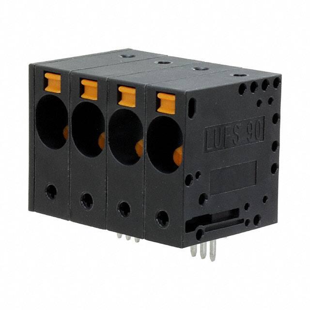

    Data sheet OMNIMATE Power - series LU LUFS 10.00/04/90V 5.0SN BK BX Weidmüller Interface GmbH & Co. KG Klingenbergstraße 16 D-32758 Detmold Germany Fon: +49 5231 14-0 Fax: +49 5231 14-292083 www.weidmueller.com     High-performance PCB terminal with a PUSH IN connection system for conductor cross-sections up to 16 mm². • Fast connection without tools thanks to pushers to open the contact point, or direct plug-in method • Securely closed contact point, with the "Connection Safety Concept" the conductor is always clamped securely • Integrated test point for PS 2.0 test plug • Central tip test point for test probes on the upper side of the terminal • Increased derating reserves because WEMID insulating material is used. • Conductor outlet direction of 180° General ordering data   Type Order No. Version GTIN (EAN) Qty. Product data Packaging   LUFS 10.00/04/90V 5.0SN BK BX 2500470000 PCB terminal, 10.00 mm, No. of poles: 4, 90°, Solder pin length (l): 5 mm, Black, PUSH IN without actuator, Clamping range, max. : 16 mm², Box 4050118604597 30 pc(s). IEC: 1000 V / 76 A / 0.5 - 16 mm² UL: 600 V / 57 A / AWG 18 - AWG 4 Box Creation date September 14, 2018 6:50:41 PM CEST   Catalogue status 31.08.2018 / We reserve the right to make technical changes. 1     Data sheet OMNIMATE Power - series LU LUFS 10.00/04/90V 5.0SN BK BX   Weidmüller Interface GmbH & Co. KG Klingenbergstraße 16 D-32758 Detmold Germany Fon: +49 5231 14-0 Fax: +49 5231 14-292083 www.weidmueller.com Technical data Dimensions and weights   Width Height Height of lowest version Depth (inches)   41.8 mm 35 mm 30 mm 1.124 inch         Width (inches) Height (inches) Depth Net weight OMNIMATE Power - series LU THT solder connection 10 mm 4 5 mm 1.6 mm 3 18 mm   Wire connection method 1.646 inch 1.378 inch 28.55 mm 38.4 g System parameters   Product family Mounting onto the PCB Pitch in mm (P) No. of poles Solder pin length (l) Solder eyelet hole diameter (D) Number of solder pins per pole Stripping length L1 in inches Touch-safe protection acc. to DIN VDE 57 106                   1.181 inch touch-safe with connected   connectors from 6 mm² PUSH IN without actuator Conductor outlet direction 90° Pitch in inches (P) 0.394 inch Fitted by customer No Solder pin dimensions d = 1.2 mm, Octagonal Solder eyelet hole diameter tolerance (D)+ 0,1 mm Screwdriver blade 0.8 x 4.0 L1 in mm 30 mm Touch-safe protection acc. to DIN VDE IP20 plugged/ IP10 0470 unplugged   Material data   Insulating material Colour chart (similar) CTI UL 94 flammability rating Storage temperature, min. Max. relative humidity during storage Operating temperature, max.   Wemid (PA) RAL 9011 ≥ 600 V-0 -25 °C 80 % 120 °C               Colour Insulating material group Insulation resistance Contact base material Storage temperature, max. Operating temperature, min.   Black I ≥ 108 Ω E-Cu 85 °C -40 °C Conductors suitable for connection   Clamping range, min. 0.5 mm² Wire connection cross section AWG, min. AWG 18 Solid, min. H05(07) V-U 0.5 mm² Stranded, min. H07V-R 6 mm² Flexible, min. H05(07) V-K 0.5 mm² w. plastic collar ferrule, DIN 46228 pt 4, min. 0.5 mm² w. wire end ferrule, DIN 46228 pt 1, min 0.5 mm² Plug gauge acc. to EN 60999 a x b; Ø 5.3mm (B6)                   Clamping range, max. 16 mm² Wire connection cross section AWG, max. AWG 4 Solid, max. H05(07) V-U 16 mm² Stranded, max. H07V-R 16 mm² Flexible, max. H05(07) V-K 16 mm² w. plastic collar ferrule, DIN 46228 pt 4, max. 16 mm² w. wire end ferrule, DIN 46228 pt 1, max. 16 mm²   Creation date September 14, 2018 6:50:41 PM CEST   Catalogue status 31.08.2018 / We reserve the right to make technical changes. 2     Data sheet OMNIMATE Power - series LU LUFS 10.00/04/90V 5.0SN BK BX   Weidmüller Interface GmbH & Co. KG Klingenbergstraße 16 D-32758 Detmold Germany Fon: +49 5231 14-0 Fax: +49 5231 14-292083 www.weidmueller.com Technical data Rated data acc. to IEC   tested acc. to standard Rated current, max. no. of poles (Tu=20°C) Rated current, max. no. of poles (Tu=40°C) Rated voltage for surge voltage class / pollution degree III/2 Rated impulse voltage for surge voltage class/ pollution degree II/2 Rated impulse voltage for surge voltage class/ contamination degree III/3       Rated current, min. no. of poles (Tu=20°C) Rated current, min. no. of poles (Tu=40°C) Rated voltage for surge voltage class / pollution degree II/2 Rated voltage for surge voltage class / pollution degree III/3 Rated impulse voltage for surge voltage class/ pollution degree III/2           Rated voltage (Use group C) Rated current (use group B) Rated current (use group D) Wire cross-section, AWG, max.   Certificate No. (cURus) 600 V 600 V 57 A 5A AWG 18 Specifications are maximum values, details see approval certificate.             Rated voltage (use group C) Nominal voltage (use group F) Rated current (use group C) Nominal current (use group F) Wire cross-section, AWG, max.   Box 170 MMT     Packaging unit (VPE) length Packaging unit (VPE) height 270 MMT 40 MMT EC001284 EC002643 27-26-11-01       ETIM 4.0 ETIM 6.0 eClass 9.1 EC002643 EC002643 27-44-04-01 IEC 60947-7-4 76 A 76 A 1,000 V 8 kV 8 kV         76 A 76 A 1,000 V 1,000 V 8 kV Rated data acc. to CSA   Rated voltage (Use group B) Rated voltage (use group D) Rated current (use group C) Wire cross-section, AWG, min.   600 V 600 V 57 A AWG 18 600 V 57 A 5A AWG 4 Rated data acc. to UL 1059   Institute (cURus) Rated voltage (use group B) Rated voltage (use group D) Rated current (use group B) Rated current (use group D) Wire cross-section, AWG, min. Reference to approval values   E60693 600 V 1,000 V 57 A 53 A AWG 4 Packaging   Packaging Packaging unit (VPE) width   Classifications   ETIM 3.0 ETIM 5.0 eClass 6.2   Creation date September 14, 2018 6:50:41 PM CEST   Catalogue status 31.08.2018 / We reserve the right to make technical changes. 3     Data sheet OMNIMATE Power - series LU LUFS 10.00/04/90V 5.0SN BK BX   Technical data Weidmüller Interface GmbH & Co. KG Klingenbergstraße 16 D-32758 Detmold Germany Fon: +49 5231 14-0 Fax: +49 5231 14-292083 www.weidmueller.com Notes   Notes • Additional colours on request • Rated current related to rated cross-section & min. No. of poles. • Wire end ferrule without plastic collar to DIN 46228/1 • Wire end ferrule with plastic collar to DIN 46228/4 • P on drawing = pitch • Rated data refer only to the component itself. Clearance and creepage distances to other components are to be designed in accordance with the relevant application standards. IPC conformity   • The test point can only be used as potential-pickup point. Conformity: The products are developed, manufactured and delivered according international recognized standards and norms and comply with the assured properties in the data sheet resp. fulfill decorative properties in accordance with IPC-A-610 "Class 2". Further claims on the products can be evaluated on request. Approvals   Approvals   Downloads   Approval/Certificate/Document of Conformity Engineering Data Motion controllers white paper White Paper UL 600 V   Declaration of the Manufacturer STEP Download Whitepaper Download Whitepaper Creation date September 14, 2018 6:50:41 PM CEST   Catalogue status 31.08.2018 / We reserve the right to make technical changes. 4     Data sheet OMNIMATE Power - series LU LUFS 10.00/04/90V 5.0SN BK BX   Weidmüller Interface GmbH & Co. KG Klingenbergstraße 16 D-32758 Detmold Germany Fon: +49 5231 14-0 Fax: +49 5231 14-292083 www.weidmueller.com Drawings Dimensional drawing Derating curve Derating curve Creation date September 14, 2018 6:50:41 PM CEST   Catalogue status 31.08.2018 / We reserve the right to make technical changes. 5 Wave Solder Profile   Recommended wave solderding profiles Weidmüller Interface GmbH & Co. KG Klingenbergstraße 16 D-32758 Detmold Germany Fon: +49 5231 14-0 Fax: +49 5231 14-292083 www.weidmueller.com   Single Wave:   260 Contact time appr. 3 sec. 260 °C 255 °C 250 °C 240 220 200 Temperature [°C] 180 160 140 appr. 150 °C Preheating 120 100 Cooling rate < 6 °K/s 80 60 Typical process Prozess limits Temperature on board 40 Heating rate < 3 °K/s 20 0 0 20 40 60 80 100 120 time [s] 140 160 180 200 220 240 Double Wave: 255 °C Total contact time max. 10 sec. 260 240 260 °C 250 °C 220 200 Temperature [°C] 180 160 140 appr. 150°C Preheating 120 100 Cooling rate < 6 °K/s 80 60 Typical process Process limits Temperature on board 40 Heating rate < 3 °K/s 20 0 0 20 40 60 Wave soldering profiles 80 100 120 time [s] 140 160 180 200 220 240 Wired connection elements should be processed in accordance with the DIN EN 61760-1 standard. We have included two recommendations for practical wave soldering profiles, with which Weidmüller PCB terminals and connectors are qualified. When choosing a suitable profile for your application, the following factors also need to be considered: - PCB thickness - Proportion of Cu in the layers - Single/double-sided assembly - Product range - Heating and cooling rates The single and double wave profiles each indicate the recommended operating range, including the maximum soldering temperature of 260°C. In practice, the maximum soldering temperature is quite often well below the above maximum profile.   We reserve the right to make technical changes.
