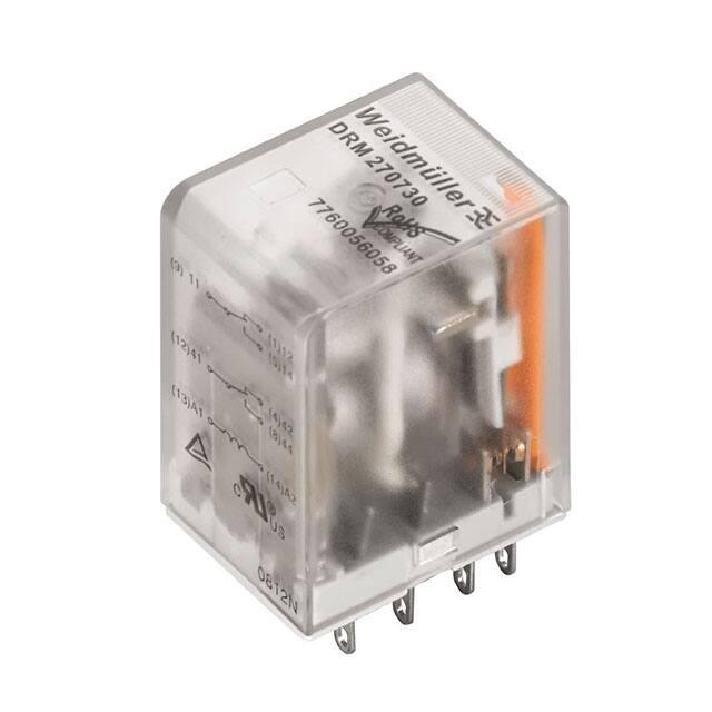

    通用 继电器 DPDT(2 Form C) 24VDC 线圈 可插
7760056051 数据手册
DRM Auxiliary Relay DRM 270 Relay 2 change over contacts AC/DC coil Relay Small size with high sensitivity Reasonable structure with wide usage Various types available TÜV Approvals with Output Load (resistive) Switching power (resistive) Contact resistance (initial) Min. load voltage / current Contact material Electrical endurance / Mechanical endurance Response / dropout delay at rated voltage Dielectric strength: Between Coil-contacts /open contacts / adjacent contacts Input Response voltage @ 25˚C Dropout voltage @ 25˚C Max. voltage @ 25˚C Insulation resistance Coil power consumption General Ambient temperature Storage temperature Humidity Atmospheric pressure Shock resistance Vibration resistance Mounting Weight Min. in package Circuit diagram PIN top view Dimensions are in mm DRM270LD Reverse polarity 10 A / 250 Vac 2500 VA, 300W ≤ 50 mΩ 12 V / 10 mA or 5 V / 1 mA (gold plated contact) Silver alloy or silver alloy with gold plating > 25×10 4 (1800 Ops/h) / > 2×107 (18000 Ops/h) ≤ 20 ms / ≤ 20 ms 2000VAC/1min / 1000VAC/1min / 2000VAC/1min (leakage current: 1mA) DC: ≥ 75% of raged voltage, AC: ≥ 80% of raged voltage DC: ≥ 10% of raged voltage, AC: ≥ 30% of raged voltage 110% of raged voltage ≥ 1000 MΩ DC: ≤ 0.9 W, AC: 1.2 VA DC: -40 °C...+60°C, AC: -40 °C...+55°C -40 °C...+70°C 35%~85% RH 86-106KPa 10G (half wave of sine pulse: 11ms) 10~55Hz dual amplitude: 1.0mm 10~55Hz Push-in connection or PCB welding 35 g 20 pcs Application Max. DC load break capacity DC24V(L/R=7ms) inductive load 0 1 2 3 4 5 6 7 8 Operating current (A) 9 10 Temperature derating curve 300 12 200 100 DRM270 50 40 30 20 10 Load current (A) Operating cycles (x10 4) 250VAC COSø=0.4 inductive load 10 0 34 250VAC resistive load 100 Switching voltage (VDC) DRM270 electrical life 1000 10 8 DRM270 6 4 2 0.1 0.2 0.5 1 2 5 10 20 Switching current (A) 0 10 50 55 60 65 70 75 80 85 90 Ambient temperature ( C) DRM Auxiliary Relay Type code DRM 270 Relay 2 change over contacts AC/DC coil DRM Type DRM Type of construction 2 change over contact Coil voltage Relay 006 6Vdc / 012 12Vdc 024 24Vdc /048 48Vdc 110 110Vdc / 220 220Vdc 524 24Vac / 548 48Vac 615 115Vac / 730 230Vac LED L (Red for AC coil; green for DC coil) Test lever T (Red for AC coil; green for DC coil) Suppressor diode D Ordering information 24 V AC 2CO 48 V AC 2CO 115 V AC 2CO 230 V AC 2CO Input Rated voltage Rated current (50Hz / 60Hz) Coil resistance Response / dropout voltage Max. voltage Power consumption 24 V AC 62.4mA/52.2mA 160Ω ±10% 19.2V / 7.2V 26.4V 1.0~1.2VA(60Hz) 48 V AC 33.3mA/27.8mA 600Ω ±10% 38.4V / 14.4V 52.8V 1.0~1.2VA(60Hz) 115 V AC 12.6mA/10.8mA 3.750Ω ±10% 92V / 34.5V 126.5V 1.0~1.2VA(60Hz) 230 V AC 6.1mA/5.2mA 16.000Ω ±10% 184V / 69V 253V 1.0~1.2VA(60Hz) Type DRM270524 DRM270548 DRM270615 DRM270730 Order No. 7760056055 7760056056 7760056057 7760056058 DRM270524L DRM270548L DRM270615L DRM270730L 7760056064 7760056065 7760056066 7760056067 DRM270524LT DRM270548LT DRM270615LT DRM270730LT 7760056073 7760056074 7760056075 Ordering information Standard With LED Type Order No. With LED and test lever Type Order No. With LED, gold plated contact With LED and test lever, gold plated contact Type 7760056076 DRM270730L Au Order No. 7760056184 Type DRM270730LT Au Order No. 7760056186 Note Ordering information 12 V DC 2CO 24 V DC 2CO 48 V DC 2CO 110 V DC 2CO 220 V DC 2CO Input Rated voltage Rated current Coil resistance Response / dropout voltage Max. voltage Power consumption 12 V DC 75mA 160Ω ±10% 9V / 1.2V 13.2V 0.9W 24 V DC 36.9mA 650Ω ±10% 18V / 2.4V 26.4V 0.9W 48 V DC 18.5mA 2,600Ω ±10% 36V / 4.8V 52.8V 0.9W 110V DC 10mA 11,000Ω ±10% 82.5V / 11V 121.0V 0.9W 220V DC 5.2mA 44,000Ω ±10% 165V / 22V 242V 0.9W Type DRM270012 DRM270024 DRM270048 DRM270110 DRM270220 Order No. 7760056050 7760056051 7760056052 7760056053 7760056054 DRM270012L DRM270024L DRM270048L DRM270110L DRM270220L Ordering information Relay Standard With LED Type Order No. With LED and test lever Type Order No. With LED and suppressor diode Type Order No. With LED, gold plated contact With LED and test lever, gold plated contact Type Order No. Type Order No. 7760056059 7760056060 7760056061 7760056062 7760056063 DRM270012LT DRM270024LT DRM270048LT DRM270110LT DRM270220LT 7760056069 7760056070 7760056071 7760056072 7760056068 DRM270024LD 7760056077 DRM270024L Au 7760056183 DRM270024LT Au 7760056185 35 DRM Auxiliary Relay DRM 570 Relay 4 change over contacts AC/DC coil Relay Small size with high sensitivity Reasonable structure with wide usage Various types available Approvals with TÜV Output Load (resistive) Switching power (resistive) Contact resistance (initial) Min. load voltage / current Contact material Electrical endurance / Mechanical endurance Response / dropout delay at rated voltage Dielectric strength: Between Coil-contacts /open contacts / adjacent contacts Input Response voltage @ 25˚C Dropout voltage @ 25˚C Max. voltage @ 25˚C Insulation resistance Coil power consumption General Ambient temperature Storage temperature Humidity Atmospheric pressure Shock resistance Vibration resistance Mounting Weight Min. in package Circuit diagram PIN top view Dimensions are in mm DRM570LD Reverse polarity 10 A / 250 Vac 2500 VA, 300W ≤ 50 mΩ 12 V / 10 mA or 5 V / 1 mA (gold plated contact) Silver alloy or silver alloy with gold plating > 25×104 (1800 Ops/h) / > 2×107 (18000 Ops/h) ≤ 20 ms / ≤ 20 ms 2000VAC/1min / 1000VAC/1min / 2000VAC/1min (leakage current: 1mA) DC: ≥ 75% of raged voltage, AC: ≥ 80% of raged voltage DC: ≥ 10% of raged voltage, AC: ≥ 30% of raged voltage 110% of raged voltage ≥ 1000 MΩ DC: ≤ 0.9 W, AC: 1.2 VA DC: -40 °C...+60°C, AC: -40 °C...+55°C -40°C...+70°C 35%~85% RH 86-106KPa 10G (half wave of sine pulse: 11ms) 10~55Hz dual amplitude: 1.0mm 10~55Hz Push-in connection or PCB welding 35 g 20 pcs Application DC24V(L/R=7ms) inductive load 0 36 0 1 2 3 4 5 6 7 8 Operating current (A) 9 10 300 12 200 100 DRM570 50 40 30 20 10 Load current (A) 250VAC resistive load 250VAC COSø=0.4 inductive load Switching voltage (VDC) Operating cycles (x10 4) 100 10 Temperature derating curve Max. DC load break capacity DRM570 electrical life 1000 10 8 6 4 DRM570 2 0.1 0.2 0.5 1 2 5 10 20 Switching current (A) 0 10 50 55 60 65 70 75 80 85 90 Ambient temperature (˚C) DRM Auxiliary Relay DRM 570 Relay 4 change over contacts AC/DC coil Type code DRM Type DRM Type of construction 4 change over contact Coil voltage Relay 006 6Vdc / 012 12Vdc 024 24Vdc /048 48Vdc 110 110Vdc / 220 220Vdc 524 24Vac / 548 48Vac 615 115Vav / 730 230Vac LED L (Red for AC coil; green for DC coil) Test lever T (Red for AC coil; green for DC coil) Suppressor diode D Ordering information 24 V AC 4CO 48 V AC 4CO 115 V AC 4CO 230 V AC 4CO Input Rated voltage Rated current (50Hz / 60Hz) Coil resistance Response / dropout voltage Max. voltage Power consumption 24 V AC 62.4mA/52.2mA 160Ω ±10% 19.2V / 7.2V 26.4V 1.0~1.2VA(60Hz) 48 V AC 33.3mA/27.8mA 615Ω ±10% 38.4V / 14.4V 52.8V 1.0~1.2VA(60Hz) 115 V AC 12.6mA/10.8mA 4,340Ω ±10% 92V / 34.5V 126.5V 1.0~1.2VA(60Hz) 230 V AC 6.1mA/5.2mA 15,000Ω ±10% 184V / 69V 253V 1.0~1.2VA(60Hz) Type DRM570524 DRM570548 DRM570615 DRM570730 Order No. 7760056083 7760056084 7760056085 7760056086 DRM570524L DRM570548L DRM570615L DRM570730L Ordering information Standard With LED Type Order No. With LED and test lever Type Order No. With LED, gold plated contact With LED and test lever, gold plated contact 7760056092 7760056093 7760056094 7760056095 DRM570524LT DRM570548LT DRM570615LT DRM570730LT 7760056101 7760056102 7760056103 Type 7760056104 DRM570730L Au Order No. 7760056188 Type DRM570730LT Au Order No. 7760056190 Note Ordering information 12 V DC 4CO 24 V DC 4CO 48 V DC 4CO 110 V DC 4CO 220 V DC 4CO Input Rated voltage Rated current Coil resistance Response / dropout voltage Max. voltage Power consumption 12 V DC 75mA 160Ω ±10% 9V / 1.2V 13.2V 0.9W 24 V DC 36.9mA 630Ω ±10% 18V / 2.4V 26.4V 0.9W 48 V DC 18.5mA 2,600Ω ±10% 36V / 4.8V 52.8V 0.9W 110V DC 10mA 11,000Ω ±10% 82.5V / 11V 121.0V 0.9W 220V DC 5.2mA 42,000Ω ±10% 165V / 22V 242V 0.9W Type DRM570012 DRM570024 DRM570048 DRM570110 DRM570220 Order No. 7760056078 7760056079 7760056080 7760056081 7760056082 DRM570012L DRM570024L DRM570048L DRM570110L DRM570220L Ordering information Standard With LED Type Order No. With LED and test lever Type Order No. With LED and suppressor diode Type Order No. With LED, gold plated contact With LED and test lever, gold plated contact Type Order No. Type Order No. 7760056087 7760056088 7760056089 7760056090 7760056091 DRM570012LT DRM570024LT DRM570048LT DRM570110LT DRM570220LT 7760056097 7760056098 7760056099 7760056100 7760056096 DRM570024LD 7760056105 DRM570024L Au 7760056187 DRM570024LT Au 7760056189 37 DRL Power Relay DRL Power Relay 1 or 2 change over contacts, AC/DC coil 28max 36max 7 Arc shield High dielectric strength: 2,000 V Approvals with TÜV Relay 0.5 4.8 28max 36max 7 0.5 Output Max. switching voltage Continuous current Contact material Min. load voltage / current Contact resistance (initial) Electrical endurance Response / dropout delay Input Response voltage @ 25˚C Circuit diagram PIN top view Dimensions are in mm 1CO 1 2 3 4 5 6 7 AC: ≤ 80% of rated voltage DC: ≤ 75% of rated voltage AC: ≥ 30% of rated voltage DC: ≥ 10% of rated voltage 110% of raged voltage 1.2 VA / 0.9 W Dropout voltage @ 25˚C Coil power consumption General Operation temperature Storage temperature Humidity Dielectric strength Coil-contact Between N.O. contacts Between adjacent contacts Clearance / creepage distance Insulation IEC60664 Rated voltage Pollution category Over voltage category Vibration resistance Shock resistance Approval Weight Min. in package Dimension Length x Width x Height 2CO 2 3 5 7 4 6 8 4.8 250 V AC 16 A @ 1CO / 10A @ 2CO AgCdO 12 V / 100 mA < 50 mΩ > 10 × 10 4 cycles (1,800 cycles / hour) < 20 ms / < 20 ms 8 1 35 … 85 % 2000V AC / 1 min 1000V AC / 1 min 2000V AC / 1 min 1.5 mm / 4 mm 250 V 3 III 10~55Hz dual amplitude: 1.0mm 10G (half wave of sine pulse: 11ms) CE; TÜV; UL 35 g 20 pcs 28 x 21.5 x 43 mm DC coil operation range 1CO Inductive load 250VAC COSØ0.4 AC coil operation range 1CO Inductive load 24VDC(L/R=7ms) 5x105 1CO Resistive load 3x105 1CO\3CO\4CO Resistive load DC current [A] Switching cycles [times] 1x106 Ambient temperature[˚C] 1x105 2CO\3CO\4CO Inductive load 24VDC (L/R=7ms) 2CO\3CO\4CO Inductive load 250VAC COSØ0.4 0.1 0.3 1 3 7 Switching current [A] Electrical life Ambient temperature[˚C] 38 21.5max 10 16 DC voltage [V] Max. DC load contact on-off curve 21.5max DRL Power Relay DRL Power Relay 1 or 2 change over contacts, AC/DC coil Type code DRL Coil voltage 012 048 220 615 Relay Type code Type DRL Type of construction 170 1 change over contact 270 2 change over contacts 12Vdc / 024 24Vdc 48Vdc / 110 110Vdc 220Vdc / 524 24Vac 115Vac / 730 230Vac LED indicator Ordering information Input Rated voltage Response / dropout voltage Power consumption Rated coil current Coil resistance 12 V DC 24 V DC 48 V DC 12 V DC 9 V / 1.2 V 0.9 W 75 mA 160Ω ±10% 24 V DC 18 V / 2.4 V 0.9 W 36.9 mA 650Ω ±10% 48 V DC 36 V / 4.8 V 0.9 W 18.5 mA 2,600Ω ±10% 110 V DC 220 V DC 110 V DC 82.5 V / 11 V 0.9 W 10 mA 11,000Ω ±10% 220 V DC 165 V / 22 V 0.9 W 5.2 mA 42,000Ω ±10% DRL170220L Ordering information 1 change over contact 1CO Type DRL170012L DRL170024L DRL170048L DRL170110L Order No. 1133450000 1133460000 1133470000 1133480000 1133490000 Type DRL270012L DRL270024L DRL270048L DRL270110L DRL270220L Order No. 1133510000 1133520000 1133530000 1133540000 1133550000 2 change over contact 2CO 24 V AC Ordering information Input Rated voltage Response / dropout voltage Power consumption Rated coil current (50 Hz) Coil resistance 24 V AC 19.2 V / 7.2 V 1.2 VA 54 mA 160Ω ±10% 115 V AC 115 V AC 92 V / 34.5 V 1.2 VA 12.9 mA 3,750Ω ±10% 230 V AC 230 V AC 184 V / 69 V 1.2 VA 6.8 mA 13,000Ω ±10% Ordering information 1 change over contact 1CO Type DRL170524L DRL170615L DRL170730L Order No. 1133840000 1133850000 1133860000 Type DRL270524L DRL270615L DRL270730L Order No. 1133870000 1133880000 1133890000 2 change over contact 2CO 39 DRL Power Relay 31.5max 28max DRL Power Relay 3 or 4 change over contacts, AC/DC coil 36max 7 Arc shield High dielectric strength: 2,000 V Approvals with TÜV Relay 4.8 41.5max 28max 36max 7 0.5 Output Max. switching voltage Continuous current Contact material Min. load voltage / current Contact resistance (initial) Electrical endurance Response / dropout delay Input Response voltage @ 25˚C Circuit diagram PIN top view Dimensions are in mm 3CO 1 2 3 4 7 5 8 6 9 250 V AC 10A AgCdO 12 V / 100 mA < 50 mΩ > 10 × 10 4 cycles (1,800 cycles / hour) < 20 ms / < 20 ms AC: ≤ 80% of rated voltage DC: ≤ 75% of rated voltage AC: ≥ 30% of rated voltage DC: ≥ 10% of rated voltage 110% of raged voltage 3CO:2 VA / 1.4 W; 4CO:2.5 VA / 1.5 W Dropout voltage @ 25˚C 11 10 Coil power consumption General Operation temperature Storage temperature Humidity Electrical strength Coil-contact Between N.O. contacts Between adjacent contacts Clearance / creepage distance Insulation IEC60664 Rated voltage Pollution category Over voltage category Vibration resistance Shock resistance Approval Weight Min. in package Dimension Length x Width x Height 4CO 1 2 3 4 5 9 6 10 7 11 8 12 13 14 4.8 35 … 85 % 2000V AC / 1 min 1000V AC / 1 min 2000V AC / 1 min 1.5 mm / 4 mm 250 V 3 III 10~55Hz dual amplitude: 1.0mm 10G (half wave of sine pulse: 11ms) CE; TÜV; UL 3CO: 50g; 4CO: 65g 10 28 x 21.5 x 43 mm DC coil operation range 1CO Inductive load 250VAC COSØ0.4 AC coil operation range 1CO Inductive load 24VDC(L/R=7ms) 5x105 1CO Resistive load 3x105 1CO\3CO\4CO Resistive load DC current [A] Ambient temperature[˚C] Switching cycles [times] 1x106 1x105 2CO\3CO\4CO Inductive load 24VDC (L/R=7ms) 2CO\3CO\4CO Inductive load 250VAC COSØ0.4 0.1 0.3 1 3 7 Switching current [A] Electrical life Ambient temperature[˚C] 40 10 16 DC voltage [V] Max. DC load contact on-off curve DRL Power Relay DRL Power Relay 3 or 4 change over contacts, AC/DC coil Type code DRL Coil voltage 012 048 220 615 Relay Type code Type DRL Type of construction 370 3 change over contact 570 4 change over contacts 12Vdc / 024 24Vdc 48Vdc / 110 110Vdc 220Vdc / 524 24Vac 115Vac / 730 230Vac LED indicator 12 V DC Ordering information Input Rated voltage Response / dropout voltage 12 V DC 9 V / 1.2 V 3CO 4CO 1.4 W 1.5 W 120 mA 125 mA 100Ω ±10% 96Ω ±10% Power consumption Rated coil current Coil resistance 24 V DC 48 V DC 24 V DC 48 V DC 18 V / 2.4 V 36 V / 4.8 V 3CO 4CO 3CO 4CO 1.4 W 1.5 W 1.4 W 1.5 W 60 mA 66.7 mA 30 mA 31.2 mA 400Ω ±10% 360Ω ±10% 1,600Ω ±10% 1,540Ω ±10% 110 V DC 220 V DC 110 V DC 220 V DC 82.5 V / 11 V 165 V / 22 V 3CO 4CO 3CO 4CO 1.4 W 1.5 W 1.4 W 1.5 W 13.1 mA 16.2 mA 6.7 mA 7.6 mA 8,400Ω ±10% 6,800Ω ±10% 33,000Ω ±10% 29,000Ω ±10% Ordering information 3 change over contact 3CO Type DRL370012L DRL370024L DRL370048L DRL370110L Order No. 1133570000 1133580000 1133590000 1133600000 1133610000 Type DRL570012L DRL570024L DRL570048L DRL570110L DRL570220L Order No. 1133620000 1133630000 1133640000 1133650000 1133660000 24 V AC 115 V AC 230 V AC 24 V AC 19.2 V / 7.2 V 3CO 4CO 2 VA 2.5 VA 80 mA 93.5 mA 102Ω ±10% 80Ω ±10% 115 V AC 92 V / 34.5 V 3CO 4CO 2 VA 2.5 VA 16 mA 25.5 mA 2,300Ω ±10% 1,680Ω ±10% 4 change over contact 4CO Ordering information Input Rated voltage Response / dropout voltage Power consumption Rated coil current (50 Hz) Coil resistance DRL370220L 230 V AC 184 V / 69 V 3CO 4CO 2 VA 2.5 VA 10 mA 13.1mA 8,600Ω ±10% 6700Ω ±10% Ordering information 3 change over contact 3CO Type DRL370524L DRL370615L DRL370730L Order No. 1133910000 1133920000 1133930000 Type DRL570524L DRL570615L DRL570730L Order No. 1133940000 1133950000 1133960000 4 change over contact 4CO 41 DRR Power Relay DRR Power Relay 2 change over contacts, AC/DC coil 9.5(max) 66 34.5(max) Relay 52.5(max) 34.5(max) 2500 VA switchover capacity 8-pin plug in DIN rail installation Approvals with TÜV Output Max. switching voltage Continuous current Contact material Min. load voltage / current Contact resistance (initial) Electrical endurance Response / dropout delay Input Response voltage @ 25˚C Circuit diagram PIN top view Dimensions are in mm AC 4 5 3 6 2 7 1 8 Coil power consumption General Operation temperature Storage temperature Humidity Electrical strength Coil-contact Between N.O. contacts Between adjacent contacts Clearance / creepage distance Insulation IEC60664 Rated voltage Pollution category Over voltage category Vibration resistance Shock resistance Approval Weight Min. in package Dimension Length x Width x Height 5 3 6 2 7 1 AC: ≤ 80% of rated voltage DC: ≤ 75% of rated voltage AC: ≥ 30% of rated voltage DC: ≥ 15% of rated voltage 110% of raged voltage 2.7 VA / 1.5 W Dropout voltage @ 25˚C DC 4 250 V AC 10A AgCdO 12 V / 100 mA < 50 mΩ > 10 × 10 4 cycles (1,800 cycles / hour) < 30 ms / < 20 ms 8 5 … 85 % 2500V AC / 1 min 1000V AC / 1 min 2500V AC / 1 min 1.5 mm / 4 mm 250 V 3 III 10~55Hz dual amplitude: 1.0mm 10G (half wave of sine pulse: 11ms) CE; TÜV; UL 75g 10 34.5 x 34.5 x 66 mm DC coil operation range AC coil operation range 5 x10 5 3 x10 5 Resistive load DC current [A] Ambient temperature[˚C] Switching cycles [times] 1 x10 6 1 x10 5 Inductive load Inductive load Switching current [A] Electrical life Ambient temperature[˚C] 42 DC voltage [V] Max. DC load contact on-off curve DRR Power Relay DRL Power Relay 2 change over contacts, AC/DC coil Type code DRR Coil voltage 012 048 220 615 Relay Type code Type DRR Type of construction 270 2 change over contacts 12Vdc / 024 24Vdc 48Vdc / 110 110Vdc 220Vdc / 524 24Vac 115Vac / 730 230Vac LED indicator 12 V DC 2CO Ordering information Input Rated voltage Response / dropout voltage Power consumption Rated coil current Coil resistance 12 V DC 9 V / 1.8 V 1.5 W 125 mA 96Ω ±10% 24 V DC 2CO 48 V DC 2CO 110 V DC 2CO 220 V DC 2CO 24 V DC 18 V / 3.6 V 1.5 W 55.8 mA 430Ω ±10% 48 V DC 36 V / 7.2 V 1.5 W 29.3 mA 1640Ω ±10% 110 V DC 82.5 V / 16.5 V 1.5 W 14.9 mA 7360Ω ±10% 220 V DC 165 V / 33 V 1.5 W 7.5 mA 29500Ω ±10% Ordering information Type Order No. Ordering information Input Rated voltage Response / dropout voltage Power consumption Rated coil current (50 Hz/60Hz) Coil resistance DRR270012L DRR270024L DRR270048L DRR270110L DRR270220L 1133360000 1133370000 1133380000 1133390000 1133400000 24 V AC 2CO 115 V AC 2CO 230 V AC 2CO 24 V AC 19.2 V / 7.2 V 2.7 VA 130 mA/116 mA 62.5Ω ±10% 115 V AC 92 V / 34.5 V 2.7 VA 29.8 mA/25.4 mA 1250Ω ±10% 230 V AC 184 V / 69 V 2.7 VA 14.9 mA/12.7 mA 6500Ω ±10% Ordering information Type Order No. DRR270524L DRR270615L DRR270730L 1133760000 1133780000 1133800000 43 DRR Power Relay DRR Power Relay 3 change over contacts, AC/DC coil 9.5(max) 66 34.5(max) Relay 52.5(max) 34.5(max) 2500 VA switchover capacity 11-pin plug in DIN rail installation Approvals with TÜV Circuit diagram PIN top view Dimensions are in mm DRR3CO AC 6 5 DRR3CO-A AC 7 6 5 7 4 8 4 8 3 9 3 9 2 1 11 10 2 1 11 6 5 7 4 3 2 1 11 4 9 3 10 6 5 8 7 9 1 11 AC: ≤ 80% of rated voltage DC: ≤ 80% of rated voltage AC: ≥ 30% of rated voltage DC: ≥ 15% of rated voltage 110% of raged voltage 2.7 VA / 1.5 W Dropout voltage @ 25˚C Coil power consumption General Operation temperature Storage temperature Humidity Electrical strength 8 2 250 V AC 10A AgNi 90/10 12 V / 100 mA < 50 mΩ > 10 × 10 4 cycles (1,800 cycles / hour) < 30 ms / < 20 ms 10 DC DC Output Max. switching voltage Continuous current Contact material Min. load voltage / current Contact resistance (initial) Electrical endurance Response / dropout delay Input Response voltage @ 25˚C 10 5 … 85 % 2500V AC / 1 min 1000V AC / 1 min 2500V AC / 1 min 1.5 mm / 4 mm Coil-contact Between N.O. contacts Between adjacent contacts Clearance / creepage distance Insulation IEC60664 Rated voltage Pollution category Over voltage category Vibration resistance Shock resistance Approval Weight Min. in package Dimension Length x Width x Height 250 V 3 III 10~55Hz dual amplitude: 1.0mm 10G (half wave of sine pulse: 11ms) CE; TÜV; UL 75g 10 34.5 x 34.5 x 66 mm DC coil operation range AC coil operation range 5 x10 5 3 x10 5 Resistive load DC current [A] Ambient temperature[˚C] Switching cycles [times] 1 x10 6 1 x10 5 Inductive load Inductive load Switching current [A] Electrical life Ambient temperature[˚C] 44 DC voltage [V] Max. DC load contact on-off curve DRR Power Relay DRL Power Relay 3 change over contacts, AC/DC coil DRR Type code Type DRR Type of construction Coil voltage 012 048 220 615 Relay 370 3 change over contacts 12Vdc / 024 24Vdc 48Vdc / 110 110Vdc 220Vdc / 524 24Vac 115Vac / 730 230Vac LED indicator 12 V DC 3CO Ordering information Input Rated voltage Response / dropout voltage Power consumption Rated coil current Coil resistance 24 V DC 3CO 48 V DC 3CO 110 V DC 3CO 220 V DC 3CO 24 V DC 18 V / 3.6 V 1.5 W 55.8 mA 430Ω ±10% 48 V DC 36 V / 7.2 V 1.5 W 29.3 mA 1640Ω ±10% 110 V DC 82.5 V / 16.5 V 1.5 W 14.9 mA 7360Ω ±10% 220 V DC 165 V / 33 V 1.5 W 7.5 mA 29500Ω ±10% DRR370012L DRR370024L DRR370048L DRR370110L DRR370220L 1133410000 1133420000 1133430000 1133440000 1133560000 DRR370024L-A DRR370048L-A DRR370110L-A DRR370220L-A 7760056250 7760056251 7760056252 7760056253 7760056254 24 V AC 3CO 115 V AC 3CO 230 V AC 3CO 24 V AC 19.2 V / 7.2 V 2.7 VA 130 mA/116 mA 62.5Ω ±10% 115 V AC 92 V / 34.5 V 2.7 VA 29.8 mA/25.4 mA 1250Ω ±10% 230 V AC 184 V / 69 V 2.7 VA 14.9 mA/12.7 mA 6500Ω ±10% DRR370524L DRR370615L DRR370730L 1133810000 1133820000 1133830000 DRR370615L-A DRR370730L-A 7760056256 7760056257 12 V DC 9 V / 1.8 V 1.5 W 125 mA 96Ω ±10% Ordering information Type Order No. Type Order No. Ordering information Input Rated voltage Response / dropout voltage Power consumption Rated coil current (50 Hz/60Hz) Coil resistance DRR370012L-A Ordering information Type Order No. Type Order No. DRR370524L-A 7760056255 45 RRD Power Relay Relay 57.00 2500 VA switchover capacity With test lever Approvals with VDE 35.50 Output Max. switching voltage Continuous current Contact material Mechanical endurance Response / dropout delay at rated voltage General Operation temperature UL 94 fire retardant class Approval Insulation coordination Electrical strength Coil-contact Between N.O. contacts Between adjacent contacts Clearance / creepage distance Insulation IEC60664 Rated voltage Pollution category Over voltage category Insulation VDE 0110b (2/79) Dielectric index of relay socket Circuit diagram PIN top view Dimensions are in mm 69.00 35.50 RRD Relay 2 change over contacts AC/DC coil 250 V AC 10A AgNi 90/10 20x106 switching cycles 12 ms / 5 ms V-0 cURus; CE; VDE 2,500V AC / 1 min 1,500V AC / 1 min 2,500V AC / 1 min 2.8 mm / 4 mm 250 V 3 III C / 250 CTI 175 Dimension Length x Width x Height 35.5 x 35.5 x 57 mm Application DC coil operation range DC load breaking capacity . Switchover voltage[Vdc] 3 对触点串联 1 对触点 . 250 Vac 阻性负载 . 2 对触点串联 . . . Un 额定线圈电压 . . . . . Switching current[A] Ambient temperature[ C] AC coil operation range . Attenuation factor Coil voltage[U/Un] . . . . . . Un 额定线圈电压 . . Ambient temperature[ C] 46 Electrical life . 阻性负载 Power factor Derating curve at COS 10 × 10 4 cycles < 20 ms / < 20 ms 1 Hz 2NO 1NO/1NC Contact material Min. load voltage / current Contact resistance (initial) Electrical endurance Response / dropout delay Max. switching frequency at rated load Input Response voltage @ 25˚C AC: ≤ 80% of rated voltage DC: ≤ 75% of rated voltage AC: ≥ 30% of rated voltage DC: ≥ 10% of rated voltage 110% of raged voltage 2.5 VA / 1.5 W 36 AC (4)14 (7)11 (4)14 (9)31 (6)34 (9)31 (6)34 (A)A1 (B)A2 (A)A1 (B)A2 3 5.5 7 9 A B 8.5 7.7 1NO/1NC 16 36 4 22.2 36 DC AC (7)11 (4)14 (9)31 (3)32 (A)A1 (B)A2 (7)11 (4)14 (9)31 (3)32 (A)A1 (B)A2 Switching cycles [times] Coil voltage [U/Un] Coil voltage [U/Un] AC coil operation range 400 V 3 III 10~55Hz dual amplitude: 1.0mm 10G (half wave of sine pulse: 11ms) CE; TÜV; UL 48 g 36 x 36 x 48 mm Max. DC load contact on-off curve 110 Switching current[A] Ambient temperature[˚C] 52 35 … 85 % 4,000V AC / 1 min 2,500V AC / 1 min 4,000V AC / 1 min 1.5 mm / 4 mm Coil-contact Between N.O. contacts Between adjacent contacts Clearance / creepage distance Insulation IEC60664 Rated voltage Pollution category Over voltage category Vibration resistance Shock resistance Approval Weight Dimension Length x Width x Height Electrical life DC coil operation range Ambient temperature[˚C] Coil power consumption General Operation temperature Storage temperature Humidity Electrical strength Switching voltage (VDC) DC (7)11 Switching current[A] DRH DC Relay Type code DRH DC Relay 2 N.O. contact and 1 N.C. contact AC / DC coil DRH Type DRH Type of construction 275 1NO/1NC 276 2NO 12 V DC Ordering information Input Rated voltage DC response / dropout voltage Power consumption DC rated current Coil resistance 12 V DC 9 V / 1.2 V 1.5 W 120 mA 100Ω ±10% 24 V DC 24 V DC 18 V / 2.4 V 1.5 W 60 mA 400Ω ±10% Relay Coil voltage 012 12Vdc / 024 24Vdc 048 48Vdc / 110 110Vdc 220 220Vdc / 524 24Vac 548 48Vac / 615 115Vac 730 230Vac With LED or test lever LT 48 V DC 110 V DC 220 V DC 48 V DC 36 V / 4.8 V 1.5 W 30 mA 1,600Ω ±10% 110 V DC 82.5 V / 11 V 1.5 W 13.03 mA 8,400Ω ±10% 220 V DC 165 V / 22 V 1.5 W 6.7 mA 33,000Ω ±10% DRH275048LT DRH275110LT DRH275220LT Ordering information Type 1 N.O. contact/ 1 N.C. contact Order No. 2 N.O. contact Type Order No. With test lever locking clip Type Order No. Ordering information Input Rated voltage DC response / dropout voltage Power consumption DC rated current Coil resistance DRH275012LT 1220040000 DRH276012LT 1220140000 Test lever block for DRH/DRW DRH275024LT 1220050000 DRH276024LT 1220150000 Test lever block for DRH/DRW 1220060000 DRH276048LT 1220170000 Test lever block for DRH/DRW 1220070000 1220080000 DRH276110LT DRH276220LT 1220180000 1220190000 Test lever block for DRH/DRW 7760056249 7760056249 7760056249 7760056249 24 V AC 48 V AC 115 V AC 24 V AC 19.2V / 7.2 V 2.5 VA 101.7 mA 100Ω ±10% 48 V AC 38.4 V / 14.4 V 2.5 VA 51.04 mA 350Ω ±10% 115 V AC 92 V / 34.5 V 2.5 VA 21.2 mA 2,200Ω ±10% 230 V AC 184 V / 69 V 2.5 VA 10.61 mA 8,000Ω ±10% DRH275615LT DRH275730LT Test lever block for DRH/DRW 7760056249 230 V AC Ordering information Type 1 N.O. contact/ 1 N.C. contact Order No. 2 N.O. contact Type Order No. With test lever locking clip Type Order No. DRH275524LT 1220090000 DRH276524LT 1220200000 Test lever block for DRH/DRW 7760056249 DRH275548LT 1220110000 DRH276548LT 1220210000 Test lever block for DRH/DRW 7760056249 1220120000 DRH276615LT 1220220000 Test lever block for DRH/DRW 7760056249 1220130000 DRH276730LT 1220230000 Test lever block for DRH/DRW 7760056249 53 DRW Power Relay DRW power relay 2CO / 3CO contacts AC / DC coil Max 36mm Max 36mm Max 8.5mm Max 48mm Relay Suitable to switch high voltage load With LED and test lever Approval with TÜV 4.7mm Output Max. switching voltage Continuous current Contact material Min. load voltage / current Contact resistance (initial) Electrical endurance Response / dropout delay Max. switching frequency at rated load Input Response voltage @ 25˚C Circuit diagram PIN top view Dimensions are in mm 6 7 5.5 3 4 9 A 16 1 8.5 7.7 36 2CO B 400 V AC 16 A@ 400 VAC; 16 A@ 30 VDC AgCdO 12 VDC / 100 mA < 50 mΩ > 10 × 10 4 cycles < 20 ms / < 10 ms 1 Hz AC: ≤ 80% of rated voltage DC: ≤ 75% of rated voltage AC: ≥ 30% of rated voltage DC: ≥ 10% of rated voltage 110% of raged voltage 2.5 VA / 1.5 W 22.2 Dropout voltage @ 25˚C 36 AC (7)11 (1)12 (4)14 (3)32 (6)34 (9)31 (3)32 (6)34 (B)A2 (A)A1 (B)A2 (1)12 (4)14 (9)31 (A)A1 3CO Coil power consumption General Operation temperature Storage temperature Humidity Electrical strength 3 5 6 7 8 A 9 B 16 2 4 5.5 1 8.5 7.7 36 11.1 22.2 36 DC (7)11 (8)21 (9)31 (10)A1 AC (1)12 (4)14 (2)22 (5)24 (3)32 (6)34 (11)A2 (7)11 (8)21 (9)31 (10)A1 (1)12 (4)14 (2)22 (5)24 (3)32 (6)34 Ambient temperature[˚C] Coil voltage [U/Un] AC coil operation range Electrical life Switching cycles [times] Coil voltage [U/Un] Normal voltage Coil-contact Between N.O. contacts Between adjacent contacts Clearance / creepage distance Insulation IEC60664 Rated voltage Pollution category Over voltage category Vibration resistance Shock resistance Approval Weight Dimension Length x Width x Height 400 V 3 III 10~55Hz dual amplitude: 1.0mm 10G (half wave of sine pulse: 11ms) CE; TÜV; UL 51 g 36 x 36 x 48 mm Max. DC load contact on-off curve Max. voltage Normal voltage Switching current[A] Ambient temperature[˚C] 54 35 … 85 % 4,000V AC / 1 min 2,500V AC / 1 min 4,000V AC / 1 min 3.5 mm / 6 mm (11)A2 DC coil operation range Max. voltage 2CO: - 40 … 60˚C; 3CO: - 40 ... 50 C; Switching voltage (VDC) DC (7)11 Switching current[A] DRW Power Relay DRW power relay 2CO / 3CO contacts AC / DC coil Type code DRW Type DRW Type of construction 270 2CO 174 1NC 12 V DC Ordering information Input Rated voltage DC response / dropout voltage Power consumption DC rated current Coil resistance 12 V DC 9 V / 1.2 V 1.5 W 120 mA 100Ω ±10% 24 V DC 24 V DC 8 V / 2.4 V 1.5 W 60 mA 400Ω ±10% Relay Coil voltage 012 12Vdc / 024 24Vdc 048 48Vdc / 110 110Vdc 220 220Vdc / 524 24Vac 548 48Vac / 615 115Vac 730 230Vac / 900 400Vac With LED or test lever LT 48 V DC 110 V DC 220 V DC 48 V DC 36 V / 4.8 V 1.5 W 30 mA 1,600Ω ±10% 110 V DC 82.5 V / 11 V 1.5 W 13.03 mA 8,400Ω ±10% 220 V DC 115 V / 22 V 1.5 W 6.7 mA 33,000Ω ±10% DRW270048LT DRW270110LT 1219750000 1219760000 1219770000 DRW370048LT DRW370110LT DRW370220LT 1219810000 1219820000 1219830000 Ordering information Type 2CO contact Order No. Type 3CO contact Order No. With test lever locking clip Type Order No. DRW270012LT 1219730000 DRW370012LT 1219780000 Test lever block for DRH/DRW 7760056249 24V AC Ordering information Input Rated voltage AC response / dropout voltage Power consumption AC rated current Coil resistance 24 V AC 19.2V / 7.2 V 2.5 VA 101.7 mA 100Ω ±10% DRW270024LT 1219740000 DRW370024LT 1219790000 Test lever block for DRH/DRW Test lever block for DRH/DRW 7760056249 7760056249 48V AC 115V AC Test lever block for DRH/DRW 7760056249 230V AC DRW270220LT Test lever block for DRH/DRW 7760056249 400V AC 48 V AC 38.4 V / 14.4 V 2.5 VA 51.04 mA 115 V AC 92 V / 34.5 V 2.5 VA 21.2 mA 230 V AC 184 V / 69 V 2.5 VA 10.61 mA 400 V AC 320 V / 120 V 2.5 VA 6.1 mA 350Ω ±10% 2,200Ω ±10% 8,000Ω ±10% 30,000Ω ±10% DRW270615LT DRW2701730LT 1219370000 1219380000 1219390000 DRW370615LT DRW370730LT DRW370900LT 1219430000 1219440000 1219450000 Ordering information Type 2CO contact Order No. Type 3CO contact Order No. With test lever locking clip Type Order No. DRW270524LT 1219350000 DRW370524LT 1219410000 Test lever block for DRH/DRW 7760056249 DRW270548LT 1219360000 DRW370548LT 1219420000 Test lever block for DRH/DRW 7760056249 Test lever block for DRH/DRW 7760056249 Test lever block for DRH/DRW 7760056249 DRW270900LT Test lever block for DRH/DRW 7760056249 55 PWR High Power Relay 34max 55max 50.5max TÜV 7.5 36.5max 10 Relay Approval with 50.5max 34max Output Circuit diagram 1NO Ω 4 36.8 Input 17.7 0 6 4 6 General 14.4 3 III Dimension DC coil operation range AC coil operation range 56 Electrical life Max. DC load contact on-off curve PWR High Power Relay PWR high power relay 1 N.O. contact AC / DC coil Ordering information Input Rated voltage DC response / dropout voltage Power consumption DC rated current Coil resistance Type code PWR 6 V DC 1NO 12 V DC 1NO 24 V DC 1NO 48 V DC 1NO 6 V DC 4.5 V / 0.9 V 1.9 W 317 mA 18.9Ω ±10% 12 V DC 9 V / 1.8 V 1.9 W 160 mA 75Ω ±10% 24 V DC 18 V / 3.6 V 1.9 W 79.2 mA 303Ω ±10% 48 V DC 36 V / 7.2 V 1.9 W 39.3 mA 1,220Ω ±10% PWR153006LT PWR153012LT PWR153024LT PWR153048LT Relay Type PWR Type of construction and mounting 153 1N.O. contact, push-in connection 173 1N.O. contact, DIN-rail mounting Coil voltage 006 6Vdc / 012 12Vdc 024 24Vdc / 048 48Vdc 110 110Vdc / 220 220Vdc 524 24Vac / 548 48Vac 615 115Vac / 730 230Vac 880 380Vac L with LED T with test lever P PCB welding 110 V DC 1NO 220 V DC 1NO 110 V DC 82.5 V / 16.5 V 1.9 W 17.3 mA 6,360Ω ±10% 220 V DC 165 V / 33 V 1.9 W 8.6 mA 25,474Ω ±10% Ordering information Type plug-in , need socket Order No. Din rail installation,no need socket Type Order No. PCB soldering Type Order No. 1219590000 PWR173006L 1219460000 PWR153006P 1233010000 24 V AC 1NO Ordering information Input Rated voltage AC response / dropout voltage Power consumption AC rated current Coil resistance PWR153110LT PWR153220LT 1219610000 1219620000 1219630000 1219640000 1219650000 PWR173012L PWR173024L PWR173048L PWR173110L PWR173220L 1219470000 1219480000 1219490000 1219510000 1219520000 PWR153012P PWR153024P PWR153048P PWR153110P PWR153220P 1233020000 1233030000 1233040000 1233050000 1233060000 48 V AC 1NO 115 V AC 1NO 24 V AC 18V / 3.6 V 2.5 VA 87.3 mA 275Ω ±10% 48 V AC 36 V / 7.2 V 2.5 VA 43.6 mA 1,100Ω ±10% 115 V AC 86.3 V / 17.3 V 2.5 VA 22.1 mA 5,200Ω ±10% PWR153524LT PWR153548LT 230 V AC 1NO 230 V AC 172.5 V / 34.5 V 2.5 VA 11.0 mA 21,000Ω ±10% 380 V AC 1NO 115 V AC 285 V / 57 V 2.5 VA 6.1 mA 62,650Ω ±10% Ordering information Din-rail mounting without socket Type Order No. 1219230000 Push-in connection with Type socket Order No. PWR173524L PCB welding PWR153524P Type Order No. 1219090000 1232860000 PWR153615LT PWR153730LT PWR153880LT 1219240000 1219250000 1219260000 1219270000 PWR173548L PWR173615L PWR173730L PWR173880L 1219120000 1219130000 1219140000 1219150000 PWR153548P PWR153615P PWR153730P PWR153880P 1232870000 1232880000 1232890000 1232900000 57 PWR High Power Relay PWR high power relay 2 N.O. contact AC / DC coil 34max 55max 50.5max 7.5 36.5max 10 Relay Max. load current: 25 A Various mounting methods available Approval with TÜV 50.5max Output Max. switching voltage Continuous current Contact material Min. load voltage / current Contact resistance (initial) Electrical endurance Response / dropout delay Circuit diagram PIN top view Dimensions are in mm 2NO 277 V AC 25 A Ag alloy 12 VDC / 100 mA < 50 mΩ > 10 × 10 4 cycles < 30 ms / < 30 ms Input Response voltage @ 25˚C 0 17.7 4 6 8 0 2 6 8 Normal voltage Ambient temperature[˚C] Coil voltage [U/Un] AC coil operation range 250 V 3 III 10~55Hz dual amplitude: 1.0mm 10G (half wave of sine pulse: 11ms) CE; TÜV Push-in connection/PCB welding: 90g; DIN-rail mounting: 120g 34 x 50.5 x 36.5 mm Electrical life Switching cycles [times] Coil voltage [U/Un] DC coil operation range Max. voltage 35 … 85 % 2,000V AC / 1 min 2,000V AC / 1 min 4,000V AC / 1 min 1.5 mm / 4 mm Coil-contact Between N.O. contacts Between adjacent contacts Clearance / creepage distance Insulation IEC60664 Rated voltage Pollution category Over voltage category Vibration resistance Shock resistance Approval Weight Dimension Length x Width x Height 1 4 Coil power consumption General Operation temperature Storage temperature Humidity Electrical strength Max. DC load contact on-off curve Switching voltage (VDC) 2 14.4 36.8 Max. voltage Normal voltage Switching current[A] Ambient temperature[˚C] 58 AC: ≤ 75% of rated voltage DC: ≤ 75% of rated voltage AC: ≥ 15% of rated voltage DC: ≥ 15% of rated voltage 110% of raged voltage 2.5 VA / 1.9 W 1 Dropout voltage @ 25˚C 6- Ø3.2 34max Switching current[A] PWR High Power Relay PWR high power relay 2 N.O. contact AC / DC coil Type code PWR Type PWR Type of construction and mounting 256 2N.O. contact, push-in connection 276 2N.O. contact, DIN-rail mounting Ordering information Input Rated voltage DC response / dropout voltage Power consumption DC rated current Coil resistance 6 V DC 2NO 12 V DC 2NO 24 V DC 2NO 48 V DC 2NO 6 V DC 4.5 V / 0.9 V 1.9 W 317 mA 18.9Ω ±10% 12 V DC 9 V / 1.8 V 1.9 W 160 mA 75Ω ±10% 24 V DC 18 V / 3.6 V 1.9 W 79.2 mA 303Ω ±10% 48 V DC 36 V / 7.2 V 1.9 W 39.3 mA 1,220Ω ±10% PWR256006LT PWR256012LT PWR256024LT PWR256048LT Relay Coil voltage 006 6Vdc / 012 12Vdc 024 24Vdc / 048 48Vdc 110 110Vdc / 220 220Vdc 524 24Vac / 548 48Vac 615 115Vac / 730 230Vac 880 380Vac L with LED T with test lever P PCB welding 110 V DC 2NO 220 V DC 2NO 110 V DC 82.5 V / 16.5 V 1.9 W 17.3 mA 6,360Ω ±10% 220 V DC 165 V / 33 V 1.9 W 8.6 mA 25,474Ω ±10% Ordering information Type plug-in , need socket Order No. Din rail installation,no need socket Type Order No. PCB soldering Type Order No. 1219660000 PWR276006L 1219530000 PWR256006P 1233070000 24 V AC 2NO Ordering information Input Rated voltage AC response / dropout voltage Power consumption AC rated current Coil resistance PWR256110LT PWR256220LT 1219670000 1219680000 1219690000 1219710000 1219720000 PWR276012L PWR276024L PWR276048L PWR276110L PWR276220L 1219540000 1219550000 1219560000 1219570000 1219580000 PWR256012P PWR256024P PWR256048P PWR256110P PWR256220P 1233080000 1233090000 1233110000 1233120000 1233130000 48 V AC 2NO 115 V AC 2NO 24 V AC 18V / 3.6 V 2.5 VA 87.3 mA 275Ω ±10% 48 V AC 36 V / 7.2 V 2.5 VA 43.6 mA 1,100Ω ±10% 115 V AC 86.3 V / 17.3 V 2.5 VA 22.1 mA 5,200Ω ±10% PWR256524LT PWR256548LT 230 V AC 2NO 230 V AC 172.5 V / 34.5 V 2.5 VA 11.0 mA 21,000Ω ±10% 380 V AC 2NO 115 V AC 285 V / 57 V 2.5 VA 6.1 mA 62,650Ω ±10% Ordering information plug-in , need socket Type Order No. Din rail installation,no need socket PCB soldering Type Order No. Type Order No. 1219280000 PWR276524L 1219160000 PWR256524P 1232910000 PWR256615LT PWR256730LT PWR256880LT 1219290000 1219320000 1219330000 1219340000 PWR276548L PWR276615L PWR276730L PWR276880L 1219170000 1219180000 1219190000 1219220000 PWR256548P PWR256615P PWR256730P PWR256880P 1232920000 1232930000 1232940000 1232990000 59 Relay Socket Separated socket (for RCL relay) 61 Relay Circuit diagram PIN top view Dimensions are in mm Ordering information 1 x 12A / 2 x 12A 35.6 300 Vac >4000 Vrms 76.4 79.6 C / 250 Vac -40...+70°C IP 20 30.4 3.5 2 x 2.5 mm2 / 2 x 1.5 mm2 0.5Nm / 0.8Nm 10 pcs. 15.6 VBG 4 7.5 1CO/2CO 3 .3 Technical data Rated current Rated voltage Coil/contact electrical strength Insulation (VDE 0110b) Ambient temperature Protection level Electric shock prevention category Wire cross section / with terminal Wiring torque / max. Packing unit 16.5 Sockets connected by screws, DIN-rail mounting Description 3.5mm pitch, DIN-rail mounting 5mm pitch screw connected sockets, DIN-rail mounting Type SRC ECO 1CO* SRC ECO 2CO* Order No. 7760056005 7760056006 Accessories Mark, for SRC ECO relay sockets Mark SRC ECO 7760056178 7 * SRC ECO sockets already have plastic release clip and mark Separated socket (for RCM and DRM relays) 29 61 Dimensions are in mm Ordering information 4 x 6 A, 3 x 10 A, 2 x 12 A 300 Vac >4000 Vrms 75 C / 250 Vac -40...+70°C IP 20 VBG 4 2 x 2.5 mm2 / 2 x 1.5 mm2 27 0.5 Nm / 0.8 Nm 10 pcs. 3.2 Technical data Rated current Rated voltage Coil/contact electrical strength Insulation (VDE 0110b) Ambient temperature Protection level Electric shock prevention category Wire cross section / with terminal Wiring torque / max. Packing unit Sockets connected by screws, DIN-rail mounting, 3CO Sockets connected by screws, DIN-rail mounting, 4CO Type Order No. SCM 2CO SCM ECO 2CO* SCM 3CO SCM 4CO SCM ECO 4CO* 8690880000 7760056007 8690890000 8690900000 7760056008 75 Sockets connected by screws, DIN-rail mounting Description Sockets connected by screws, DIN-rail mounting, 2CO * SRC ECO sockets already have plastic release clip and mark Relay clips (plastic and metal) Ordering information For SCM 2CO, SCM 3CO and SCM 4CO Description Plastic clip for RCM of 29 mm Metal clip for RCM of 29 mm Accessories Mark, for SRC ECO relay sockets 60 22.5 Type SCM CLIP P SCM CLIP M Order No. 8691110000 7760056039 Mark SCM ECO 7760056179 Relay Socket Hybrid socket (for RCM and DRM relay) Relay 29.5Max Dimensions are in mm Technical data Rated current Rated voltage Dielectric withstand voltage / coil-contacts Dielectric withstand voltage / between contacts Wiring torque / max. Wire Environments Weight Min. in package 2CO/4CO 22Max Ordering information 12A/10A 25Max 66.5Max 300Vac 2500Vrms 2500Vrms 2CO 4CO Qty. 10 Order No. 7760056106 FS 4CO 10 7760056107 66.5Max 31Max Description DIN-Rail mounting sockets DIN-Rail mounting sockets Accessories Mark, for SRC ECO relay sockets -40°C...+70°C 35g/43g 20pcs Type FS 2CO* 25Max 2CO/4CO 29.5Max 0.5Nm/0.8Nm 0.5-2.5 mm2 7760056180 Mark FS 71 * Functional module is not suitable for this type of sockets. Note: FS sockets already have marks. Economic socket (for RCM and DRM relay) 30Max Dimensions are in mm 35.5 15 Ordering information Technical data Rated current Rated voltage Dielectric withstand voltage / coil-contacts Dielectric withstand voltage / between contacts Wiring torque / max. Wire Environments Weight Min. in package Description 2CO/4CO 59 10A/5A 300V 30Max 2000V 2000V 0.5Nm/0.8Nm 0.5-2.5mm2 DIN-Rail mounting sockets 2CO DIN-Rail mounting sockets 4CO DIN-Rail mounting sockets with finger protection 2CO DIN-Rail mounting sockets with finger protection 4CO Note: functional module is not suitable for this type of sockets 35.5 75Max -40°C...+70°C 43g/56g 20pcs Type Qty. Order No. FS 2CO ECO 10 7760056126 FS 4CO ECO FS 2CO F ECO FS 4CO F ECO 10 7760056127 10 10 1190740000 1190750000 22 29Max 2CO/4CO 22Max 75Max 59 Metal clip (recommended for vibration occasion) Order No. 7760056108 7760056128 Type DRM clip M (for DRM relay) Metal clip set (for DRM relay, only with FS ECO sockets) Functional modules Technical data Suppressor diode 6...230Vdc RC-combined protection110...230 Vac RC-combined protection110...230Vac with LED Green LED 6...24 Vdc with suppressor diode Green LED 24...60 Vdc with suppressor diode Green LED 110...230 Vdc with suppressor diode Green LED 6...24 Vdc / Vac Green LED 24...60 Vdc / Vac Green LED 110...230 Vdc / Vac * Type RIM 1 6/230VDC RIM 3 110/230VAC RIM 3 110/230VAC LED RIM 2 6/24VDC RIM 2 24/60VDC RIM 2 110/230VDC RIM 3 6/24VUC RIM 3 24/60VUC RIM 3 110/230VUC Order No. 7760056169 7760056014 7760056045 7760056015 7760056016 7760056017 7940018457 7760056018 7940018455 DRM clip M Metal clip set * For SCM/SRC sockets only, not for FS sockets. 61 Relay Socket DRL relay socket SLD Dimensions are in mm Relay 27.8Max SLD 2CO 67.5Max 27.8Max SLD 3CO Order No. 10 1132830000 SLD 3CO 10 1132840000 SLD 4CO 10 1132850000 SLD Clip M 10 7760056242 69.8Max SLD 4CO 27.8Max SLD 2CO 35.5 40.5Max  ss 300 V 10 A 2,000 V 2,500 V -40 … 85˚C 2 III 1.0 Nm 0.5 … 2.5 mm2 IP10 2CO: 50 g ; 3CO: 60 g ; 4CO: 76 g CE Type Qty. 36.5 35.5 46.5  ss DRL relay socket SLD 50.5Max Technical data Rated voltage Rated current Coil/contact electrical strength Electrical strength between contacts Operation temperature Pollution class Over voltage class Wiring torque Wire cross section Protection level (IEC 61810) Weight Approvals Description DIN-rail mounted socket, 2CO DIN-rail mounted socket, 3CO DIN-rail mounted socket, 4CO Metal clips (pair) 26.5 Ordering information 30Max  ss 35.5 69.8Max Ordering information 30Max SLD F 2CO 300 V 10 A 2,000 V 2,500 V -40 … 85˚C 2 III 1.0 Nm 0.5 … 2.5 mm2 IP20 CE Type 24.1Max 83.3Max 30Max SLD F 3CO Order No. 10 7760056225 SLD F 3CO 10 7760056226 SLD F 4CO 10 7760056227 83.3Max 34.1Max SLD F 2CO Ordering information Type Order No. Metal clip 7760056108 SLD clip 3CO 7760056234 SLD clip 4CO 7760056235 Type RIM 1 6/230Vdc Order No. 7760056169 RIM 3 110/230Vac 7760056014 RIM 5 6/230Vac 1174670000 RIM 5 6/230Vdc 1174650000 83.3Max Ordering information Technical data Suppressing diode 6…230Vdc, for SLD F 2CO/3CO Blocking modular 110…230 Vac, for SLD F 2CO/3CO Blocking modular 6 … 230 Vac, for SLD F 4CO Suppressing diode 6…230 Vdc, for SLD F 4CO 62 SLD F 4CO 30Max Technical data Metal clips SLD F 2CO Metal clips SLD F 3CO Metal clips SLD F 4CO 44.1Max Technical data Rated voltage Rated current Coil/contact electrical strength Electrical strength between contacts Operation temperature Pollution class Over voltage class Wiring torque Wire cross section Protection level (IEC 61810) Approvals Description DIN-rail mounted socket, 2CO DIN-rail mounted socket, 3CO DIN-rail mounted socket, 4CO Relay Socket DRR/RRD relay sockets Dimensions are in mm Relay SRD ECO 2CO 27.2Ma x 73Max 12A 300V 1132810000 0928 35.5 24 22 12 3 14 2 A1 4 1 11 5 8 21 6 7 A2 7 7 A2 IEC: NEMA: 300 V 12 A 4,000 V 2,500 V -40 … 85˚C 2 III 1.0 Nm 0.5 … 2.5 mm2 2 SRD ECO 3CO IP20 50 g CE Type Qty. Order No. SRD ECO 2CO 10 1132810000 SRD ECO 3CO 10 1132820000 73Max 27.2Ma x Technical data Rated voltage Rated current Coil/contact electrical strength Electrical strength between contacts Operating temperature Pollution class Over voltage class Wiring torque Wire cross section Protection level (IEC 61810) Weight Approvals Description DIN-rail mounting rockets, 8-pin DIN-rail mounting rockets, 11-pin 38.2Ma x 4 Ordering information 12A 300V 1132820000 0924 35.5 4 34 32 7 24 5 22 3 14 4 12 38.2Ma x 2 A1 IEC: NEMA: 1 11 8 6 21 9 31 2 11 8869370000 10 A2 Order No. 1134160000 A2 DRR SOCKET METAL CLIP SRD-I CLIP M 10 Description Metal clip for DRR relay sockets Metal clip for RRD relay sockets 10 Metal clip RIM 6/23 5 0VA C C R A2 A1 Functional modules Technical data RC combined protection 6 … 230 Vac Protective diode 6 … 230 Vdc Type RIM 5 6/230Vac RIM 5 6/230Vdc Order No. 1174670000 1174650000 63 Relay Socket PWR relay socket Shape Relay 46Max RELAY SOCKET SWR 1220240000 30A 400V RoHS COMPLIANT 1008 35.5 Mounting Product performance 55.5Max 6 4 Relay type SWR 0 2 Assembled relays and accessories Technical data Product type PWR relay socket 1 8 30 A 400 V AC 2500 V/S 1.0Nm 20-10/0.5-5.5AWG/mm2 -40~+85°C 56g 40±0.05 Technical data Rated current Rated voltage Medium withstand voltage Screw torque External wire Environments Weight Order No. 1220240000 51.2Max DRH and DRW relay socket Dimensions are in mm SPW ECO 3CO 31.3Max 1 Ordering information 64 92Max SPW ECO 3CO Metal clip DRH/DRW 5.5 8.3 39max 400 V AC 16 A 4,000 V 4,000 V -40 … 60˚C 2 II 1.2 Nm 0.5 … 4 mm2 IP20 64g CE, UL Type 22.2 Technical data Rated voltage Rated current Coil/contact electrical strength Electrical strength between contacts Operation temperature Pollution class Over voltage class Wiring torque/max. Wire cross section Protection level (IEC 61810) Weight Approvals Description Relay socket, for DRH and DRW relays Metal clip Qty. 10 10 Order No. 1220250000 1220260000 21.5 Relay Socket RCL sockets with PCB pins SRC 05 PCB 20 20 Order No. 7760056110 7760056111 7.5 Qty. Relay 5 5 7.5 Type SRC 05 PCB SRC 08 PCB 20 3.53.5 31.5Max 7760056110 31.5Max 13.7 0928 13Max 12 A 2 x 12 A 300 V AC – 40 °C ... +80 °C 13Max Rated voltage Ambient temperature Approvals Description Sockets with PCB pins, pitch: 3.5 mm Sockets with PCB pins, pitch: 5 mm SRC 08 PCB 20 12A 300V 1CO 2CO 8A 300V Technical data Rated current 13.7 Ordering information 0928 7760056111 Note: SRC 05 PCB and SRC 08 PCB already contain metal clip RCM/DRM sockets with PCB pins SCM 14 PCB Ordering information 0928 7760056113 15.5 30 Technical data Rated current Rated voltage Ambient temperature 10 A 250 V AC – 40 °C ... +80 °C 16.8 6.4 4.2 Approvals Sockets with PCB pins, 4CO Metal clip DRM PCB Qty. 10 10 10 Order No. 7760056112 1132790000 7760056113 1209690000 21.8 Sockets with PCB pins, 3CO Type SCM 08 PCB SCM 11 PCB SCM 14 PCB metal clip DRM PCB 13.2 Sockets with PCB pins, 2CO 4.4 Description 6A 300V RRD sockets with PCB pins SRD 8-pin Ordering information Technical data Rated current Rated voltage Ambient temperature Description Sockets with PCB pins, 8-pin Sockets with PCB pins, 11-pin 10 A 250 VAC – 40 °C ... +70 °C Type SRD 2CO PCB SRD 3CO PCB SRD 11-pin Qty. 25 25 Order No. 8697750000 8697730000 SPW PCB 1132800000 0928 12 DRH/DRW sockets with PCB pins SPW PCB SPW METAL CLIP Qty. 10 Order No. 1132800000 1238770000 21.4 8.4 16 A 400 VAC – 40 °C ... +70 °C Type 5.5 Technical data Rated current Rated voltage Ambient temperature Description Sockets with PCB pins, 11-pin Metal clip SPW PCB 35 Ordering information 22.2 38.5 65
