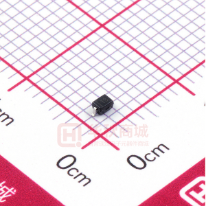

WTE POWER SEMICONDUCTORS BAV19W – BAV21W SURFACE MOUNT FAST SWITCHING DIODE Features ! ! ! High Conductance A SOD-123 Dim A Min 3.6 2.5 1.4 0.5 — 0.4 0.95 — Max 3.9 2.8 1.8 0.7 0.2 — 1.35 0.12 Fast Switching Speed Surface Mount Package Ideally Suited for Automatic Insertion ! For General Purpose Switching Application C ! Plastic Material – UL Recognition Flammability Classification 94V-O  E D B B C D E G H J Mechanical Data ! ! ! ! ! Case: SOD-123, Molded Plastic Terminals: Plated Leads Solderable per MIL-STD-202, Method 208 Polarity: Cathode Band Weight: 0.01 grams (approx.) Marking: BAV19W A8 BAV20W A80 BAV21W A82 @TA=25°C unless otherwise specified H G J All Dimensions in mm Maximum Ratings Characteristic Non-Repetitive Peak Reverse Voltage Peak Repetitive Reverse Voltage Working Peak Reverse Voltage DC Blocking Voltage RMS Reverse Voltage Forward Continuous Current (Note 1) Average Rectified Output Current (Note 1) Non-Repetitive Peak Forward Surge Current Power Dissipation Typical Thermal Resistance, Junction to Ambient Air (Note 1) Operating and Storage Temperature Range @ t = 1.0ms @ t = 1.0s Symbol VRM VRRM VRWM VR VR(RMS) IFM IO IFSM Pd RJA Tj, TSTG BAV19W 120 100 70 BAV20W 200 150 105 400 200 2.5 0.5 410 500 -65 to +150 BAV21W 250 200 140 Unit V V V mA mA A mW K/W °C Electrical Characteristics Characteristic Forward Voltage Drop Peak Reverse Leakage Current At Rated DC Blocking Voltage @TA=25°C unless otherwise specified Symbol @ IF = 100mA VFM IRM Cj trr BAV19W BAV20W 1.0 BAV21W Unit V 100 150 5.0 50 200 nA pF nS Typical Junction Capacitance (VR = 0V DC, f = 1.0MHz) Reverse Recovery Time (Note 2) Note: 1. Valid provided that terminals are kept at ambient temperature. 2. Measured with IF = IR = 30mA, IRR = 0.1 x IR, RL = 100. BAV19W – BAV21W 1 of 3 © 2002 Won-Top Electronics IF, INSTANTANEOUS FORWARD CURRENT (mA) 1000 Tj = 25°C 100 IR, LEAKAGE CURRENT (µA) 100 10 10 1 1.0 0.1 0.1 0.01 0 1 2 VF, INSTANTANEOUS FORWARD VOLTAGE (V) Fig. 1 Forward Characteristics 0.01 0 100 200 Tj, JUNCTION TEMPERATURE (°C) Fig. 2 Leakage Current vs Junction Temperature BAV19W – BAV21W 2 of 3 © 2002 Won-Top Electronics ORDERING INFORMATION Product No.! BAV19W-T1 BAV19W-T3 BAV20W-T1 BAV20W-T3 BAV21W-T1 BAV21W-T3 Package Type SOD-123 SOD-123 SOD-123 SOD-123 SOD-123 SOD-123 Shipping Quantity 3000/Tape & Reel 10000/Tape & Reel 3000/Tape & Reel 10000/Tape & Reel 3000/Tape & Reel 10000/Tape & Reel Products listed in bold are WTE Preferred devices. ! T1 suffix refers to a 7” reel. T3 suffix refers to a 13” reel. Shipping quantity given is for minimum packing quantity only. For minimum order quantity, please consult the Sales Department. RECOMMENDED FOOTPRINT 0.04 (1.02) 0.055 (1.40) 0.094 (2.40) inches(mm) Won-Top Electronics Co., Ltd (WTE) has checked all information carefully and believes it to be correct and accurate. However, WTE cannot assume any responsibility for inaccuracies. Furthermore, this information does not give the purchaser of semiconductor devices any license under patent rights to manufacturer. WTE reserves the right to change any or all information herein without further notice. WARNING: DO NOT USE IN LIFE SUPPORT EQUIPMENT. WTE power semiconductor products are not authorized for use as critical components in life support devices or systems without the express written approval. Won-Top Electronics Co., Ltd. No. 44 Yu Kang North 3rd Road, Chine Chen Dist., Kaohsiung, Taiwan Phone: 886-7-822-5408 or 886-7-822-5410 Fax: 886-7-822-5417 Email: sales@wontop.com Internet: http://www.wontop.com We power your everyday. © 2002 Won-Top Electronics BAV19W – BAV21W 3 of 3
BAV20W-T3
1. 物料型号: - BAV19W-T1:SOD-123封装,3000/卷带装。 - BAV19W-T3:SOD-123封装,10000/卷带装。 - BAV20W-T1:SOD-123封装,3000/卷带装。 - BAV20W-T3:SOD-123封装,10000/卷带装。 - BAV21W-T1:SOD-123封装,3000/卷带装。 - BAV21W-T3:SOD-123封装,10000/卷带装。
2. 器件简介: - 该器件为表面贴装快速开关二极管,适用于自动插入和一般用途的开关应用。
3. 引脚分配: - 根据封装SOD-123,通常有两个引脚:阳极和阴极。
4. 参数特性: - 高导通性 - 快速开关速度 - 表面贴装封装,适合自动插入 - 一般用途的开关应用 - 塑料材料,UL认可的阻燃等级94V-0
5. 功能详解: - 非重复峰值反向电压:BAV19W为120V,BAV20W为200V,BAV21W为250V。 - 工作峰值反向电压:BAV19W为100V,BAV20W为150V,BAV21W为200V。 - 直流阻断电压VR,RMS反向电压VR(RMS):BAV19W为70V,BAV20W为105V,BAV21W为140V。 - 正向连续电流IFM:400mA。 - 平均整流输出电流IO:200mA。 - 非重复峰值正向浪涌电流IFSM:BAV19W为2.5A,BAV20W为0.5A。 - 功率耗散Pd:410mW。 - 典型热阻,结到环境空气ReJA:500K/W。 - 工作和存储温度范围TSTG:-65至+150℃。
6. 应用信息: - 适用于一般用途的开关应用。
7. 封装信息: - 封装类型为SOD-123,尺寸参数最小值和最大值详细列出,包括A、B、C、D、E、G、H、J等尺寸。
