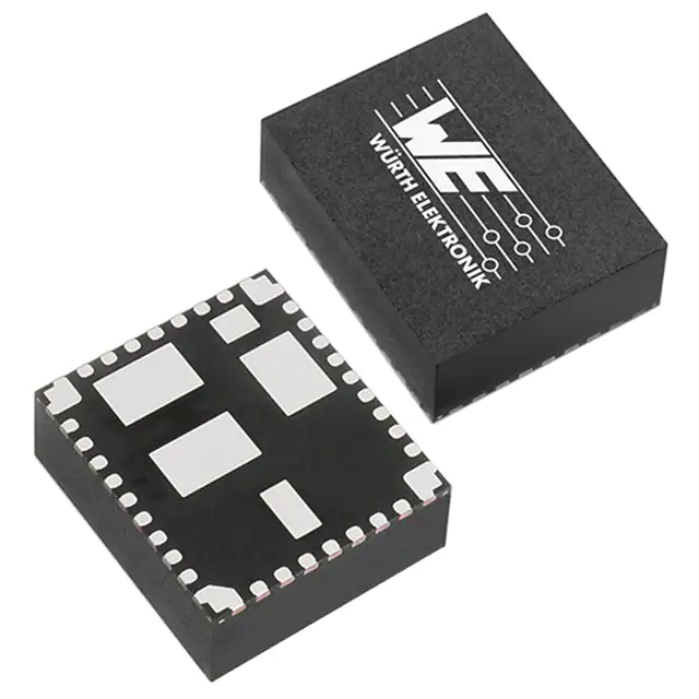

WPMDB1600362Q / 171060302 MagI3C Power Module VDRM – Variable Step Down Regulator Module 2.95 – 6V / 6A / 0.8 – 3.6V Output DESCRIPTION FEATURES 3 The VDRM 1710x0302 series of the MagI C Power Module family provide a fully integrated DC-DC power supply including the switching regulator with integrated MOSFETs, compensation and shielded inductor in one package. These modules require as few as 4 external components. The 171060302 offers high efficiency and delivers up to 6A of output current. It operates with an input voltage from 2.95 to 6V and is designed for fast transient response. It is available in a standard industrial high power density QFN package (11mm x 9mm x 2.8mm) with very good thermal performance. This module has an on-board protection circuitry to guard against thermal overstress and electrical damage featuring thermal shutdown, over-current, short-circuit, overvoltage and undervoltage protections. TYPICAL APPLICATIONS · · · · · · · Point-of-load DC-DC applications from 5V and 3.3V rails Industrial, test & measurement, medical applications Communication infrastructure System power supplies DSPs, FPGAs, MCUs and MPU supply I/O interface power supply High density distributed power systems · · · · · · · · · · · · · · · · · · · · · · · · · · · Peak efficiency up to 96% Current capability up to 6A Input voltage range: 2.95 to 6V Output voltage range: 0.8 to 3.6V Continuous output power: 21.6W Integrated shielded inductor Low output voltage ripple: 4mV typ. Reference accuracy over temperature: 1% max. Adjustable switching frequency: 0.5 to 2 MHz Current Mode control Synchronous operation Forced continuous mode under light load Undervoltage lockout protection (UVLO) Adjustable soft-start and voltage tracking Frequency synchronization with external clock Sequencing Thermal shutdown Short circuit protection Cycle-by-cycle current limit Output overvoltage protection Output undervoltage and overvoltage Power Good Pin compatible with 171020302 & 171040302 Operating ambient temperature up to 85°C No derating within the operating temperature range Operating junction temp. range: -40 to 125°C UL94V-0 package material Complies with EN55022 class B radiated emissions standard TYPICAL CIRCUIT DIAGRAM we-online.com ©May 2016 Würth Elektronik eiSos GmbH & Co. KG – Data Sheet Rev. 1.0 1/48 WPMDB1600362Q / 171060302 MagI3C Power Module VDRM – Variable Step Down Regulator Module PACKAGE Top View Bottom View we-online.com ©May 2016 Würth Elektronik eiSos GmbH & Co. KG – Data Sheet Rev. 1.0 2/48 WPMDB1600362Q / 171060302 MagI3C Power Module VDRM – Variable Step Down Regulator Module PIN DESCRIPTION SYMBOL NUMBER TYPE VIN 30,31,32 8,9,10,11, 12,13,14, 38 Power Input Voltage. Place input capacitors as close as possible Power Output voltage. Place output capacitors as close as possible. For thermal performance use copper plane(s) at these pins. AGND 33,34 Supply PGND 37 Power VSENSE+ 36 Input FB 35 Input RT/CLK 4 Input Analog ground for internal circuitry. Connect to power ground Power ground for the internal switching circuitry. Connect to copper plane(s) with thermal vias for thermal performance. Connect to positive terminal of the output capacitor. An internal resistor of 1430 Ω is connected internally between VSENSE+ and FB. This is the upper resistor of the feedback voltage divider. A resistor (RSET) from FB to AGND is needed to select the output voltage. This is the lower resistor of the feedback voltage divider. An external resistor from RT/CLK to AGND adjusts the switching frequency of the device. This pin can also be used to synchronize with an external clock. INTRRT 5 Analog Internal resistor which defines the default switching frequency. RCOMP 1 Analog Internal resistor of the compensation network. Must be connected to AGND. SYMBOL NUMBER TYPE UVLO 29 Input ENABLE 28 Input PG 27 Output SS/TRK 6 Input INTSS 7 Analog DESCRIPTION An internal undervoltage lock out resistor of 34kΩ is connected to the enable pin. If connected to analog ground, the internal UVLO resistor divider will be activated. For input voltages below 3.3V this pin should be left open and an optional resistor from enable to analog ground sets the UVLO to values between 2.95 and 3.3 V. Enable pin. Internally pull-up source. Pull to analog ground to disable. Float to Enable. Open drain output. The PG pin pulls low during thermal shutdown, over-current, output overvoltage or undervoltage or disabled device. A pull-up resistor is required. Internal current source. Connect an external capacitor to optionally increase the soft-start time. A voltage applied to this pin allows tracking and sequencing. An internal 3.3nF capacitor is connected to this pin. If pin 7 is connected to analog ground, a 1.1ms soft-start time is selected. SYMBOL NUMBER TYPE COMP 3 Output CCOMP 2 Analog Internal capacitor of the compensation network. Do not connect. BOOT 26 17,18,19, 20,21,22, 23,24,25, 39 Supply Internal bootstrap pin for the high side MOSFET. Power Internal switch node. Do not connect these pins. VOUT DESCRIPTION OPTIONAL AUXILIARY SWITCH NC we-online.com ©May 2016 15,16 DESCRIPTION Output of the error amplifier. If an external compensation is used, pin 1 must be left open. Not connected to internal circuitry. Würth Elektronik eiSos GmbH & Co. KG – Data Sheet Rev. 1.0 3/48 WPMDB1600362Q / 171060302 MagI3C Power Module VDRM – Variable Step Down Regulator Module ORDERING INFORMATION ORDER CODE PART DESCRIPTION SPECIFICATIONS PACKAGE PACKAGING UNIT 171060302 WPMDB1600362Q 6A / 21.6W version BQFN-39 Tape and Reel, 250 pieces 178060302 Evaluation Board 6A / 21.6W version 1 PIN COMPATIBLE FAMILY MEMBERS ORDER CODE PART DESCRIPTION SPECIFICATIONS PACKAGE PACKAGING UNIT 171020302 WPMDB1200362Q 2A / 7.2W version BQFN-39 Tape and Reel, 250 pieces 178020302 Evaluation Board 2A / 7.2W version 171040302 WPMDB1400362Q 4A / 14.4W version 178040302 Evaluation Board 4A / 14.W version 1 BQFN-39 Tape and Reel, 250 pieces 1 PACKAGE SPECIFICATIONS Weight 0.54g Molding compound EME-G770H UL class UL94 V-0 Certificate number E41429 SALES INFORMATION SALES CONTACTS Würth Elektronik eiSos GmbH & Co. KG EMC & Inductive Solutions Max-Eyth-Str. 1 74638 Waldenburg Germany Tel. +49 (0) 7942 945 0 www.we-online.com powermodules@we-online.com we-online.com ©May 2016 Würth Elektronik eiSos GmbH & Co. KG – Data Sheet Rev. 1.0 4/48 WPMDB1600362Q / 171060302 MagI3C Power Module VDRM – Variable Step Down Regulator Module ABSOLUTE MAXIMUM RATINGS Caution: Exceeding the listed absolute maximum ratings may affect the device negatively and may cause permanent damage. SYMBOL LIMITS PARAMETER MIN VIN VOUT FB UVLO EN RT/CLK PG COMP INTSS MAX (1) UNIT Input voltage -0.3 7 V Output voltage -0.6 VIN V Feedback voltage -0.3 3 V Undervoltage lockout pin voltage -0.3 3.3 V Enable pin Voltage -0.3 7 V Enable source current RT/CLK pin voltage RT/CLK source current SS/TRK (1) SS/TRK pin voltage - 100 µA -0.3 6 V - ±100 µA -0.3 3 V SS/TRK pin sink current - ±100 µA Power Good pin voltage -0.3 7 V Power Good sink current - 10 mA Output of the error amplifier pin voltage -0.3 3 V - 100 µA Internal soft-start capacitor pin voltage -0.3 3 V COMP sink current INTRRT Internal resistor for the initial switching frequency pin voltage -0.3 6 V RCOMP Resistor of the compensation network pin voltage -0.3 3 V CCOMP Capacitor of the compensation network pin voltage -0.3 3 V VOUT sense pin voltage -0.3 Vout V Switch node pin voltage -0.6 7 V 10ns transient -2 V BOOT Internal supply for the high MOSFET driver pin voltage - 7 VSW +8V Tstorage Assembled, non operating storage temperature Peak case/leads temperature during reflow soldering, max. 30sec. (JEDEC J-STD020) Maximum three cycles! -65 150 °C - 245±5 °C Mechanical shock: Mil-STD-883D, Method 2002.2, 1ms, ½ sine, mounted - 1500 G Mechanical vibration: Mil-STD-883D, Method 2007.2, 20-2000Hz - 20 G VSENSE+ SW TSOLR we-online.com ©May 2016 V Würth Elektronik eiSos GmbH & Co. KG – Data Sheet Rev. 1.0 5/48 WPMDB1600362Q / 171060302 MagI3C Power Module VDRM – Variable Step Down Regulator Module OPERATING CONDITIONS Operating conditions are conditions under which operation of the device is intended to be functional. All values are referenced to GND. MIN and MAX limits are valid for the recommended ambient temperature range of -40°C to 85°C. Typical values represents statistically the utmost probability at following conditions: VIN = 3.3V, VOUT = 1.8V, IOUT = 6A, CIN1 = 47µF ceramic, CIN2 = 220µF polymer electrolytic, COUT1 = 47µF ceramic, COUT2 = 100µF poly-tantalum unless otherwise noted. SYMBOL VIN PARAMETER MIN (1) (2) TYP MAX (1) UNIT Input voltage Output voltage (depending on input voltage and switching frequency) 2.95 - 6 V 0.8 - 3.6 V TA Ambient temperature range -40 - 85 TJOP Junction temperature range -40 - 125 °C IOUT Nominal output current 6 A VOUT (3) °C THERMAL SPECIFICATIONS SYMBOL ӨJA ΨJT ΨJB TSD we-online.com ©May 2016 PARAMETER Junction-to-ambient thermal resistance Junction-to-top TYP (4) (5) Junction-to-board (6) (2) UNIT 12 °C/W 2.2 °C/W 9.7 °C/W Thermal shutdown, rising 175 °C Thermal shutdown hysteresis, falling 15 °C Würth Elektronik eiSos GmbH & Co. KG – Data Sheet Rev. 1.0 6/48 WPMDB1600362Q / 171060302 MagI3C Power Module VDRM – Variable Step Down Regulator Module ELECTRICAL SPECIFICATIONS MIN and MAX limits are valid for the recommended ambient temperature range of -40°C to 85°C. Typical values represents statistically the utmost probability at following conditions: VIN = 3.3V, VOUT = 1.8V, IOUT = 6A, CIN1 = 47µF ceramic, CIN2 = 220µF polymer electrolytic, COUT1 = 47µF ceramic, COUT2 = 100µF poly-tantalum unless otherwise noted. SYMBOL PARAMETER TEST CONDITIONS MIN (1) TYP (2) MAX (1) UNIT Output current IOCP VFB Over current protection Reference accuracy Temperature variation Line regulation VOUT Load regulation - 9 - - - ±1 % -40°C≤TA≤85°C, IOUT = 0A Over VIN range, TA = 25°C, IOUT = 0A - ±0.3 - % - ±0.1 - % Over IOUT range, TA = 25°C - ±0.1 - % - - ±1.5 % - 4 - mVpp Using RT mode 500 - 2000 kHz RT/CLK pin open 400 500 600 kHz Using CLK mode 500 - 2000 kHz Accuracy TA = 25°C, IOUT = 0A with internal feedback resistor Total output voltage variation Output voltage ripple 10µF ceramic, 20MHz BW (8) A (7) Switching frequency fSW Switching frequency fCLK Synchronization clock frequency range Minimum CLK pulse width 75 - - ns VCLK-H RT/CLK high threshold 2.2 - 3.3 V VCLK-L RT/CLK low threshold -0.3 - 0.4 V RT/CLK to switch node delay - 90 - ns PLL lock-in-time - 14 - µs - 3.05 3.135 V 2.5 2.75 - V Enable logic high voltage - 1.25 - V Enable logic low voltage -0.3 - 1.0 V VOUT rising, VOUT GOOD - 93 - % VOUT rising, VOUT FAULT - 109 - % VOUT falling, VOUT GOOD - 107 - % VOUT falling, VOUT FAULT - 91 - % IPG = 0.33mA - - 0.3 V fCLK VUVLO VENABLE Relative to AGND Enable and undervoltage lockout VIN increasing, UVLO pin connected to AGND VIN undervoltage threshold VIN decreasing, UVLO pin connected to AGND Enable threshold trip point Power Good PG Power Good threshold Power Good low voltage we-online.com ©May 2016 Würth Elektronik eiSos GmbH & Co. KG – Data Sheet Rev. 1.0 7/48 WPMDB1600362Q / 171060302 MagI3C Power Module VDRM – Variable Step Down Regulator Module ELECTRICAL SPECIFICATIONS SYMBOL PARAMETER TEST CONDITIONS MIN (1) (2) TYP MAX (1) UNIT Efficiency VIN = 5V IOUT = 3A η Efficiency VIN = 3.3V IOUT = 3A VOUT = 3.3V, fSW = 1.0MHz - 95 - % VOUT = 2.5V, fSW = 1.0MHz - 93 - % VOUT = 1.8V, fSW = 1.0MHz - 92 - % VOUT = 1.5V, fSW = 1.0MHz - 90 - % VOUT = 1.2V, fSW = 750kHz - 89 - % VOUT = 1.0V, fSW = 650kHz - 87 - % VOUT = 0.8V, fSW = 650kHz - 85 - % VOUT = 1.8V, fSW = 1.0MHz - 91 - % VOUT = 1.5V, fSW = 1.0MHz - 90 - % VOUT = 1.2V, fSW = 750kHz - 88 - % VOUT = 1.0V, fSW = 650kHz - 87 - % VOUT = 0.8V, fSW = 650kHz - 84 - % - µF Input and output capacitors CIN External input capacitor ceramic Non ceramic External output cpacitor COUT ceramic Non ceramic Output capacitor ESR TTR Transient Response Transient Response Recovery time 1A/µs load step from 1.5A to 4.5A VOUT over/undershoot 1A/µs load step from 1.5A to 4.5A (9) 47 47 (9) 220 (10) 150 (10) 650 µF (11) µF (11) µF - 100 1000 - - 25 mΩ - 80 - µs - 120 - mV - 70 100 µA Input quiescent current ISD Shutdown quiescent current VENABLE = 0V RELIABILITY SYMBOL MTBF PARAMETER Mean Time Between Failures we-online.com ©May 2016 TEST CONDITIONS Confidence level 60%, TA=55°C, Activation energy 0.7eV, 1000 hrs test duration, 128756 samples, 0 fail MIN (1) TYP (2) 1·10 10 MAX (1) UNIT h Würth Elektronik eiSos GmbH & Co. KG – Data Sheet Rev. 1.0 8/48 WPMDB1600362Q / 171060302 MagI3C Power Module VDRM – Variable Step Down Regulator Module NOTES (1) Min and Max limits are 100% production tested at 25°C. Limits over the operating temperature range are guaranteed through correlation using Statistical Quality Control (SQC) methods. (2) Typical numbers are valid at 25°C ambient temperature and represent statistically the utmost probability assuming the Gaussian distribution. (3) Depending on heat sink design, number of PCB layers, copper thickness and air flow. (4) Measured on a 100 x 100mm two layer board, with 35µm (1 ounce) copper, no air flow (5) The junction-to-top characterization parameter, ΨJT, estimates the junction temperature, TJ, of a device in a real system, using a procedure described in JESD51-2A (sections 6 and 7). TJ = ΨJT * Pdis + TT; where Pdis is the power dissipated in the device and TT is the temperature of the top of the device. (6) The junction-to-board characterization parameter, ΨJB, estimates the junction temperature, TJ, of a device in a real system, using a procedure described in JESD51-2A (sections 6 and 7). T J = ΨJB * Pdis + TB; where Pdis is the power dissipated in the device and TB is the temperature of the board 1mm from the device. (7) The stated limit of the set-point voltage tolerance includes the tolerance of both the internal voltage reference and the internal adjustment resistor. The overall output voltage tolerance is affected by the tolerance of the external R SET resistor. (8) The industry standard for comparison of the output voltage ripple between switching regulators or modules requires a 10µF ceramic (sometimes additional 1µF ceramic in parallel) at the point of load where the voltage measurement is done using an oscilloscope with its probe and probe jack for low voltage/high frequency (low impedance) measurement. The oscilloscopes bandwidth is limited at 20MHz. (9) A minimum of 47µF of ceramic capacitance is required across the input for proper operation. Locate the capacitor directly at VIN of the device. An additional 220µF of bulk capacitance is recommended. (10) The amount of required output capacitance varies depending on the output voltage. The amount of required capacitance must include at least 47µF of ceramic capacitance. Locate the capacitance close to the device. Adding additional capacitance close to the load improves the response of the regulator to load transients. (11) When using both ceramic and non-ceramic output capacitance, the combined maximum must not exceed 1200µF. we-online.com ©May 2016 Würth Elektronik eiSos GmbH & Co. KG – Data Sheet Rev. 1.0 9/48 WPMDB1600362Q / 171060302 MagI3C Power Module VDRM – Variable Step Down Regulator Module TYPICAL PERFORMANCE CURVES If not otherwise specified, the following conditions apply: VIN = 3.3V - 5V; CIN = 2 x 47µF X7R ceramic; COUT = 2x 47µF X7R ceramic, TAMB = 25°C. RADIATED EMISSIONS EN55022 (CISPR-22) CLASS B COMPLIANT Measured on module with PCB and without external filters at 3m antenna distance 70 Radiated Emissions 171060302 VIN = 5V, VOUT = 1.8V, fSW = 1MHz, ILOAD = 6A Radiated Emissions [dBµV/m] 60 Horizontal Vertical 50 EN55022 Class A 40 EN55022 Class B 30 20 10 0 30 100 1000 Frequency [MHz] 70 Radiated Emissions 171060302 VIN = 3.3V, VOUT = 1.8V, fSW = 1MHz, ILOAD = 6A Radiated Emissions [dBµV/m] 60 Horizontal Vertical 50 EN55022 Class A 40 EN55022 Class B 30 20 10 0 30 100 1000 Frequency [MHz] we-online.com ©May 2016 Würth Elektronik eiSos GmbH & Co. KG – Data Sheet Rev. 1.0 10/48 WPMDB1600362Q / 171060302 MagI3C Power Module VDRM – Variable Step Down Regulator Module EFFICIENCY 171060302 5V Input 100 95 90 Efficiency [%] 85 80 Vout = 3.3V, fsw = 1MHz 75 Vout = 2.5V, fsw = 1MHz 70 Vout = 1.8V, fsw = 1MHz 65 Vout = 1.2V, fsw = 750kHz 60 Vout = 0.8V, fsw = 650kHz 55 50 0 1 2 3 4 Output Current [A] 5 6 171060302 3.3V Input 100 95 90 Efficiency [%] 85 80 Vout = 2.5V, fsw = 1MHz 75 Vout = 1.8V, fsw = 1MHz 70 Vout = 1.2V, fsw = 750kHz 65 Vout = 0.8V, fsw = 650kHz 60 55 50 0 we-online.com ©May 2016 1 2 3 4 Output Current [A] 5 6 Würth Elektronik eiSos GmbH & Co. KG – Data Sheet Rev. 1.0 11/48 WPMDB1600362Q / 171060302 MagI3C Power Module VDRM – Variable Step Down Regulator Module POWER DISSIPATION 171060302 5V Input 2,00 1,80 Power Dissipation [W] 1,60 1,40 1,20 Vout = 3.3V, fsw = 1MHz 1,00 Vout = 2.5V, fsw = 1MHz 0,80 Vout = 1.8V, fsw = 1MHz 0,60 Vout = 1.2V, fsw = 750kHz 0,40 Vout = 0.8V, fsw = 650kHz 0,20 0,00 0 1 2 3 4 Output Current [A] 5 6 171060302 3.3V Input 2,00 1,80 Power Dissipation [W] 1,60 1,40 1,20 Vout = 2.5V, fsw = 1MHz 1,00 Vout = 1.8V, fsw = 1MHz 0,80 Vout = 1.2V, fsw = 750kHz 0,60 Vout = 0.8V, fsw = 650kHz 0,40 0,20 0,00 0 we-online.com ©May 2016 1 2 3 4 Output Current [A] 5 6 Würth Elektronik eiSos GmbH & Co. KG – Data Sheet Rev. 1.0 12/48 WPMDB1600362Q / 171060302 MagI3C Power Module VDRM – Variable Step Down Regulator Module OUTPUT POWER DERATING 171060302 Derating (all output voltages) 8 7 Output Current [A] 6 5 4 3 2 1 0 20 25 30 35 40 45 50 55 60 65 70 Ambient Temperature [°C] 75 80 85 Note : see TA limits in operating conditions on page 6. we-online.com ©May 2016 Würth Elektronik eiSos GmbH & Co. KG – Data Sheet Rev. 1.0 13/48 WPMDB1600362Q / 171060302 MagI3C Power Module VDRM – Variable Step Down Regulator Module OUTPUT VOLTAGE RIPPLE 171060302 5V Input Output Voltage Ripple [mVpp] 7 6 5 Vout = 3.3V, fsw = 1.5MHz 4 Vout = 2.5V, fsw = 1.5MHz 3 Vout = 1.8V, fsw = 1MHz 2 Vout = 1.2V, fsw = 750kHz Vout = 0.8V, fsw = 650kHz 1 0 0 1 2 3 4 Output Current [A] 5 6 171060302 3.3V Input Output Voltage Ripple [mVpp] 7 6 5 4 Vout = 2.5V, fsw = 1MHz Vout = 1.8V, fsw = 1MHz 3 Vout = 1.2V, fsw = 750kHz 2 Vout = 0.8V, fsw = 650kHz 1 0 0 we-online.com ©May 2016 1 2 3 4 Output Current [A] 5 6 Würth Elektronik eiSos GmbH & Co. KG – Data Sheet Rev. 1.0 14/48 WPMDB1600362Q / 171060302 MagI3C Power Module VDRM – Variable Step Down Regulator Module LIGHT LOAD OPERATION The 171060302 forces the CCM (Continuous Conduction Mode) operation at light load (forced CCM). The inductor current during tOFF can flow in the opposite direction, i.e. from the output capacitor and load to ground, through the low side MOSFET. In this way during tOFF the output capacitor is discharged and loses the excess of charge gathered during t ON. In this way the switching frequency always remains constant, giving a relevant advantage in terms of filtering and avoiding interferences in undesired frequency ranges. Any load change will simply shift the inductor current up and down (see figure below). we-online.com ©May 2016 Würth Elektronik eiSos GmbH & Co. KG – Data Sheet Rev. 1.0 15/48 WPMDB1600362Q / 171060302 MagI3C Power Module VDRM – Variable Step Down Regulator Module OUTPUT VOLTAGE RIPPLE AT LIGHT LOAD In addition, the forced CCM implemented by the 171060302 keeps the output voltage ripple constant and low at all conditions (see figure below). we-online.com ©May 2016 Würth Elektronik eiSos GmbH & Co. KG – Data Sheet Rev. 1.0 16/48 WPMDB1600362Q / 171060302 MagI3C Power Module VDRM – Variable Step Down Regulator Module BLOCK DIAGRAM 26 17-25, 39 BOOT Power Module SW 1µH VIN VIN C IN 100n 28 27 8-14, 38 V OUT 36 C OUT 1430Ω PWM Controller/ Dr iver/ Prote ction Circuitry ENABLE 34k 29 VSENSE+ Cboot 48.7k VO UT E rror A mpli fier 35 FB UVLO 0.8V RSET VRE F PG 5 4 2 COMP 37 1 CC OMP 33, 34 RC OMP RT/CLK PGND 6 AGND 7 INT RRT INT SS SS/TR K Current Source 3 CIRCUIT DESCRIPTION The MagI³C Power Module series 1710x0302 is based on a synchronous step down regulator with integrated MOSFETs and a power inductor. The control scheme is based on a Current Mode (CM) regulation loop. The VOUT of the regulator is divided with the feedback resistor network of internal 1430Ω and external R SET and fed into the FB pin. The error amplifier compares this signal with the internal 0.803V reference. The error signal is amplified and controls the on-time of a fixed frequency pulse width generator. This signal drives the power MOSFETs. The Current Mode architecture features a constant frequency during load steps. Only the on-time is modulated. It is internally compensated and stable with low ESR output capacitors and requires no external compensation network. This architecture supports fast transient response and very small output ripple values (less than 10mV) are achieved. we-online.com ©May 2016 Würth Elektronik eiSos GmbH & Co. KG – Data Sheet Rev. 1.0 17/48 WPMDB1600362Q / 171060302 MagI3C Power Module VDRM – Variable Step Down Regulator Module DESIGN FLOW The next 10 simple steps will show how to select the external components to design your power application. Essential Steps 1. 2. 3. 4. Set output voltage Set operating frequency Select input capacitor Select output capacitor Optional Steps 5. 6. 7. 8. 9. 10. Select soft-start capacitor Select undervoltage lockout divider Enable / Disable Voltage tracking Synchronization to an external clock Power Good we-online.com ©May 2016 Würth Elektronik eiSos GmbH & Co. KG – Data Sheet Rev. 1.0 18/48 WPMDB1600362Q / 171060302 MagI3C Power Module VDRM – Variable Step Down Regulator Module Step 1 Setting the output voltage (VOUT ) The output voltage is selected with a resistor divider across FB pin and AGND. The upper resistor of 1430 Ω of the feedback voltage resistor divider is located inside the module. The output voltage adjustment range is from 0.8V to 3.6V. R VREF is the internal reference voltage (0.8V). = V V ∗ 1430Ω (Ω) (1) −V VOUT 3.3V 3.0V 2.5V 1.8V 1.5V 1.2V 1.0V 0.8V RSET (E96) 453Ω 523Ω 665Ω 1130Ω 1620Ω 2870Ω 5620Ω open VOUT 36 VOUT 143 0Ω 35 AGND FB we-online.com ©May 2016 RSET Würth Elektronik eiSos GmbH & Co. KG – Data Sheet Rev. 1.0 19/48 WPMDB1600362Q / 171060302 MagI3C Power Module VDRM – Variable Step Down Regulator Module Step 2 Setting the operating frequency (fSW) The switching frequency must be selected according to the input voltage, output voltage and load current for the best performance in loop regulation and transient response. Note: RRT open (fSW = 500 kHz) is only allowed under specific conditions (see table below)! VIN = 5V OPERATING FREQUENCY [kHz] RRT [kΩ] VIN = 3.3V IOUT = 0 to 6A IOUT = 0 to 6A VOUT RANGE [V] VOUT RANGE [V] MIN MAX MIN MAX 500 open 0.8 1.8 0.8 2.5 550 3400 0.8 2.2 0.8 2.5 600 1800 0.8 3.3 0.8 2.5 650 1200 0.8 3.6 0.8 2.5 700 887 0.8 3.6 0.8 2.5 750 715 0.9 3.6 0.8 2.5 800 590 0.9 3.6 0.8 2.5 850 511 1.0 3.6 0.8 2.5 900 442 1.0 3.6 0.8 2.5 950 392 1.1 3.6 0.8 2.5 1000 348 1.1 3.6 0.8 2.5 1250 232 1.4 3.6 0.9 2.4 1500 174 1.7 3.5 1.1 2.3 1750 137 2.0 3.4 1.3 2.3 2000 113 2.2 3.3 1.4 2.2 we-online.com ©May 2016 Würth Elektronik eiSos GmbH & Co. KG – Data Sheet Rev. 1.0 20/48 WPMDB1600362Q / 171060302 MagI3C Power Module VDRM – Variable Step Down Regulator Module Step 3 Select input capacitor (CIN) The energy at the input of the power module is stored in the input capacitor. A small input capacitor (100nF) is integrated inside the 1710x0302 MagI³C Power Module series, ensuring good EMI performance. Additional input capacitance is required external to the power module to provide cycle-by-cycle switch current and to support load transients. The external input capacitors must be placed directly at VIN pin. The input capacitor can be several capacitors in parallel. Input capacitor selection is generally directed to satisfy the input ripple current requirements rather than by capacitance value. Input ripple current rating is dictated by the equation: I 1 ≈ ∗ I 2 ∗ D V (2) where D ≈ 1−D V As a point of reference, the worst case ripple current will occur when the module is presented with full load current and when VIN = 2 x VOUT. Recommended minimum input capacitance is 47µF X7R or X5R ceramic with a voltage rating at least 25% higher than the maximum applied input voltage for the application. It is also recommended that attention be paid to the voltage and temperature deratings of the capacitor selected. It should be noted that ripple current rating of ceramic capacitors may be missing from the capacitor data sheet and you may have to contact the capacitor manufacturer for this rating. If the system design requires a certain minimum value of peak-to-peak input ripple voltage (ΔV IN) then the following equation may be used: C ≥ I ∗ D ∗ (1 − D) V (3) where D ≈ f ∗ ∆V V CCM = continuous conduction mode Additional bulk capacitance with higher ESR may be required to damp any resonant effects of the input capacitance and parasitic inductance of the incoming supply lines. we-online.com ©May 2016 Würth Elektronik eiSos GmbH & Co. KG – Data Sheet Rev. 1.0 21/48 WPMDB1600362Q / 171060302 MagI3C Power Module VDRM – Variable Step Down Regulator Module Step 4 Select output capacitor (COUT ) L HS Mosfet IL Iout VCOUT COUT CIN VIN LS Mosfet VOUT Rload ESR VES R None of the required output capacitors are integrated within the module. The output capacitor must meet the worst case RMS current rating of 0.5 ∗ ∆ , as calculated in equation (4). ∆I = V f Selection by output voltage ripple requirements ∗ (V − V ∗L∗V ) (4) The capacitor should be selected in order to minimize the output voltage and provide a stable voltage at the output. Under steady state conditions, the voltage ripple observed at the output can be defined as: V = ∆I ∗ ESR + ∆I ∗ 1 8∙f ∙C (5) Very low ESR capacitors, like ceramic and polymer electrolytic, are recommended. If a low ESR capacitor is selected, equation (4) can be simplified and a first condition for the minimum capacitance value can be derived: C ≥ 8∗V ∆I ∗f (6) Beyond that, additional capacitance will reduce output ripple as long as the ESR is low enough to permit it. Please consider the derating of the nominal capacitance value due to temperature, aging and applied DC voltage (only for MLCC, e.g. X7R up to -50%). we-online.com ©May 2016 Würth Elektronik eiSos GmbH & Co. KG – Data Sheet Rev. 1.0 22/48 WPMDB1600362Q / 171060302 MagI3C Power Module VDRM – Variable Step Down Regulator Module The use of very low ESR capacitors leads to an output voltage ripple as shown below: Output voltage ripple with low ESR capacitors Output voltage ripple [mV] 10 5 0 -5 -10 0 1 2 3 time [µs] When capacitors with slightly higher ESR are utilized, the dominant parameter which influences the output voltage ripple is just the ESR: ESR ≤ V ∆I (7) Consequently the shape of the output voltage ripple changes, as shown below: Output voltage ripple with high ESR capacitors Output voltage ripple [mV] 100 50 0 -50 -100 0 1 2 3 time [µs] we-online.com ©May 2016 Würth Elektronik eiSos GmbH & Co. KG – Data Sheet Rev. 1.0 23/48 WPMDB1600362Q / 171060302 MagI3C Power Module VDRM – Variable Step Down Regulator Module Selection by load step requirements The output voltage is also affected by load transients (see picture below). When the output current transitions from a low to a high value, the voltage at the output capacitor (V OUT) drops. This involves two contributing factors. One is caused by the voltage drop across the ESR (V ESR) and depends on the slope of the rising edge of the current step (t rise). For low ESR values and small load currents, this is often negligible. It can be calculated as follows: V Where ∆ = ESR ∗ ∆I (8) is the load step, as shown in the picture below (simplified: no voltage ripple is shown). IOUT ∆IOUT 0 trise t VOUT VESR ∆VOUT Vdischarge 0 t td treg The second contributing factor is the voltage drop due to discharge of the output capacitor, which can be estimated as: V = ∆I ∙t (9) 2∙C In a current mode architecture the t d is strictly related to the bandwidth of the regulation loop and influenced by the COUT (increasing COUT, the td increases as well). we-online.com ©May 2016 Würth Elektronik eiSos GmbH & Co. KG – Data Sheet Rev. 1.0 24/48 WPMDB1600362Q / 171060302 MagI3C Power Module VDRM – Variable Step Down Regulator Module In order to choose the value of the output capacitor, the following steps should be utilized: 1. 2. 3. According to the operating conditions (VIN, VOUT and fSW ), select the minimum COUT recommended in table on page 35. Measure td. Calculate the appropriate value of COUT for the maximum voltage drop Vdischarge allowed at a defined load step, using the following equation (10), derived from equation (9): C 4. ≥ ∆I 2∙V ∙t (10) As above mentioned, changing COUT affects also td. Therefore a new measure should be performed and, if necessary, the step 2 and 3 should be repeated (it is an iterative process and few steps could be required). Example. VIN = 5V, VOUT = 3.3V, ΔIOUT = 5A, fsw = 1.5MHz, ΔVOUT
