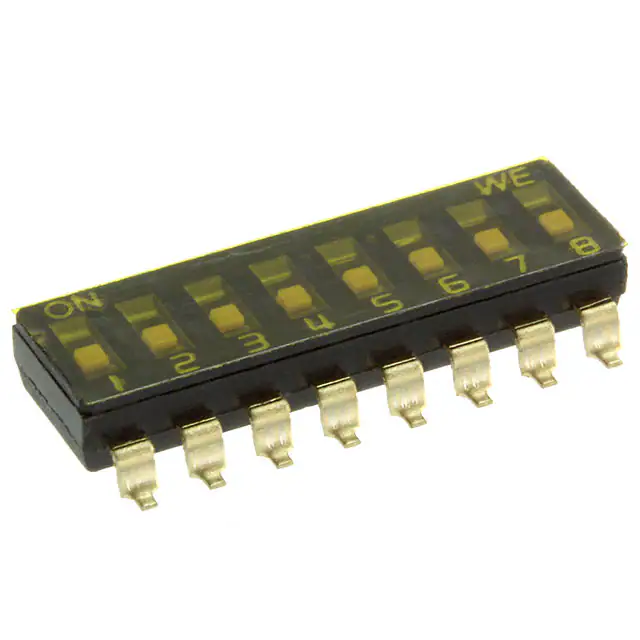

    WURTH(伍尔特)
    SMD,P=2.54mm
    开关 滑动 插件 单刀单掷 25mA 24V
418121160808 数据手册
6,6 11,0 8,6 ±0,1 2,54 9,8 ± 0,3 Land Pattern 0,5 x0,25 2,54 MATERIAL >Cover : >Base : >Actuator : >Tape: >Contact : >Terminal : 1,1 Wiring Diagram PA9T UL 94 V-0, color Black PA9T UL 94 V-0, color Black PA46 UL 94 V-0, color White Polyimide Film Gold Plated Gold Plated SOLDERING INFORMATION >Terminal in SMD version >Reflow soldering according to JEDEC J-STD-020D Hot Air, 3 cycles max. >Keep in “off” position during soldering >For cleaning or washing only with top tape sealed >VPH Heating Process only with top tape sealed 0,8 ±0,2 3,0 7,62 0,7 L SPECIFICATION >Contact Rating Switching : 25mA, 24VDC Non-Switching : 100mA, 50VDC >Contact Resistance Initial: 50mΩ max. After life test : 100mΩ max. >Insulation Resistance : min. 100MΩ at 500VDC >Dielectric Strength : 500VAC for 1 minute >Operation Force : 600g max. >Mechanical Life : 2000 cycles >Electrical Life : 2000 cycles / 25mA, 24VDC >Flat Actuator with top tape sealed WASHABLE DEFINITION Please do not submerse washable products into water or cleaning agents or put them in locations exposed to water or liquids completely. When cleaning by hand (brushing), please do not use excessive force on our switch to avoid malfunction afterwards, because you could deform function relevant areas or you could damage sealing functions. Do not clean washable series immediately after soldering. The cleaning agent may be absorbed into the switch through respiration while the switch cools. 6,2 ± 0,1 1,8 h 0,1 ref. ENVIRONMENTAL Storage condition : Operation condition : Compliance : -40°C ~ +85°C -40°C ~ +85°C Lead Free , ROHS , Reach PACKAGING INFORMATION >Tape & Reel >On delivery in “off” position Pole 1 please refer separateness specification. Scale - 2:1 DIMENSION No. of Poles Dim. L (mm) No. of Poles Dim. L (mm) Würth Elektronik eiSos GmbH & Co. KG EMC & Inductive Solutions Max-Eyth-Str. 1 74638 Waldenburg Germany com. +49 79 42 945 - 0 REV. FILE DATE BY www.we-online.de eiSos@we-online.de 2 6.02 7 18.72 3 8.56 8 21.26 4 11.10 9 23.80 5 13.64 10 26.34 CREATED CHECKED GENERAL TOLERANCE WJ Hsu DIN ISO 2768-1m DESCRIPTION 6 16.18 12 31.42 PROJECTION METHOD SCALE 2:1 TECHNICAL REFERENCE _________ WS-DISV Flat actuator with top tape sealed ORDER CODE SIZE STATUS DATE IC type, SMD Released 2017-04-06 4181211608xx BUSINESS UNIT eiCan PAGE 1 /1 This electronic component has been designed and developed for usage in general electronic equipment only. This product is not authorized for use in equipment where a higher safety standard and reliability standard is especially required or where a failure of the product is reasonably expected to cause severe personal injury or death, unless the parties have executed an agreement specifically governing such use. Moreover Würth Elektronik eiSos GmbH & Co KG products are neither designed nor intended for use in areas such as military, aerospace, aviation, nuclear control, submarine, transportation (automotive control, train control, ship control), transportation signal, disaster prevention, medical, public information network etc.. Würth Elektronik eiSos GmbH & Co KG must be informed about the intent of such usage before the design-in stage. In addition, sufficient reliability evaluation checks for safety must be performed on every electronic component which is used in electrical circuits that require high safety and reliability functions or performance.
