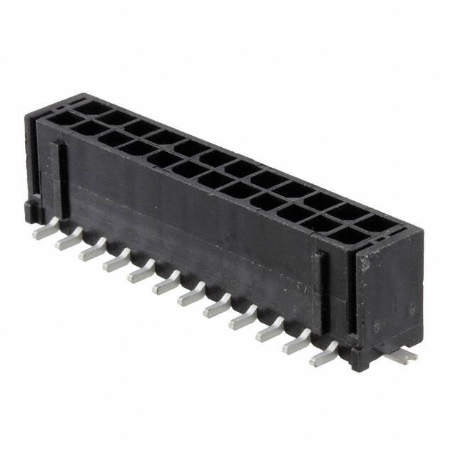

    CONN HEADER SMD 24POS 3MM
662024231822 数据手册
1 2 3 4 5 TECHNICAL CHARACTERISTICS MATERIAL INSULATOR: LCP FLAMABILITY RATING: UL94-V0 COLOR: BLACK CONTACT MATERIAL: COPPER ALLOY CONTACT TYPE: STAMPED CONTACT PLATING: TIN QUALITY CLASS: 25 MATING CYCLES PITCH: 3.00MM A ENVIRONMENTAL OPERATING TEMPERATURE: -40 UP TO 105°C COMPLIANCE: LEAD FREE AND ROHS ELECTRICAL CURRENT RATING:5A WORKING VOLTAGE: 250V AC INSULATOR RESISTANCE: >1000 MOHM DIELECTRIC WITHSTANDING VOLTAGE: 1500V AC/MN CONTACT RESISTANCE: 10 mOHM MAX B STANDARD CERTIFIED: E323964 SOLDERING JEDEC LEAD FREE REFLOW SOLDERING PROCESS PACKAGING TRAY LAST CKT. DIMENSION A = 3.00 x (NB. PIN / 2 - 1) B = 3.00 x (NB. PIN / 2 + 1) + 0.70 C CKT.#1 CKT.#2 RoHS Compliant PROJECTION: GENERAL TOLERANCE N 07-MAR-16 COPLANARITY AK M 02-JUL-15 PINNING AK L 29-JUL-13 DWG & CARAC QL K J 21-JAN-13 06-JUL-12 DIM A & B MOD PLASTIC QL GG I 22-FEB-12 DESCRIPTION GG SCALE: DESCRIPTION: 3.00MM MALE DUAL ROW SMT VERTICAL HEADER WITH SMT SOLDER TAB H 29-AUG-11 PACKAGING JP SHEET: 1/3 WERI PART NO: 662 0xx 231 822 REV DATE FILE BY DRAW: PEARL .X = +/- 0.2 .XX = +/- 0.15 APPROVAL: BBu UNIT: MM SIZE A4 D 1 2 3 4 5 A B C RoHS Compliant PROJECTION: G F GENERAL TOLERANCE .X = +/- 0.2 .XX = +/- 0.15 E D C APPROVAL: BBu B A REV DATE FILE BY UNIT: MM SCALE: DESCRIPTION: 3.00MM MALE DUAL ROW SMT VERTICAL HEADER WITH SMT SOLDER TAB SHEET: 2/3 WERI PART NO 662 0xx 231 22_TPK DRAW: PEARL SIZE A4 D 1 2 3 4 5 Cautions and Warnings: This electronic component is designed and developed with the intention for use in general electronics equipments. Before incorporating the components into any equipments in the field such as aerospace, aviation, nuclear control, submarine, transportation, (automotive control, train control, ship control), transportation signal, disaster prevention, medical, public information network etc. where higher safety and reliability are especially required or if there is possibility of direct damage or injury to human body, Wurth Elektronik must be asked for a written approval. In addition, even electronic component in general electronic equipments, when used in electrical circuits that require high safety, reliability functions or performance, the sufficient reliability evaluation-check for the safety must be performed before by the user before usage. A B C RoHS Compliant PROJECTION: G F GENERAL TOLERANCE .X = +/- 0.2 .XX = +/- 0.15 E D C APPROVAL: JC B UNIT: MM DESCRIPTION: DISCLAIMER SIZE WERI PART NO: DISCLAIMER A4 SCALE: A 10-SEP-14 PDF QL SHEET: 3/3 REV DATE FILE BY DRAW: QL D
