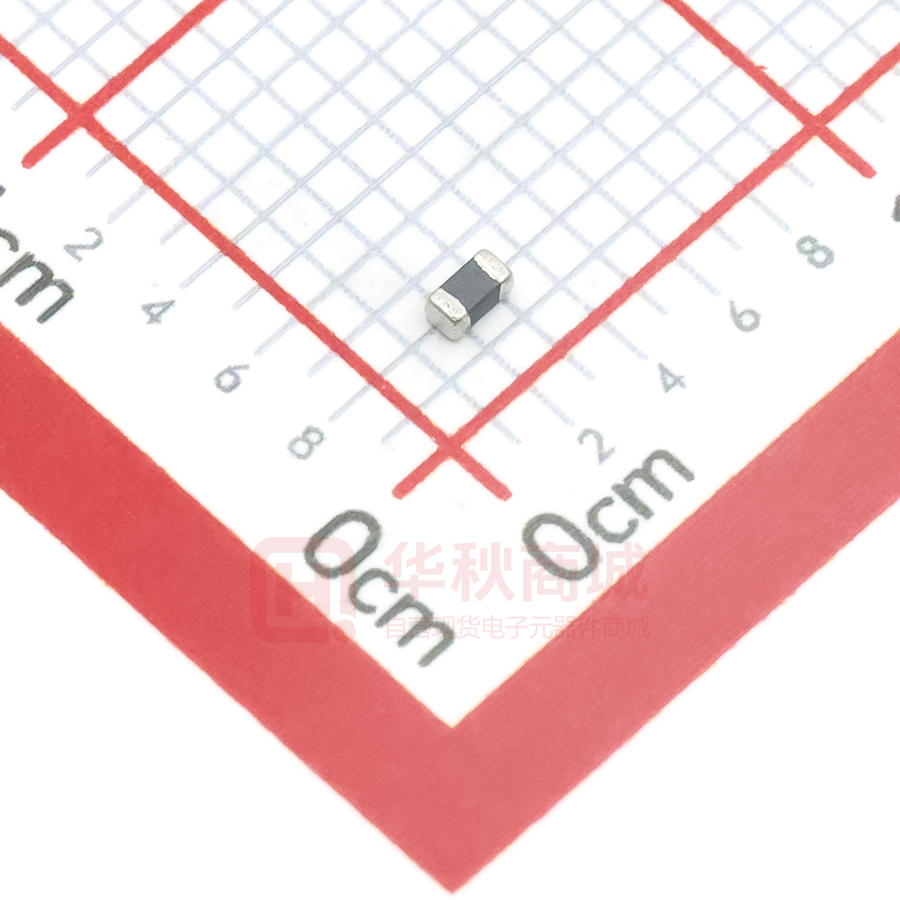

Dimensions: [mm] Recommended Land Pattern: [mm] Electrical Properties: Properties Test conditions Value Unit Tol. 100 MHz 110 Ω ±25% Zmax 226 MHz 135 Ω typ. Rated Current 2 IR 2 ΔT = 40 K 4100 mA max. DC Resistance RDC @ 20 °C 20 mΩ max. DC Resistance RDC @ 20 °C 14.5 mΩ typ. Impedance @ 100 MHz W Z Maximum Impedance 0,7 0,7 0,3 ±0,2 Type High Current Certification: WIDE BAND / HIGH SPEED: W = 2,2 HIGH CURRENT: W = 2,6 0,8±0,2 1,6±0,2 Scale - 20:1 RoHS Approval Compliant [2011/65/EU&2015/863] REACh Approval Conform or declared [(EC)1907/2006] Halogen Free Conform [JEDEC JS709B] Halogen Free Conform [IEC 61249-2-21] Component Qualification AEC-Q200 Grade 1 Schematic: General Information: 0,8±0,2 Do not use this part constantly beyond the Rated Current, as this will create excessive heat and can harm the component Operating Temperature -55 up to +125 °C Storage Conditions (in original packaging) < 40 °C ; < 75 % RH Moisture Sensitivity Level (MSL) 1 Test conditions of Electrical Properties: +20 °C, 33 % RH if not specified differently Scale - 20:1 CHECKED REVISION DATE (YYYY-MM-DD) GENERAL TOLERANCE MHB 001.003 2021-01-18 DIN ISO 2768-1m PROJECTION METHOD DESCRIPTION Würth Elektronik eiSos GmbH & Co. KG EMC & Inductive Solutions Max-Eyth-Str. 1 74638 Waldenburg Germany Tel. +49 (0) 79 42 945 - 0 www.we-online.com eiSos@we-online.com WE-MPSB EMI Multilayer Power Suppression Bead ORDER CODE 74279228111 SIZE/TYPE BUSINESS UNIT STATUS PAGE 0603 eiSos Valid 1/10 This electronic component has been designed and developed for usage in general electronic equipment only. This product is not authorized for use in equipment where a higher safety standard and reliability standard is especially required or where a failure of the product is reasonably expected to cause severe personal injury or death, unless the parties have executed an agreement specifically governing such use. Moreover Würth Elektronik eiSos GmbH & Co KG products are neither designed nor intended for use in areas such as military, aerospace, aviation, nuclear control, submarine, transportation (automotive control, train control, ship control), transportation signal, disaster prevention, medical, public information network etc.. Würth Elektronik eiSos GmbH & Co KG must be informed about the intent of such usage before the design-in stage. In addition, sufficient reliability evaluation checks for safety must be performed on every electronic component which is used in electrical circuits that require high safety and reliability functions or performance. Typical Impedance Characteristics: DC bias current: 1000 100 100 Impedance [Ω] Impedance [Ω] 1000 10 1 10 1 10 100 1000 1 1 10 Frequency [MHz] Z XL 100 1000 Frequency [MHz] R Z @ 1A Z @ 2A Z @ 3A CHECKED REVISION DATE (YYYY-MM-DD) GENERAL TOLERANCE MHB 001.003 2021-01-18 DIN ISO 2768-1m Z @ 4A PROJECTION METHOD DESCRIPTION Würth Elektronik eiSos GmbH & Co. KG EMC & Inductive Solutions Max-Eyth-Str. 1 74638 Waldenburg Germany Tel. +49 (0) 79 42 945 - 0 www.we-online.com eiSos@we-online.com WE-MPSB EMI Multilayer Power Suppression Bead ORDER CODE 74279228111 SIZE/TYPE BUSINESS UNIT STATUS PAGE 0603 eiSos Valid 2/10 This electronic component has been designed and developed for usage in general electronic equipment only. This product is not authorized for use in equipment where a higher safety standard and reliability standard is especially required or where a failure of the product is reasonably expected to cause severe personal injury or death, unless the parties have executed an agreement specifically governing such use. Moreover Würth Elektronik eiSos GmbH & Co KG products are neither designed nor intended for use in areas such as military, aerospace, aviation, nuclear control, submarine, transportation (automotive control, train control, ship control), transportation signal, disaster prevention, medical, public information network etc.. Würth Elektronik eiSos GmbH & Co KG must be informed about the intent of such usage before the design-in stage. In addition, sufficient reliability evaluation checks for safety must be performed on every electronic component which is used in electrical circuits that require high safety and reliability functions or performance. Typical Peak Current vs. Pulse Length Characteristics: Typical Number of Pulse Repetition: 50 100.000 45 40 10.000 30 Typical Number of Pulse repetition Current [A] 35 25 20 15 10 1.000 100 10 5 0 1 0.5 1.0 1.5 2.0 2.5 3.0 3.5 4.0 4.5 5.0 5.5 6.0 6.5 7.0 7.5 8.0 Pulse Length [ms] valid for ambient temperature: +25°C; 8 ms pulse length, single pulse 0 10 20 30 40 50 Current [A] 60 70 80 valid for ambient temperature: +25°C; 8 ms pulse length, 10 s break between pulse CHECKED REVISION DATE (YYYY-MM-DD) GENERAL TOLERANCE MHB 001.003 2021-01-18 DIN ISO 2768-1m PROJECTION METHOD DESCRIPTION Würth Elektronik eiSos GmbH & Co. KG EMC & Inductive Solutions Max-Eyth-Str. 1 74638 Waldenburg Germany Tel. +49 (0) 79 42 945 - 0 www.we-online.com eiSos@we-online.com WE-MPSB EMI Multilayer Power Suppression Bead ORDER CODE 74279228111 SIZE/TYPE BUSINESS UNIT STATUS PAGE 0603 eiSos Valid 3/10 This electronic component has been designed and developed for usage in general electronic equipment only. This product is not authorized for use in equipment where a higher safety standard and reliability standard is especially required or where a failure of the product is reasonably expected to cause severe personal injury or death, unless the parties have executed an agreement specifically governing such use. Moreover Würth Elektronik eiSos GmbH & Co KG products are neither designed nor intended for use in areas such as military, aerospace, aviation, nuclear control, submarine, transportation (automotive control, train control, ship control), transportation signal, disaster prevention, medical, public information network etc.. Würth Elektronik eiSos GmbH & Co KG must be informed about the intent of such usage before the design-in stage. In addition, sufficient reliability evaluation checks for safety must be performed on every electronic component which is used in electrical circuits that require high safety and reliability functions or performance. Derating Curve: 120% 100% Current [A] 80% 60% 40% 20% 0% 0 20 40 60 80 100 120 140 160 Temperature [°C] valid for ambient temperature: -55°C to +85°C CHECKED REVISION DATE (YYYY-MM-DD) GENERAL TOLERANCE MHB 001.003 2021-01-18 DIN ISO 2768-1m PROJECTION METHOD DESCRIPTION Würth Elektronik eiSos GmbH & Co. KG EMC & Inductive Solutions Max-Eyth-Str. 1 74638 Waldenburg Germany Tel. +49 (0) 79 42 945 - 0 www.we-online.com eiSos@we-online.com WE-MPSB EMI Multilayer Power Suppression Bead ORDER CODE 74279228111 SIZE/TYPE BUSINESS UNIT STATUS PAGE 0603 eiSos Valid 4/10 This electronic component has been designed and developed for usage in general electronic equipment only. This product is not authorized for use in equipment where a higher safety standard and reliability standard is especially required or where a failure of the product is reasonably expected to cause severe personal injury or death, unless the parties have executed an agreement specifically governing such use. Moreover Würth Elektronik eiSos GmbH & Co KG products are neither designed nor intended for use in areas such as military, aerospace, aviation, nuclear control, submarine, transportation (automotive control, train control, ship control), transportation signal, disaster prevention, medical, public information network etc.. Würth Elektronik eiSos GmbH & Co KG must be informed about the intent of such usage before the design-in stage. In addition, sufficient reliability evaluation checks for safety must be performed on every electronic component which is used in electrical circuits that require high safety and reliability functions or performance. Packaging Specification - Tape: [mm] Packaging Specification - Reel: [mm] P0 A D0 T (=K0) W3 E1 P2 D A A0 N B0 E2 C Top Cover Tape T1 A P1 W2 T1 Feeding direction End W1 close to center W F B Carrier Tape Start Cover Tape detail B B Top Cover Tape Chip Cavity Sprocket Hole No Component min. 160mm Components No Component min.100mm Embossment Bottom Cover Tape Cover Tape min. 400mm Packaging is referred to the international standard IEC 60286-3:2019 Tape Type Tolerance Value 1a A0 (mm) typ. 1,10 B0 (mm) typ. 1,88 W (mm) +0,3/ -0,1 8,00 T (mm) ref. 1,10 T1 (mm) ref. 0,10 P0 (mm) ±0,1 4,00 P1 (mm) ±0,1 4,00 P2 (mm) +0,05 2,00 D0 (mm) +0,1 / -0,0 1,50 E1 (mm) ±0,1 1,75 E2 (mm) min. 6,25 F (mm) ±0,05 3,50 Material Qty. (pcs.) Paper 4000 165° - 180° Tolerance Value A (mm) ± 2,0 178 B (mm) min. 1.5 C (mm) min. 12.8 D (mm) min. 20.2 N (mm) min. 50 W1 (mm) +1,5 8.4 W2 (mm) max. 14.4 CHECKED REVISION DATE (YYYY-MM-DD) GENERAL TOLERANCE MHB 001.003 2021-01-18 DIN ISO 2768-1m W3 (mm) min. 7.9 W3 (mm) max. 10.9 Material Polystyrene PROJECTION METHOD DESCRIPTION Pull-of force Tape width 8 mm 0,1 N - 1,0 N Würth Elektronik eiSos GmbH & Co. KG EMC & Inductive Solutions Max-Eyth-Str. 1 74638 Waldenburg Germany Tel. +49 (0) 79 42 945 - 0 www.we-online.com eiSos@we-online.com WE-MPSB EMI Multilayer Power Suppression Bead ORDER CODE 74279228111 SIZE/TYPE BUSINESS UNIT STATUS PAGE 0603 eiSos Valid 5/10 This electronic component has been designed and developed for usage in general electronic equipment only. This product is not authorized for use in equipment where a higher safety standard and reliability standard is especially required or where a failure of the product is reasonably expected to cause severe personal injury or death, unless the parties have executed an agreement specifically governing such use. Moreover Würth Elektronik eiSos GmbH & Co KG products are neither designed nor intended for use in areas such as military, aerospace, aviation, nuclear control, submarine, transportation (automotive control, train control, ship control), transportation signal, disaster prevention, medical, public information network etc.. Würth Elektronik eiSos GmbH & Co KG must be informed about the intent of such usage before the design-in stage. In addition, sufficient reliability evaluation checks for safety must be performed on every electronic component which is used in electrical circuits that require high safety and reliability functions or performance. Packaging Specification - Inner Carton: [mm] H IC H MC Packaging Specification - Reel in Carton: [mm] L MC W MC L IC W IC Tolerance Value LIC (mm) typ. 185,00 WIC (mm) typ. 91,00 HIC (mm) typ. 188,00 No. of Reel (pcs.) 5 Qty. (pcs.) 20000 Material Paper Tolerance Value LMC (mm) typ. 485,00 WMC (mm) typ. 197,00 HMC (mm) typ. 200,00 No. of Inner Carton (pcs.) Qty. (pcs.) Material 5 100000 Paper CHECKED REVISION DATE (YYYY-MM-DD) GENERAL TOLERANCE MHB 001.003 2021-01-18 DIN ISO 2768-1m PROJECTION METHOD DESCRIPTION Würth Elektronik eiSos GmbH & Co. KG EMC & Inductive Solutions Max-Eyth-Str. 1 74638 Waldenburg Germany Tel. +49 (0) 79 42 945 - 0 www.we-online.com eiSos@we-online.com WE-MPSB EMI Multilayer Power Suppression Bead ORDER CODE 74279228111 SIZE/TYPE BUSINESS UNIT STATUS PAGE 0603 eiSos Valid 6/10 This electronic component has been designed and developed for usage in general electronic equipment only. This product is not authorized for use in equipment where a higher safety standard and reliability standard is especially required or where a failure of the product is reasonably expected to cause severe personal injury or death, unless the parties have executed an agreement specifically governing such use. Moreover Würth Elektronik eiSos GmbH & Co KG products are neither designed nor intended for use in areas such as military, aerospace, aviation, nuclear control, submarine, transportation (automotive control, train control, ship control), transportation signal, disaster prevention, medical, public information network etc.. Würth Elektronik eiSos GmbH & Co KG must be informed about the intent of such usage before the design-in stage. In addition, sufficient reliability evaluation checks for safety must be performed on every electronic component which is used in electrical circuits that require high safety and reliability functions or performance. H C Packaging Specification - Outer Carton: [mm] L W C C Tolerance Value LC (mm) typ. 500,00 WC (mm) typ. 412,00 HC (mm) typ. 224,00 No. of Medium Carton (pcs.) Qty. (pcs.) Material 2 200000 Paper CHECKED REVISION DATE (YYYY-MM-DD) GENERAL TOLERANCE MHB 001.003 2021-01-18 DIN ISO 2768-1m PROJECTION METHOD DESCRIPTION Würth Elektronik eiSos GmbH & Co. KG EMC & Inductive Solutions Max-Eyth-Str. 1 74638 Waldenburg Germany Tel. +49 (0) 79 42 945 - 0 www.we-online.com eiSos@we-online.com WE-MPSB EMI Multilayer Power Suppression Bead ORDER CODE 74279228111 SIZE/TYPE BUSINESS UNIT STATUS PAGE 0603 eiSos Valid 7/10 This electronic component has been designed and developed for usage in general electronic equipment only. This product is not authorized for use in equipment where a higher safety standard and reliability standard is especially required or where a failure of the product is reasonably expected to cause severe personal injury or death, unless the parties have executed an agreement specifically governing such use. Moreover Würth Elektronik eiSos GmbH & Co KG products are neither designed nor intended for use in areas such as military, aerospace, aviation, nuclear control, submarine, transportation (automotive control, train control, ship control), transportation signal, disaster prevention, medical, public information network etc.. Würth Elektronik eiSos GmbH & Co KG must be informed about the intent of such usage before the design-in stage. In addition, sufficient reliability evaluation checks for safety must be performed on every electronic component which is used in electrical circuits that require high safety and reliability functions or performance. Classification Reflow Profile for SMT components: Classification Reflow Soldering Profile: Profile Feature Tp tp Max. Ramp Up Rate Max. Ramp Down Rate TL Temperature Ts max Ts min Ts min 150 °C Preheat Temperature Max Ts max 200 °C Preheat Time ts from Ts min to Ts max ts Ramp-up Rate (TL to TP) Liquidous Temperature tL Preheat Area TC –5°C Value Preheat Temperature Min 60 - 120 seconds 3 °C/ second max. TL 217 °C Time tL maintained above TL tL 60 - 150 seconds Peak package body temperature Tp Tp ≤ Tc, see Table below Time within 5°C of actual peak temperature tp 20 - 30 seconds Ramp-down Rate (TP to TL) 6 °C/ second max. Time 25°C to peak temperature 8 minutes max. refer to IPC/ JEDEC J-STD-020E tS Package Classification Reflow Temperature (Tc): Volume mm³ 350-2000 Volume mm³ >2000 PB-Free Assembly | Package Thickness 260 °C < 1.6 mm 260 °C 260 °C PB-Free Assembly | Package Thickness 260 °C 1.6 mm - 2.5 mm 250 °C 245 °C PB-Free Assembly | Package Thickness 250 °C > 2.5 mm 245 °C 245 °C Properties 25 Time 25°C to Peak Time Volume mm³
