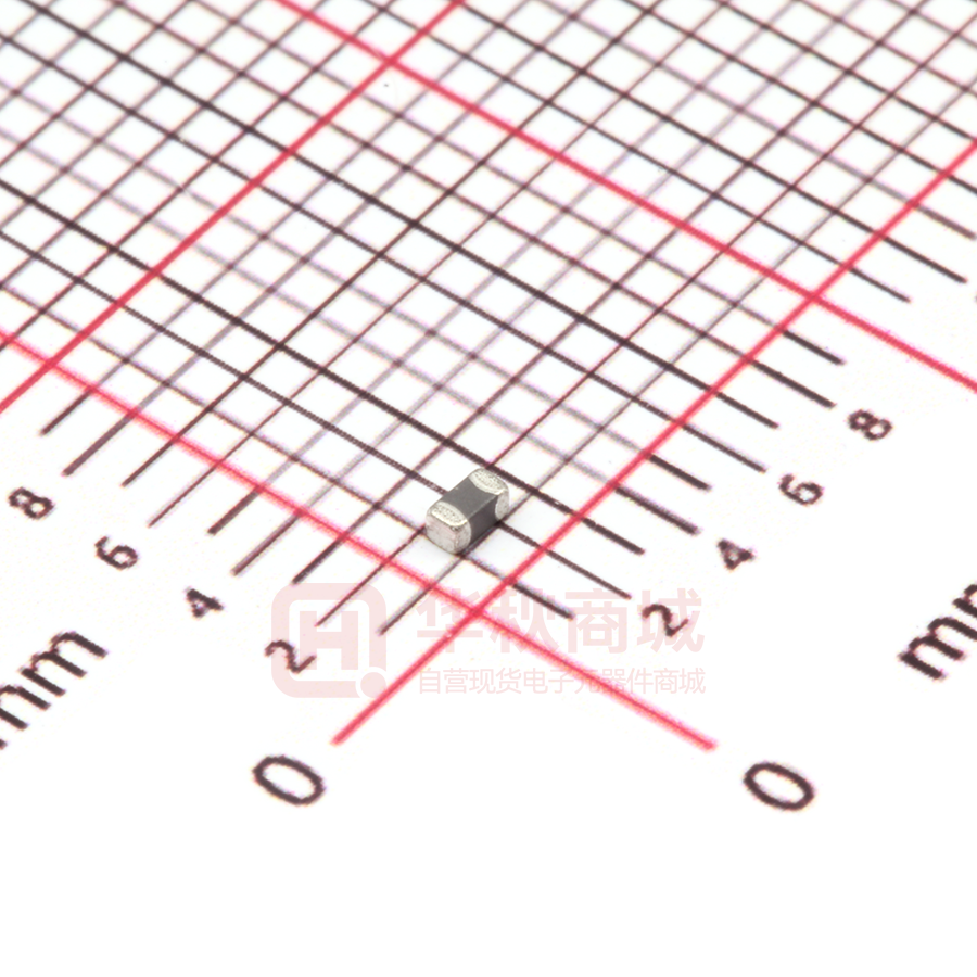

    WURTH(伍尔特)
    0603
    贴片磁珠 30Ω@100MHz ±25% 0603 30mΩ 1A
742792601 数据手册
Dimensions: [mm] Recommended Land Pattern: [mm] Electrical Properties: Properties Test conditions Value Unit Tol. 30 Ω ±25% 65 Ω typ. ΔT = 20 K 800 mA max. ΔT = 40 K 1000 mA max. @ 20 °C 0.03 Ω max. Impedance @ 100 MHz 0,7 Maximum Impedance Zmax 1000 MHz Rated Current 1 IR 1 Rated Current 2 IR 2 DC Resistance RDC 0,7 W 0,3 ±0,2 Z 100 MHz Type WIDE BAND / HIGH SPEED: W = 2,2 HIGH CURRENT: W = 2,6 0,8±0,2 1,6±0,2 Scale - 20:1 High Current Certification: RoHS Approval Compliant [2011/65/EU&2015/863] REACh Approval Conform or declared [(EC)1907/2006] Halogen Free Conform [JEDEC JS709B] Halogen Free Conform [IEC 61249-2-21] Component Qualification AEC-Q200 Grade 1 Schematic: General Information: 0,8±0,2 Do not use this part beyond the Rated Current as this will create excessive heat and can harm the component Operating Temperature -55 up to +125 °C Storage Conditions (in original packaging) < 40 °C ; < 75 % RH Moisture Sensitivity Level (MSL) 1 Test conditions of Electrical Properties: +20 °C, 33 % RH if not specified differently Scale - 20:1 CHECKED REVISION DATE (YYYY-MM-DD) GENERAL TOLERANCE MBH 005.010 2020-10-01 DIN ISO 2768-1m PROJECTION METHOD DESCRIPTION Würth Elektronik eiSos GmbH & Co. KG EMC & Inductive Solutions Max-Eyth-Str. 1 74638 Waldenburg Germany Tel. +49 (0) 79 42 945 - 0 www.we-online.com eiSos@we-online.com WE-CBF SMT EMI Suppression Ferrite Bead ORDER CODE 742792601 SIZE/TYPE BUSINESS UNIT STATUS PAGE 0603 eiSos Valid 1/7 This electronic component has been designed and developed for usage in general electronic equipment only. This product is not authorized for use in equipment where a higher safety standard and reliability standard is especially required or where a failure of the product is reasonably expected to cause severe personal injury or death, unless the parties have executed an agreement specifically governing such use. Moreover Würth Elektronik eiSos GmbH & Co KG products are neither designed nor intended for use in areas such as military, aerospace, aviation, nuclear control, submarine, transportation (automotive control, train control, ship control), transportation signal, disaster prevention, medical, public information network etc.. Würth Elektronik eiSos GmbH & Co KG must be informed about the intent of such usage before the design-in stage. In addition, sufficient reliability evaluation checks for safety must be performed on every electronic component which is used in electrical circuits that require high safety and reliability functions or performance. Typical Impedance Characteristics: Derating Curve: 100 120% 100% Current [A] Impedance [Ω] 80% 10 60% 40% 20% 1 1 10 100 1000 0 Frequency [MHz] Z XL 0% 20 40 60 80 100 120 140 160 Temperature [°C] R Test Equipment: E4991A or equivalent CHECKED REVISION DATE (YYYY-MM-DD) GENERAL TOLERANCE MBH 005.010 2020-10-01 DIN ISO 2768-1m PROJECTION METHOD DESCRIPTION Würth Elektronik eiSos GmbH & Co. KG EMC & Inductive Solutions Max-Eyth-Str. 1 74638 Waldenburg Germany Tel. +49 (0) 79 42 945 - 0 www.we-online.com eiSos@we-online.com WE-CBF SMT EMI Suppression Ferrite Bead ORDER CODE 742792601 SIZE/TYPE BUSINESS UNIT STATUS PAGE 0603 eiSos Valid 2/7 This electronic component has been designed and developed for usage in general electronic equipment only. This product is not authorized for use in equipment where a higher safety standard and reliability standard is especially required or where a failure of the product is reasonably expected to cause severe personal injury or death, unless the parties have executed an agreement specifically governing such use. Moreover Würth Elektronik eiSos GmbH & Co KG products are neither designed nor intended for use in areas such as military, aerospace, aviation, nuclear control, submarine, transportation (automotive control, train control, ship control), transportation signal, disaster prevention, medical, public information network etc.. Würth Elektronik eiSos GmbH & Co KG must be informed about the intent of such usage before the design-in stage. In addition, sufficient reliability evaluation checks for safety must be performed on every electronic component which is used in electrical circuits that require high safety and reliability functions or performance. Packaging Specification - Tape: [mm] Packaging Specification - Reel: [mm] P0 A D0 T (=K0) W3 E1 P2 D A A0 N B0 E2 C Top Cover Tape T1 A P1 W2 T1 Feeding direction End W1 close to center W F B Carrier Tape Start Cover Tape detail B B Top Cover Tape Chip Cavity Sprocket Hole No Component min. 160mm Components No Component min.100mm Embossment Bottom Cover Tape Cover Tape min. 400mm Packaging is referred to the international standard IEC 60286-3:2019 Tape Type 1a A0 (mm) typ. 1,10 B0 (mm) typ. 1,88 W (mm) +0,3/ -0,1 8,00 T (mm) ref. 1,10 T1 (mm) ref. 0,10 P0 (mm) ±0,1 4,00 P1 (mm) ±0,1 4,00 P2 (mm) +0,05 2,00 D0 (mm) +0,1 / -0,0 1,50 E1 (mm) ±0,1 1,75 E2 (mm) min. 6,25 F (mm) ±0,05 3,50 Material Qty. (pcs.) Paper 4000 A (mm) ± 2,0 178 B (mm) min. 1.5 C (mm) min. 12.8 D (mm) min. 20.2 N (mm) min. 50 W1 (mm) +1,5 8.4 W2 (mm) max. 14.4 CHECKED REVISION DATE (YYYY-MM-DD) GENERAL TOLERANCE MBH 005.010 2020-10-01 DIN ISO 2768-1m W3 (mm) min. 7.9 W3 (mm) max. 10.9 Material Polystyrene PROJECTION METHOD 165° - 180° DESCRIPTION Pull-of force Tape width 8 mm 0,1 N - 1,0 N Würth Elektronik eiSos GmbH & Co. KG EMC & Inductive Solutions Max-Eyth-Str. 1 74638 Waldenburg Germany Tel. +49 (0) 79 42 945 - 0 www.we-online.com eiSos@we-online.com WE-CBF SMT EMI Suppression Ferrite Bead ORDER CODE 742792601 SIZE/TYPE BUSINESS UNIT STATUS PAGE 0603 eiSos Valid 3/7 This electronic component has been designed and developed for usage in general electronic equipment only. This product is not authorized for use in equipment where a higher safety standard and reliability standard is especially required or where a failure of the product is reasonably expected to cause severe personal injury or death, unless the parties have executed an agreement specifically governing such use. Moreover Würth Elektronik eiSos GmbH & Co KG products are neither designed nor intended for use in areas such as military, aerospace, aviation, nuclear control, submarine, transportation (automotive control, train control, ship control), transportation signal, disaster prevention, medical, public information network etc.. Würth Elektronik eiSos GmbH & Co KG must be informed about the intent of such usage before the design-in stage. In addition, sufficient reliability evaluation checks for safety must be performed on every electronic component which is used in electrical circuits that require high safety and reliability functions or performance. Packaging Specification - Outer Carton: [mm] H C H IC Packaging Specification - Inner Carton: [mm] W L IC Tolerance Value LIC (mm) typ. 185,00 WIC (mm) typ. 185,00 HIC (mm) typ. 80,00 No. of Reel (pcs.) 5 W IC Qty. (pcs.) 20000 L C Material Paper Tolerance Value LC (mm) typ. 445,00 WC (mm) typ. 395,00 HC (mm) typ. 210,00 C No. of Inner Carton (pcs.) Qty. (pcs.) Material 10 200000 Paper CHECKED REVISION DATE (YYYY-MM-DD) GENERAL TOLERANCE MBH 005.010 2020-10-01 DIN ISO 2768-1m PROJECTION METHOD DESCRIPTION Würth Elektronik eiSos GmbH & Co. KG EMC & Inductive Solutions Max-Eyth-Str. 1 74638 Waldenburg Germany Tel. +49 (0) 79 42 945 - 0 www.we-online.com eiSos@we-online.com WE-CBF SMT EMI Suppression Ferrite Bead ORDER CODE 742792601 SIZE/TYPE BUSINESS UNIT STATUS PAGE 0603 eiSos Valid 4/7 This electronic component has been designed and developed for usage in general electronic equipment only. This product is not authorized for use in equipment where a higher safety standard and reliability standard is especially required or where a failure of the product is reasonably expected to cause severe personal injury or death, unless the parties have executed an agreement specifically governing such use. Moreover Würth Elektronik eiSos GmbH & Co KG products are neither designed nor intended for use in areas such as military, aerospace, aviation, nuclear control, submarine, transportation (automotive control, train control, ship control), transportation signal, disaster prevention, medical, public information network etc.. Würth Elektronik eiSos GmbH & Co KG must be informed about the intent of such usage before the design-in stage. In addition, sufficient reliability evaluation checks for safety must be performed on every electronic component which is used in electrical circuits that require high safety and reliability functions or performance. Classification Reflow Profile for SMT components: Classification Reflow Soldering Profile: Profile Feature Tp tp Max. Ramp Up Rate Max. Ramp Down Rate TL Temperature Ts max tL Preheat Area Ts min TC –5°C Value Preheat Temperature Min Ts min 150 °C Preheat Temperature Max Ts max 200 °C Preheat Time ts from Ts min to Ts max ts Ramp-up Rate (TL to TP) 60 - 120 seconds 3 °C/ second max. Liquidous Temperature TL 217 °C Time tL maintained above TL tL 60 - 150 seconds Peak package body temperature Tp Tp ≤ Tc, see Table below Time within 5°C of actual peak temperature tp 20 - 30 seconds Ramp-down Rate (TP to TL) 6 °C/ second max. Time 25°C to peak temperature 8 minutes max. refer to IPC/ JEDEC J-STD-020E tS Package Classification Reflow Temperature (Tc): Volume mm³ 350-2000 Volume mm³ >2000 PB-Free Assembly | Package Thickness 260 °C < 1.6 mm 260 °C 260 °C PB-Free Assembly | Package Thickness 260 °C 1.6 mm - 2.5 mm 250 °C 245 °C PB-Free Assembly | Package Thickness 250 °C > 2.5 mm 245 °C 245 °C Properties 25 Time 25°C to Peak Time Volume mm³
