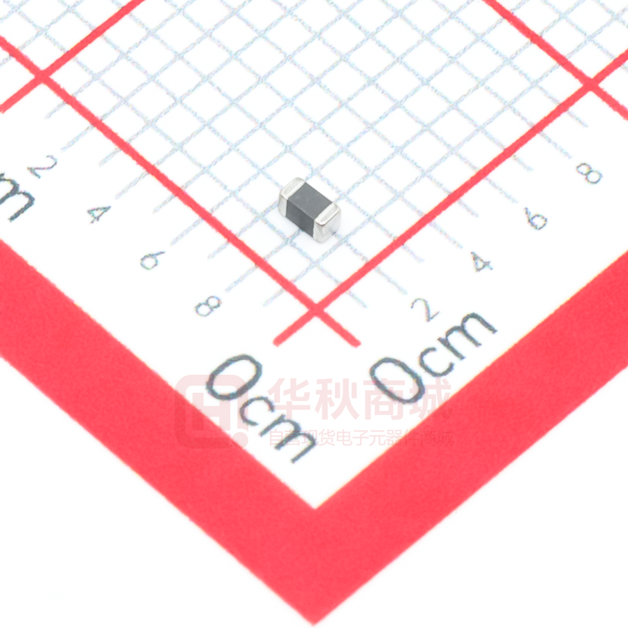

Dimensions: [mm] Recommended Land Pattern: [mm] Electrical Properties: Properties Test conditions Value Unit Tol. 100 MHz 1000 Ω ±25% Maximum Impedance Zmax 120 MHz 1100 Ω typ. Rated Current 1 IR 1 ΔT = 20 K 300 mA max. Rated Current 2 IR 2 ΔT = 40 K 680 mA max. DC Resistance RDC @ 20 °C 0.6 Ω max. Impedance @ 100 MHz 0,7 0,7 W 0,3 ±0,2 Z Type WIDE BAND / HIGH SPEED: W = 2,2 HIGH CURRENT: W = 2,6 0,8±0,2 1,6±0,2 Scale - 20:1 High Speed Certification: RoHS Approval Compliant [2011/65/EU&2015/863] REACh Approval Conform or declared [(EC)1907/2006] Halogen Free Conform [JEDEC JS709B] Halogen Free Conform [IEC 61249-2-21] Component Qualification AEC-Q200 Grade 1 Schematic: General Information: 0,8±0,2 Do not use this part beyond the Rated Current as this will create excessive heat and can harm the component Operating Temperature -55 up to +125 °C Storage Conditions (in original packaging) < 40 °C ; < 75 % RH Moisture Sensitivity Level (MSL) 1 Test conditions of Electrical Properties: +20 °C, 33 % RH if not specified differently Scale - 20:1 CHECKED REVISION DATE (YYYY-MM-DD) GENERAL TOLERANCE MBH 005.000 2020-10-01 DIN ISO 2768-1m PROJECTION METHOD DESCRIPTION Würth Elektronik eiSos GmbH & Co. KG EMC & Inductive Solutions Max-Eyth-Str. 1 74638 Waldenburg Germany Tel. +49 (0) 79 42 945 - 0 www.we-online.com eiSos@we-online.com WE-CBF SMT EMI Suppression Ferrite Bead ORDER CODE 742792664 SIZE/TYPE BUSINESS UNIT STATUS PAGE 0603 eiSos Valid 1/7 This electronic component has been designed and developed for usage in general electronic equipment only. This product is not authorized for use in equipment where a higher safety standard and reliability standard is especially required or where a failure of the product is reasonably expected to cause severe personal injury or death, unless the parties have executed an agreement specifically governing such use. Moreover Würth Elektronik eiSos GmbH & Co KG products are neither designed nor intended for use in areas such as military, aerospace, aviation, nuclear control, submarine, transportation (automotive control, train control, ship control), transportation signal, disaster prevention, medical, public information network etc.. Würth Elektronik eiSos GmbH & Co KG must be informed about the intent of such usage before the design-in stage. In addition, sufficient reliability evaluation checks for safety must be performed on every electronic component which is used in electrical circuits that require high safety and reliability functions or performance. Typical Impedance Characteristics: Derating Curve: 10000 120% 100% 80% Current [A] Impedance [Ω] 1000 100 60% 40% 10 20% 1 1 10 100 1000 0 Frequency [MHz] Z XL 0% 20 40 60 80 100 120 140 160 Temperature [°C] R Test Equipment: E4991A or equivalent CHECKED REVISION DATE (YYYY-MM-DD) GENERAL TOLERANCE MBH 005.000 2020-10-01 DIN ISO 2768-1m PROJECTION METHOD DESCRIPTION Würth Elektronik eiSos GmbH & Co. KG EMC & Inductive Solutions Max-Eyth-Str. 1 74638 Waldenburg Germany Tel. +49 (0) 79 42 945 - 0 www.we-online.com eiSos@we-online.com WE-CBF SMT EMI Suppression Ferrite Bead ORDER CODE 742792664 SIZE/TYPE BUSINESS UNIT STATUS PAGE 0603 eiSos Valid 2/7 This electronic component has been designed and developed for usage in general electronic equipment only. This product is not authorized for use in equipment where a higher safety standard and reliability standard is especially required or where a failure of the product is reasonably expected to cause severe personal injury or death, unless the parties have executed an agreement specifically governing such use. Moreover Würth Elektronik eiSos GmbH & Co KG products are neither designed nor intended for use in areas such as military, aerospace, aviation, nuclear control, submarine, transportation (automotive control, train control, ship control), transportation signal, disaster prevention, medical, public information network etc.. Würth Elektronik eiSos GmbH & Co KG must be informed about the intent of such usage before the design-in stage. In addition, sufficient reliability evaluation checks for safety must be performed on every electronic component which is used in electrical circuits that require high safety and reliability functions or performance. Packaging Specification - Tape: [mm] Packaging Specification - Reel: [mm] P0 A D0 T (=K0) W3 E1 P2 D A A0 N B0 E2 C Top Cover Tape T1 A P1 W2 T1 Feeding direction End W1 close to center W F B Carrier Tape Start Cover Tape detail B B Top Cover Tape Chip Cavity Sprocket Hole No Component min. 160mm Components No Component min.100mm Embossment Bottom Cover Tape Cover Tape min. 400mm Packaging is referred to the international standard IEC 60286-3:2019 Tape Type 1a A0 (mm) typ. 1,10 B0 (mm) typ. 1,88 W (mm) +0,3/ -0,1 8,00 T (mm) ref. 1,10 T1 (mm) ref. 0,10 P0 (mm) ±0,1 4,00 P1 (mm) ±0,1 4,00 P2 (mm) +0,05 2,00 D0 (mm) +0,1 / -0,0 1,50 E1 (mm) ±0,1 1,75 E2 (mm) min. 6,25 F (mm) ±0,05 3,50 Material Qty. (pcs.) Paper 4000 A (mm) ± 2,0 178 B (mm) min. 1.5 C (mm) min. 12.8 D (mm) min. 20.2 N (mm) min. 50 W1 (mm) +1,5 8.4 W2 (mm) max. 14.4 CHECKED REVISION DATE (YYYY-MM-DD) GENERAL TOLERANCE MBH 005.000 2020-10-01 DIN ISO 2768-1m W3 (mm) min. 7.9 W3 (mm) max. 10.9 Material Polystyrene PROJECTION METHOD 165° - 180° DESCRIPTION Pull-of force Tape width 8 mm 0,1 N - 1,0 N Würth Elektronik eiSos GmbH & Co. KG EMC & Inductive Solutions Max-Eyth-Str. 1 74638 Waldenburg Germany Tel. +49 (0) 79 42 945 - 0 www.we-online.com eiSos@we-online.com WE-CBF SMT EMI Suppression Ferrite Bead ORDER CODE 742792664 SIZE/TYPE BUSINESS UNIT STATUS PAGE 0603 eiSos Valid 3/7 This electronic component has been designed and developed for usage in general electronic equipment only. This product is not authorized for use in equipment where a higher safety standard and reliability standard is especially required or where a failure of the product is reasonably expected to cause severe personal injury or death, unless the parties have executed an agreement specifically governing such use. Moreover Würth Elektronik eiSos GmbH & Co KG products are neither designed nor intended for use in areas such as military, aerospace, aviation, nuclear control, submarine, transportation (automotive control, train control, ship control), transportation signal, disaster prevention, medical, public information network etc.. Würth Elektronik eiSos GmbH & Co KG must be informed about the intent of such usage before the design-in stage. In addition, sufficient reliability evaluation checks for safety must be performed on every electronic component which is used in electrical circuits that require high safety and reliability functions or performance. Packaging Specification - Outer Carton: [mm] H C H IC Packaging Specification - Inner Carton: [mm] W L IC Tolerance Value LIC (mm) typ. 185,00 WIC (mm) typ. 185,00 HIC (mm) typ. 80,00 No. of Reel (pcs.) 5 W IC Qty. (pcs.) 20000 L C Material Paper Tolerance Value LC (mm) typ. 445,00 WC (mm) typ. 395,00 HC (mm) typ. 210,00 C No. of Inner Carton (pcs.) Qty. (pcs.) Material 10 200000 Paper CHECKED REVISION DATE (YYYY-MM-DD) GENERAL TOLERANCE MBH 005.000 2020-10-01 DIN ISO 2768-1m PROJECTION METHOD DESCRIPTION Würth Elektronik eiSos GmbH & Co. KG EMC & Inductive Solutions Max-Eyth-Str. 1 74638 Waldenburg Germany Tel. +49 (0) 79 42 945 - 0 www.we-online.com eiSos@we-online.com WE-CBF SMT EMI Suppression Ferrite Bead ORDER CODE 742792664 SIZE/TYPE BUSINESS UNIT STATUS PAGE 0603 eiSos Valid 4/7 This electronic component has been designed and developed for usage in general electronic equipment only. This product is not authorized for use in equipment where a higher safety standard and reliability standard is especially required or where a failure of the product is reasonably expected to cause severe personal injury or death, unless the parties have executed an agreement specifically governing such use. Moreover Würth Elektronik eiSos GmbH & Co KG products are neither designed nor intended for use in areas such as military, aerospace, aviation, nuclear control, submarine, transportation (automotive control, train control, ship control), transportation signal, disaster prevention, medical, public information network etc.. Würth Elektronik eiSos GmbH & Co KG must be informed about the intent of such usage before the design-in stage. In addition, sufficient reliability evaluation checks for safety must be performed on every electronic component which is used in electrical circuits that require high safety and reliability functions or performance. Classification Reflow Profile for SMT components: Classification Reflow Soldering Profile: Profile Feature Tp tp Max. Ramp Up Rate Max. Ramp Down Rate TL Temperature Ts max Ts min Ts min 150 °C Preheat Temperature Max Ts max 200 °C Preheat Time ts from Ts min to Ts max ts Ramp-up Rate (TL to TP) Liquidous Temperature tL Preheat Area TC –5°C Value Preheat Temperature Min 60 - 120 seconds 3 °C/ second max. TL 217 °C Time tL maintained above TL tL 60 - 150 seconds Peak package body temperature Tp Tp ≤ Tc, see Table below Time within 5°C of actual peak temperature tp 20 - 30 seconds Ramp-down Rate (TP to TL) 6 °C/ second max. Time 25°C to peak temperature 8 minutes max. refer to IPC/ JEDEC J-STD-020E tS Package Classification Reflow Temperature (Tc): Volume mm³ 350-2000 Volume mm³ >2000 PB-Free Assembly | Package Thickness 260 °C < 1.6 mm 260 °C 260 °C PB-Free Assembly | Package Thickness 260 °C 1.6 mm - 2.5 mm 250 °C 245 °C PB-Free Assembly | Package Thickness 250 °C ≥ 2.5 mm 245 °C 245 °C Properties 25 Time 25°C to Peak Time Volume mm³
