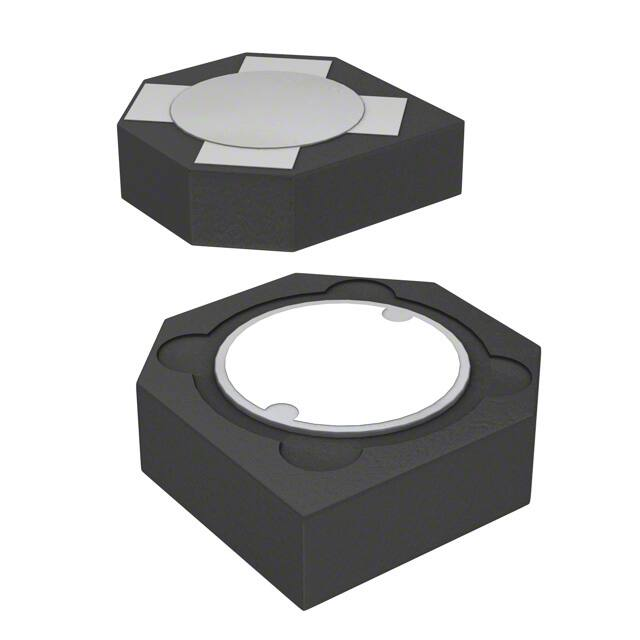

    固定电感器 Nonstandard 1.2µH ±35% 1A 115mΩ 210MHz
744030001 数据手册
Dimensions: [mm] Recommended Land Pattern: [mm] Electrical Properties: Properties 2, 3 4, 2 Ty p. 2 1 0, 5 4 3 Ty p. Ty p. 1, 1, 8 T 2 y ty p. p. 3 4 Ty p. 1, 1 p. Ty 0,95 ±0,10 3 1, 3,3 ±0,2 Value Unit Tol. L 100 kHz/ 100 mV 1.2 µH ±35% Rated Current IR ΔT = 40 K 1 A max. typ. Saturation Current ISAT 1.1 A DC Resistance RDC @ 20 °C |ΔL/L| < 35 % 95 mΩ typ. DC Resistance RDC @ 20 °C 115 mΩ max. Self Resonant Frequency fres 210 MHz typ. Certification: 2 1 Test conditions Inductance Scale - 5:1 RoHS Approval Compliant [2011/65/EU&2015/863] REACh Approval Conform or declared [(EC)1907/2006] Halogen Free Conform [JEDEC JS709B] Halogen Free Conform [IEC 61249-2-21] Schematic: 3, 5 General Properties: ±0 ,2 It is recommended that the temperature of the component does not exceed +125 °C under worst case conditions 2 4 Ambient Temperature (referring to IR) -40 up to +85 °C Operating Temperature -40 up to +125 °C Storage Conditions (in original packaging) < 40 °C ; < 75 % RH Moisture Sensitivity Level (MSL) 1 Test conditions of Electrical Properties: +20 °C, 33 % RH if not specified differently Scale - 5:1 Product Marking: Marking A CHECKED REVISION DATE (YYYY-MM-DD) GENERAL TOLERANCE LiSt 007.007 2020-06-09 DIN ISO 2768-1m PROJECTION METHOD DESCRIPTION Würth Elektronik eiSos GmbH & Co. KG EMC & Inductive Solutions Max-Eyth-Str. 1 74638 Waldenburg Germany Tel. +49 (0) 79 42 945 - 0 www.we-online.com eiSos@we-online.com WE-TPC SMT Shielded Tiny Power Inductor ORDER CODE 744030001 SIZE/TYPE BUSINESS UNIT STATUS PAGE 3510 eiSos Valid 1/6 This electronic component has been designed and developed for usage in general electronic equipment only. This product is not authorized for use in equipment where a higher safety standard and reliability standard is especially required or where a failure of the product is reasonably expected to cause severe personal injury or death, unless the parties have executed an agreement specifically governing such use. Moreover Würth Elektronik eiSos GmbH & Co KG products are neither designed nor intended for use in areas such as military, aerospace, aviation, nuclear control, submarine, transportation (automotive control, train control, ship control), transportation signal, disaster prevention, medical, public information network etc.. Würth Elektronik eiSos GmbH & Co KG must be informed about the intent of such usage before the design-in stage. In addition, sufficient reliability evaluation checks for safety must be performed on every electronic component which is used in electrical circuits that require high safety and reliability functions or performance. Typical Inductance vs. Current Characteristics: Typical Impedance Characteristics: 1.4 10000 1.2 1000 Impedance [Ω] Inductance [µH] 1.0 0.8 0.6 100 10 0.4 1 0.2 0 0.1 0.0 0.0 0.2 0.4 0.6 0.8 1.0 Current [A] 1.2 1.4 1 10 100 1000 Frequency [MHz] 1.6 Z CHECKED REVISION DATE (YYYY-MM-DD) GENERAL TOLERANCE LiSt 007.007 2020-06-09 DIN ISO 2768-1m PROJECTION METHOD DESCRIPTION Würth Elektronik eiSos GmbH & Co. KG EMC & Inductive Solutions Max-Eyth-Str. 1 74638 Waldenburg Germany Tel. +49 (0) 79 42 945 - 0 www.we-online.com eiSos@we-online.com WE-TPC SMT Shielded Tiny Power Inductor ORDER CODE 744030001 SIZE/TYPE BUSINESS UNIT STATUS PAGE 3510 eiSos Valid 2/6 This electronic component has been designed and developed for usage in general electronic equipment only. This product is not authorized for use in equipment where a higher safety standard and reliability standard is especially required or where a failure of the product is reasonably expected to cause severe personal injury or death, unless the parties have executed an agreement specifically governing such use. Moreover Würth Elektronik eiSos GmbH & Co KG products are neither designed nor intended for use in areas such as military, aerospace, aviation, nuclear control, submarine, transportation (automotive control, train control, ship control), transportation signal, disaster prevention, medical, public information network etc.. Würth Elektronik eiSos GmbH & Co KG must be informed about the intent of such usage before the design-in stage. In addition, sufficient reliability evaluation checks for safety must be performed on every electronic component which is used in electrical circuits that require high safety and reliability functions or performance. Packaging Specification - Tape and Reel: [mm] Packaging Specification - Reel: [mm] P0 A W3 P2 T W1 close to center E1 D0 B0 A N W E2 F D B C Top Cover Tape D1 A T1 P1 W2 T2 A0 Feeding direction End Start Carrier Tape Cover Tape detail B B Cover Tape Chip Cavity Sprocket Hole No Component min.160mm Components No Component min.100mm Embossment Cover Tape min. 400mm packaging is reffered to the international standard IEC 60286-3:2013 tolerance size 3510 A0 typ. 3,50 B0 typ. 3.5 W +0,3 -0,1 12 P1 ±0,1 8 T ±0,1 0.25 T1 max. 0,10 T2 typ. 1.5 D0 +0,1 -0,0 1,50 E1 ±0,1 1,75 E2 min. 10.25 F ±0,05 5.5 P0 ±0,1 4,00 P2 ±0,05 2,00 Tape Type Polystyrene VPE / packaging unit pcs. 1500 165° - 180° 12 mm A ± 2,0 178,00 B min. 1,50 C min. 12,80 D min. 20,20 N min. 50,00 CHECKED REVISION DATE (YYYY-MM-DD) GENERAL TOLERANCE LiSt 007.007 2020-06-09 DIN ISO 2768-1m W1 + 2,0 12,40 W2 max. 18,40 W3 min. 11,90 W3 max. 15,40 PROJECTION METHOD DESCRIPTION Pull-of force Tape width Tolerance Tape width 12 mm 0,1 N - 1,3 N Würth Elektronik eiSos GmbH & Co. KG EMC & Inductive Solutions Max-Eyth-Str. 1 74638 Waldenburg Germany Tel. +49 (0) 79 42 945 - 0 www.we-online.com eiSos@we-online.com WE-TPC SMT Shielded Tiny Power Inductor ORDER CODE 744030001 SIZE/TYPE BUSINESS UNIT STATUS PAGE 3510 eiSos Valid 3/6 This electronic component has been designed and developed for usage in general electronic equipment only. This product is not authorized for use in equipment where a higher safety standard and reliability standard is especially required or where a failure of the product is reasonably expected to cause severe personal injury or death, unless the parties have executed an agreement specifically governing such use. Moreover Würth Elektronik eiSos GmbH & Co KG products are neither designed nor intended for use in areas such as military, aerospace, aviation, nuclear control, submarine, transportation (automotive control, train control, ship control), transportation signal, disaster prevention, medical, public information network etc.. Würth Elektronik eiSos GmbH & Co KG must be informed about the intent of such usage before the design-in stage. In addition, sufficient reliability evaluation checks for safety must be performed on every electronic component which is used in electrical circuits that require high safety and reliability functions or performance. Classification Reflow Profile for SMT components: Classification Reflow Soldering Profile: Profile Feature Tp tp Max. Ramp Up Rate Max. Ramp Down Rate TL Temperature Ts max Ts min Ts min 150 °C Preheat Temperature Max Ts max 200 °C Preheat Time ts from Ts min to Ts max ts Ramp-up Rate (TL to TP) Liquidous Temperature tL Preheat Area TC –5°C Value Preheat Temperature Min 60 - 120 seconds 3 °C/ second max. TL 217 °C Time tL maintained above TL tL 60 - 150 seconds Peak package body temperature Tp Tp ≤ Tc, see Table below Time within 5°C of actual peak temperature tp 20-30 seconds, except Tp 260°C at tp 10 seconds Ramp-down Rate (TP to TL) 6 °C/ second max. Time 25°C to peak temperature 8 minutes max. refer to IPC/ JEDEC J-STD-020E tS Package Classification Reflow Temperature (Tc): Volume mm³ 350-2000 Volume mm³ >2000 PB-Free Assembly | Package Thickness 260 °C < 1.6 mm 260 °C 260 °C PB-Free Assembly | Package Thickness 260 °C 1.6 mm - 2.5 mm 250 °C 245 °C PB-Free Assembly | Package Thickness 250 °C ≥ 2.5 mm 245 °C 245 °C Properties 25 Time 25°C to Peak Time Volume mm³
