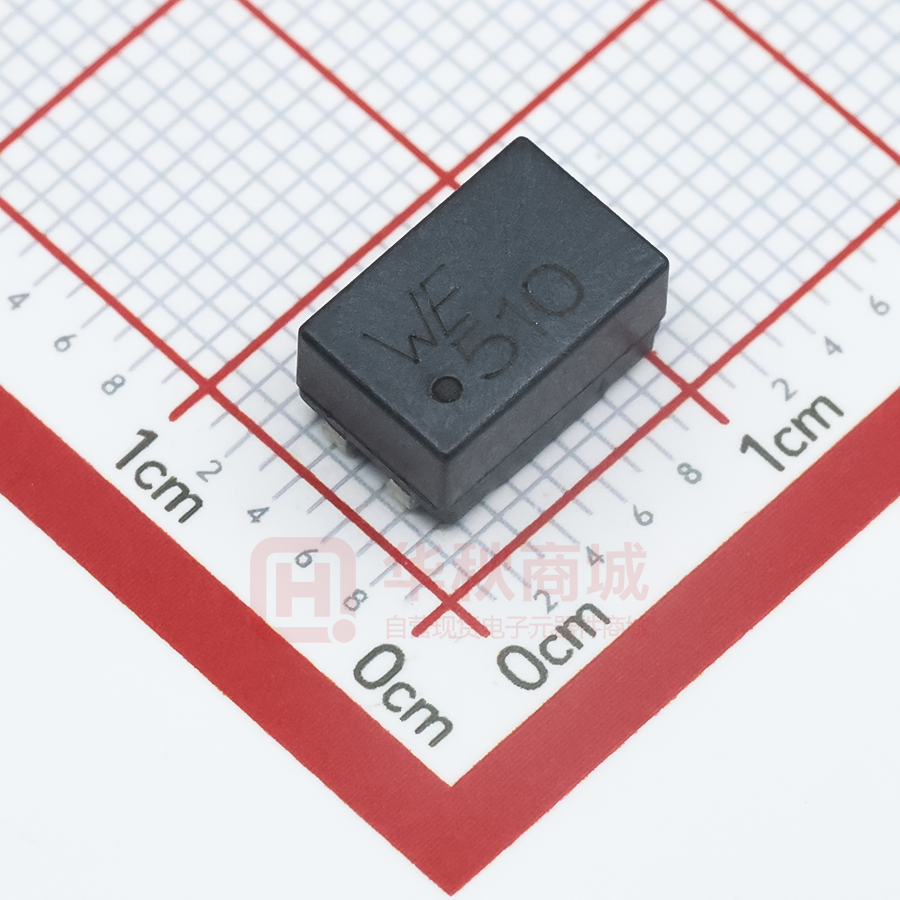

Dimensions: [mm] Recommended Land Pattern: [mm] Electrical Properties: Properties Test conditions Number of windings 3 1 2 4 2,54 5,7 ref. 2,54 ±0,2 4 1 L 3 Unit Tol. µH ±30% 2 1 kHz/ 100 mV 51 Zmax Maximum Impedance 2,0 1,2 2 Inductance 9,5 Value N 5500 Ω typ. Rated Current IR ΔT = 40 K 1000 mA max. DC Resistance RDC @ 20 °C 0.16 Ω max. Leakage Inductance LS 1 MHz/ 1 mA 85 nH typ. Insulation Test Voltage VT 50 Hz/ 3 mA/ 3 sec. 500 V (AC) max. Rated Voltage VR 80 V Certification: 5,0 ±0,3 9,2 ±0,3 1,4 ref. Scale - 3:1 Schematic: RoHS Approval Compliant [2011/65/EU&2015/863] REACh Approval Conform or declared [(EC)1907/2006] Halogen Free Conform [JEDEC JS709B] Halogen Free Conform [IEC 61249-2-21] Component Qualification 1,0 ±0,1 AEC-Q200 Grade 1 General Properties: 6,0 ±0,3 1 2 1 2 4 3 Ambient Temperature (referring to IR) -40 up to +85 °C Operating Temperature -40 up to +125 °C Storage Conditions (in original packaging) < 40 °C ; < 75 % RH Moisture Sensitivity Level (MSL) 1 Test conditions of Electrical Properties: +20 °C, 33 % RH if not specified differently Scale - 3:1 Product Marking: with dot: bifilar winding style without dot: sectional winding style Marking 510 (Inductance Code) CHECKED REVISION DATE (YYYY-MM-DD) GENERAL TOLERANCE Iva 009.003 2023-04-12 DIN ISO 2768-1m PROJECTION METHOD DESCRIPTION Würth Elektronik eiSos GmbH & Co. KG EMC & Inductive Solutions Max-Eyth-Str. 1 74638 Waldenburg Germany Tel. +49 (0) 79 42 945 - 0 www.we-online.com eiSos@we-online.com WE-SL2 SMT Common Mode Line Filter ORDER CODE 744227 BUSINESS UNIT STATUS PAGE eiSos Valid 1/6 This electronic component has been designed and developed for usage in general electronic equipment only. This product is not authorized for use in equipment where a higher safety standard and reliability standard is especially required or where a failure of the product is reasonably expected to cause severe personal injury or death, unless the parties have executed an agreement specifically governing such use. Moreover Würth Elektronik eiSos GmbH & Co KG products are neither designed nor intended for use in areas such as military, aerospace, aviation, nuclear control, submarine, transportation, transportation signal, disaster prevention, medical, public information network etc.. Würth Elektronik eiSos GmbH & Co KG must be informed about the intent of such usage before the design-in stage. In addition, sufficient reliability evaluation checks for safety must be performed on every electronic component which is used in electrical circuits that require high safety and reliability functions or performance. Typical Impedance Characteristics: Test Setup: 100000 Impedance [Ω] 10000 1000 100 10 1 0.01 0.1 1 10 100 Frequency [MHz] Z (comm) Z (diff) CHECKED REVISION DATE (YYYY-MM-DD) GENERAL TOLERANCE Iva 009.003 2023-04-12 DIN ISO 2768-1m PROJECTION METHOD DESCRIPTION Würth Elektronik eiSos GmbH & Co. KG EMC & Inductive Solutions Max-Eyth-Str. 1 74638 Waldenburg Germany Tel. +49 (0) 79 42 945 - 0 www.we-online.com eiSos@we-online.com WE-SL2 SMT Common Mode Line Filter ORDER CODE 744227 BUSINESS UNIT STATUS PAGE eiSos Valid 2/6 This electronic component has been designed and developed for usage in general electronic equipment only. This product is not authorized for use in equipment where a higher safety standard and reliability standard is especially required or where a failure of the product is reasonably expected to cause severe personal injury or death, unless the parties have executed an agreement specifically governing such use. Moreover Würth Elektronik eiSos GmbH & Co KG products are neither designed nor intended for use in areas such as military, aerospace, aviation, nuclear control, submarine, transportation, transportation signal, disaster prevention, medical, public information network etc.. Würth Elektronik eiSos GmbH & Co KG must be informed about the intent of such usage before the design-in stage. In addition, sufficient reliability evaluation checks for safety must be performed on every electronic component which is used in electrical circuits that require high safety and reliability functions or performance. Packaging Specification - Tape and Reel: [mm] Packaging Specification - Reel: [mm] P0 P2 W3 T E1 D0 A C N W B E2 B0 D F W1 close to center top cover tape D1 K0 A0 T1 T2 P1 W2 detail B Feeding direction End Start Carrier Tape B Cover tape Cover Tape Chip Cavity Sprocket Hole No Component min. 160mm Components No Component min. 100mm Embossment Cover Tape min. 400mm packaging is reffered to the international standard IEC 60286-3:2013 tolerance value A0 typ. 6,50 B0 typ. 9,70 W +0,3/ -0,1 16,00 P1 ±0,1 12,00 T ±0,1 0,40 T1 max. 0,10 T2 typ. 5,70 D0 +0,1/ -0,0 1,50 D1 min 1,50 E1 ±0,1 1,75 E2 min. 14,25 F ±0,05 7,50 P0 ±0,1 4,00 P2 ±0,05 2,00 VPE / packaging unit pcs. 1000 165° - 180° tolerance Tape width 16 mm A ± 2,0 330.00 B min. 1.50 C min. 12.80 D min. 20.20 N min. 60.00 CHECKED REVISION DATE (YYYY-MM-DD) GENERAL TOLERANCE Iva 009.003 2023-04-12 DIN ISO 2768-1m W1 +2 16.40 W2 max. 22.40 W3 min. 15.90 W3 max. 19.40 PROJECTION METHOD DESCRIPTION Pull-off force Tape width 16 mm 0,1 N - 1,3 N Würth Elektronik eiSos GmbH & Co. KG EMC & Inductive Solutions Max-Eyth-Str. 1 74638 Waldenburg Germany Tel. +49 (0) 79 42 945 - 0 www.we-online.com eiSos@we-online.com WE-SL2 SMT Common Mode Line Filter ORDER CODE 744227 BUSINESS UNIT STATUS PAGE eiSos Valid 3/6 This electronic component has been designed and developed for usage in general electronic equipment only. This product is not authorized for use in equipment where a higher safety standard and reliability standard is especially required or where a failure of the product is reasonably expected to cause severe personal injury or death, unless the parties have executed an agreement specifically governing such use. Moreover Würth Elektronik eiSos GmbH & Co KG products are neither designed nor intended for use in areas such as military, aerospace, aviation, nuclear control, submarine, transportation, transportation signal, disaster prevention, medical, public information network etc.. Würth Elektronik eiSos GmbH & Co KG must be informed about the intent of such usage before the design-in stage. In addition, sufficient reliability evaluation checks for safety must be performed on every electronic component which is used in electrical circuits that require high safety and reliability functions or performance. Classification Reflow Profile for SMT components: Classification Reflow Soldering Profile: Profile Feature Tp tp Max. Ramp Up Rate Max. Ramp Down Rate TL Temperature Ts max tL Preheat Area Ts min TC –5°C Value Preheat Temperature Min Ts min 150 °C Preheat Temperature Max Ts max 200 °C Preheat Time ts from Ts min to Ts max ts Ramp-up Rate (TL to TP) 60 - 120 seconds 3 °C/ second max. Liquidous Temperature TL 217 °C Time tL maintained above TL tL 60 - 150 seconds Peak package body temperature Tp Tp ≤ Tc, see Table below Time within 5°C of actual peak temperature tp 20 - 30 seconds Ramp-down Rate (TP to TL) 6 °C/ second max. Time 25°C to peak temperature 8 minutes max. refer to IPC/ JEDEC J-STD-020E tS Package Classification Reflow Temperature (Tc): Volume mm³ 350-2000 Volume mm³ >2000 PB-Free Assembly | Package Thickness 260 °C < 1.6 mm 260 °C 260 °C PB-Free Assembly | Package Thickness 260 °C 1.6 mm - 2.5 mm 250 °C 245 °C PB-Free Assembly | Package Thickness 250 °C > 2.5 mm 245 °C 245 °C Properties 25 Time 25°C to Peak Time Volume mm³
