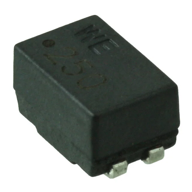

744227S 数据手册
Spezifikation für Freigabe / specification for release Kunde / customer : Artikelnummer / part number : Bezeichnung : description : 744227S LF RoHS compliant DATUM / DATE : 2004-10-11 STROMKOMP. SMD LINE FILTER WE-SL2 COMMON MODE SMD LINE FILTER WE-SL2 A Mechanische Abmessungen / dimensions : H 3 4 G C B D F A WE 2 ===== 1 3 4 2 Ee 1 A B C D E F G H 9,2 ± 0,3 6,0 ± 0,3 5,0 ± 0,3 2,0 ref. 2,54 ± 0,2 5,7 ref. 1,4 ref. 1,0 ± 0,1 mm mm mm mm mm mm mm B Elektrische Eigenschaften / electrical properties : Eigenschaften / properties Induktivität / inductance Nennspannung/ rated voltage DC-Widerstand / DC-resistance Nennstrom / rated current Impedanz / impedance Testbedingungen / test conditions 0,1V / 1 KHz Wert / value Einheit / unit tol. ± 30 % C Lötpad / soldering spec. : µH V Ω A Ω max. max. max. 2,0 9,5 L1-4;2-3 UDC RDC IDC Z 51 80 0,16 1,00 5500 2,54 1,2 , D Prüfgeräte / test equipment : HP 4274 A für/for L und/and Q HP 34401 A für/for IDC und/and RDC E Testbedingungen / test conditions : Luftfeuchtigkeit / humidity: Umgebungstemperatur / temperature: 33% +20°C F Werkstoffe & Zulassungen / material & approvals : Basismaterial / base material: Draht / wire: Gehäuse / Housing: Ferrit / ferrite Class F UL94-V0 G Eigenschaften / granted properties : Betriebstemp. / operating temperature: -40°C - + 125°C Umgebungstemp. / ambient temperature: -40°C - + 85°C It is recommended that the temperature of the part does not exceed 125°C under worst case operating conditions. Spannungsfestigkeit / High-Pot Test:(60Hz 3mA 3sec.) 500 VAC Freigabe erteilt / general release: Kunde / customer MST Version 7 Version 6 Version 5 Version 4 Version 3 Version 2 Version 1 2004-10-11 2004-03-29 2004-01-07 2003-04-15 2003-03-04 2002-04-23 2002-03-21 .......................................................................... .................................................................................. MST MST AG MST Datum / date Unterschrift / signature Würth Elektronik .................................................................................. .......................................................................... RT MST Geprüft / checked Kontrolliert / approved Würth Elektronik eiSos GmbH & Co. KG D-74638 Waldenburg · Max-Eyth-Strasse 1 - 3 · Germany · Telefon (+49) (0) 7942 - 945 - 0 · Telefax (+49) (0) 7942 - 945 - 400 http://www.we-online.com SEITE 1 VON 2 Spezifikation für Freigabe / specification for release Kunde / customer : Artikelnummer / part number : Bezeichnung : description : 744227S LF RoHS compliant DATUM / DATE : 2004-10-11 STROMKOMP. SMD LINE FILTER WE-SL2 COMMON MODE SMD LINE FILTER WE-SL2 H Impedanzverlauf / impedance curve : 10000 1000 Impedanz / impedance [Ohm] 100 10 1 1 IF BW 10kHz START 1 MHz 10 Frequenz / frequency [MHz] POWER 0 dBm 100 SWP 134,5 msec STOP 300 MHz 1000 Z (com) common mode ===== Z (dif) differential mode ===== Freigabe erteilt / general release: Kunde / customer MST MST Version 7 Version 6 Version 5 Version 4 Version 3 Version 2 Version 1 Änderung / modification 2004-10-11 2004-03-29 2004-01-07 2003-04-15 2003-03-04 2002-04-23 2002-03-21 .......................................................................... .................................................................................. MST AG MST RT Datum / date Unterschrift / signature Würth Elektronik .................................................................................. .......................................................................... MST Name Geprüft / checked Kontrolliert / approved Datum / date This electronic component is designed and developed with the intention for use in general electronics equipments. Before incorporating the components into any equipments in the field such as aerospace, aviation, nuclear control, submarine, transportation, (automotive control, train control, ship control), transportation signal, disaster prevention, medical, public information network etc. where higher safety and reliability are especially required or if there is possibility of direct damage or injury to human body. In addition, even electronic component in general electronic equipments, when used in electrical circuits that require high safety, reliability functions or performance, the sufficient reliability evaluation-check for the safety must be performed before use. It is essential to give consideration when to install a protective circuit at the design stage. Würth Elektronik eiSos GmbH & Co. KG D-74638 Waldenburg · Max-Eyth-Strasse 1 - 3 · Germany · Telefon (+49) (0) 7942 - 945 - 0 · Telefax (+49) (0) 7942 - 945 - 400 http://www.we-online.com SEITE 2 VON 2
