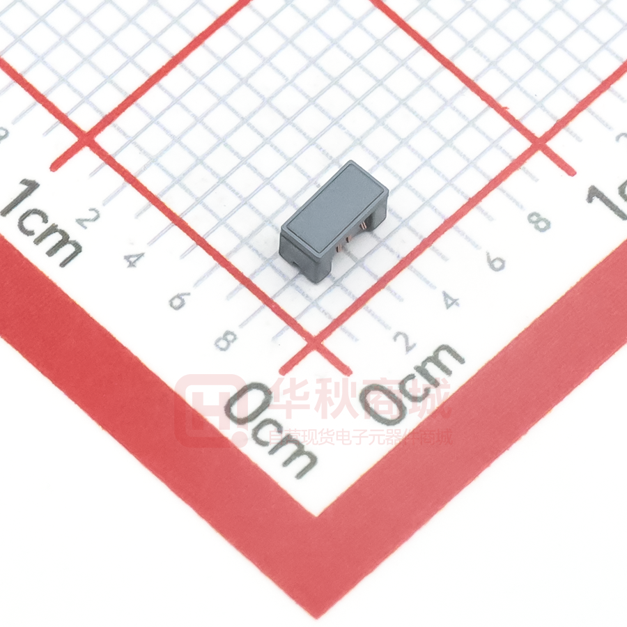

    SMD,3.2x1.6mm
    90 Ω @ 100MHZ 370MA
744232090 数据手册
Dimensions: [mm] Recommended Land Pattern: [mm] Electrical Properties: Properties 0,4 1,60 2 0,6 ref. 1 L Impedance @ 100 MHz Z IR Rated Current 3 4 Test conditions Inductance 0,60 0,7 ref. 1,1 1,6 1,1 Unit 0.111 µH Tol. typ. 100 MHz 90 Ω ±20% ΔT = 40 K 370 mA max. DC Resistance RDC @ 20 °C 0.3 Ω max. Insulation Test Voltage VT 125 V (DC) max. Rated Voltage VR 50 V Certification: 3,2 ±0,2 1,8 ±0,2 Value Scale - 6:1 RoHS Approval Compliant [2011/65/EU&2015/863] REACh Approval Conform or declared [(EC)1907/2006] Halogen Free Conform [JEDEC JS709B] Halogen Free Conform [IEC 61249-2-21] AECQ Qualified Schematic: Yes Component Qualification AEC-Q200 Grade1 1,6 ±0,2 General Properties: 1 4 3 2 1 2 Ambient Temperature (referring to IR) -40 up to +85 °C Operating Temperature -40 up to +125 °C Storage Conditions (in original packaging) < 40 °C ; < 75 % RH Moisture Sensitivity Level (MSL) 1 Test conditions of Electrical Properties: +20 °C, 33 % RH if not specified differently Scale - 6:1 CHECKED REVISION DATE (YYYY-MM-DD) GENERAL TOLERANCE ACG 006.002 2021-02-10 DIN ISO 2768-1m PROJECTION METHOD DESCRIPTION Würth Elektronik eiSos GmbH & Co. KG EMC & Inductive Solutions Max-Eyth-Str. 1 74638 Waldenburg Germany Tel. +49 (0) 79 42 945 - 0 www.we-online.com eiSos@we-online.com WE-CNSW SMT Common Mode Line Filter ORDER CODE 744232090 SIZE/TYPE BUSINESS UNIT STATUS PAGE 1206 eiSos Valid 1/6 This electronic component has been designed and developed for usage in general electronic equipment only. This product is not authorized for use in equipment where a higher safety standard and reliability standard is especially required or where a failure of the product is reasonably expected to cause severe personal injury or death, unless the parties have executed an agreement specifically governing such use. Moreover Würth Elektronik eiSos GmbH & Co KG products are neither designed nor intended for use in areas such as military, aerospace, aviation, nuclear control, submarine, transportation (automotive control, train control, ship control), transportation signal, disaster prevention, medical, public information network etc.. Würth Elektronik eiSos GmbH & Co KG must be informed about the intent of such usage before the design-in stage. In addition, sufficient reliability evaluation checks for safety must be performed on every electronic component which is used in electrical circuits that require high safety and reliability functions or performance. Typical Impedance Characteristics: Test Setup: 10000 Impedance [Ω] 1000 According to CISPR 17 1´ (GND) 2´ (GND) Port 1 1 100 1 4 Port 2 2 3 4 DUT 3 2 Port 3 Port 4 3´ (GND) 10 4´ (GND) GND Network Analyzer: Keysight E5080A or equivalent 1 1 10 100 1000 Frequency [MHz] Z (comm) Z (diff) CHECKED REVISION DATE (YYYY-MM-DD) GENERAL TOLERANCE ACG 006.002 2021-02-10 DIN ISO 2768-1m PROJECTION METHOD DESCRIPTION Würth Elektronik eiSos GmbH & Co. KG EMC & Inductive Solutions Max-Eyth-Str. 1 74638 Waldenburg Germany Tel. +49 (0) 79 42 945 - 0 www.we-online.com eiSos@we-online.com WE-CNSW SMT Common Mode Line Filter ORDER CODE 744232090 SIZE/TYPE BUSINESS UNIT STATUS PAGE 1206 eiSos Valid 2/6 This electronic component has been designed and developed for usage in general electronic equipment only. This product is not authorized for use in equipment where a higher safety standard and reliability standard is especially required or where a failure of the product is reasonably expected to cause severe personal injury or death, unless the parties have executed an agreement specifically governing such use. Moreover Würth Elektronik eiSos GmbH & Co KG products are neither designed nor intended for use in areas such as military, aerospace, aviation, nuclear control, submarine, transportation (automotive control, train control, ship control), transportation signal, disaster prevention, medical, public information network etc.. Würth Elektronik eiSos GmbH & Co KG must be informed about the intent of such usage before the design-in stage. In addition, sufficient reliability evaluation checks for safety must be performed on every electronic component which is used in electrical circuits that require high safety and reliability functions or performance. Packaging Specification - Tape and Reel: [mm] Packaging Specification - Reel: [mm] P0 P2 T W3 E1 D0 D W1 close to center A E2 B0 C top cover tape D1 A0 K0 P1 W2 T1 T2 Feeding direction End N W F B Start Carrier tape detail B B Cover tape Top Cover Tape Chip Cavity Sprocket Hole No Component min. 160 mm Components No Component min. 100 mm Cover Tape min. 400 mm Embossment Packaging is referred to the international standard IEC 60286-3:2013 tolerance size 1206 A0 typ. 1,88 B0 typ. 3,50 W +0,3 8,00 P1 ±0,1 4,00 T ±0,1 0,20 T1 max. 0,10 T2 typ. 2,10 D0 +0,1 1,50 E1 ±0,1 1,75 E2 min. 6,25 F ±0,05 3,50 P0 ±0,1 4,00 P2 ±0,05 2,00 Tape Polystyrene VPE / packaging unit pcs. 2000 165° - 180° tolerance Tape width 8 mm A ±2,0 178,00 B min. 1,50 C ±0,8 13,00 Bottom Cover Tape D min. 20,20 N min. 50,00 CHECKED REVISION DATE (YYYY-MM-DD) GENERAL TOLERANCE ACG 006.002 2021-02-10 DIN ISO 2768-1m W1 +1,5 8,40 W2 max. 14,40 W3 min. 7,90 W3 max. 10,90 PROJECTION METHOD DESCRIPTION Pull-of force Tape width 8 mm 0,1 N - 1,0 N Würth Elektronik eiSos GmbH & Co. KG EMC & Inductive Solutions Max-Eyth-Str. 1 74638 Waldenburg Germany Tel. +49 (0) 79 42 945 - 0 www.we-online.com eiSos@we-online.com WE-CNSW SMT Common Mode Line Filter ORDER CODE 744232090 SIZE/TYPE BUSINESS UNIT STATUS PAGE 1206 eiSos Valid 3/6 This electronic component has been designed and developed for usage in general electronic equipment only. This product is not authorized for use in equipment where a higher safety standard and reliability standard is especially required or where a failure of the product is reasonably expected to cause severe personal injury or death, unless the parties have executed an agreement specifically governing such use. Moreover Würth Elektronik eiSos GmbH & Co KG products are neither designed nor intended for use in areas such as military, aerospace, aviation, nuclear control, submarine, transportation (automotive control, train control, ship control), transportation signal, disaster prevention, medical, public information network etc.. Würth Elektronik eiSos GmbH & Co KG must be informed about the intent of such usage before the design-in stage. In addition, sufficient reliability evaluation checks for safety must be performed on every electronic component which is used in electrical circuits that require high safety and reliability functions or performance. Classification Reflow Profile for SMT components: Classification Reflow Soldering Profile: Profile Feature Tp tp Max. Ramp Up Rate Max. Ramp Down Rate TL Temperature Ts max Ts min Ts min 150 °C Preheat Temperature Max Ts max 200 °C Preheat Time ts from Ts min to Ts max ts Ramp-up Rate (TL to TP) Liquidous Temperature tL Preheat Area TC –5°C Value Preheat Temperature Min 60 - 120 seconds 3 °C/ second max. TL 217 °C Time tL maintained above TL tL 60 - 150 seconds Peak package body temperature Tp Tp ≤ Tc, see Table below Time within 5°C of actual peak temperature tp 20 - 30 seconds Ramp-down Rate (TP to TL) 6 °C/ second max. Time 25°C to peak temperature 8 minutes max. refer to IPC/ JEDEC J-STD-020E tS Package Classification Reflow Temperature (Tc): Volume mm³ 350-2000 Volume mm³ >2000 PB-Free Assembly | Package Thickness 260 °C < 1.6 mm 260 °C 260 °C PB-Free Assembly | Package Thickness 260 °C 1.6 mm - 2.5 mm 250 °C 245 °C PB-Free Assembly | Package Thickness 250 °C > 2.5 mm 245 °C 245 °C Properties 25 Time 25°C to Peak Time Volume mm³
