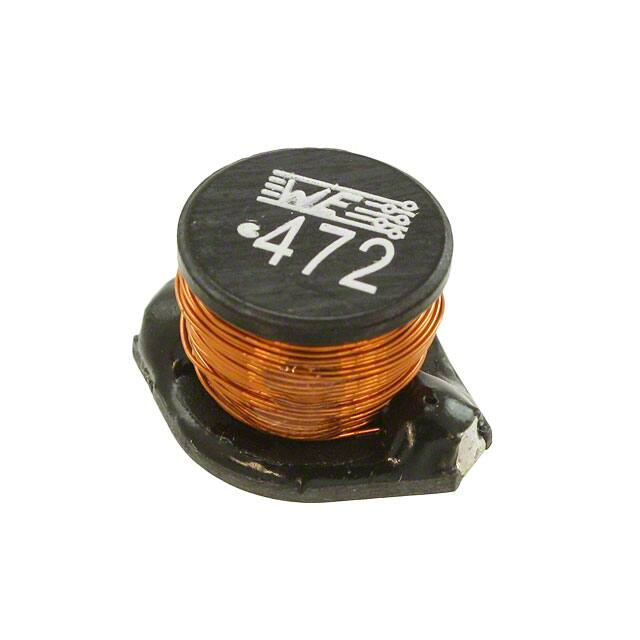

    固定电感器 Nonstandard 4.7mH ±10% 400mA 4.8Ω 500KHz
74458304 数据手册
Dimensions: [mm] Recommended Land Pattern: [mm] Electrical Properties: Properties Inductance L 12,45 2,92 13,3 max. 12,0 max. Scale - 1,5:1 Value Unit Tol. 100 kHz/ 100 mV 4.7 mH ±10% 22 pF typ. DC Resistance RDC @ 20 °C C 4.8 Ω max. DC Resistance RDC @ 20 °C 4 Ω typ. 0.4 A max. IR Rated Current 2,79 2,54 ref. 13,15 ref. 2,54 ref. Capacitance Test conditions Saturation Current ISAT Self Resonant Frequency fres ΔT = 40 K |ΔL/L| < 10 % 0.9 A typ. 500 kHz min. Certification: RoHS Approval Compliant [2011/65/EU&2015/863] REACh Approval Conform or declared [(EC)1907/2006] Halogen Free Conform [JEDEC JS709B] Schematic: 18,54 max. General Information: 15,24 max. It is recommended that the temperature of the component does not exceed +125 °C under worst case conditions Ambient Temperature (referring to IR) -40 up to +85 °C Operating Temperature -40 up to +125 °C Storage Conditions (in original packaging) < 40 °C ; < 75 % RH Moisture Sensitivity Level (MSL) 1 Scale - 1,5:1 Product Marking: Marking Start of Winding 472 (Inductance Code) • CHECKED REVISION DATE (YYYY-MM-DD) GENERAL TOLERANCE ALa 004.004 2020-05-18 DIN ISO 2768-1m PROJECTION METHOD DESCRIPTION WE-ASI SMT Wire Wound Inductor Würth Elektronik eiSos GmbH & Co. KG EMC & Inductive Solutions Max-Eyth-Str. 1 74638 Waldenburg Germany Tel. +49 (0) 79 42 945 - 0 www.we-online.com eiSos@we-online.com ORDER CODE 74458304 SIZE/TYPE BUSINESS UNIT STATUS PAGE L eiSos Valid 1/5 This electronic component has been designed and developed for usage in general electronic equipment only. This product is not authorized for use in equipment where a higher safety standard and reliability standard is especially required or where a failure of the product is reasonably expected to cause severe personal injury or death, unless the parties have executed an agreement specifically governing such use. Moreover Würth Elektronik eiSos GmbH & Co KG products are neither designed nor intended for use in areas such as military, aerospace, aviation, nuclear control, submarine, transportation (automotive control, train control, ship control), transportation signal, disaster prevention, medical, public information network etc.. Würth Elektronik eiSos GmbH & Co KG must be informed about the intent of such usage before the design-in stage. In addition, sufficient reliability evaluation checks for safety must be performed on every electronic component which is used in electrical circuits that require high safety and reliability functions or performance. Packaging Specification - Tape and Reel: [mm] P0 A P2 T W1 close to center W S B0 A F B N D E D0 W3 K0 C d Top Cover Tape D1 A P1 T1 D0 2 A0 T2 detail B End Start Feeding direction No Component min. 160mm Components Carrier Tape Cover Tape Cover Tape B No Component min. 100mm Chip Cavity Sprocket Hole Embossment Cover Tape min. 400mm Packaging is referred to the international standard IEC 60286-3:2019 Tape Type Tolerance Value 3 A0 (mm) typ. 15,74 B0 (mm) typ. 19,04 W (mm) ±0,3 32,00 T (mm) ref. 0,50 T1 (mm) ref. 0,10 T2 (mm) typ. 12,60 K0 (mm) typ. 12,40 P0 (mm) ±0,1 4,00 P1 (mm) ±0,1 24,00 P2 (mm) ±0,1 2,00 D0 (mm) +0,1/ -0,0 1,50 D0 / 2 (mm) +0,05/ -0,0 0,75 D1 (mm) min. 2,00 d (mm) ±0,05 0,20 E (mm) ±0,1 1,75 S (mm) ±0,1 28,40 F (mm) Material ±0,1 14,20 Polystyrene Qty. (pcs.) Tolerance Value A (mm) ± 2,0 330,00 B (mm) min. 1,50 C (mm) min. 12,80 D (mm) min. 20,20 N (mm) typ. 100,00 W1 (mm) + 2,0 32,40 W2 (mm) max. 38,40 W3 (mm) min. 31,90 W3 (mm) max. 35,40 Material Polystyrene 200 165° - 180° CHECKED REVISION DATE (YYYY-MM-DD) GENERAL TOLERANCE ALa 004.004 2020-05-18 DIN ISO 2768-1m PROJECTION METHOD DESCRIPTION WE-ASI SMT Wire Wound Inductor Pull-of force Tape width 32 mm 0,1 N - 1,3 N Würth Elektronik eiSos GmbH & Co. KG EMC & Inductive Solutions Max-Eyth-Str. 1 74638 Waldenburg Germany Tel. +49 (0) 79 42 945 - 0 www.we-online.com eiSos@we-online.com ORDER CODE 74458304 SIZE/TYPE BUSINESS UNIT STATUS PAGE L eiSos Valid 2/5 This electronic component has been designed and developed for usage in general electronic equipment only. This product is not authorized for use in equipment where a higher safety standard and reliability standard is especially required or where a failure of the product is reasonably expected to cause severe personal injury or death, unless the parties have executed an agreement specifically governing such use. Moreover Würth Elektronik eiSos GmbH & Co KG products are neither designed nor intended for use in areas such as military, aerospace, aviation, nuclear control, submarine, transportation (automotive control, train control, ship control), transportation signal, disaster prevention, medical, public information network etc.. Würth Elektronik eiSos GmbH & Co KG must be informed about the intent of such usage before the design-in stage. In addition, sufficient reliability evaluation checks for safety must be performed on every electronic component which is used in electrical circuits that require high safety and reliability functions or performance. Classification Reflow Profile for SMT components: Classification Reflow Soldering Profile: Profile Feature Tp tp Max. Ramp Up Rate Max. Ramp Down Rate TL Temperature Ts max tL Preheat Area Ts min TC –5°C Value Preheat Temperature Min Ts min 150 °C Preheat Temperature Max Ts max 200 °C Preheat Time ts from Ts min to Ts max ts Ramp-up Rate (TL to TP) 60 - 120 seconds 3 °C/ second max. Liquidous Temperature TL 217 °C Time tL maintained above TL tL 60 - 150 seconds Peak package body temperature Tp Tp ≤ Tc, see Table below Time within 5°C of actual peak temperature tp 20 - 30 seconds Ramp-down Rate (TP to TL) 6 °C/ second max. Time 25°C to peak temperature 8 minutes max. refer to IPC/ JEDEC J-STD-020E tS Package Classification Reflow Temperature (Tc): Volume mm³ 350-2000 Volume mm³ >2000 PB-Free Assembly | Package Thickness 260 °C < 1.6 mm 260 °C 260 °C PB-Free Assembly | Package Thickness 260 °C 1.6 mm - 2.5 mm 250 °C 245 °C PB-Free Assembly | Package Thickness 250 °C > 2.5 mm 245 °C 245 °C Properties 25 Time 25°C to Peak Time Volume mm³
