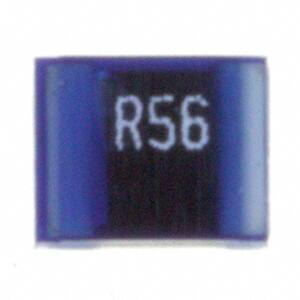

    固定电感器 1008 560nH ±5% 310mA 1.5Ω 430MHz 45@100MHz
744762256A 数据手册
Dimensions: [mm] Recommended Land Pattern: [mm] Electrical Properties: Properties Test conditions Inductance Q-Factor Unit Tol. 25 MHz 560 nH ±5% Q 100 MHz 45 RDC @ 20 °C DC Resistance 2,2 Value L Rated Current IR Self Resonant Frequency fres ΔT = 15 K min. 1.5 Ω max. 310 mA max. 430 MHz min. Certification: 0,5 ± 0,1 0,5 ref. 1,2 Scale - 10:1 1,6 ±0,2 2,5 ± 0,2 0,9 RoHS Approval Compliant [2011/65/EU&2015/863] REACh Approval Conform or declared [(EC)1907/2006] Halogen Free Conform [JEDEC JS709B] Halogen Free Conform [IEC 61249-2-21] Component Qualification AEC-Q200 Grade 1 Schematic: General Information: 2,0 ± 0,2 It is recommended that the temperature of the component does not exceed +125 °C under worst case conditions Ambient Temperature (referring to IR) -40 up to +110 °C Operating Temperature -40 up to +125 °C Storage Conditions (in original packaging) < 40 °C ; < 75 % RH Moisture Sensitivity Level (MSL) 1 Test conditions of Electrical Properties: +20 °C, 33 % RH if not specified differently Scale - 10:1 Product Marking: Marking R56 (Inductance Code) CHECKED REVISION DATE (YYYY-MM-DD) GENERAL TOLERANCE JoMa 003.000 2021-05-14 DIN ISO 2768-1m PROJECTION METHOD DESCRIPTION Würth Elektronik eiSos GmbH & Co. KG EMC & Inductive Solutions Max-Eyth-Str. 1 74638 Waldenburg Germany Tel. +49 (0) 79 42 945 - 0 www.we-online.com eiSos@we-online.com WE-KI SMT Wire Wound Ceramic Inductor ORDER CODE 744762256A SIZE/TYPE BUSINESS UNIT STATUS PAGE 1008A eiSos Valid 1/6 This electronic component has been designed and developed for usage in general electronic equipment only. This product is not authorized for use in equipment where a higher safety standard and reliability standard is especially required or where a failure of the product is reasonably expected to cause severe personal injury or death, unless the parties have executed an agreement specifically governing such use. Moreover Würth Elektronik eiSos GmbH & Co KG products are neither designed nor intended for use in areas such as military, aerospace, aviation, nuclear control, submarine, transportation (automotive control, train control, ship control), transportation signal, disaster prevention, medical, public information network etc.. Würth Elektronik eiSos GmbH & Co KG must be informed about the intent of such usage before the design-in stage. In addition, sufficient reliability evaluation checks for safety must be performed on every electronic component which is used in electrical circuits that require high safety and reliability functions or performance. Typical Inductance vs. Frequency Characteristics: Q-Factor vs. Frequency: 10000 60 50 1000 Q Inductance [nH] 40 100 30 20 10 10 1 0 1 10 100 1000 1 10 Frequency [MHz] 100 1000 Frequency [MHz] CHECKED REVISION DATE (YYYY-MM-DD) GENERAL TOLERANCE JoMa 003.000 2021-05-14 DIN ISO 2768-1m PROJECTION METHOD DESCRIPTION Würth Elektronik eiSos GmbH & Co. KG EMC & Inductive Solutions Max-Eyth-Str. 1 74638 Waldenburg Germany Tel. +49 (0) 79 42 945 - 0 www.we-online.com eiSos@we-online.com WE-KI SMT Wire Wound Ceramic Inductor ORDER CODE 744762256A SIZE/TYPE BUSINESS UNIT STATUS PAGE 1008A eiSos Valid 2/6 This electronic component has been designed and developed for usage in general electronic equipment only. This product is not authorized for use in equipment where a higher safety standard and reliability standard is especially required or where a failure of the product is reasonably expected to cause severe personal injury or death, unless the parties have executed an agreement specifically governing such use. Moreover Würth Elektronik eiSos GmbH & Co KG products are neither designed nor intended for use in areas such as military, aerospace, aviation, nuclear control, submarine, transportation (automotive control, train control, ship control), transportation signal, disaster prevention, medical, public information network etc.. Würth Elektronik eiSos GmbH & Co KG must be informed about the intent of such usage before the design-in stage. In addition, sufficient reliability evaluation checks for safety must be performed on every electronic component which is used in electrical circuits that require high safety and reliability functions or performance. Packaging Specification - Tape and Reel: [mm] W3 P0 T W1 close to center D B W F A N P2 E1 D0 B0 E2 C W2 top cover tape D1 A0 T1 P1 T2 Feeding direction End Start detail B B Carrier tape Top Cover Tape Cover tape Chip Cavity Sprocket Hole Embossment No Component min. 160 mm tolerance size A0 B0 W typ. typ. +0,3/ -0,1 1008A 2.20 2.83 8.00 Components Bottom Cover Tape No Component min. 100 mm Cover Tape min. 400 mm T T1 T2 K0 P0 P1 P2 D0 ±0,1 max. typ. typ. ±0,1 ±0,1 ±0,05 +0,1/ -0,0 0.22 0.10 1.97 1.75 4.00 4.00 2.00 1.50 D1 E1 E2 F Tape Type 2a ±0,1 ±0,1 min. ±0,05 1.00 1.75 6.25 3.50 Polystyrene VPE / packaging unit pcs. 2000 165° - 180° tolerance Tape width 8 mm A ± 2,0 178 B min. 1.5 C min. 12.8 D min. 20.2 N min. 50 CHECKED REVISION DATE (YYYY-MM-DD) GENERAL TOLERANCE JoMa 003.000 2021-05-14 DIN ISO 2768-1m W1 +1,5 8.4 W2 max. 14.4 W3 min. 7.9 W3 max. 10.9 PROJECTION METHOD DESCRIPTION Pull-of force Tape width 8 mm 0,1 N - 1,0 N Würth Elektronik eiSos GmbH & Co. KG EMC & Inductive Solutions Max-Eyth-Str. 1 74638 Waldenburg Germany Tel. +49 (0) 79 42 945 - 0 www.we-online.com eiSos@we-online.com WE-KI SMT Wire Wound Ceramic Inductor ORDER CODE 744762256A SIZE/TYPE BUSINESS UNIT STATUS PAGE 1008A eiSos Valid 3/6 This electronic component has been designed and developed for usage in general electronic equipment only. This product is not authorized for use in equipment where a higher safety standard and reliability standard is especially required or where a failure of the product is reasonably expected to cause severe personal injury or death, unless the parties have executed an agreement specifically governing such use. Moreover Würth Elektronik eiSos GmbH & Co KG products are neither designed nor intended for use in areas such as military, aerospace, aviation, nuclear control, submarine, transportation (automotive control, train control, ship control), transportation signal, disaster prevention, medical, public information network etc.. Würth Elektronik eiSos GmbH & Co KG must be informed about the intent of such usage before the design-in stage. In addition, sufficient reliability evaluation checks for safety must be performed on every electronic component which is used in electrical circuits that require high safety and reliability functions or performance. Classification Reflow Profile for SMT components: Classification Reflow Soldering Profile: Profile Feature Tp tp Max. Ramp Up Rate Max. Ramp Down Rate TL Temperature Ts max tL Preheat Area Ts min TC –5°C Value Preheat Temperature Min Ts min 150 °C Preheat Temperature Max Ts max 200 °C Preheat Time ts from Ts min to Ts max ts Ramp-up Rate (TL to TP) 60 - 120 seconds 3 °C/ second max. Liquidous Temperature TL 217 °C Time tL maintained above TL tL 60 - 150 seconds Peak package body temperature Tp Tp ≤ Tc, see Table below Time within 5°C of actual peak temperature tp 20 - 30 seconds Ramp-down Rate (TP to TL) 6 °C/ second max. Time 25°C to peak temperature 8 minutes max. refer to IPC/ JEDEC J-STD-020E tS Package Classification Reflow Temperature (Tc): Volume mm³ 350-2000 Volume mm³ >2000 PB-Free Assembly | Package Thickness 260 °C < 1.6 mm 260 °C 260 °C PB-Free Assembly | Package Thickness 260 °C 1.6 mm - 2.5 mm 250 °C 245 °C PB-Free Assembly | Package Thickness 250 °C > 2.5 mm 245 °C 245 °C Properties 25 Time 25°C to Peak Time Volume mm³
