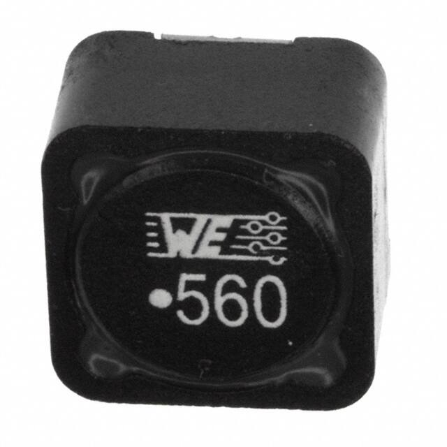

    固定电感器 Nonstandard 56µH ±20% 2.4A 110mΩ 7.1MHz
744770156 数据手册
Dimensions: [mm] Recommended Land Pattern: [mm] Electrical Properties: Properties 7,0 12,8 2,9 8,0 ±0,3 5,4 Value Unit Tol. Inductance L Test conditions 1 kHz/ 250 mV 56 µH ±20% Rated Current IR ΔT = 40 K 2.4 A max. |ΔL/L| < 10 % typ. Saturation Current ISAT 2.9 A DC Resistance RDC @ 20 °C 85 mΩ typ. DC Resistance RDC @ 20 °C 110 mΩ max. Self Resonant Frequency fres 7.1 MHz typ. V 120 V max. Operating Voltage 5,0 ±0,2 Certification: 12,0 ±0,5 no vias and sensitive traces underneath the component Scale - 2:1 RoHS Approval Compliant [ 2011/65/EU&2015/863 ] REACh Approval Conform or declared [ (EC)1907/2006 ] Halogen Free Conform [ JEDEC 709B ] 8,0 max. Schematic: General Information: 12,0 ±0,5 It is recommended that the temperature of the component does not exceed +125 °C under worst case conditions Ambient Temperature (refering to IR) -40 up to +85 °C Operating Temperature -40 up to +125 °C Storage Conditions (in original packaging) < 40 °C ; < 75 % RH Moisture Sensitivity Level (MSL) 1 Test conditions of Electrical Properties: +20 °C, 33 % RH if not specified differently Scale - 2:1 Product Marking: Start of Winding Marking • 560 (Inductance Code) CHECKED REVISION DATE (YYYY-MM-DD) GENERAL TOLERANCE PSL 005.007 2018-12-01 DIN ISO 2768-1m PROJECTION METHOD DESCRIPTION Würth Elektronik eiSos GmbH & Co. KG EMC & Inductive Solutions Max-Eyth-Str. 1 74638 Waldenburg Germany Tel. +49 (0) 79 42 945 - 0 www.we-online.com eiSos@we-online.com WE-PD SMT Shielded Power Inductor ORDER CODE 744770156 SIZE/TYPE BUSINESS UNIT STATUS PAGE 1280 eiSos Valid 1/6 This electronic component has been designed and developed for usage in general electronic equipment only. This product is not authorized for use in equipment where a higher safety standard and reliability standard is especially required or where a failure of the product is reasonably expected to cause severe personal injury or death, unless the parties have executed an agreement specifically governing such use. Moreover Würth Elektronik eiSos GmbH & Co KG products are neither designed nor intended for use in areas such as military, aerospace, aviation, nuclear control, submarine, transportation (automotive control, train control, ship control), transportation signal, disaster prevention, medical, public information network etc.. Würth Elektronik eiSos GmbH & Co KG must be informed about the intent of such usage before the design-in stage. In addition, sufficient reliability evaluation checks for safety must be performed on every electronic component which is used in electrical circuits that require high safety and reliability functions or performance. Typical Inductance vs. Current Characteristics: Typical Impedance Characteristics: 60.0 100000 50.0 10000 Impedance [Ω] Inductance [µH] 40.0 30.0 1000 100 20.0 10 10.0 1 0,1 0.0 0.0 2.0 4.0 1 10 100 1000 Frequency [MHz] 6.0 Current [A] Z CHECKED REVISION DATE (YYYY-MM-DD) GENERAL TOLERANCE PSL 005.007 2018-12-01 DIN ISO 2768-1m PROJECTION METHOD DESCRIPTION Würth Elektronik eiSos GmbH & Co. KG EMC & Inductive Solutions Max-Eyth-Str. 1 74638 Waldenburg Germany Tel. +49 (0) 79 42 945 - 0 www.we-online.com eiSos@we-online.com WE-PD SMT Shielded Power Inductor ORDER CODE 744770156 SIZE/TYPE BUSINESS UNIT STATUS PAGE 1280 eiSos Valid 2/6 This electronic component has been designed and developed for usage in general electronic equipment only. This product is not authorized for use in equipment where a higher safety standard and reliability standard is especially required or where a failure of the product is reasonably expected to cause severe personal injury or death, unless the parties have executed an agreement specifically governing such use. Moreover Würth Elektronik eiSos GmbH & Co KG products are neither designed nor intended for use in areas such as military, aerospace, aviation, nuclear control, submarine, transportation (automotive control, train control, ship control), transportation signal, disaster prevention, medical, public information network etc.. Würth Elektronik eiSos GmbH & Co KG must be informed about the intent of such usage before the design-in stage. In addition, sufficient reliability evaluation checks for safety must be performed on every electronic component which is used in electrical circuits that require high safety and reliability functions or performance. Packaging Specification - Tape and Reel: [mm] P0 W3 T E1 P2 W1 close to center D D0 N A C W B0 E2 F B top cover tape A0 K0 P1 W2 T1 T2 detail B End Feeding direction No Component min. 160mm Start Components tolerance value B0 typ. 12,70 W +0,3 -0,1 24,00 P1 ±0,1 16,00 T ±0,1 0,25 T1 max. 0,10 T2 typ. 8,50 Cover Tape Embossment No Component min. 400mm D0 +0,3 -0,1 1,50 E1 ±0,1 1,75 E2 min. 22,25 F ±0,05 11,50 P0 ±0,1 4,00 P2 ±0,05 2,00 Tape Type Polystyrene VPE / packaging unit pcs. 500 165° - 180° Tolerance Tape width 24mm A ± 2,0 330,00 B min. 1,50 C min. 12,80 D min. 20,20 N ± 2,0 60,00 CHECKED REVISION DATE (YYYY-MM-DD) GENERAL TOLERANCE PSL 005.007 2018-12-01 DIN ISO 2768-1m W1 + 2,0 24,40 W2 max. 30,40 W3 min. 23,90 W3 max. 27,40 PROJECTION METHOD DESCRIPTION Pull-of force Tape width Chip Cavity Sprocket Hole No Component min. 100mm Packaging is referred to the international standard IEC 60286 -3:2013 A0 typ. 12,70 Cover Tape B Carrier Tape 24 mm 0,1 N - 1,3 N Würth Elektronik eiSos GmbH & Co. KG EMC & Inductive Solutions Max-Eyth-Str. 1 74638 Waldenburg Germany Tel. +49 (0) 79 42 945 - 0 www.we-online.com eiSos@we-online.com WE-PD SMT Shielded Power Inductor ORDER CODE 744770156 SIZE/TYPE BUSINESS UNIT STATUS PAGE 1280 eiSos Valid 3/6 This electronic component has been designed and developed for usage in general electronic equipment only. This product is not authorized for use in equipment where a higher safety standard and reliability standard is especially required or where a failure of the product is reasonably expected to cause severe personal injury or death, unless the parties have executed an agreement specifically governing such use. Moreover Würth Elektronik eiSos GmbH & Co KG products are neither designed nor intended for use in areas such as military, aerospace, aviation, nuclear control, submarine, transportation (automotive control, train control, ship control), transportation signal, disaster prevention, medical, public information network etc.. Würth Elektronik eiSos GmbH & Co KG must be informed about the intent of such usage before the design-in stage. In addition, sufficient reliability evaluation checks for safety must be performed on every electronic component which is used in electrical circuits that require high safety and reliability functions or performance. Classification Reflow Profile for SMT components: Classification Reflow Soldering Profile: Profile Feature Tp tp Max. Ramp Up Rate Max. Ramp Down Rate TL Temperature Ts max Ts min Ts min 150 °C Preheat Temperature Max Ts max 200 °C Preheat Time ts from Ts min to Ts max ts Ramp-up Rate (TL to TP) 60 - 120 seconds 3 °C/ second max. Liquidous Temperature tL Preheat Area TC –5°C Value Preheat Temperature Min TL 217 °C Time tL maintained above TL tL 60 - 150 seconds Peak package body temperature Tp see table below Time within 5°C of actual peak temperaure tp 20 - 30 seconds Ramp-down Rate (TL to TP) 6 °C/ second max. Time 25°C to peak temperature 8 minutes max. refer to IPC/ JEDEC J-STD-020E tS Package Classification Reflow Temperature: 25 Time 25°C to Peak Time Properties Volume mm³ 2000 PB-Free Assembly | Package Thickness < 1.6 mm 260 °C 260 °C 260 °C PB-Free Assembly | Package Thickness 1.6 mm - 2.5 mm 260 °C 250 °C 245 °C PB-Free Assembly | Package Thickness ≥ 2.5 mm 245 °C 245 °C 250 °C refer to IPC/ JEDEC J-STD-020E CHECKED REVISION DATE (YYYY-MM-DD) GENERAL TOLERANCE PSL 005.007 2018-12-01 DIN ISO 2768-1m PROJECTION METHOD DESCRIPTION Würth Elektronik eiSos GmbH & Co. KG EMC & Inductive Solutions Max-Eyth-Str. 1 74638 Waldenburg Germany Tel. +49 (0) 79 42 945 - 0 www.we-online.com eiSos@we-online.com WE-PD SMT Shielded Power Inductor ORDER CODE 744770156 SIZE/TYPE BUSINESS UNIT STATUS PAGE 1280 eiSos Valid 4/6 This electronic component has been designed and developed for usage in general electronic equipment only. This product is not authorized for use in equipment where a higher safety standard and reliability standard is especially required or where a failure of the product is reasonably expected to cause severe personal injury or death, unless the parties have executed an agreement specifically governing such use. Moreover Würth Elektronik eiSos GmbH & Co KG products are neither designed nor intended for use in areas such as military, aerospace, aviation, nuclear control, submarine, transportation (automotive control, train control, ship control), transportation signal, disaster prevention, medical, public information network etc.. Würth Elektronik eiSos GmbH & Co KG must be informed about the intent of such usage before the design-in stage. In addition, sufficient reliability evaluation checks for safety must be performed on every electronic component which is used in electrical circuits that require high safety and reliability functions or performance. Cautions and Warnings: Potting: The following conditions apply to all goods within the product series of WE-PD of Würth Elektronik eiSos GmbH & Co. KG: • If the product is potted in the customer application, the potting material may shrink or expand during and after hardening. Shrinking could lead to an incomplete seal, allowing contaminants into the core. Expansion could damage the core or wire contacts. We recommend a manual inspection after potting to avoid these effects. General: Storage Conditions: • This electronic component is designed and manufactured for use in general electronic equipment. • Würth Elektronik must be asked for written approval (following the PPAP procedure) before incorporating the components into any equipment in fields such as military, aerospace, aviation, nuclear control, submarine, transportation (automotive control, train control, ship control), transportation signal, disaster prevention, medical, public information network etc. where higher safety and reliability are especially required and/or if there is the possibility of direct damage or human injury. • Electronic components that will be used in safety-critical or high-reliability applications, should be pre-evaluated by the customer. • The component is designed and manufactured to be used within the datasheet specified values. If the usage and operation conditions specified in the datasheet are not met, the wire insulation may be damaged or dissolved. • Do not drop or impact the components, as the core may flake apart. • Würth Elektronik products are qualified according to international standards, which are listed in each product reliability report. Würth Elektronik does not warrant any customer qualified product characteristics beyond Würth Elektroniks’ specifications, for its validity and sustainability over time. • The responsibility for the applicability of the customer specific products and use in a particular customer design is always within the authority of the customer. All technical specifications for standard products also apply to customer specific products. • A storage of Würth Electronik products for longer than 12 months is not recommended. Within other effects, the terminals may suffer degradation, resulting in bad solderability. Therefore, all products shall be used within the period of 12 months based on the day of shipment. • Do not expose the components to direct sunlight. • The storage conditions in the original packaging are defined according to DIN EN 61760-2. Handling: • Violation of the technical product specifications such as exceeding the nominal rated current will void the warranty. • Applying currents with audio-frequency signals may result in audible noise due to the magnetostrictive material properties. These cautions and warnings comply with the state of the scientific and technical knowledge and are believed to be accurate and reliable. However, no responsibility is assumed for inaccuracies or incompleteness. Product specific: Soldering: • The solder profile must comply with the Würth Elektronik technical soldering specification. All other profiles will void the warranty. • All other soldering methods are at the customers’ own risk. • Strong forces which may affect the coplanarity of the components’ electrical connection with the PCB (i.e. pins), can damage the part, resulting in avoid of the warranty. Cleaning and Washing: • Washing agents used during the production to clean the customer application might damage or change the characteristics of the wire insulation, marking or plating. Washing agents may have a negative effect on the long-term functionality of the product. • Using a brush during the cleaning process may break the wire due to its small diameter. Therefore, we do not recommend using a brush during the PCB cleaning process. CHECKED REVISION DATE (YYYY-MM-DD) GENERAL TOLERANCE PSL 005.007 2018-12-01 DIN ISO 2768-1m PROJECTION METHOD DESCRIPTION Würth Elektronik eiSos GmbH & Co. KG EMC & Inductive Solutions Max-Eyth-Str. 1 74638 Waldenburg Germany Tel. +49 (0) 79 42 945 - 0 www.we-online.com eiSos@we-online.com WE-PD SMT Shielded Power Inductor ORDER CODE 744770156 SIZE/TYPE BUSINESS UNIT STATUS PAGE 1280 eiSos Valid 5/6 This electronic component has been designed and developed for usage in general electronic equipment only. This product is not authorized for use in equipment where a higher safety standard and reliability standard is especially required or where a failure of the product is reasonably expected to cause severe personal injury or death, unless the parties have executed an agreement specifically governing such use. Moreover Würth Elektronik eiSos GmbH & Co KG products are neither designed nor intended for use in areas such as military, aerospace, aviation, nuclear control, submarine, transportation (automotive control, train control, ship control), transportation signal, disaster prevention, medical, public information network etc.. Würth Elektronik eiSos GmbH & Co KG must be informed about the intent of such usage before the design-in stage. In addition, sufficient reliability evaluation checks for safety must be performed on every electronic component which is used in electrical circuits that require high safety and reliability functions or performance. Important Notes 6. Product Life Cycle The following conditions apply to all goods within the product range of Würth Elektronik eiSos GmbH & Co. KG: Due to technical progress and economical evaluation we also reserve the right to discontinue production and delivery of products. As a standard reporting procedure of the Product Termination Notification (PTN) according to the JEDEC-Standard we will inform at an early stage about inevitable product discontinuance. According to this we cannot guarantee that all products within our product range will always be available. Therefore it needs to be verified with the field sales engineer or the internal sales person in charge about the current product availability expectancy before or when the product for application design-in disposal is considered. The approach named above does not apply in the case of individual agreements deviating from the foregoing for customer-specific products. 1. General Customer Responsibility Some goods within the product range of Würth Elektronik eiSos GmbH & Co. KG contain statements regarding general suitability for certain application areas. These statements about suitability are based on our knowledge and experience of typical requirements concerning the areas, serve as general guidance and cannot be estimated as binding statements about the suitability for a customer application. The responsibility for the applicability and use in a particular customer design is always solely within the authority of the customer. Due to this fact it is up to the customer to evaluate, where appropriate to investigate and decide whether the device with the specific product characteristics described in the product specification is valid and suitable for the respective customer application or not. 2. Customer Responsibility related to Specific, in particular Safety-Relevant Applications It has to be clearly pointed out that the possibility of a malfunction of electronic components or failure before the end of the usual lifetime cannot be completely eliminated in the current state of the art, even if the products are operated within the range of the specifications. In certain customer applications requiring a very high level of safety and especially in customer applications in which the malfunction or failure of an electronic component could endanger human life or health it must be ensured by most advanced technological aid of suitable design of the customer application that no injury or damage is caused to third parties in the event of malfunction or failure of an electronic component. Therefore, customer is cautioned to verify that data sheets are current before placing orders. The current data sheets can be downloaded at www.we-online.com. 7. Property Rights All the rights for contractual products produced by Würth Elektronik eiSos GmbH & Co. KG on the basis of ideas, development contracts as well as models or templates that are subject to copyright, patent or commercial protection supplied to the customer will remain with Würth Elektronik eiSos GmbH & Co. KG. Würth Elektronik eiSos GmbH & Co. KG does not warrant or represent that any license, either expressed or implied, is granted under any patent right, copyright, mask work right, or other intellectual property right relating to any combination, application, or process in which Würth Elektronik eiSos GmbH & Co. KG components or services are used. 8. General Terms and Conditions Unless otherwise agreed in individual contracts, all orders are subject to the current version of the “General Terms and Conditions of Würth Elektronik eiSos Group”, last version available at www.we-online.com. 3. Best Care and Attention Any product-specific notes, cautions and warnings must be strictly observed. Any disregard will result in the loss of warranty. 4. Customer Support for Product Specifications Some products within the product range may contain substances which are subject to restrictions in certain jurisdictions in order to serve specific technical requirements. Necessary information is available on request. In this case the field sales engineer or the internal sales person in charge should be contacted who will be happy to support in this matter. 5. Product R&D Due to constant product improvement product specifications may change from time to time. As a standard reporting procedure of the Product Change Notification (PCN) according to the JEDEC-Standard inform about minor and major changes. In case of further queries regarding the PCN, the field sales engineer or the internal sales person in charge should be contacted. The basic responsibility of the customer as per Section 1 and 2 remains unaffected. CHECKED REVISION DATE (YYYY-MM-DD) GENERAL TOLERANCE PSL 005.007 2018-12-01 DIN ISO 2768-1m PROJECTION METHOD DESCRIPTION Würth Elektronik eiSos GmbH & Co. KG EMC & Inductive Solutions Max-Eyth-Str. 1 74638 Waldenburg Germany Tel. +49 (0) 79 42 945 - 0 www.we-online.com eiSos@we-online.com WE-PD SMT Shielded Power Inductor ORDER CODE 744770156 SIZE/TYPE BUSINESS UNIT STATUS PAGE 1280 eiSos Valid 6/6 This electronic component has been designed and developed for usage in general electronic equipment only. This product is not authorized for use in equipment where a higher safety standard and reliability standard is especially required or where a failure of the product is reasonably expected to cause severe personal injury or death, unless the parties have executed an agreement specifically governing such use. Moreover Würth Elektronik eiSos GmbH & Co KG products are neither designed nor intended for use in areas such as military, aerospace, aviation, nuclear control, submarine, transportation (automotive control, train control, ship control), transportation signal, disaster prevention, medical, public information network etc.. Würth Elektronik eiSos GmbH & Co KG must be informed about the intent of such usage before the design-in stage. In addition, sufficient reliability evaluation checks for safety must be performed on every electronic component which is used in electrical circuits that require high safety and reliability functions or performance.
744770156
物料型号为 WE-PD SMT Shielded Power Inductor,尺寸/型号 1280。
器件简介为 Würth Elektronik eiSos GmbH & Co. KG 生产的电磁兼容及感应解决方案的贴片式屏蔽功率电感器。
引脚分配未在文档中明确说明,但通常为贴片安装。
参数特性包括: - 标称电感:56 μH(1kHz/250mV),公差 +20% - 额定电流:2.4 A(最大值) - 饱和电流:2.9 A(典型值,IALLI<10%) - 直流电阻:85 mΩ(典型值)/ 110 mΩ(最大值) - 自谐振频率:7.1 MHz(典型值) - 最大工作电压:120 V
功能详解包括其在电路中用于储能、滤波、稳压等。
应用信息主要为一般电子设备,不适用于高安全标准和高可靠性标准的设备,如军事、航空、核控制、运输信号、医疗等。
封装信息为贴片式,具体尺寸和包装规格遵循国际标准 IEC 60286-3:2013。
产品符合 RoHS、REACH 和无卤标准。
