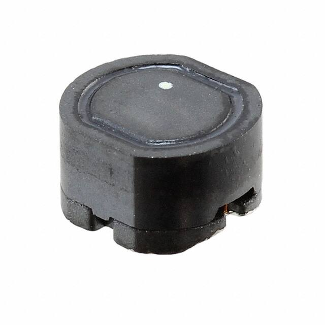

    WURTH(伍尔特)
    SMD,7.8x7mm
    固定电感器 SMD-2 100µH ±20% 950mA 467mΩ 5MHz
744787101 数据手册
Dimensions: [mm] Recommended Land Pattern: [mm] Electrical Properties: Properties 7,5 ref. 2,0 ref. 3,0 ref. Test conditions Value Unit Tol. Inductance L 100 kHz/ 250 mV 100 µH ±20% Rated Current IR ΔT = 40 K 0.95 A max. |ΔL/L| < 15 % typ. Saturation Current ISAT 0.87 A DC Resistance RDC @ 20 °C 396 mΩ typ. DC Resistance RDC @ 20 °C 467 mΩ max. Self Resonant Frequency fres 5 MHz typ. 120 V max. Operating Voltage 3,0 ref. 8,0 ref. 5,0 max. 7,8 ±0,3 Scale - 3:1 V DC Certification: RoHS Approval Compliant [2011/65/EU&2015/863] REACh Approval Conform or declared [(EC)1907/2006] Halogen Free Conform [JEDEC JS709B] Schematic: General Properties: 7,0 ±0,3 It is recommended that the temperature of the component does not exceed +125 °C under worst case conditions Ambient Temperature (referring to IR) -40 up to +85 °C Operating Temperature -40 up to +125 °C Storage Conditions (in original packaging) < 40 °C ; < 75 % RH Moisture Sensitivity Level (MSL) 1 Test conditions of Electrical Properties: +20 °C, 33 % RH if not specified differently Scale - 3:1 Product Marking: Start of Winding Marking • 101 (Inductance Code) CHECKED REVISION DATE (YYYY-MM-DD) GENERAL TOLERANCE ALa 001.005 2020-06-30 DIN ISO 2768-1m PROJECTION METHOD DESCRIPTION Würth Elektronik eiSos GmbH & Co. KG EMC & Inductive Solutions Max-Eyth-Str. 1 74638 Waldenburg Germany Tel. +49 (0) 79 42 945 - 0 www.we-online.com eiSos@we-online.com WE-PD2SR Shielded Power Inductor ORDER CODE 744787101 SIZE/TYPE BUSINESS UNIT STATUS PAGE 7845 eiSos Valid 1/6 This electronic component has been designed and developed for usage in general electronic equipment only. This product is not authorized for use in equipment where a higher safety standard and reliability standard is especially required or where a failure of the product is reasonably expected to cause severe personal injury or death, unless the parties have executed an agreement specifically governing such use. Moreover Würth Elektronik eiSos GmbH & Co KG products are neither designed nor intended for use in areas such as military, aerospace, aviation, nuclear control, submarine, transportation (automotive control, train control, ship control), transportation signal, disaster prevention, medical, public information network etc.. Würth Elektronik eiSos GmbH & Co KG must be informed about the intent of such usage before the design-in stage. In addition, sufficient reliability evaluation checks for safety must be performed on every electronic component which is used in electrical circuits that require high safety and reliability functions or performance. Typical Inductance vs. Current Characteristics: Typical Impedance Characteristics: 120.0 100000 100.0 10000 Impedance [Ω] Inductance [µH] 80.0 60.0 1000 100 40.0 10 20.0 1 0.01 0.0 0.0 0.5 1.0 Current [A] 1.5 0.1 1 10 100 Frequency [MHz] 2.0 Z CHECKED REVISION DATE (YYYY-MM-DD) GENERAL TOLERANCE ALa 001.005 2020-06-30 DIN ISO 2768-1m PROJECTION METHOD DESCRIPTION Würth Elektronik eiSos GmbH & Co. KG EMC & Inductive Solutions Max-Eyth-Str. 1 74638 Waldenburg Germany Tel. +49 (0) 79 42 945 - 0 www.we-online.com eiSos@we-online.com WE-PD2SR Shielded Power Inductor ORDER CODE 744787101 SIZE/TYPE BUSINESS UNIT STATUS PAGE 7845 eiSos Valid 2/6 This electronic component has been designed and developed for usage in general electronic equipment only. This product is not authorized for use in equipment where a higher safety standard and reliability standard is especially required or where a failure of the product is reasonably expected to cause severe personal injury or death, unless the parties have executed an agreement specifically governing such use. Moreover Würth Elektronik eiSos GmbH & Co KG products are neither designed nor intended for use in areas such as military, aerospace, aviation, nuclear control, submarine, transportation (automotive control, train control, ship control), transportation signal, disaster prevention, medical, public information network etc.. Würth Elektronik eiSos GmbH & Co KG must be informed about the intent of such usage before the design-in stage. In addition, sufficient reliability evaluation checks for safety must be performed on every electronic component which is used in electrical circuits that require high safety and reliability functions or performance. Packaging Specification - Tape and Reel: [mm] P0 D0 P2 T W1 close to center A C W B0 E2 F B N D E1 A W3 K0 Top Cover Tape D1 A P1 W2 T1 A0 T2 detail B Feeding direction End Carrier Tape Cover Tape Start B Cover Tape Chip Cavity Sprocket Hole No Component min. 160mm Components No Component min. 100mm Embossment Cover Tape min. 400mm Packaging is refered to the international standard IEC 60286-3:2013 Tape Type 2a A0 (mm) typ. 7,30 B0 (mm) typ. 8,10 W (mm) +0,3/ -0,1 16,00 T (mm) ref. 0,50 T1 (mm) max. 0,10 T2 (mm) typ. 5,10 K0 (mm) typ. 4,90 P0 (mm) ±0,1 4,00 P1 (mm) ±0,1 12,00 P2 (mm) ±0,1 2,00 D0 (mm) +0,1/ -0,0 1,50 D1 (mm) min. 1,50 E1 (mm) ±0,1 1,75 E2 (mm) min. 14,25 F (mm) ±0,1 7,50 Material Qty. (pcs.) Polystyrene 1000 165° - 180° B (mm) min. 1,50 C (mm) min. 12,80 D (mm) min. 20,20 N (mm) min. 60,00 W1 (mm) + 2,0 16,40 W2 (mm) max. 22,40 W3 (mm) min. 15,90 CHECKED REVISION DATE (YYYY-MM-DD) GENERAL TOLERANCE ALa 001.005 2020-06-30 DIN ISO 2768-1m W3 (mm) max. 19,40 Material Polystyrene/ Polyurethane PROJECTION METHOD DESCRIPTION Pull-of force Tape width A (mm) ± 2,0 330,00 16 mm 0,1 N - 1,3 N Würth Elektronik eiSos GmbH & Co. KG EMC & Inductive Solutions Max-Eyth-Str. 1 74638 Waldenburg Germany Tel. +49 (0) 79 42 945 - 0 www.we-online.com eiSos@we-online.com WE-PD2SR Shielded Power Inductor ORDER CODE 744787101 SIZE/TYPE BUSINESS UNIT STATUS PAGE 7845 eiSos Valid 3/6 This electronic component has been designed and developed for usage in general electronic equipment only. This product is not authorized for use in equipment where a higher safety standard and reliability standard is especially required or where a failure of the product is reasonably expected to cause severe personal injury or death, unless the parties have executed an agreement specifically governing such use. Moreover Würth Elektronik eiSos GmbH & Co KG products are neither designed nor intended for use in areas such as military, aerospace, aviation, nuclear control, submarine, transportation (automotive control, train control, ship control), transportation signal, disaster prevention, medical, public information network etc.. Würth Elektronik eiSos GmbH & Co KG must be informed about the intent of such usage before the design-in stage. In addition, sufficient reliability evaluation checks for safety must be performed on every electronic component which is used in electrical circuits that require high safety and reliability functions or performance. Classification Reflow Profile for SMT components: Classification Reflow Soldering Profile: Profile Feature Tp tp Max. Ramp Up Rate Max. Ramp Down Rate TL Temperature Ts max Ts min Ts min 150 °C Preheat Temperature Max Ts max 200 °C Preheat Time ts from Ts min to Ts max ts Ramp-up Rate (TL to TP) Liquidous Temperature tL Preheat Area TC –5°C Value Preheat Temperature Min 60 - 120 seconds 3 °C/ second max. TL 217 °C Time tL maintained above TL tL 60 - 150 seconds Peak package body temperature Tp Tp ≤ Tc, see Table below Time within 5°C of actual peak temperature tp 20 - 30 seconds Ramp-down Rate (TP to TL) 6 °C/ second max. Time 25°C to peak temperature 8 minutes max. refer to IPC/ JEDEC J-STD-020E tS Package Classification Reflow Temperature (Tc): Volume mm³ 350-2000 Volume mm³ >2000 PB-Free Assembly | Package Thickness 260 °C < 1.6 mm 260 °C 260 °C PB-Free Assembly | Package Thickness 260 °C 1.6 mm - 2.5 mm 250 °C 245 °C PB-Free Assembly | Package Thickness 250 °C ≥ 2.5 mm 245 °C 245 °C Properties 25 Time 25°C to Peak Time Volume mm³
744787101
1. 物料型号:WE-PD2SR Shielded Power Inductor,ORDER CODE 744787101,SIZE/TYPE 7845。
2. 器件简介:该电子元件专为一般电子设备设计和开发。产品未授权用于需要更高安全标准和可靠性标准的设备,或在产品故障合理预期会导致严重人身伤害或死亡的场合,除非双方已执行特别管理此类使用的协议。
3. 引脚分配:文档中未明确提供具体的引脚分配图或说明,但提供了推荐的焊盘图案尺寸和标记。
4. 参数特性: - 电感 (L):100KHz/250mV下为100μH,公差±20%。 - 额定电流:在40°C时为0.95A,最大值。 - 饱和电流 (SAT):在IALLI<15%条件下为0.87A,典型值。 - DC电阻 (RDc):在20°C时为396mΩ,典型值。 - DC电阻 (Roc):在20°C时为467mΩ,最大值。 - 自谐振频率:5MHz,典型值。 - 工作电压:最大120V DC。
5. 功能详解:文档中提供了关于该电感器的典型电感与电流特性图和典型阻抗特性图,展示了不同电流和频率下的电感值和阻抗。
6. 应用信息:文档中未提供具体的应用案例,但强调了该产品不适用于需要更高安全和可靠性标准的领域,如军事、航空、核控制、运输信号、医疗等,除非有特别的协议。
7. 封装信息:提供了包装规格,包括胶带和卷轴的详细尺寸,符合国际标准IEC 60286-3:2013。
