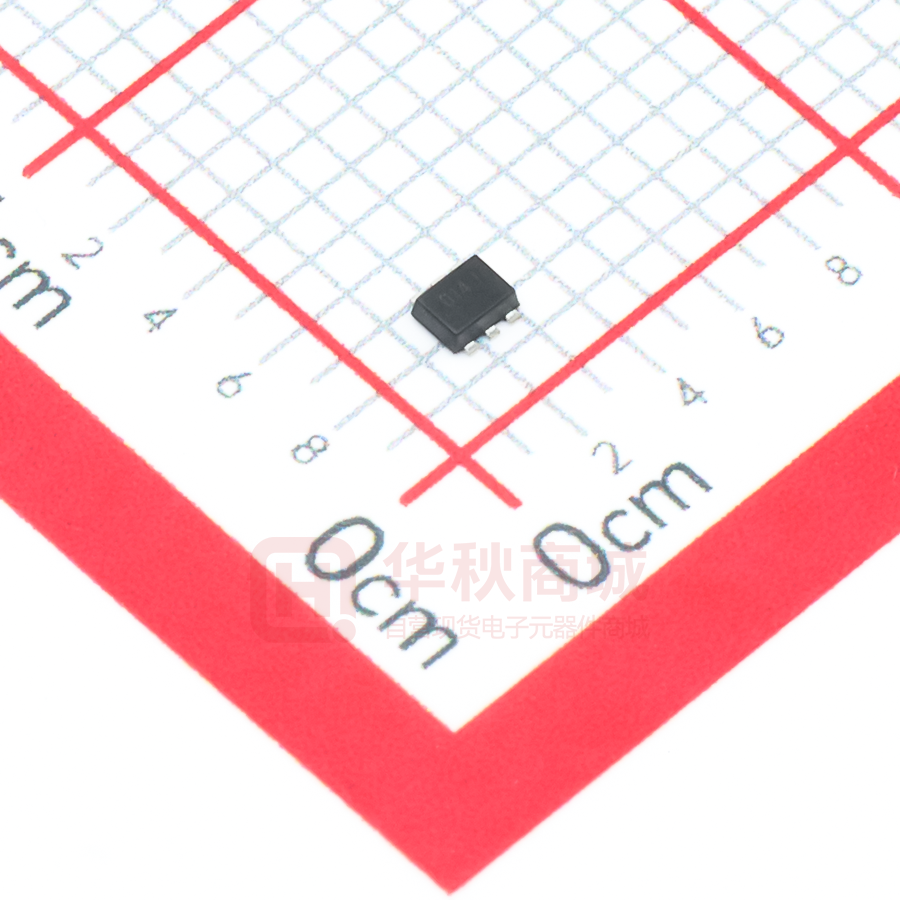

    SOT563
    TVS Ipp=6A Vdc=6V Vrwm=5V Vbv=6V Ir=5µA Vc=7.7V
82400152 数据手册
Dimensions: [mm] Recommended Land Pattern: [mm] 6 3 ESD Air Discharge Capability 0,7 0,5 0,13 0,05 max. 1,6 +0,03 -0,04 +0,05 0,55 -0,025 1,0 0,5 Schematic: VDD 5 Tol. 6 A max. IPeak EFT tp = 5/50ns 40 A max. VESD Air 15 kV max. VESD Contact 8 kV max. Channels 2+1 in positive and negative polarity in positive and negative polarity Certification: 3 1,0 I/O 1 6 Unit tp = 8/20µs 1) ESD Contact Discharge Capability 2) 1) 2) 4 1 Test conditions (Reverse) Peak Pulse Current 1,4 0,2 ± 0,1 1,6 6 0,22 ±0,05 Value IPeak (Reverse) Peak Pulse Current 0,5 1 Properties 0,3 4 0,5 ±0,05 Absolute Maximum Ratings (Ambient Temperature 25°C): RoHS Approval Compliant [2011/65/EU&2015/863] REACh Approval Conform or declared [(EC)1907/2006] Halogen Free Conform [JEDEC JS709B] Halogen Free Conform [IEC 61249-2-21] I/O 2 4 General Information: 0,55 ref. Operating Temperature -55 up to +125 °C Storage Conditions (in original packaging) < 40 °C ; < 90 % RH 1,2 Moisture Sensitivity Level (MSL) 3 Test conditions of Electrical Properties: +20 °C, 33 % RH if not specified differently VCh Clamp ESD was measured by Transmission Line Pulsing (TLP) System. TLP conditions: Z0=50Ω,tp=100ns, tr=1ns 1 I/O 1 Marking 1) 1) 3 I/O 2 Compliant: IEC 61000-4-2, -4 and -5 Flow-Thru Design:Route the data lines straight away under the TVS diode I/O pins, that the data signal will not pass through the diode. Product Marking: Pin 1 2 GND • 01XY X = Datecode; Y = Controlcode CHECKED REVISION DATE (YYYY-MM-DD) GENERAL TOLERANCE RoD 001.002 2023-05-05 DIN ISO 2768-1m PROJECTION METHOD DESCRIPTION Würth Elektronik eiSos GmbH & Co. KG EMC & Inductive Solutions Max-Eyth-Str. 1 74638 Waldenburg Germany Tel. +49 (0) 79 42 945 - 0 www.we-online.com eiSos@we-online.com WE-TVS TVS Diode – High Speed Series ORDER CODE 82400152 SIZE/TYPE BUSINESS UNIT STATUS PAGE SOT563 eiSos Valid 1/9 This electronic component has been designed and developed for usage in general electronic equipment only. This product is not authorized for use in equipment where a higher safety standard and reliability standard is especially required or where a failure of the product is reasonably expected to cause severe personal injury or death, unless the parties have executed an agreement specifically governing such use. Moreover Würth Elektronik eiSos GmbH & Co KG products are neither designed nor intended for use in areas such as military, aerospace, aviation, nuclear control, submarine, transportation, transportation signal, disaster prevention, medical, public information network etc.. Würth Elektronik eiSos GmbH & Co KG must be informed about the intent of such usage before the design-in stage. In addition, sufficient reliability evaluation checks for safety must be performed on every electronic component which is used in electrical circuits that require high safety and reliability functions or performance. Electrical Properties: Test conditions Channel Operating Voltage VCh I/O to GND DC Operating Voltage VDC VDD to GND (Reverse) Breakdown Voltage VBR I/O to GND; IBR=1mA Leakage Current ILeak VDD to GND; VDD=VDC; VGND=0V Channel (Reverse) Leakage Current ICh Leak I/O to GND VDD=VDC; VI/O=VCh; VGND= 0V Forward Voltage VF GND to I/O; IF=15mA (Channel) Input Capacitance CCh Channel to Channel Input Capacitance CCross Channel ESD Clamping Voltage Channel Surge Clamping Voltage Polarity Value min. typ. max. 5 6 Unit Tol. V V 6 120 max. 100 max. 80 V 5 µA 1 µA 0.8 1 V I/O to GND VDD=5V; VI/O=2.5V; VGND=0V; f=1MHz 2 2.5 pF between I/O pins VDD=5V; VI/O=2.5V; VGND=0V; f=1MHz 0.4 0.6 pF Derating [%] Properties Peak Pulse Power and Current Derating: 60 40 20 VCh Clamp ESD VCh Clamp IEC 61000-4-2 +8kV (TLP=16A) Contact Mode, I/O to GND 10 V I/O to GND 5A, tp = 8/20 µs 7.7 V 0 Unidirectional 0 25 50 75 100 125 150 Ambient Temperature [°C] CHECKED REVISION DATE (YYYY-MM-DD) GENERAL TOLERANCE RoD 001.002 2023-05-05 DIN ISO 2768-1m PROJECTION METHOD DESCRIPTION Würth Elektronik eiSos GmbH & Co. KG EMC & Inductive Solutions Max-Eyth-Str. 1 74638 Waldenburg Germany Tel. +49 (0) 79 42 945 - 0 www.we-online.com eiSos@we-online.com WE-TVS TVS Diode – High Speed Series ORDER CODE 82400152 SIZE/TYPE BUSINESS UNIT STATUS PAGE SOT563 eiSos Valid 2/9 This electronic component has been designed and developed for usage in general electronic equipment only. This product is not authorized for use in equipment where a higher safety standard and reliability standard is especially required or where a failure of the product is reasonably expected to cause severe personal injury or death, unless the parties have executed an agreement specifically governing such use. Moreover Würth Elektronik eiSos GmbH & Co KG products are neither designed nor intended for use in areas such as military, aerospace, aviation, nuclear control, submarine, transportation, transportation signal, disaster prevention, medical, public information network etc.. Würth Elektronik eiSos GmbH & Co KG must be informed about the intent of such usage before the design-in stage. In addition, sufficient reliability evaluation checks for safety must be performed on every electronic component which is used in electrical circuits that require high safety and reliability functions or performance. Transmission Line Pulsing (TLP) Measurement: Clamping Voltage vs. Peak Pulse Current: 18 12 16 10 14 8 Clamping Voltage [V] TLP Current [A] 12 10 8 6 6 4 4 2 Waveform Parameters: tr= 8 µs td = 20µs I/O to GND I/O to GND 2 VDD to GND 0 0 0 2 4 6 8 10 12 0 1 2 3 4 5 6 7 Peak Pulse Current [A] TLP Voltage [V] CHECKED REVISION DATE (YYYY-MM-DD) GENERAL TOLERANCE RoD 001.002 2023-05-05 DIN ISO 2768-1m PROJECTION METHOD DESCRIPTION Würth Elektronik eiSos GmbH & Co. KG EMC & Inductive Solutions Max-Eyth-Str. 1 74638 Waldenburg Germany Tel. +49 (0) 79 42 945 - 0 www.we-online.com eiSos@we-online.com WE-TVS TVS Diode – High Speed Series ORDER CODE 82400152 SIZE/TYPE BUSINESS UNIT STATUS PAGE SOT563 eiSos Valid 3/9 This electronic component has been designed and developed for usage in general electronic equipment only. This product is not authorized for use in equipment where a higher safety standard and reliability standard is especially required or where a failure of the product is reasonably expected to cause severe personal injury or death, unless the parties have executed an agreement specifically governing such use. Moreover Würth Elektronik eiSos GmbH & Co KG products are neither designed nor intended for use in areas such as military, aerospace, aviation, nuclear control, submarine, transportation, transportation signal, disaster prevention, medical, public information network etc.. Würth Elektronik eiSos GmbH & Co KG must be informed about the intent of such usage before the design-in stage. In addition, sufficient reliability evaluation checks for safety must be performed on every electronic component which is used in electrical circuits that require high safety and reliability functions or performance. Variation of CIO vs. VIO: 4.0 I/O to GND VDD = floated GND = 0V f = 1MHz 3.5 Capacitance [pF] 3.0 2.5 2.0 I/O to GND VDD = 5V GND = 0V f = 1MHz 1.5 1.0 0.5 0.0 0 1 2 3 4 5 Voltage [V] CHECKED REVISION DATE (YYYY-MM-DD) GENERAL TOLERANCE RoD 001.002 2023-05-05 DIN ISO 2768-1m PROJECTION METHOD DESCRIPTION Würth Elektronik eiSos GmbH & Co. KG EMC & Inductive Solutions Max-Eyth-Str. 1 74638 Waldenburg Germany Tel. +49 (0) 79 42 945 - 0 www.we-online.com eiSos@we-online.com WE-TVS TVS Diode – High Speed Series ORDER CODE 82400152 SIZE/TYPE BUSINESS UNIT STATUS PAGE SOT563 eiSos Valid 4/9 This electronic component has been designed and developed for usage in general electronic equipment only. This product is not authorized for use in equipment where a higher safety standard and reliability standard is especially required or where a failure of the product is reasonably expected to cause severe personal injury or death, unless the parties have executed an agreement specifically governing such use. Moreover Würth Elektronik eiSos GmbH & Co KG products are neither designed nor intended for use in areas such as military, aerospace, aviation, nuclear control, submarine, transportation, transportation signal, disaster prevention, medical, public information network etc.. Würth Elektronik eiSos GmbH & Co KG must be informed about the intent of such usage before the design-in stage. In addition, sufficient reliability evaluation checks for safety must be performed on every electronic component which is used in electrical circuits that require high safety and reliability functions or performance. Packaging Specification - Tape: [mm] A Packaging Specification - Reel: [mm] P2 P0 K0 T W3 E1 D0 W1 close to center E2 B0 A A0 D1 End A N W F D B C P1 T1 T2 Feeding direction Top Cover Tape W2 Carrier Tape Start detail B Cover Tape B Cover Tape Chip Cavity Sprocket Hole No Component min.160mm Components No Component min.100mm Embossment Cover Tape min. 400mm Tape Type Tolerance Value 2a A0 (mm) typ. 1,78 B0 (mm) typ. 1,78 W (mm) +0,3/ -0,1 8,00 T (mm) ref. 0,20 T1 (mm) ref. 0,10 T2 (mm) typ. 0,89 K0 (mm) typ. 1,69 P0 (mm) ±0,1 4,00 P1 (mm) ±0,1 4,00 P2 (mm) ±0,05 2,00 D0 (mm) +0,1/ -0,0 1,50 D1 (mm) min. 0,30 E1 (mm) ±0,1 1,75 E2 (mm) min. 6,25 F (mm) ±0,05 3,50 Material Polystyrene Qty. (pcs.) 3000 Tolerance Value A (mm) ± 2,0 178 B (mm) min. 1.5 C (mm) min. 12.8 D (mm) min. 20.2 N (mm) min. 50 W1 (mm) +1,5 8.4 W2 (mm) max. 14.4 CHECKED REVISION DATE (YYYY-MM-DD) GENERAL TOLERANCE RoD 001.002 2023-05-05 DIN ISO 2768-1m W3 (mm) min. 7.9 W3 (mm) max. 10.9 Material Polystyrene PROJECTION METHOD DESCRIPTION Würth Elektronik eiSos GmbH & Co. KG EMC & Inductive Solutions Max-Eyth-Str. 1 74638 Waldenburg Germany Tel. +49 (0) 79 42 945 - 0 www.we-online.com eiSos@we-online.com WE-TVS TVS Diode – High Speed Series ORDER CODE 82400152 SIZE/TYPE BUSINESS UNIT STATUS PAGE SOT563 eiSos Valid 5/9 This electronic component has been designed and developed for usage in general electronic equipment only. This product is not authorized for use in equipment where a higher safety standard and reliability standard is especially required or where a failure of the product is reasonably expected to cause severe personal injury or death, unless the parties have executed an agreement specifically governing such use. Moreover Würth Elektronik eiSos GmbH & Co KG products are neither designed nor intended for use in areas such as military, aerospace, aviation, nuclear control, submarine, transportation, transportation signal, disaster prevention, medical, public information network etc.. Würth Elektronik eiSos GmbH & Co KG must be informed about the intent of such usage before the design-in stage. In addition, sufficient reliability evaluation checks for safety must be performed on every electronic component which is used in electrical circuits that require high safety and reliability functions or performance. Packaging Specification - Inner Carton: [mm] Packaging Specification - Outer Carton: [mm] H IC H C ESD-Bag W W Tolerance Value LIC (mm) typ. 195,00 L IC WIC (mm) typ. 195,00 HIC (mm) typ. 92,00 C IC No. of Reel (pcs.) 4 L C Qty. (pcs.) 12000 Material Paper Tolerance Value LC (mm) typ. 405,00 WC (mm) typ. 300,00 HC (mm) typ. 215,00 No. of Inner Cartons (pcs.) Qty. (pcs.) Material 6 72000 Paper CHECKED REVISION DATE (YYYY-MM-DD) GENERAL TOLERANCE RoD 001.002 2023-05-05 DIN ISO 2768-1m PROJECTION METHOD DESCRIPTION Würth Elektronik eiSos GmbH & Co. KG EMC & Inductive Solutions Max-Eyth-Str. 1 74638 Waldenburg Germany Tel. +49 (0) 79 42 945 - 0 www.we-online.com eiSos@we-online.com WE-TVS TVS Diode – High Speed Series ORDER CODE 82400152 SIZE/TYPE BUSINESS UNIT STATUS PAGE SOT563 eiSos Valid 6/9 This electronic component has been designed and developed for usage in general electronic equipment only. This product is not authorized for use in equipment where a higher safety standard and reliability standard is especially required or where a failure of the product is reasonably expected to cause severe personal injury or death, unless the parties have executed an agreement specifically governing such use. Moreover Würth Elektronik eiSos GmbH & Co KG products are neither designed nor intended for use in areas such as military, aerospace, aviation, nuclear control, submarine, transportation, transportation signal, disaster prevention, medical, public information network etc.. Würth Elektronik eiSos GmbH & Co KG must be informed about the intent of such usage before the design-in stage. In addition, sufficient reliability evaluation checks for safety must be performed on every electronic component which is used in electrical circuits that require high safety and reliability functions or performance. Classification Reflow Profile for SMT components: Classification Reflow Soldering Profile: Profile Feature Tp tp Max. Ramp Up Rate Max. Ramp Down Rate TL Temperature Ts max tL Preheat Area Ts min TC –5°C Value Preheat Temperature Min Ts min 150 °C Preheat Temperature Max Ts max 200 °C Preheat Time ts from Ts min to Ts max ts Ramp-up Rate (TL to TP) 60 - 120 seconds 3 °C/ second max. Liquidous Temperature TL 217 °C Time tL maintained above TL tL 60 - 150 seconds Peak package body temperature Tp Tp ≤ Tc, see Table below Time within 5°C of actual peak temperature tp 20 - 30 seconds Ramp-down Rate (TP to TL) 6 °C/ second max. Time 25°C to peak temperature 8 minutes max. refer to IPC/ JEDEC J-STD-020E tS Package Classification Reflow Temperature (Tc): Volume mm³ 350-2000 Volume mm³ >2000 PB-Free Assembly | Package Thickness 260 °C < 1.6 mm 260 °C 260 °C PB-Free Assembly | Package Thickness 260 °C 1.6 mm - 2.5 mm 250 °C 245 °C PB-Free Assembly | Package Thickness 250 °C > 2.5 mm 245 °C 245 °C Properties 25 Time 25°C to Peak Time Volume mm³
