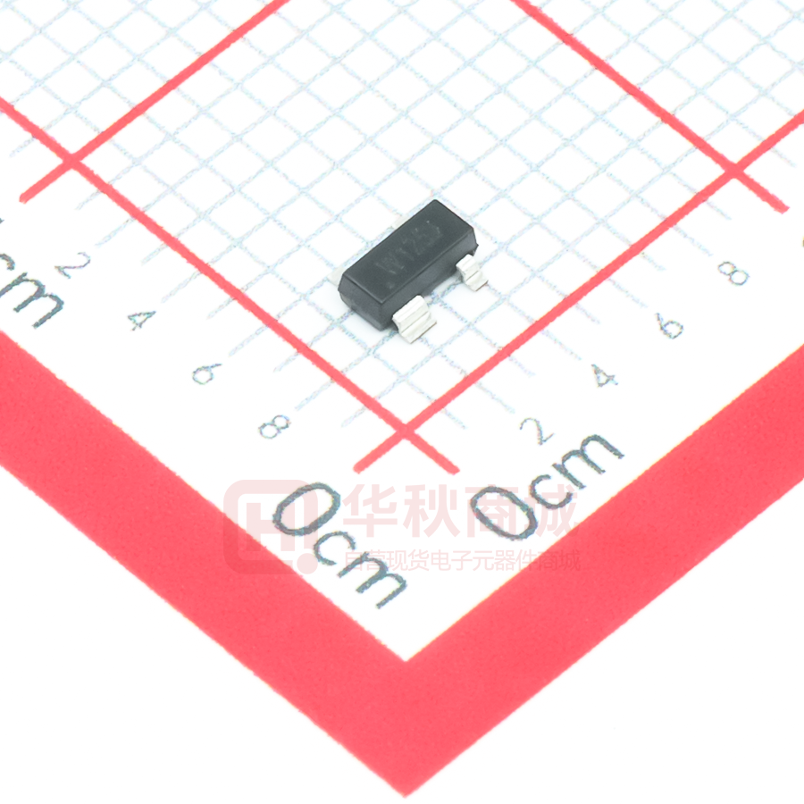

    SOT-143
    TVS二极管 VRWM=3.3 V VBR(Min)=4.5 V VC=6 V IPP=12 A Ppp=Original SOT143-4
8240136 数据手册
Specification for release Customer : Ordercode: Description: Package: 8240136 TVS Diode Array WE-TVS SOT143-4L DATUM / DATE : 2010-01-27 A Features: B Schematic and Pin Configuration: • ESD Protection for 2 high-speed I/O channels and VDD • Provide ESD protection for each channel to IEC 61000-4-2 (ESD) ±15kV (air), ±8kV (contact) IEC 61000-4-4 (EFT) 80A (5/50ns) IEC 61000-4-5 (Lightning) 12A (8/20µs) • Below 3.3V operating voltage: 2.5 - 3.3V • Low capacitance: 3pF typical VDD Mechanical Characteristics: • JEDEC SOT143-4L Package • Molding compound flamability rating: UL94V-0 • Packaging: Tape & Reel I/O 2 4 3 1 2 GND C Absolute Maximum Ratings: I/O 1 Symbol Rating Unit Peak Pulse Current (tp = 8/20µs) IPP 12 A Operating Supply Voltage, VDD to GND VDC 3.8 V VESD,IO 30 / 24 kV VESD,VDD 30 / 24 kV DC Voltage at any I/O Pin VIO (GND -0,5) to (VDD +0,5) V Operating Temperature TOp -55 to +125 °C Storage Temperature TSto -20 to +60 °C ESD per IEC 61000-4-2 (Air / Contact), I/O to GND ESD per IEC 61000-4-2 (Air / Contact), VDD to GND D Electrical Characterisitcs: Properties Test Conditions Value Value Value min typ max Unit VRWM Pin 4 to Pin 1 VBV IBV=1mA, Pin 4 to Pin 1 IR VPin5=5V, Pin 4 to Pin 1 VF IF = 15mA, Pin 1 to Pin 4 vC IPP=5A, tp=8/20µs, I/O to GND 6.0 V ITLP = 17A, I/O to GND 9.0 V vCl,IO CIO CX VPin4=4V, VPin1=0V, VIO=2.5V, f=1MHz, I/O to GND VPin4=5V, VPin1=0V, VIO=2.5V f=1MHz, between I/O pins 3.3 4.5 V V 0.6 5 µA 1 V 3.0 3.5 pF 0.4 0.6 pF Würth Elektronik eiSos GmbH & Co. KG D-74638 Waldenburg · Max-Eyth-Strasse 1 · Germany · Phone (+49) (0) 7942 - 945 - 0 · Fax (+49) (0) 7942 - 945 - 400 http://www.we-online.com PAGE 1 OF 5 Specification for release Customer : Ordercode: Description : Package: 8240136 TVS Diode Array WE-TVS SOT143-4L DATUM / DATE : 2010-01-27 120 14 80 Temp Ipp Current 0 100 4,7 6,2 25 100 12 9,4 125 20 125 0 12 Voltage 10 Clamping Voltage [V] 100 60 40 8 6 4 20 Waveform Parameters: tr= 8 µs td = 20µs 2 0 0 0 25 50 75 100 125 150 4 6 8 Ambient Temperature TA (℃) 10 12 Peak Pulse Current [A] Power Derating Curve Clamping Voltage vs. Peak Pulse Current 0,8 4,0 3,0 2,5 2,0 U C C 0 3,3 0,8 0,5 3,15 0,77 1,2 3,02 0,76 1,65 3 0,75 2,2 3,02 0,74 2,7 3,15 0,73 3,3 VDD = 3.3V 3,4 GND = 0V f = 1MHz 0,75 1,5 0,7 0,6 0,4 0,1 0,0 0,0 1,65 Variation of CIO vs. VIO 2,475 0,8 0,5 0,42 0,77 3,3 0,76 0,4 0,75 0,74 2,7 0,43 0,73 3,3 VDD = 3.3V 0,48 GND = 0V f = 1MHz 0,75 0,3 0,5 Voltage [V] C 0,45 2,2 0,2 0,825 C 0 1,65 0,5 1,0 0 U 1,2 Capacitance [pF] 3,5 Capacitance [pF] Peak Pulse Derating in % of PeakPulse Current in % E Typical Characteristics: 0 0,825 1,65 2,475 3,3 Voltage [V] Variation of CX vs. VIO Würth Elektronik eiSos GmbH & Co. KG D-74638 Waldenburg · Max-Eyth-Strasse 1 · Germany · Phone (+49) (0) 7942 - 945 - 0 · Fax (+49) (0) 7942 - 945 - 400 http://www.we-online.com PAGE 2 OF 5 Specification for release Customer : Ordercode: Description : Package: 8240136 TVS Diode Array WE-TVS SOT143-4L DATUM / DATE : 2010-01-27 E Typical Characteristic: 18,0 I/O to GND U VDD to GND 0,5 16,0 14,0 I/O to GND VDD to GND 0,1 0,1 9 0,1 0,1 9,5 0,1 0,1 4,8 0,2 9 17 Pulse 100ns TLP Current [A] 12,0 10,0 I/O start 8,0 I/O end 6,0 VDD start 4,4 0,2 VDD end 6,5 17 DUT V I Rise time: 1ns 4,0 2,0 0,0 0 2 4 6 8 10 TLP Voltage [V] Transmission Line Pulsing (TLP) Measurement Transmission Line Pulsing System F Recommended Land Layout: A A 4 C F G Body Marking: E D C1 B A 1.00 mm A1 1.40 mm B 1.40 mm C 1.90 mm C1 1.70 mm D 2.20 mm E 0.80 mm F 3.60 mm 3 W12XY 1 A1 A 2 W12: Device Code X: Date Code Y: Control Code Würth Elektronik eiSos GmbH & Co. KG D-74638 Waldenburg · Max-Eyth-Strasse 1 · Germany · Phone (+49) (0) 7942 - 945 - 0 · Fax (+49) (0) 7942 - 945 - 400 PAGE 3 OF 5 http://www.we-online.com Specification for release Customer : Ordercode: Description : Package: 8240136 TVS Diode Array WE-TVS SOT143-4L DATUM / DATE : 2010-01-27 H Dimensions: Würth Elektronik eiSos GmbH & Co. KG D-74638 Waldenburg · Max-Eyth-Strasse 1 · Germany · Phone (+49) (0) 7942 - 945 - 0 · Fax (+49) (0) 7942 - 945 - 400 http://www.we-online.com PAGE 4 OF 5 Specification for release Customer : Ordercode: Description : Package: 8240136 TVS Diode Array WE-TVS SOT143-4L I Tape: K I Feeding Direction J Pin 1 ØD E F A B C D E F G H I J K 3.15 ± 0.15 4.00 ± 0.10 8.00 ± 0.20 1.55 ± 0.05 4.00 ± 0.10 2.00 ± 0.05 1.75 ± 0.10 3.50 ± 0.05 3.25 ± 0.15 1.35 ± 0.15 0.25 ± 0.02 mm mm mm mm mm mm mm mm mm mm mm a b c d 178.0 ± 2.0 13.0 ± 0.8 10.0 ± 1.5 12.5 ± 2.0 mm mm mm mm G H A C B J Reel: b a 165° to 180° c d Quantity per Reel: 3000 General Release: .................................................................................. Date .................................................................................. Checked Customer .................................................................................. Signature Würth Elektronik .................................................................................. Approved JB Version 1 Name Modification 2010-01-27 Date This electronic component has been designed and developed for usage in general electronic equipment. Before incorporating this component into any equipment where higher safety and reliability is especially required or if there is the possibility of direct damage or injury to human body, for example in the range of aerospace, aviation, nuclear control, submarine, transportation, (automotive control, train control, ship control), transportation signal, disaster prevention, medical, public information network etc, Würth Elektronik eiSos GmbH must be informed before the design-in stage. In addition, sufficient reliability evaluation checks for safety must be performed on every electronic component which is used in electrical circuits that require high safety and reliability functions or performance. Würth Elektronik eiSos GmbH & Co. KG D-74638 Waldenburg · Max-Eyth-Strasse 1 · Germany · Phone (+49) (0) 7942 - 945 - 0 · Fax (+49) (0) 7942 - 945 - 400 http://www.we-online.com PAGE 5 OF 5
