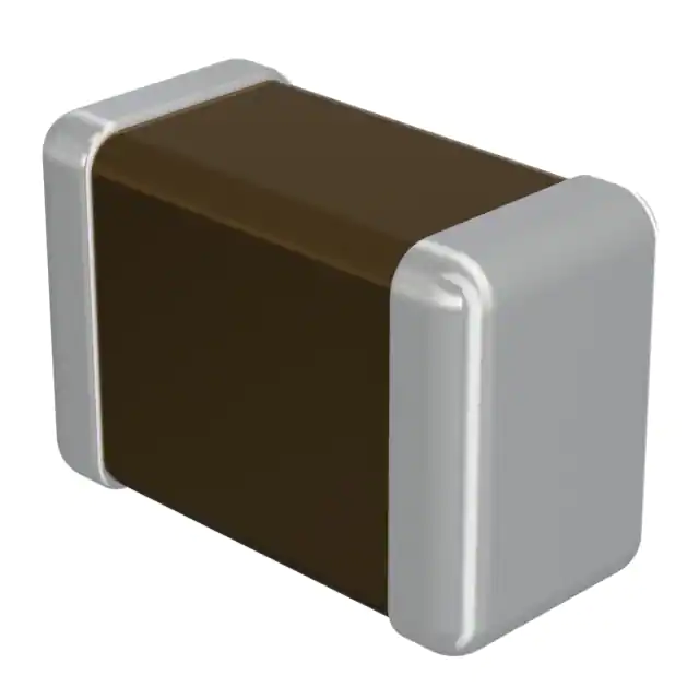

    贴片电容(MLCC) 1206 470pF ±10% 1KV X7R
885342208017 数据手册
Dimensions: [mm] Recommended Land Pattern: [mm] Electrical Properties: Properties 4,0 1,6 2,2 0,5 ±0,25 1,6 ±0,15 1,25 ±0,1 3,2 ±0,15 D A R Schematic: Würth Elektronik eiSos GmbH & Co. KG EMC & Inductive Solutions Max-Eyth-Str. 1 74638 Waldenburg Germany Tel. +49 (0) 79 42 945 - 0 www.we-online.com eiSos@we-online.com Test conditions Value Unit Tol. 470 pF ±10% 1000 V (DC) max. 1 ±0.2 VRMS, 1 kHz ±10% @25 °C Capacitance C Rated Voltage VR Dissipation Factor DF 1 ±0.2 VRMS, 1 kHz ±10% @25 °C 2.5 % max. Insulation Resistance RISO Apply 500 V for 60 s max. 10 GΩ min. T F Precondition for Class II MLCC measurement: Apply a preheat treatment @150 ±10 °C for 1 hour. The measurement should be applied after 24 ±2 hrs the part was stored under ambient conditions. There is not any precondition necessary for Class I MLCC. General Information: Mid & High Voltage MLCC Ceramic Type X7R Class II Temperature Coefficient ± 15 % max. Operating Temperature -55 up to +125 °C Storage Conditions (in original packaging) 5 °C up to + 35 °C; 10 % up to 75 % RH Moisture Sensitivity Level (MSL) Dielectric Strength 1 15 sec. @120 % VR; Charge & Discharge Current 0603 10 ±1 sec; 5 N 10 ±1 sec; 10 N Vibration Resistance all 3 directions, 2 hours each @ 10 - 50 Hz/ min., amplitude 0.75 mm or 10 g Resistance to Solder Heat Specific Refer to Soldering Profile Certification: RoHS Approval Compliant [2011/65/EU&2015/863] REACh Approval Conform or declared [(EC)1907/2006] Halogen Free Conform [JEDEC JS709B] Halogen Free Conform [IEC 61249-2-21] D A R Würth Elektronik eiSos GmbH & Co. KG EMC & Inductive Solutions Max-Eyth-Str. 1 74638 Waldenburg Germany Tel. +49 (0) 79 42 945 - 0 www.we-online.com eiSos@we-online.com T F CHECKED REVISION DATE (YYYY-MM-DD) GENERAL TOLERANCE PSL 002.000 2021-03-29 DIN ISO 2768-1m PROJECTION METHOD DESCRIPTION TECHNICAL REFERENCE WCAP-CSMH Ceramic Capacitors X7R1206471KA00DFCT10000 ORDER CODE 885342208017 SIZE/TYPE BUSINESS UNIT STATUS PAGE 1206 eiCap Valid from 2021-03-29 due to PCN 2/8 This electronic component has been designed and developed for usage in general electronic equipment only. This product is not authorized for use in equipment where a higher safety standard and reliability standard is especially required or where a failure of the product is reasonably expected to cause severe personal injury or death, unless the parties have executed an agreement specifically governing such use. Moreover Würth Elektronik eiSos GmbH & Co KG products are neither designed nor intended for use in areas such as military, aerospace, aviation, nuclear control, submarine, transportation (automotive control, train control, ship control), transportation signal, disaster prevention, medical, public information network etc.. Würth Elektronik eiSos GmbH & Co KG must be informed about the intent of such usage before the design-in stage. In addition, sufficient reliability evaluation checks for safety must be performed on every electronic component which is used in electrical circuits that require high safety and reliability functions or performance. Tape Type 2a A0 (mm) typ. 2,00 B0 (mm) typ. 3,70 W (mm) +0,3/ -0,1 8,00 T (mm) ref. 0,23 T1 (mm) ref. 0,10 T2 (mm) typ. 2,91 K0 (mm) typ. 2,50 P0 (mm) ±0,1 4,00 P1 (mm) ±0,1 4,00 P2 (mm) ±0,05 2,00 D0 (mm) +0,1/ -0,0 1,50 D1 (mm) min. 0,30 E1 (mm) ±0,1 1,75 E2 (mm) min. 6,25 F (mm) ±0,05 3,50 Material Qty. (pcs.) Polycarbonate 3000 Packaging Specification - Reel: [mm] W3 A D T F N B W1 close to center C 165° - 180° D A R Pull-of force Tape width 8 mm 0,1 N - 1,0 N Würth Elektronik eiSos GmbH & Co. KG EMC & Inductive Solutions Max-Eyth-Str. 1 74638 Waldenburg Germany Tel. +49 (0) 79 42 945 - 0 www.we-online.com eiSos@we-online.com W2 detail B B Cover Tape Chip Cavity Sprocket Hole Embossment A (mm) ± 2,0 178 B (mm) min. 1.5 C (mm) min. 12.8 D (mm) min. 20.2 N (mm) min. 50 W1 (mm) +1,5 8.4 W2 (mm) max. 14.4 CHECKED REVISION DATE (YYYY-MM-DD) GENERAL TOLERANCE PSL 002.000 2021-03-29 DIN ISO 2768-1m W3 (mm) min. 7.9 W3 (mm) max. 10.9 Material Polystyrene PROJECTION METHOD DESCRIPTION TECHNICAL REFERENCE WCAP-CSMH Ceramic Capacitors X7R1206471KA00DFCT10000 ORDER CODE 885342208017 SIZE/TYPE BUSINESS UNIT STATUS PAGE 1206 eiCap Valid from 2021-03-29 due to PCN 3/8 This electronic component has been designed and developed for usage in general electronic equipment only. This product is not authorized for use in equipment where a higher safety standard and reliability standard is especially required or where a failure of the product is reasonably expected to cause severe personal injury or death, unless the parties have executed an agreement specifically governing such use. Moreover Würth Elektronik eiSos GmbH & Co KG products are neither designed nor intended for use in areas such as military, aerospace, aviation, nuclear control, submarine, transportation (automotive control, train control, ship control), transportation signal, disaster prevention, medical, public information network etc.. Würth Elektronik eiSos GmbH & Co KG must be informed about the intent of such usage before the design-in stage. In addition, sufficient reliability evaluation checks for safety must be performed on every electronic component which is used in electrical circuits that require high safety and reliability functions or performance. HIC (mm) typ. 180,00 D No. of Reel (pcs.) Qty. (pcs.) Material 10 30000 Paper A R Würth Elektronik eiSos GmbH & Co. KG EMC & Inductive Solutions Max-Eyth-Str. 1 74638 Waldenburg Germany Tel. +49 (0) 79 42 945 - 0 www.we-online.com eiSos@we-online.com Packaging Specification - Outer Carton: [mm] T F C WIC (mm) typ. 180,00 H LIC (mm) typ. 120,00 W C LC (mm) typ. 393,00 WC (mm) typ. 393,00 HC (mm) typ. 203,00 L C No. of Inner Carton (pcs.) Qty. (pcs.) Material 6 180000 Paper CHECKED REVISION DATE (YYYY-MM-DD) GENERAL TOLERANCE PSL 002.000 2021-03-29 DIN ISO 2768-1m PROJECTION METHOD DESCRIPTION TECHNICAL REFERENCE WCAP-CSMH Ceramic Capacitors X7R1206471KA00DFCT10000 ORDER CODE 885342208017 SIZE/TYPE BUSINESS UNIT STATUS PAGE 1206 eiCap Valid from 2021-03-29 due to PCN 4/8 This electronic component has been designed and developed for usage in general electronic equipment only. This product is not authorized for use in equipment where a higher safety standard and reliability standard is especially required or where a failure of the product is reasonably expected to cause severe personal injury or death, unless the parties have executed an agreement specifically governing such use. Moreover Würth Elektronik eiSos GmbH & Co KG products are neither designed nor intended for use in areas such as military, aerospace, aviation, nuclear control, submarine, transportation (automotive control, train control, ship control), transportation signal, disaster prevention, medical, public information network etc.. Würth Elektronik eiSos GmbH & Co KG must be informed about the intent of such usage before the design-in stage. In addition, sufficient reliability evaluation checks for safety must be performed on every electronic component which is used in electrical circuits that require high safety and reliability functions or performance. Classification Reflow Profile for SMT components: Classification Reflow Soldering Profile: Profile Feature Tp tp Max. Ramp Up Rate Max. Ramp Down Rate TL Temperature Ts max Ts min 150 °C Preheat Temperature Max Ts max 200 °C Preheat Time ts from Ts min to Ts max Time tL maintained above TL 3 °C/ second max. T F TL 217 °C tL 60 - 150 seconds Tp Tp ≤ Tc, see Table below Time within 5°C of actual peak temperature tp 20 - 30 seconds 6 °C/ second max. Time 25°C to peak temperature refer to IPC/ JEDEC J-STD-020E tS 60 - 120 seconds Peak package body temperature Ramp-down Rate (TP to TL) Ts min ts Ramp-up Rate (TL to TP) Liquidous Temperature tL Preheat Area TC –5°C Value Preheat Temperature Min A R 8 minutes max. Package Classification Reflow Temperature (Tc): Volume mm³ 350-2000 Volume mm³ >2000 PB-Free Assembly | Package Thickness 260 °C < 1.6 mm 260 °C 260 °C PB-Free Assembly | Package Thickness 260 °C 1.6 mm - 2.5 mm 250 °C 245 °C PB-Free Assembly | Package Thickness 250 °C > 2.5 mm 245 °C 245 °C Properties 25 Time 25°C to Peak Time D Volume mm³
