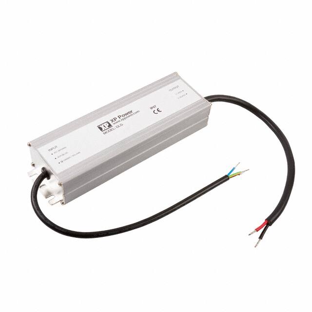

    700mA 50 ~ 100 V Constant Current LED Driver AC DC Converter Topology 1 Output
DLG70PS700-A 数据手册
AC-DC 70-150 Watts xppower.com DLG-HV Series • AC Input LED Driver • Constant Current Operation • High Power Factor • High Efficiency • Water Proof to IP67 • 90-305 VAC Input Voltage Range • 3 Year Warranty Specification Input General • 90-305 VAC, see derating curve • 47-63 Hz • 70 W: 1.2 A at 115 VAC, 0.6 A at 230 VAC, 100 W: 1.4 A at 115 VAC, 0.7 A at 230 VAC, 150 W: 2.0 A at 115 VAC, 1.0 A at 230 VAC Inrush Current • 65 A at 230 VAC, cold start +25 °C Power Factor • >0.94 at 230 VAC, full load Earth Leakage Current • 750 µA max at 230 VAC Input Protection • DLG70/100 T2.0A/300V fuse fitted in line, DLG150 T3.5A/300V fuse fitted in line Input Voltage Input Frequency Input Current Output See table No minimum load required 2 s max at 240 VAC ±0.5% ±5.0% of nominal output current 5% max 5% maximum deviation, recovery to within 1% in 10 ms for a 50% load change Ripple & Noise • DLG70: 700 mV DLG100: 1000 mV DLG150: 2000 mV (see note 2) Overvoltage Protection • 110-142%, recycle mains to reset Overtemperature • Unit shuts down, recycle mains to reset Protection Overload Protection • 105% maximum, auto recovery Short Circuit Protection • Trip and restart (hiccup mode) Temperature • 0.04%/°C Coefficient Output Voltage Minimum Load Start Up Delay Line Regulation Load Regulation Turn On Overshoot Transient Response • • • • • • • Efficiency Isolation Switching Frequency MTBF • See table • 3750 VAC Input to Output 1880 VAC Input to Ground 500 VAC Output to Ground • DLG50/70: 40-80 kHz DLG100/150: PWM 60-80 kHz, PFC 55-133 kHz • >200 kHrs to MIL-HDBK-217F at 25 °C, GB Environmental Operating Temperature Operating Humidity Storage Temperature Operating Altitude Vibration • • • • • -30 °C to +70 °C (see derating curve) 5-100% RH, non-condensing -40 °C to +80 °C 3000 m 10-500 Hz, 2 g, 10 mins/cycle, 6 cycles in each of 3 axes EMC & Safety Emissions Harmonic Currents Voltage Flicker ESD Immunity Radiated Immunity EFT/Burst Surge Conducted Immunity Dips & Interruptions Safety Approvals • EN55015, class B conducted and radiated • EN61000-3-2, class A EN61000-3-2, class C for loads >80% • EN61000-3-3 • EN61000-4-2, 8 kV air and 4 kV contact, Perf Criteria A • EN61000-4-3, level 2 Perf Criteria B • EN61000-4-4, level 2 Perf Criteria B • EN61000-4-5, installation class 3, Perf Criteria B • EN61000-4-6, level 2 Perf Criteria A • EN61547, >95% 10 ms, 30% 200 ms, Perf Criteria B, B for 70/100 W, A, A for 150 W • EN61347, UL8750, CE Mark AC-DC DLG70-150-HV Models and Ratings Output Power Output Voltage Output Current Efficiency(1) Model Number 70 W 100 W 100 W 100 W 150 W 150 W 150 W 150 W 150 W 50 - 100 V 100 - 142 V 100 - 142 V 50 - 71 V 120 - 428 V 115 - 284 V 60 - 210 V 60 - 143 V 30 - 107 V 700 mA 700 mA 800 mA 1400 mA 350 mA 530 mA 700 mA 1050 mA 1400 mA 90.0% 91.0% 91.0% 91.0% 92.0% 92.0% 92.0% 92.0% 91.0% DLG70PS700-A DLG100PS700-A DLG100PS800-A DLG100PS1400-A DLG150PS350-A DLG150PS530-A DLG150PS700-A DLG150PS1050-A DLG150PS1400-A Notes 1. Typical efficiency at full load and 240 VAC input. 2. Measured using 12” twisted pair with 0.1 µF and 47 µF capacitors in parallel at 20 MHz bandwidth. Mechanical Details A B H D C F 4-R2.3 (DLG70/100) 4-R2.1 (DLG150) AC IN E ACL DC OUT V+ (RED) ACN V- (BLACK) 18 AWGx2C (DLG70/100 and DLG150PS350-A) 16 AWGx2C (All other DLG150) 18AWGx3C F 11.81±0.79 (300±20) 11.81±0.79 (300±20) G ACL = Brown wire ACN = Blue wire A B C D E F G H = Green/Yellow wire DLG70/100 DLG150 7.80 (198.0) 7.38 (187.4) 6.07 (177.0) 2.24 (57.0) 1.20 (30.6) 0.26 (6.7) 1.46 (37.0) 0.21 (5.3) 8.90 (226.0) 8.35 (212.0) 8.00 (203.2) 2.68 (68.0) 1.35 (34.2) 0.35 (8.9) 1.54 (39.0) 0.28 (7.0) Notes 1. All dimensions shown in inches (mm). 2. Weight: DLG70/100: 1.65 lbs (750 g), DLG150: 2.29 lbs (1040 g) 3. Tolerance: ±0.02 (0.5) Application Notes Derating Curve 100 A 100 B 60 40 80 A DLG70/100 B DLG150 Load (%) Load (%) 80 20 0 -30 60 40 20 0 10 20 30 Ambient Temp (˚C) 40 50 55 60 70 0 90 100 305 Input Voltage (VAC) 23-Dec-14
