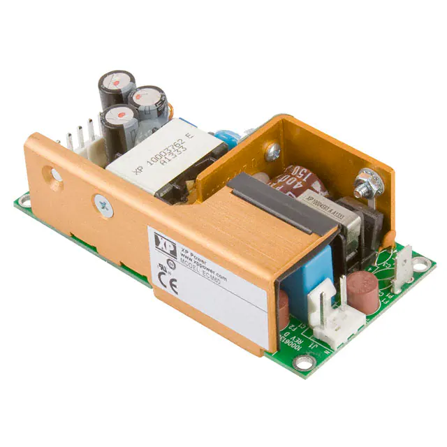

ECM40-60 • 40 & 60 Watt Models • Small Size 2.0”x 4.0”x 1.2” • Low Leakage Current • Industrial & Medical Approvals • Full Load Available Convection Cooled • Wide Operating Temperature 0 °C to +70 °C • Level B Conducted Emissions • EN61000 Compliant • Universal AC Input 90-264 VAC • Input Frequency 47-63 & 440 Hz • Single & Multiple Outputs • Cover Kits Available • Mating Connector & Loom Kits Available Approved for Class I and Class II applications, the ECM range of single and multiple output AC-DC, 40-60 W power supplies from XP feature the world's smallest footprint for units of these ratings. Both are just 2" x 4" (50.8 mm x 101.6 mm) and 1.2" (30.48 mm) high. Furthermore, these high-density power supplies meet EN55032 Level B conducted emissions with maximum leakage currents of 100 µA at 115 VAC or 200 µA at 230 VAC. As a result, these switchers are equally suitable for industrial, IT and medical applications, with no price premium for meeting medical requirements. The ECM40-60 series have single output versions from 5 V to 48 VDC, adjustable by ±10%, and dual and triple output versions covering combinations of 3.3 V, 5 V, 12 V, 15 V and 24 V. They are dual-fused for compliance with IEC60601-1 and efficiency is 80-85%, depending upon the model, so minimal excess heat is generated. The power supplies deliver full power between 0 °C and +50 °C and will operate at up to +70 °C with derating and only 5 CFM of cooling. Comprehensive overvoltage, overload and short circuit protection is built in. Covers, looms and connector kits are available. xppower.com Input Characteristics Characteristic Input Voltage - Operating Input Frequency Input Current - No load Input Current - Full load Inrush Current Power Factor Earth Leakage Current Input Protection Minimum 90 47 Typical 50/60 Maximum 264 63 41 1.38 40 Units VAC Hz mA A A 290 µA 0.62 Notes & Conditions 120-370 VDC 400 Hz operation available 230 VAC 90 VAC Cold start at 230 VAC 230 VAC 264 VAC T3.15 A/ 250 V internal fuse in line & neutral All specifications are at nominal input, full resistance load at 25°C unless otherwise stated. Output Characteristics Characteristic Output Voltage Initial Set Accuracy Output Voltage Trim Minimum load Start Up Delay Start Up Rise Time Hold Up Time Drift Line Regulation Load Regulation Minimum Typical 5.0 Maximum Units Notes & Conditions 48.0 V1: ±1, V2 & V3: ±5 See modules table 1.5 10 75 ±0.2 ±0.5 ±1.0 V1: ±3, V2 & V3: ±5 VDC % % A s ms ms % % % % 4 % 1 135 170 %pk-pk VDC % Imax 0.05 %/ºC ±10 V1: 0.5, V2: 0.1 16 Transient Response Ripple & Noise Overvoltage Protection Overload Protection Short Circuit Protection Temperature Coefficient 115 110 V1 (V2 will track V1 by the same %) Not required on single output models 90 VAC 115-230 VAC input 90-264 VAC Single output Dual output Output voltage recovers to within 1% in less than 500 µs for 50% load change. 20 MHz bandwidth Recycle input to reset Auto-recovery Trip & restart (hiccup mode) General Specifications Characteristic Efficiency Isolation Voltage Switching Frequency Power Density Weight MTBF 2 Minimum Typical Maximum 70 80 75 Units % (at 230 VAC full load) 4000 1500 500 70 VAC 6.25 0.33 (150) 600 kHz W/In3 lbs (g) kHrs Notes & Conditions 3.3 & 5 V single output versions All other single output versions Dual output versions Input to output Input to ground Output to ground Fixed For 60 W version Mil HDBK 217F xppower.com Environmental Characteristic Operating Temperature Storage Temperature Cooling Operating Humidity Operating Altitude Shock Vibration Minimum Typical Maximum Units Notes & Conditions +70 +85 ºC ºC CFM % RH m Gpk G See derating curves -0 -40 0 95 3000 30 2 Convection-cooled Non- condensing Half sine 6 axis 5-500 Hz 3 axis Electromagnetic Compatibility & Immunity Standard Test Level EN55032 Emissions Criteria EN55032 Class A Radiated EN60601-1-2 Class B Conducted Harmonic Currents EN61000-3-2 Voltage Flicker EN61000-3-3 ESD Immunity EN61000-4-2 level 2, performance criteria A Radiated Immunity EN61000-4-3 10 V/m, performance criteria A EFT/Burst EN61000-4-4 level 2, performance criteria A Surge EN61000-4-5 level 3, performance criteria A Conducted Immunity EN61000-4-6 10 Vrms, performance criteria A 70% UT : performance criteria A Dips & Interruptions Dips & Interruptions EN61000-4-11 EN61000-4-11 (Medical) Notes & Conditions Class B Conducted For 10 ms, 100% load 40% UT : performance criteria B For 100 ms, 100% load 0% UT : performance criteria B For 5000 ms, 100% load 70% Ut, performance criteria A For 500 ms, Medical, 100% load 40% Ut, performance criteria A For 100 ms, Medical, 60% load 0% Ut, performance criteria A For 10 ms, Medical, 100% load 0% Ut, performance criteria B For 5000 ms, Medical, 100% load Safety Approvals Safety Agency CB Report UL TUV CE Safety Agency CB Report UL TUV Primary to Secondary Primary to Earth Safety Standard IEC60950-1:2005 Ed 2 / IEC62368-1:2014 UL 62368-1 & CAN/CSA C22.2 No. 62368-1-14 EN62368-1:2014/A11:2017 LVD Safety Standard Certificate #US/18293 & 18269/UL, IEC60601-1 Ed 3 Including Risk Management UL File # E146893, ANSI/AAMI ES 60601-1:2005 & CSA C22.2 No. 60601-1:08 TUV Certificate # B12 01 57396 125, EN60601-1:2006 Means of Protection 1 x MOPP (Means of Patient Protection) Contact Sales for 2 x MOPP 1 x MOPP (Means of Patient Protection) Category Information Technology Information Technology Information Technology Category Medical Medical Medical Category IEC60601-1 Ed 3 Equipment Protection Class Safety Standard Notes & Conditions Class I & Class II IEC60950-1:2005 Ed 2 / IEC62368-1:2014 See safety agency conditions of acceptability for details 3 xppower.com Models & Ratings Max Power 40 W Max Power 60 W V1 5.0 V 7.0 V 9.0 V 12.0 V 15.0 V 18.0 V 24.0 V 33.0 V 48.0 V +5.0 V +5.0 V +5.0 V +5.0 V +5.0 V +3.3 V +5.0 V V1 5.0 V 7.0 V 9.0 V 12.0 V 15.0 V 18.0 V 20.0 V 24.0 V 28.0 V 33.0 V 48.0 V +5.0 V +5.0 V +5.0 V +5.0 V +5.0 V +3.3 V +5.0 V Imin/Imax(3) 0.0 A / 8.0 A 0.0 A / 5.7 A 0.0 A / 4.4 A 0.0 A / 3.5 A 0.0 A / 2.7 A 0.0 A / 2.2 A 0.0 A / 1.7 A 0.0 A / 1.2 A 0.0 A / 0.9 A 0.5 A / 6.0 A 0.5 A / 6.0 A 0.5 A / 6.0 A 0.5 A / 6.0 A 0.5 A / 6.0 A 0.5 A / 6.0 A 0.5 A / 6.0 A Imin/Imax(3) 0.0 A / 12.00 A 0.0 A / 8.60 A 0.0 A / 6.70 A 0.0 A / 5.00 A 0.0 A / 4.00 A 0.0 A / 3.30 A 0.0 A / 3.00 A 0.0 A / 2.50 A 0.0 A / 2.14 A 0.0 A / 1.80 A 0.0 A / 1.25 A 0.5 A / 8.00 A 0.5 A / 8.00 A 0.5 A / 8.00 A 0.5 A / 8.00 A 0.5 A / 8.00 A 0.5 A / 8.00 A 0.5 A / 8.00 A V2 Outputs Imin/Imax V3 +12.0 V +15.0 V +12.0 V +24.0 V +15.0 V +5.0 V +3.3 V 0.1 0.1 0.1 0.1 0.1 0.1 0.1 -12.0 V -12.0 V -15.0 V +12.0 V +12.0 V V2 +12.0 V +15.0 V +12.0 V +24.0 V +15.0 V +5.0 V +3.3 V A A A A A A A / / / / / / / 2.0 1.5 2.0 1.0 1.5 1.5 1.5 Outputs Imin/Imax 0.1 0.1 0.1 0.1 0.1 0.1 0.1 A A A A A A A / / / / / / / 3.0 2.5 3.0 1.5 2.5 1.5 1.5 A A A A A A A A A A A A A A Imin/Imax 0.0 0.0 0.0 0.0 0.0 V3 -12.0 V -12.0 V -15.0 V +12.0 V +12.0 V 0.0 0.0 0.0 0.0 0.0 Notes 4 *Available from Newark InOne. / / / / / 0.5 0.5 0.5 0.5 0.5 A A A A A Imin/Imax 1. V2 will track a change in V1 by the same percentage change in voltage as V1 is trimmed. 2. To receive unit with cover fitted, add suffix ‘-C’ to model number. For Class I operation only. 3. A 120% peak load can be taken for up to 100 ms with a 25% duty cycle. Average load not to exceed maximum power rating. † Available from Farnell InOne. A A A A A A A A A A / / / / / 0.5 0.5 0.5 0.5 0.5 A A A A A Model Number ECM40US05†* ECM40US07 ECM40US09* ECM40US12†* ECM40US15†* ECM40US18 ECM40US24†* ECM40US33 ECM40US48†* ECM40UD21 ECM40UD22 ECM40UT31†* ECM40UT32† ECM40UT33†* ECM40UT34†* ECM40UT35† Model Number ECM60US05†* ECM60US07 ECM60US09* ECM60US12†* ECM60US15†* ECM60US18 ECM60US20 ECM60US24†* ECM60US28 ECM60US33 ECM60US48†* ECM60UD21 ECM60UD22 ECM60UT31†* ECM60UT32† ECM60UT33†* ECM60UT34†* ECM60UT35† xppower.com Thermal Derating Curves All ECM40 models with 5 CFM 100% 100% 75% 75% Output Power Output Power All ECM40 models convection-cooled 50% 25% 50% 25% 0% 0% 0 10 20 30 40 50 60 Ambient Temp (°C) 70 0 80 30 20 50 40 60 80 70 Ambient Temp (°C) Note: Derate by 10% if cover is fitted All ECM60 models convection-cooled All ECM60 models with 5 CFM 100% Output Power 100% Output Power 10 75% 50% 25% 75% 50% 25% 0% 0% 0 10 20 30 40 Ambient Temp (°C) 50 60 70 80 0 Note: Derate by 10% if cover is fitted 10 20 30 40 50 60 70 80 Ambient Temp (°C) Transient Response ECM60US24 25% load change 5 xppower.com Efficiency Versus Input Voltage ECM60US24 with 60 W load ECM60UT33 with 50 W load Efficiency Versus Output Load ECM60US24 at 230 VAC input 6 ECM60UT33 at 230 VAC input xppower.com Start Up Delay ECM60US24 with 60 W load ECM60UT33 with 60 W load Hold Up Tme ECM60US24 with 60 W load at 230 VAC Overload Characteristics ECM60US24. When current reaches 5.4 A, output goes into trip and restart (hiccup) mode 7 xppower.com Ripple & Noise 8 ECM60US24 with 60 W load Noise measured is 64 mV pk-pk ECM60UT33 output 1 with 30 W load. Noise measured is 36 mV pk-pk ECM60UT33 output 2 with 15 W load. Noise measured is 68 mV pk-pk ECM60UT33 output 3 with 7 W load. Noise measured is 34 mV pk-pk xppower.com Conducted Noise ECM60US24 at full load ECM60UT33 at full load 9 xppower.com Mechanical Details - Single Output Models Weight: approx. 0.33 lb (150g) 1.20 (30.5) 4.00 (101.6) 3.75 (95.25) CR2 J1 1 2 2.00 (50.8) 1 1.75 (44.45) T1 J2 C4 L1 0.25 x 0.32 faston ground tab 4X ø0.156 (3.96) mounting holes ø0.312 (7.92) clearance top and bottom Input Connector J1 Pin 1 Line Pin 2 Neutral J1 mates with Molex housing 43061-0003 and Molex series 5194 crimp terminals. Ground (0.25 faston) tab standard. V Adj. 6 0.14 (3.5) SMD component height Output Connector J2 Single Pin 1 +V1 2 +V1 3 RTN 4 RTN 5 N.C. 6 N.C. J2 mates with Molex housing 43061-0006 & Molex series 5194 crimp terminals. Notes 1. All dimensions in inches (mm). Tolerance .xx = ±0.02 (0.50); .xxx = ±0.01 (0.25) 2. Cable harnesses with 300mm wire available. For single output models, order part number ECM40/60S LOOM. For multi-output models, order part number ECM40/60DT LOOM . 3. Mating connector kit available. Order part number ECM40/60 CONKIT. 4. Covers available. Order part number ECM40/60 COVER. Cover dimensions are 4.49 x 2.52 x 1.52 (114 x 64 x 38.5) 5. † All accessories available from Farnell InOne. Thermal Considerations To ensure correct and safe operation of the PSU, the temperature of the components listed in the table below must not be exceeded. See mechanical details for component locations. Component L1 T1 CR2 C4 10 Maximum Temperature 110 °C 110 °C 120 °C 95 °C xppower.com Mechanical Details - Single Output Models (3 x 5) Weight: approx. 0.4 lb (180 g) 1.20 (30.5) 0.14 (3.6), SMD Component Height 5.00 (127.0) 0.22 (5.71) 1 4.55 (115.57 N L J2 J1 3.00 (76.2) 6 2.55 (64.7) P1 0.22 (5.71) 0.25 (6.35) Faston Ground Tab, Optional 4 x ø0.156 (3.96) Mounting Holes ø0.312 (7.92) Clearance Top & Bottom Input Connector J1 Pin 1 Line Pin 2 Neutral J1 mates with Molex housing 43061-0003 and Molex series 5194 crimp terminals. Ground (0.25 faston) tab standard. Output Connector J2 Single Pin 1 +V1 2 +V1 3 RTN 4 RTN 5 N.C. 6 N.C. J2 mates with Molex housing 43061-0006 & Molex series 5194 crimp terminals. Notes 1. All dimensions in inches (mm). Tolerance .xx = ±0.02 (0.50); .xxx = ±0.01 (0.25) 2. Cable harnesses with 300mm wire available. For single output models, order part number ECM40/60S LOOM. For multi-output models, order part number ECM40/60DT LOOM . 3. Mating connector kit available. Order part number ECM40/60 CONKIT. 4. Covers available. Order part number ECM40/60 COVER. Cover dimensions are 4.49 x 2.52 x 1.52 (114 x 64 x 38.5) 5. † All accessories available from Farnell InOne. Thermal Considerations To ensure correct and safe operation of the PSU, the temperature of the components listed in the table below must not be exceeded. See mechanical details for component locations. Component L1 T1 CR2 C4 Maximum Temperature 110 °C 110 °C 120 °C 95 °C 11 xppower.com Mechanical Details - Multi Output Models Weight: approx. 0.33 lb (150g) 1.20 (30.5) 4.00 (101.6) CR2 3.75 (95.25) J1 2 2.00 (50.8) 1 1 1.75 (44.45) T1 C4 L1 6 4X ø0.156 (3.96) mounting holes ø0.312 (7.92) clearance top and bottom Input Connector J1 Pin 1 Line Pin 2 Neutral J1 mates with Molex housing 43061-0003 and Molex series 5194 crimp terminals. Ground (0.25 faston) tab standard. J2 0.14 (3.5) SMD component height Output Connector J2 Single Pin 1 +V1 2 +V1 3 RTN 4 RTN 5 -V3 6 +V2 J2 mates with Molex housing 43061-0006 & Molex series 5194 crimp terminals. Notes 1. All dimensions in inches (mm). Tolerance .xx = ±0.02 (0.50); .xxx = ±0.01 (0.25) 2. Cable harnesses with 300mm wire available. For single output models, order part number ECM40/60S LOOM. For multi-output models, order part number ECM40/60DT LOOM . 3. Mating connector kit available. Order part number ECM40/60 CONKIT. 4. Covers available. Order part number ECM40/60 COVER. Cover dimensions are 4.49 x 2.52 x 1.52 (114 x 64 x 38.5) 5. † All accessories available from Farnell InOne. Thermal Considerations To ensure correct and safe operation of the PSU, the temperature of the components listed in the table below must not be exceeded. See mechanical details for component locations. Component L1 T1 CR2 C4 12 Maximum Temperature 110 °C 110 °C 120 °C 95 °C 17 Feb 20 ECM100 Series • 100 Watt Models • Small Size 2.5” x 4.5” x 1.2” • Low Leakage Current • Industrial & Medical Approvals • Convection & Force Cooled Ratings • Wide Operating Temperature 0 °C to +70 °C • Level B Conducted Emissions • EN61000 Compliant • Universal AC Input 90-264 VAC • Input Frequency 47-63 & 440 Hz • Cover Kits Available • Mating Connector & Cable Harness Kits Available Approved for Class I and Class II applications, the ECM100 range of single output AC-DC, 100 W power supplies from XP feature the world's smallest footprint for units of these ratings. Size is just 2.5" x 4.5" (63.5 mm x 114.3 mm) and 1.2" (30.48 mm) high. Furthermore, these high-density power supplies meet EN55032 Level B conducted emissions with maximum leakage currents of 125 µA at 115 VAC or 210 µA at 230 VAC. As a result, these switchers are equally suitable for industrial, IT and medical applications, with no price premium for meeting medical requirements. The ECM100 series have single output versions from 3.3 V to 48 VDC, adjustable by ±10%. They are dual-fused for compliance with IEC60601-1 and efficiency is 80-85%, depending upon the model, so minimal excess heat is generated. The power supplies deliver full power between 0 °C and +50 °C and will operate at up to +70 °C with derating and only 5 CFM of cooling. Comprehensive overvoltage, overload and short circuit protection is built in. Covers, cable harnesses and connector kits are available. xppower.com Input Characteristics Charactristic Input Voltage - Operating Input Frequency Power Factor Input Current - No Load Input Current - Full Load Inrush Current Earth Leakage Current Input Protection Minimum 90 47 Typical Minimum Typical 50/60 0.62 40 0.9 Maximum 264 63 Units VAC Hz Notes & Conditions 120-370 VDC 400 Hz operation available 230 VAC mA 230 VAC A 230 VAC 40 A 230 VAC cold start 125/210 µA 115/230 VAC T3.15 A/250 V internal fuse in both line and neutral Output Characteristics Charactristic Output Voltage Initial Set Accuracy Output Voltage Adjustment Minimum Load Start Up Delay Start Up Rise Time Hold Up Time Drift Line Regulation 3.3 Units Notes & Conditions 48.0 V1: ±1. V2,V3 & V4: ±5 VDC % See Models and Ratings Table ±5 ±10 % 1.5 50 75 ±0.2 ±0.5 ±1 V1 & V2: ±1. V3 & V4: ±5 16 Load Regulation Transient Response Ripple & Noise Overvoltage Protection Overload Protection Short Circuit Protection Temperature Coefficient Maximum 115 110 A s ms ms % % % 4 % 1 135 170 %pk-pk % % 0.05 %/˚C 3.3 & 5 V versions All other versions See model tables 90 VAC 115-230 VAC input 90-264 VAC Single output versions Multi output versions Recovery to within 1% in less than 500 µs for a 25% load change 20 MHz bandwidth V1 only. Recycle input to reset Primary power limit, auto-recovery Trip & restart (Hiccup mode) General Specifications Characteristic Reliability and Service Life Isolation Input to Output Test Voltage Input to Ground Test Voltage Output to Ground Test Voltage Other Specifications Efficiency Switching Frequency Weight Minimum Typical 4000 1500 500 80-85 70 0.4 (180) Power Density MTBF 2 Maximum 7.40 600 Units Notes & Conditions VAC VAC VAC Test duration: 1 min Test duration: 1 min Test duration: 1 min % kHz lb (g) See Efficiency Graphs Fixed W/In3 kHrs MIL HDBK 217F xppower.com Environmental Characteristic Operating Temperature Storage Temperature Cooling Humidity Operating Altitude Shock Vibration Minimum 0 -40 5 Typical Maximum +70 +85 95 3000 30 2 Units ˚C ˚C CFM %RH m G peak G rms Notes & Conditions See derating curves For full power operation Non-condensing Half sine 6 axis 5 Hz to 500 Hz, 3 axis Electromagnetic Compatibility - Immunity Phenomenon Standard Test Level Criteria ESD EFT Radiated Field Surges Conducted EN61000-4-2 EN61000-4-4 EN61000-4-3 EN61000-4-5 EN61000-4-6 Dips and Interruptions EN61000-4-11 (Medical) Dips and Interruptions EN61000-4-11 3 3 10 V/m 3 10 Vrms 70% Ut 40% Ut 0% Ut 0% Ut 70% Ut 40% Ut
