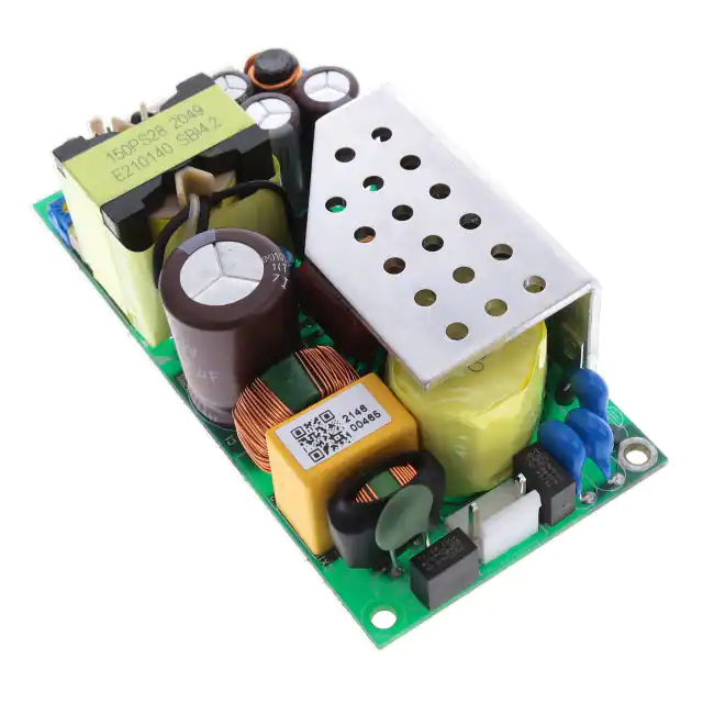

    ECP150系列是一款150W单输出AC-DC电源模块,具有低功耗和高效率特性,适用于医疗和ITE应用。该系列产品具有2x4英寸的紧凑尺寸,并提供从12V到48V的单输出电压。
ECP150PS28 数据手册
ECP150 Series AC-DC Power Supplies XP Power 150 Watts • 100 W Convection-cooled • 150 W Forced-cooled • 2” x 4”Foot Print • Single Outputs from 12 V to 48 V • Built-in Fan Supply • 60W 115/230 VAC 60 A 230 VAC cold start, 25 °C 230 μA 115/230 VAC/50 Hz (Typ.), 264 VAC/60 Hz (Max.) 0.5 W F3.15 A/250 V Internal fuse fitted in line and neutral. Output Characteristic Minimum Output Voltage - V1 Typical 12 Initial Set Accuracy Output Voltage Adjustment - V1 10 Minimum Load 0 Maximum Units Notes & Conditions 48 VDC See Models and Ratings table ±1 % V1 at 50% load, 115/230 VAC % V1 only via potentiometer. See mech. details, Vfan will track A Start Up Delay 550 ms Rise Time 35 ms Hold Up Time 16 20 115/230 VAC full load at 25° C. See fig. 3 & 4. ms At full load, 100 VAC, see fig. 5. Drift ±0.02 % After 20 min warm up Line Regulation ±0.5 % 90-264 VAC Load Regulation ±0.5 % 0-100% load % Recovery within 1% in less than 500 μs for a 50-75% and 75-50% load step % Full Load Transient Response 4 Over/Undershoot 4 Ripple & Noise 1 % pk-pk Overvoltage Protection 115 140 % Overload Protection 110 150 % I nom 0.02 %/ ° C Short Circuit Protection 20 MHz bandwidth & 10 μF electrolytic capacitor in parallel with 0.1 μF ceramic capacitor, See fig. 6. Vnom, recycle input to reset See fig. 1. Trip and Restart See fig. 2. Temperature Coefficient Output Overload Characteristic Figure. 1 ECP150PS12 ECP150PS24 Over Current Profile Over Current Profile 110% 130% 100% 24.2 140% 11.9 100Vac 11.7 115Vac 230Vac 11.5 264Vac 11.3 Output Voltage (V) Output Voltage (V) 100% 12.1 Percent Overload 120% 110% Percent Overload 120% 130% 140% 24 100Vac 23.8 115Vac 230Vac 23.6 264Vac 23.4 23.2 11.1 12.5 13.75 15 16.25 17.5 6.25 Current (A) www.xppower.com 6.875 7.5 Current (A) 8.125 8.75 2 ECP150 Series AC-DC Power Supplies Output Output Short Circuit Profile Figure 2 ECP150PS12 ECP150PS24 Output Start Up Time Output Rise Time Figure 3 Figure 4 ECP150PS12 100VAC full load ECP150PS12 100 VAC full load Output Hold Up Time Figure 5 ECP150PS12 100VAC 100W load 3 ECP150PS12 100VAC 150W load www.xppower.com XP Power ECP150 Series AC-DC Power Supplies XP Power Output Output Noise & Ripple Figure 6 ECP150PS12 at 100VAC & 150W load Low Frequency High Frequency General Characteristic Minimum Typical Efficiency Isolation: Input to Output Input to Ground Output to Ground Maximum Units 91 % Notes & Conditions 230 VAC Full load (see fig. 7 & 8) 4000 VAC 2 MOPP 1500 VAC 1 MOPP 500 VDC 60 kHz PFC ±10kHz 60 kHz Main Converters ±10kHz 14.9/9.9 Switching Frequency Power Density Mean Time Between Failure Weight W/in3 Forced / Convection-cooled 300 kHrs MIL-HDBK-217F, Notice 2 +25 °C GB 0.51(230) lb(g) Efficiency Vs Load Figure 7 ECP150PS12 Efficiency 100% 90% 100Vac input 115Vac input 230Vac input 80% 264Vac input 70% 10 20 30 40 50 60 70 80 90 100 Load (%) Figure 8 ECP150PS24 Efficiency 100% 90% 100Vac input 115Vac input 230Vac input 80% 264Vac input 70% 10 20 30 40 50 60 70 80 90 100 Load (%) www.xppower.com 4 ECP150 Series AC-DC Power Supplies XP Power Environmental Characteristic Maximum Units Operating Temperature Minimum -20 Typical +70 °C Storage Temperature -40 +85 °C Cooling 10 CFM Forced Cooled > 100W Humidity 5 95 %RH Non-condensing 3000 m Operating Altitude Notes & Conditions See derating curve, fig.9 ±3 x 30g shocks in each plane, total 18 shocks. 30g = 11ms (+/- 0.5msecs), half sine. Conforms to EN60068-2-27 Shock Single axis 10 - 500 Hz at 2g sweep and endurance at resonance in all 3 planes. Conforms to EN60068-2-6 Vibration Temperature Derating Curve 50 0 -40 High Line Only 100 Output Load (%) Figure 9 -30 0 +50 +70 Ambient Temperature (ºC) EMC: Emissions Phenomenon Conducted Radiated Harmonic Current Standard Test Level EN55011/22 Class B Criteria EN55011/22 Class A EN61000-3-2 Class A Standard Test Level Criteria Notes & Conditions Class C for loads above 60W EMC: Immunity Phenomenon Voltage Fluctuations Low Voltage PSU EMC EN61000-3-3 EN61204-3 High severity level as below Radiated Immunity EN61000-4-3 3 A EFT/Burst EN61000-4-4 3 A Surges EN61000-4-5 Installation class 3 A Conducted EN61000-4-6 3 A Dip > 95% (0 VAC), 8.3ms EN61000-4-11 EN55035 (240 VAC) Dips and Interruptions EN60601-1-2 (100 VAC EN60601-1-2 (240 VAC) 5 A Dip 30% (70 VAC), 416ms A Dip > 95% (0 VAC), 4160ms B Dip > 95% (0 VAC), 10.0ms A Dip 30% (168 VAC), 500ms A Dip > 95% (0 VAC), 5000ms B Dip > 95% (0 VAC), 10.0ms A Dip 60% (40 VAC), 100ms B Dip 30% (70 VAC), 500ms A Dip > 95% (0 VAC), 5000ms B Dip > 95% (0 VAC), 10.0ms A Dip 60% (96 VAC), 100ms A Dip 30% (168 VAC), 500ms A Dip > 95% (0 VAC), 5000ms B www.xppower.com Notes & Conditions ECP150 Series AC-DC Power Supplies XP Power Safety Approvals Safety Agency CB Report UL EN Safety Standard Notes & Conditions IEC62368-1 Audio/Video, Information and Communication Technology Equipment IEC60601-1 Ed 3 Including Risk Management Medical UL62368-1, CSA 22.2 No.62368-1-07 Ed, 2011-12 Audio/Video, Information and Communication Technology Equipment ANSI/AAMI ES60601-1:2005 & CSA C22.2, No.60601-1:08 Medical EN62368-1:2014/A11:2017 Audio/Video, Information and Communication Technology Equipment EN60601-1/A12:2006 Medical CE Meets all applicable directives UKCA Meets all applicable legislation Primary to Secondary 2 x MOPP (Means of Patient Protection) Primary to Earth 1 x MOPP (Means of Patient Protection) Means of Protection Category IEC60601-1 Ed 3 Mechanical Details & Connectivity TB1 - Input Connector Pin 1 Line Pin 2 Not Fitted Pin 3 Neutral 4.00 (101.6) Voltage Adj. 3.75 (95.2) Mates with JST housing VHR-3N and JST Series SVH-21T-P1.1 crimp terminals 1 Mounting holes marked with must be connected to safety earth 1.75 (44.45) N 3 L 1 TB1 TB2 TB2 - Output Connector Pin 1 +Vout Pin 2 +Vout Pin 3 +Vout Pin 4 -Vout Pin 5 -Vout Pin 6 -Vout TB3 1 2.00 (50.8) 6 0.134 (3.4) Mates with JST housing VHR-6N and JST Series SVH-21T-P1.1 crimp terminals 1.16 (29.5) TB3 - Fan Connector Pin 1 Fan + Pin 2 Fan - Mates with Molex housing 22-01-1022 and 2759 crimp terminals 0.06 (1.6) 0.10 (2.5) Notes 1. All dimensions shown in inches (mm). Tolerance: ±0.02 (0.5) 2. Weight: 0.42 lbs (230 g) approx. www.xppower.com 6 ECP150 Series AC-DC Power Supplies XP Power Thermal Considerations In order to ensure safe operation of the PSU in the end-use equipment, the temperature of the components listed in the table below must not be exceeded. Temperature should be monitored using K type thermocouples placed on the hottest part of the component (out of direct air flow). See Mechanical Details for component locations. Temperature Measurements (At Maximum Ambient) Component Max Temperature °C TR1 Coil 110°C L4 Coil 120°C Q1 Body 120°C Q2 Body 120°C C1 105°C C20 105°C Service Life The estimated service life of the ECP150 is determined by the cooling arrangements and load conditions experienced in the end application. Due to the uncertain nature of the end application this estimated service life is based on the actual measured temperature of a key capacitor with in the product when installed by the end application, The graph below expresses the estimated lifetime of a given component temperature and assumes continuous operation at this temperature. Estimated Service Life vs Component Temperature Figure 10 70000 60000 Lifetime (Hrs) 50000 40000 C20 30000 C1 20000 10000 0 105 95 85 75 65 55 C1 & C20 Temperature (ºC) 7 www.xppower.com 20 July 2022
ECP150PS28
物料型号:ECP150系列 器件简介:ECP150系列是XP Power公司生产的AC-DC电源,提供150瓦特强制风冷或100瓦特自然对流冷却的功率,具有2x4英寸的小巧尺寸。
该系列电源设计用于满足最新的环保法规,具有低无负载功耗和高效率,适用于医疗和ITE应用。
引脚分配: - 输入连接器TB1:1号脚为火线,3号脚为零线。
- 输出连接器TB2:1-3号脚为正输出电压,4-6号脚为负输出电压。
- 风扇连接器TB3:1号脚为风扇正,2号脚为风扇负。
参数特性: - 工作输入电压范围:90至264伏交流电。
- 工作频率范围:47至63赫兹。
- 功率因数:0.95。
- 满负荷输入电流:115/230伏交流电时分别为1.5/0.75安培。
- 空载输入功率:<0.5瓦。
- 效率:在230伏交流电满载时,效率可达91%。
功能详解:ECP150系列电源具有过压保护、过载保护、短路保护和瞬态响应等功能。
还包含两个保险丝和低泄漏电流,满足医疗应用要求。
应用信息:ECP150系列电源适用于广泛的应用,包括医疗设备和信息技术设备,由于其低剖面和安全认证,使其成为多种应用的理想选择。
封装信息:ECP150系列电源的尺寸为4.00 x 2.00 x 1.16英寸(101.6 x 50.8 x 29.5毫米),具有1.26英寸(约32毫米)的低高度和紧凑的2x4英寸的占用空间。
