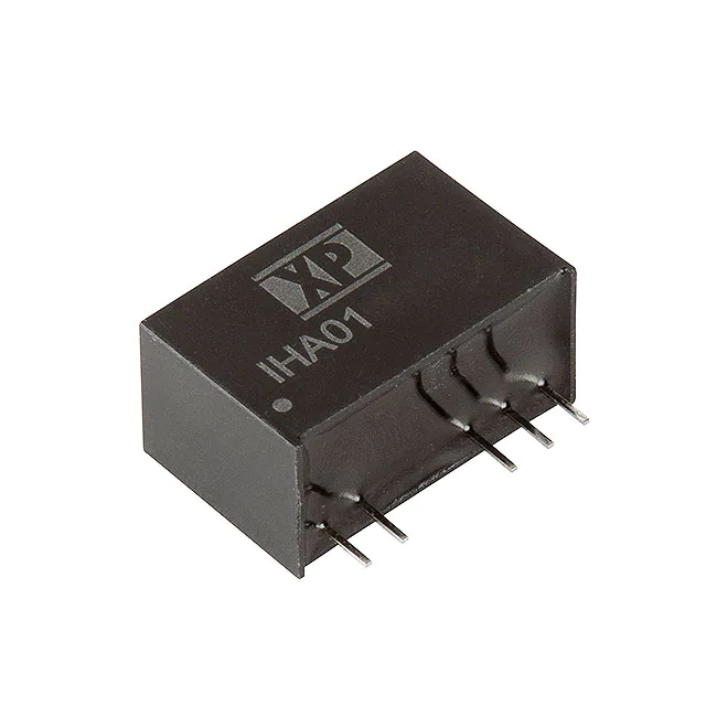

IHA01 Series DC-DC Converter 1 Watt xxx Series • High Isolation, 6000 V • 250 VAC Working Voltage • Single and Dual Outputs • Bipolar Outputs for MOSFET and IGBT Drives • SIP7 Package • -40 °C to +85 °C Operation • Full Load at 85 °C Ambient • MTBF 2.5 MHrs • 3 Year Warranty Dimensions: IHA01: 0.77 x 0.39 x 0.49” (19.5 x 9.8 x 12.5 mm) Input Characteristic Minimum 4.5 8.1 10.8 13.5 21.6 Input Voltage Range Typical Input Reflected Ripple Current Maximum 5.5 9.9 13.2 16.5 26.4 20 7 12 15 18 28 Input Surge Units VDC mA pk-pk VDC for 100 ms Notes & Conditions 5 V nominal 9 V nominal 12 V nominal 15 V nominal 24 V nominal Through 12 µH inductor and 47 µF capacitor 5 V nominal 9 V nominal 12 V nominal 15 V nominal 24 V nominal Output Characteristic Output Voltage Initial Set Accuracy Minimum Load Minimum 3.3 Typical Maximum 30 ±3 Units VDC % % Line Regulation ±1.2 %/1% Load Regulation 10 % 10 Cross Regulation ±4 % Ripple & Noise 200 mV pk-pk Short Circuit Protection Maximum Capacitive Load Temperature Coefficient 0.03 %/ ˚C Notes & Conditions See Models and Ratings table At full load Minimum load required to meet specified regulation Output changes by max of 1.2% for each 1% change in input voltage From 10% to full load, see application note On dual output models, when one output is at 25% load and other is varied from 10% load to full load 20 MHz bandwidth. Measured using 10 µF electrolytic in parallel with 0.1 µF ceramic capacitor Continuous See Models and Ratings table Mechanical Details 0.02 (0.5) 0.77 (19.5) 0.47 (12.0) 0.02 (0.5) 0.39 (9.8) 1 0.10 (2.54) 2 5 6 7 0.12 (3.0) 0.39 (9.8) Printed Face 0.09 (2.4) 0.01 (0.25) 0.08 (2.13) 0.02 (0.5) 0.60 (15.24) Notes 1. All dimensions are in inches (mm) 2. Weight: 0.009 lbs (4.3 g) approx. 3. Pin diameter: 0.02±0.002 (0.5±0.05) 1 4. Pin pitchand length tolerance: ±0.014 (±0.35) 5. Case tolerance: ±0.02 (±0.5) www.xppower.com 0.49 (12.5) Pin Connections Pin 1 2 5 6 7 Single +Vin -Vin -Vout No Pin +Vout Dual +Vin -Vin -Vout Common +Vout IHA01 Series DC-DC Converter Models & Ratings Input Voltage 4.5-5.5 V 8.1-9.9 V 10.8-13.2 V 13.5-16.5 V 21.6-26.4 V Output Voltage 3V3 5V 9V 12 V 15 V ±3V3 ±5 V ±9 V ±12 V ±15 V +15 V / -9 V 3V3 5V 9V 12 V 15 V ±3V3 ±5 V ±9 V ±12 V ±15 V +15 V / -9 V 3V3 5V 9V 12 V 15 V ±3V3 ±5 V ±9 V ±12 V ±15 V +15 V / -9 V 3V3 5V 9V 12 V 15 V ±3V3 ±5 V ±9 V ±12 V ±15 V +15 V / -9 V 3V3 5V 9V 12 V 15 V ±3V3 ±5 V ±9 V ±12 V ±15 V +15 V / -9 V Input current No Load Full Load Output Current 303 mA 200 mA 111 mA 83 mA 67 mA ±151 mA ±100 mA ±56 mA ±42 mA ±33 mA +33 mA / -55 303 mA 200 mA 111 mA 83 mA 67 mA ±151 mA ±100 mA ±56 mA ±42 mA ±33 mA +33 mA / -55 303 mA 200 mA 111 mA 83 mA 67 mA ±151 mA ±100 mA ±56 mA ±42 mA ±33 mA +33 mA / -55 303 mA 200 mA 111 mA 83 mA 67 mA ±151 mA ±100 mA ±56 mA ±42 mA ±33 mA +33 mA / -55 303 mA 200 mA 111 mA 83 mA 67 mA ±151 mA ±100 mA ±56 mA ±42 mA ±33 mA +33 mA / -55 30 mA 30 mA 30 mA 45 mA 40 mA 30 mA 30 mA 30 mA 45 mA 40 mA 40 mA 20 mA 25 mA 25 mA 25 mA 25 mA 25 mA 25 mA 25 mA 25 mA 25 mA 25 mA 20 mA 20 mA 20 mA 20 mA 20 mA 20 mA 20 mA 20 mA 20 mA 20 mA 20 mA 15 mA 15 mA 15 mA 15 mA 15 mA 15 mA 15 mA 15 mA 15 mA 15 mA 12 mA 15 mA 15 mA 15 mA 15 mA 15 mA 10 mA 15 mA 15 mA 15 mA 15 mA 15 mA mA mA mA mA mA 280 mA 265 mA 260 mA 265 mA 260 mA 275 mA 265 mA 260 mA 265 mA 260 mA 265 mA 155 mA 145 mA 140 mA 145 mA 140 mA 155 mA 150 mA 140 mA 145 mA 140 mA 140 mA 120 mA 115 mA 110 mA 115 mA 110 mA 115 mA 115 mA 110 mA 115 mA 110 mA 110 mA 91 mA 87 mA 83 mA 83 mA 84 mA 89 mA 84 mA 82 mA 83 mA 83 mA 79 mA 60 mA 59 mA 60 mA 58 mA 57 mA 61 mA 60 mA 57 mA 58 mA 56 mA 56 mA Max. capacitive load 220 220 220 220 220 ±100 ±100 ±100 ±100 ±100 ±100 220 220 220 220 220 ±100 ±100 ±100 ±100 ±100 ±100 220 220 220 220 220 ±100 ±100 ±100 ±100 ±100 ±100 220 220 220 220 220 ±100 ±100 ±100 ±100 ±100 ±100 220 220 220 220 220 ±100 ±100 ±100 ±100 ±100 ±100 µF µF µF µF µF µF µF µF µF µF µF µF µF µF µF µF µF µF µF µF µF µF µF µF µF µF µF µF µF µF µF µF µF µF µF µF µF µF µF µF µF µF µF µF µF µF µF µF µF µF µF µF µF µF µF Efficiency Model Number 71% 75% 77% 76% 77% 73% 75% 77% 76% 77% 76% 72% 77% 79% 77% 79% 73% 75% 79% 77% 79% 78% 70% 73% 77% 73% 76% 72% 73% 77% 74% 76% 76% 73% 77% 80% 80% 79% 75% 79% 81% 80% 80% 84% 70% 71% 70% 72% 73% 68% 69% 73% 72% 75% 74% IHA0105S3V3 IHA0105S05 IHA0105S09 IHA0105S12 IHA0105S15 IHA0105D03 IHA0105D05 IHA0105D09 IHA0105D12 IHA0105D15 IHA0105D1509 IHA0109S3V3 IHA0109S05 IHA0109S09 IHA0109S12 IHA0109S15 IHA0109D03 IHA0109D05 IHA0109D09 IHA0109D12 IHA0109D15 IHA0109D1509 IHA0112S3V3 IHA0112S05 IHA0112S09 IHA0112S12 IHA0112S15 IHA0112D03 IHA0112D05 IHA0112D09 IHA0112D12 IHA0112D15 IHA0112D1509 IHA0115S3V3 IHA0115S05 IHA0115S09 IHA0115S12 IHA0115S15 IHA0115D03 IHA0115D05 IHA0115D09 IHA0115D12 IHA0115D15 IHA0115D1509 IHA0124S3V3 IHA0124S05 IHA0124S09 IHA0124S12 IHA0124S15 IHA0124D03 IHA0124D05 IHA0124D09 IHA0124D12 IHA0124D15 IHA0124D1509 Notes Input currents measured at nominal input voltage. General Characteristic Efficiency Isolation: Input to Output Isolation Working Voltage Isolation Resistance Isolation Capacitance Switching Frequency Power Density Mean Time Between Failure Weight Minimum Typical 77 Maximum 6000 250 109 10 50 6.8 20 2.39 0.009 (4.2) Units % VDC VAC Ω pF kHz W/in3 MHrs lb (g) www.xppower.com Notes & Conditions See Models and Ratings table MIL-HDBK-217F, +25 °C GB 2 IHA01 Series DC-DC Converter Environmental Maximum Units Notes & Conditions Operating Temperature -40 +85 °C No thermal derating Storage Temperature -40 +125 °C Characteristic Minimum Typical Case Temperature 2.5 Humidity +100 °C 95 %RH Non-condensing Natural convection Cooling EMC: Emissions Phenomenon Standard Test Level Notes & Conditions Conducted EN55022 Class B See Application Note Radiated EN55022 Class B EMC: Immunity Phenomenon Standard Test Level Criteria ESD Immunity EN61000-4-2 ±6/±8 kV A Radiated Immunity EN61000-4-3 10 Vrms A EFT/Burst EN61000-4-4 2 kV A Conducted Immunity EN61000-4-6 10 V rms A Magnetic Fields EN61000-4-8 1 A/m A Notes & Conditions Contact/Air Discharge External components required, see application notes Mechanical Details 0.02 (0.5) 0.77 (19.5) 0.47 (12.0) 0.02 (0.5) 0.39 (9.8) 1 0.10 (2.54) 2 5 6 7 0.12 (3.0) 0.39 (9.8) Printed Face 0.09 (2.4) 0.08 (2.13) 0.02 (0.5) 0.60 (15.24) Pin Connections Notes 1. All dimensions are in inches (mm) 2. Weight: 0.009 lbs (4.3 g) approx. 3. Pin diameter: 0.02±0.002 (0.5±0.05) 3 0.49 (12.5) 0.01 (0.25) 4. Pin pitch and length tolerance: ±0.014 (±0.35) 5. Case tolerance: ±0.02 (±0.5) www.xppower.com Pin 1 2 5 6 7 Single +Vin -Vin -Vout No Pin +Vout Dual +Vin -Vin -Vout Common +Vout 3 IHA01 Series DC-DC Converter Application Note Regulation Hig hl Typ ica Low imit l Lo ad L ine Lim it EFT Filter Input component C1 is used to help meet EFT test requirements for the module. C1 IHA01 IHA0105XXXX 470 µF/35 V IHA0109XXXX 470 µF/35 V IHA0112XXXX 470 µF/35 V IHA0115XXXX 470 µF/35 V IHA0124XXXX 470 µF/35 V I EMI Filter Input filter components (C1,C2, C3 and L) are used to help meet conducted emissions requirements for the module. These components should be mounted as close as possible to the module, and all leads should be minimised to decrease radiated noise. C1 IHA01 L IHA0105XXXX 1206, 4.7 µF/ 50 V 18 µH IHA0109XXXX 1206, 4.7 µF/ 50 V 18 µH IHA0112XXXX 1206, 4.7 µF/ 50 V 18 µH IHA0115XXXX 1206, 4.7 µF/ 50 V 18 µH IHA0124XXXX 1206, 4.7 µF/ 50 V 18 µH C2 C3 1210, 2.2 µF/ 100 V 1206, 470 pF/ 2 kV C3 www.xppower.com 23 Aug 16

物料型号:IHA01系列 器件简介:高隔离性,工作电压高达6000V,提供单输出和双输出,双极性输出适用于MOSFET和IGBT驱动,SIP7封装,工作温度范围为-40°C至+85°C,MTBF为2.5MHrs,提供3年保修。 引脚分配:单输出型号引脚1和2为输入正负极,引脚5和7为输出正负极;双输出型号引脚1和2为输入正负极,引脚5为负输出,引脚7为正输出,引脚6为空脚,通常为公共地。 参数特性:输入电压范围从4.5VDC至26.4VDC,输出电压范围从3.3VDC至30VDC,具有不同的输出电流和输入电流规格,以及效率、隔离电阻、电容、开关频率等详细参数。 功能详解:提供了详细的输入输出特性表,包括初始设定精度、最小负载、线路调节、负载调节、交叉调节、纹波和噪声、短路保护、最大电容负载和温度系数等。 应用信息:提供了环境特性表,包括工作温度、存储温度、外壳温度、湿度和冷却方式,以及EMC辐射和抗扰度标准。 封装信息:提供了详细的机械尺寸图和重量信息,以及引脚连接的详细说明。
