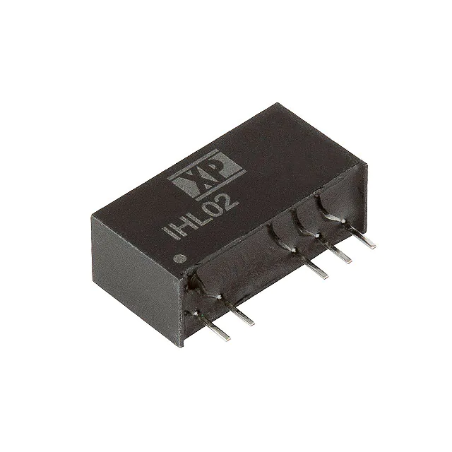

IHL02 Series DC-DC Converter XP Power 2 Watts xxx Series • High Isolation, 5.2kVDC (functional insulation) • Working voltage rated for 250Vrms & 400VDC • Single & dual outputs • Bipolar outputs for MOSFET & IGBT drives • Common mode transient immunity (CMTI) 20 kV/μs • SIP7 package • -40 °C to +95 °C operation • Full load at 65 °C ambient • MTBF 3.3 MHrs Dimensions: • 3 year warranty IHL02: 0.77 x 0.28 x 0.39” (19.5 x 7.2 x 10.0 mm) The IHL02 series is a low cost, high isolation, high working voltage DC-DC converter with excellent common mode transient immunity (CMTI). The low input to output capacitance of just 10pF, high continuous working voltage rating and 2.5mm isolation barrier, make the product ideal for IGBT & MOSFET driver applications. Input Characteristic Input Voltage Range Minimum Typical maximum 4.5 5.5 10.8 13.2 13.5 16.5 21.6 26.4 Input Reflected Ripple Current 20 Units 5 V nominal VDC 9 Input Surge 20 12 V nominal 15 V nominal 24 V nominal mA pk-pk 18 Notes & Conditions Through 12 μH inductor and 47 μF capacitor 5 V nominal VDC for 100 ms 30 12 V nominal 15 V nominal 24 V nominal Output Characteristic Minimum Output Voltage 3.3 Typical Initial Set Accuracy Minimum Load maximum Units Notes & Conditions 30 VDC See Models and Ratings table ±5 % 10 % Minimum load required to meet specified regulation Output changes by max of 1.2% for each 1% change in input voltage Line Regulation ±1.2 %/1% Load Regulation 12/10 % For IHL0205S3V3 and IHL0205S05/Other Models. From 10% to full load, see application note % On dual output models, when one output is at 25% load and other is varied from 10% load to full load mV pk-pk 20 MHz bandwidth. Measured using 10 μF electrolytic in parallel with 0.1 μF ceramic capacitor Cross Regulation Ripple & Noise ±5 150 Short Circuit Protection Continuous, auto recovery Maximum Capacitive Load Temperature Coefficient 1 At full load See Models and Ratings table 0.03 %/ ˚C www.xppower.com IHL02 Series DC-DC Converter XP Power Models & Ratings Input Voltage Output Voltage Output Current 3V3 5V 9V 12 V 15 V ±5 V ±9 V ±12 V ±15 V +15/-9 V 3V3 5V 9V 12 V 15 V ±5 V ±9 V ±12 V ±15 V +15/-9V 3V3 5V 9V 12 V 15 V ±5 V ±9 V ±12 V ±15 V +15/-9V 3V3 5V 9V 12 V 15 V ±5 V ±9 V ±12 V ±15 V +15/-9V 500 mA 400 mA 222 mA 167 mA 133 mA ±200 mA ±111 mA ±83.3 mA ±66.7 mA +66.7/-111 mA 500 mA 400 mA 222 mA 167 mA 133 mA ±200 mA ±111 mA ±83.3 mA ±66.7 mA +66.7/-111 mA 500 mA 400 mA 222 mA 167 mA 133 mA ±200 mA ±111 mA ±83.3 mA ±66.7 mA +66.7/-111 mA 500 mA 400 mA 222 mA 167 mA 133 mA ±200 mA ±111 mA ±83.3 mA ±66.7 mA +66.7/-111 mA 5V (4.5-5.5V) 12V (10.8-13.2V) 15V (13.5-16.5V) 24V (21.6-26.4V) Input current No Load Full Load 40 mA 435 mA 40 mA 505 mA 40 mA 480 mA 40 mA 475 mA 40 mA 470 mA 40 mA 505 mA 40 mA 490 mA 40 mA 480 mA 40 mA 475 mA 40 mA 480 mA 30 mA 185 mA 30 mA 210 mA 30 mA 205 mA 30 mA 205 mA 30 mA 200 mA 30 mA 210 mA 30 mA 205 mA 30 mA 200 mA 30 mA 200 mA 30 mA 210 mA 25 mA 150 mA 25 mA 170 mA 25 mA 165 mA 25 mA 165 mA 25 mA 160 mA 25 mA 170 mA 25 mA 165 mA 25 mA 160 mA 25 mA 165 mA 25 mA 165 mA 20 mA 95 mA 20 mA 105 mA 20 mA 105 mA 20 mA 105 mA 20 mA 105 mA 20 mA 105 mA 20 mA 105 mA 20 mA 105 mA 20 mA 100 mA 20 mA 105 mA Maximum Capacitive Load 1000 μF 470 μF 470 μF 220 μF 220 μF ±220 μF ±220 μF ±100 μF ±100 μF +100/-220 μF 1000 μF 470 μF 470 μF 220 μF 220 μF ±220 μF ±220 μF ±100 μF ±100 μF +100/-220 μF 1000 μF 470 μF 470 μF 220 μF 220 μF ±220 μF ±220 μF ±100 μF ±100 μF +100/-220 μF 1000 μF 470 μF 470 μF 220 μF 220 μF ±220 μF ±220 μF ±100 μF ±100 μF +100/-220 μF Efficiency Model Number 76% 79% 83% 84% 85% 79% 82% 83% 84% 83% 74% 79% 82% 82% 83% 79% 81% 83% 83% 80% 74% 78% 81% 82% 83% 79% 81% 83% 82% 81% 73% 78% 81% 81% 81% 79% 80% 81% 82% 80% IHL0205S3V3 IHL0205S05 IHL0205S09 IHL0205S12 IHL0205S15 IHL0205D05 IHL0205D09 IHL0205D12 IHL0205D15 IHL0205D1509 IHL0212S3V3 IHL0212S05 IHL0212S09 IHL0212S12 IHL0212S15 IHL0212D05 IHL0212D09 IHL0212D12 IHL0212D15 IHL0212D1509 IHL0215S3V3 IHL0215S05 IHL0215S09 IHL0215S12 IHL0215S15 IHL0215D05 IHL0215D09 IHL0215D12 IHL0215D15 IHL0215D1509 IHL0224S3V3 IHL0224S05 IHL0224S09 IHL0224S12 IHL0224S15 IHL0224D05 IHL0224D09 IHL0224D12 IHL0224D15 IHL0224D1509 Notes Input currents measured at nominal input voltage. General Characteristic Minimum Efficiency Isolation: Input to Output Typical maximum 80 % 5200 VDC Isolation Working Voltage Isolation Resistance 250 Switching Frequency 7 50 100 23.7 Power Density Mean Time Between Failure VAC rms Notes & Conditions See Models and Ratings table Functional (100% production test for 60s) 400 VDC Ω 109 Isolation Capacitance Units 3.3 pF kHz W/in3 MHrs MIL-HDBK-217F, +25 °C GB Case Material Non-conductive black plastic (UL94V-0) Pin Material C5191R-H solder coated phospher bronze Potting Material Epoxy (UL94V-0) 260 Solder Process Weight 0.006 (2.7) °C 1.5mm from case, 10 s max. lb (g) www.xppower.com 2 IHL02 Series DC-DC Converter XP Power Environmental Characteristic maximum Units Operating Temperature Minimum -40 Typical +95 °C Storage Temperature -40 +125 °C Case Temperature Humidity 2.5 Notes & Conditions Derate Linearly from 100% at 65 °C to no load at 95 °C +100 °C 95 %RH Non-condensing Cooling Natural convection EMC: Emissions Phenomenon Standard Test Level Notes & Conditions Conducted EN55032 Class B See Application Note Radiated EN55032 Class B EMC: Immunity Phenomenon Standard Test Level Criteria ESD Immunity EN61000-4-2 ±6/±8 kV A Radiated Immunity EN61000-4-3 10 Vrms A EFT/Burst EN61000-4-4 2 kV A Conducted Immunity EN61000-4-6 10 V rms A Magnetic Fields EN61000-4-8 1 A/m A CMTI Notes & Conditions Contact/Air Discharge External components required, see application notes 1500 VDC 20 kV/μs Safety Approvals Safety Agency Safety Standard CE Meets all applicable directives Notes & Conditions UKCA Meets all applicable legislation Mechanical Details 0.28 (7.2) 0.76 (19.5) 0.12 (3.0) 0.37 (9.5) 0.08 (2.0) 0.02 (0.5) 0.02 (0.5) 0.60 (15.24) 0.08 (2.13) Pin Connections 0.08 (2.13) Notes 1. All dimensions are in inches (mm) 2. Weight: 0.006 lbs (2.7 g) approx. 3. Pin diameter: 0.02±0.002 (0.5±0.05) 3 0.28 (7.2) 0.39 (10.0) 0.02 (0.5) 0.10 (2.54) 0.01 Printed (0.25) Face 4. Pin pitch and length tolerance: ±0.014 (±0.35) 5. Case tolerance: ±0.02 (±0.5) www.xppower.com Pin 1 2 5 6 7 Single +Vin -Vin -Vout No Pin +Vout Dual +Vin -Vin -Vout Common +Vout 3 IHL02 Series DC-DC Converter XP Power Application Note Regulation High limit Typi cal L oad Line Low Limi t EFT Filter Input components C1 and D1 are used to help meet EFT and surge test requirements for the module. 1 IHL02 D1 2 C1 D1 IHL0205XXXX 330 μF/50 V SMDJ9.0 A IHL0212XXXX 330 μF/50 V SMDJ13 A IHL0215XXXX 330 μF/50 V SMDJ18 A IHL0224XXXX 1000 μF/35 V SMDJ24 A 7 5 EMI Filter Input filter components (C1,C2, C3 and L) are used to help meet conducted emissions requirements for the module. These components should be mounted as close as possible to the module, and all leads should be minimised to decrease radiated noise. 1 IHL02 C3 2 C1 7 L 5 L IHL0205XXXX 1206, 4.7 μF/ 16 V 6.8 μH IHL0212XXXX 1206, 22 μF/ 25 V 6.8 μH IHL0215XXXX 1206, 22 μF/ 25 V 6.8 μH IHL0224XXXX 1210, 10 μF/ 35 V 10 μH C2 C3 1210, 10 μF/ 35 V 1210, 10 μF/ 35 V Derating Curve www.xppower.com 22 Sept 2021
IHL0205S3V3
物料型号:IHL02系列 器件简介:低成本、高隔离、高工作电压DC-DC转换器,具有出色的共模瞬态抗扰度(CMTI)。 引脚分配:单输出配置为1+Vin, 2-Vin, 5-Vout, 7+Vout;双输出配置为1+Vin, 2-Vin, 5-Vout, 6COM, 7+Vout。 参数特性:工作电压额定值为250Vrms和400VDC,输入电压范围从4.5VDC至26.4VDC,输出电压范围从3.3VDC至30VDC,具有多种输入和输出电压组合。 功能详解:产品适用于IGBT和MOSFET驱动应用,具有高连续工作电压额定值和低输入至输出电容。 应用信息:适用于-40°C至+95°C的环境温度范围,65°C环境温度下满负荷工作,MTBF为3.3百万小时,提供3年保修。 封装信息:SIP7封装,尺寸为0.77 x 0.28 x 0.39英寸(19.5 x 7.2 x 10.0毫米)。
