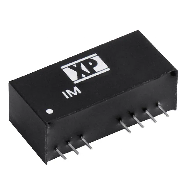

DC-DC 2 Watts IM Series xppower.com Specification Regulated Single & Dual Output • Wide 4:1 Input Range • SIP Package • 1500 VDC Isolation • UL Approved • Remote On/Off • Continuous Short Circuit Protection • 3 Year Warranty Input Voltage Input Input Voltage Range Input Reflected Ripple Current Input Filter Input Surge • • See table • 20 mA pk-pk through 12 μH inductor and 47 μF capacitor, 5 Hz to 20 MHz • Capacitor • 24 V models: 50 VDC for 100 ms 48 V models: 100 VDC for 100 ms 9.0-36.0 V Output Output Voltage Minimum Load Line Regulation Load Regulation Setpoint Accuracy Ripple & Noise Short Circuit Protection Cross Regulation Remote On/Off • • • • • • • • • See table None(1) ±0.5% max ±0.5% max from 10-100% load(1) ±1% max 50 mV pk-pk max, 20 MHz bandwidth Continuous with auto recovery (foldback) ±5% on dual output models(2) On: Pin floating or pulled to -Vin Off: Pin driven to +2.7 to 15 VDC with respect to -Vin Vmax: 15 Vdc Temperature Coefficient • 0.02%/C 18.0-75.0 V Output Voltage Output Current No Load Input Current(3) 3.3 V 500 mA 10 mA 2200 μF 75% IM2403SA 5.0 V 400 mA 10 mA 1000 μF 81% IM2405SA 12.0 V 165 mA 10 mA 165 μF 84% IM2412SA 15.0 V 135 mA 10 mA 100 μF 85% IM2415SA ±5.0 V ±200 mA 10 mA ±470 μF 81% IM2405S ±12.0 V ±85 mA 10 mA ±100 μF 83% IM2412S ±15.0 V ±65 mA 10 mA ±47 μF 82% IM2415S 3.3 V 500 mA 5 mA 2200 μF 75% IM4803SA 5.0 V 400 mA 5 mA 1000 μF 80% IM4805SA 12.0 V 165 mA 5 mA 165 μF 84% IM4812SA 15.0 V 135 mA 5 mA 100 μF 84% IM4815SA ±5.0 V ±200 mA 5 mA ±470 μF 80% IM4805S ±12.0 V ±85 mA 5 mA ±100 μF 81% IM4812S ±15.0 V ±65 mA 5 mA ±47 μF 84% IM4815S 1.02 (26.0) • • • • • • See table 1500 VDC 109 Ω 500 pF max 250 kHz typical >1.2 MHrs to MIL-HDBK-217F at 25 °C, GB 0.36 (9.2) Printed Face 0.49 (12.5) 1 2 3 6 7 8 9 0.16 (4.0) 0.07 (1.8) Environmental 2 x 0.1 (2 x 2.54) Operating Temperature • -40 °C to +100 °C, derate from 100% load at 75 °C to 0% load at 100 °C Storage Temperature • -40 °C to +125 °C Case Temperature • 100 °C max Cooling • Convection-cooled 1 2 3 • UL60950-1, CAN/CSA C22.2 No.60950-1, UL62368-1, CE (Meets all applicable directives), UKCA (Meets all applicable legislation Notes 1. Operation at no load will not damage the converter but may not meet all specifications. 2. When one output is set to 100% load and the other varies between 25%-100% load. 3. Input current measured at nominal input voltage 4. Pin pitch tolerance: ±0.014 (±0.35) 5. Case tolerance: ±0.02 (±0.5) 6. Weight: 0.014 lbs (6.5 g) 0.3 (7.62) 3 x 0.1 (3 x 2.54) 0.012 (0.3) Bottom View Safety Safety Approvals Model Number Mechanical Details General Efficiency Isolation Voltage Isolation Resistance Isolation Capacitance Switching Frequency MTBF Max Capacitive Efficiency Load 7 6 8 9 0.02 (0.50) Pin Single 1 -V Input 0.36 (9.2) 0.11 (2.75) PIN CONNECTIONS Dual Pin -V Input 7 Single Dual N.C. Common 2 +V Input +V Input 8 N.C. N.C. 3 Remote On/Off Remote On/Off 9 -V Output -V Output 6 +V Output +V Output 22 Sept 2021
