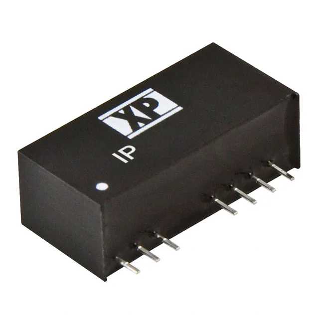

xppower.com • Regulated Single & Dual Output • Wide 4:1 Input Range • SIP Package • 1600 VDC Isolation • -40 °C to 85 °C Operation • Remote On/Off • 3 Year Warranty Specification Input Voltage Input Input Voltage Range Input Reflected Ripple Current Input Filter Input Surge • See table • 20 mA pk-pk through 12 μH inductor and 47 μF capacitor, 5 Hz to 20 MHz • Capacitor • 12 V models: 25 VDC for 100 ms 24 V models: 50 VDC for 100 ms 48 V models: 100 VDC for 100 ms 4.5-18.0 V Output Voltage Output Current No Load Input Current Max Capacitive Load Efficiency 3.3 V 700 mA 5.0 V 600 mA 40 mA 1760 μF 72% IP1203SA 40 mA 1000 μF 77% 12.0 V IP1205SA 250 mA 40 mA 170 μF 81% IP1212SA 15.0 V 200 mA 40 mA 110 μF 81% IP1215SA ±5.0 V ±300 mA 40 mA ±470 μF 77% IP1205S ±12.0 V ±125 mA 40 mA ±100 μF 80% IP1212S ±15.0 V ±100 mA 40 mA ±47 μF 80% IP1215S 3.3 V 700 mA 25 mA 1760 μF 75% IP2403SA 5.0 V 600 mA 25 mA 1000 μF 79% IP2405SA 12.0 V 250 mA 25 mA 170 μF 82% IP2412SA 15.0 V 200 mA 25 mA 110 μF 82% IP2415SA ±5.0 V ±300 mA 25 mA ±470 μF 79% IP2405S ±12.0 V ±125 mA 25 mA ±100 μF 79% IP2412S ±15.0 V ±100 mA 25 mA ±47 μF 80% IP2415S 3.3 V 700 mA 15 mA 1760 μF 74% IP4803SA 5.0 V 600 mA 15 mA 1000 μF 78% IP4805SA 12.0 V 250 mA 15 mA 170 μF 80% IP4812SA 15.0 V 200 mA 15 mA 110 μF 81% IP4815SA ±5.0 V ±300 mA 15 mA ±470 μF 79% IP4805S ±12.0 V ±125 mA 15 mA ±100 μF 79% IP4812S ±15.0 V ±100 mA 15 mA ±47 μF 79% IP4815S Output Output Voltage • Minimum Load • Line Regulation • Load Regulation • Setpoint Accuracy • Ripple & Noise • Temperature Coefficient • Short Circuit Protection • Cross Regulation • Remote On/Off • See table None(1) ±0.2% max ±1.0% max for a 10-100% load change(1) ±1% max 30 mV pk-pk max, 20 MHz bandwidth 0.02%/°C Continuous with auto recovery (foldback) ±5% on dual output models(2) Apply 2 to 4 mA to pin 3 to turn off output 9.0-36.0 V 18.0-75.0 V General Efficiency Isolation Voltage Isolation Resistance Isolation Capacitance Switching Frequency MTBF • • • • • • See table 1600 VDC 109Ω 200 pF 100-600 kHz variable >1.7 MHrs to MIL-HDBK-217F at 25 °C, GB Mechanical Details 0.86 (21.85) 0.36 (9.20) Printed Face 0.42 (10.60) Environmental Operating Temperature • -40 °C to +85 °C, derate from 100% load at 70 °C to 30% load at 85 °C Storage Temperature • -40 °C to +125 °C Case Temperature • 100 °C max Cooling • Convection cooled 0.02 (0.50) 0.10 (2.54) 0.44 (11.10) 1 2 3 5 6 7 8 0.12 (3.05) 0.70 (17.78) 0.02 (0.50) 0.36 (9.20) Notes 1. Operation at no load will not damage the converter but may not meet all specifications. 2. When one output is set to 100% load and the other varies between 25%-100% load. 3. Pin pitch tolerance ±0.014 (±0.35) 4. Case tolerance ±0.02 (0.5) 5. Weight: 0.014 lbs (6.5 g) 6. All dimensions in inches (mm) Model Number 0.01 (0.25) 0.13 (3.20) 0.02 (0.50) Pin 1 2 3 4 Single -V Input +V Input Remote On/Off No Pin PIN CONNECTIONS Dual Pin Single -V Input 5 N.C. +V Input 6 +V Output Remote On/Off 7 -V Output No Pin 8 N.C. Dual N.C. +V Output Common -V Output 23 Sept 2021 DC-DC 3 Watts IP Series
